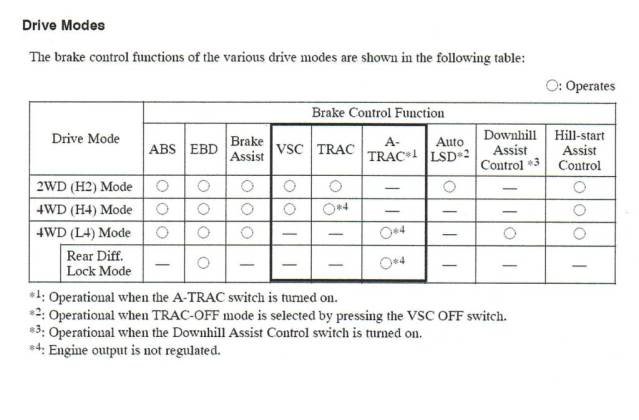

    AUTO LSD (2WD) is the same mechanical function as TRAC (4WD-Hi): Both are traction control (limited slip) without engine output regulation. They just don't use the same name. TRAC in 2WD has engine output regulation... but sometimes you need to rev it up and that is why the push of a button to turn off TRAC (2WD), which turns on AUTO LSD.
    When you go into H4, the TRAC system looses the engine regulation and becomes AUTO LSD but on all four tires, they didn't call it that name sadly.
    Before you mess with a new truck, in warantee still, that has a great stock traction system, learn what it is you have and try it one winter.

    Good info davidk. The problem however is TRAC shuts off in 4L leaving 2 open diffs. Here a mechanical LSD makes sense.

    So, stay in H4... it will do better with TRAC than L4 anyway... The only exception is steep grades... for that he should have gotten the Off Road TRD so he could have A-TRAC or Rear Locker in L4.
    All is not lost, however... He can have TRAC in L4 by performing the YELLOW WIRE MOD !!! It is for all non A-TRAC 4WD Tacomas 2009+
    They report great advance in ability with TRAC in L4 (or call it AUTO LSD in L4)!

    ONLY IN 2WD TRAC, NOT IN 2WD AUTO LSD and NOT IN 4WD.
    (you see friends, even though this information has been posted by me for a year and many others, people still don't know how it works)
    This used to be my signature... It is the 9 drive modes we '09+ Off Road 4WD Tacomas have:
    1) 2WD: VSC and TRAC active, engine regulated ('Limited Slip Lite').
    2) 2WD: 'AUTO LSD' ('TRAC OFF MODE'). No engine regulation for 'strong' limited slip.
    3) 2WD: 'VSC OFF MODE' (TRAC is off for 'open differential').
    4) 4WD-Hi: VSC and TRAC active. No engine regulation for 'strong' limited slip.
    5) 4WD-Hi: 'VSC OFF MODE' (TRAC is off for 'open differentials').
    6) 4WD-Lo: VSC and TRAC are both off in L4 ('open differentials').
    7) 4WD-Lo: 'A-TRAC' on gives a 'locker-like, super strong' limited slip, front and rear.
    8) 4WD-Lo: Rear Differential Locked and open front differential (A-TRAC off).
    9) 4WD-Lo: RR DIFF LOCK + A-TRAC on, 3 MPH limit.
    Only the Off Road 4WD Tacomas have a hydraulic brake booster (for the A-TRAC system).
    Now, the 2WD Tacomas have modes 1-3 and the Off Road 2WD Tacomas have 1-3 + a locking rear differential.
    The 4WD non-Off Road Tacomas have modes 1-6.
