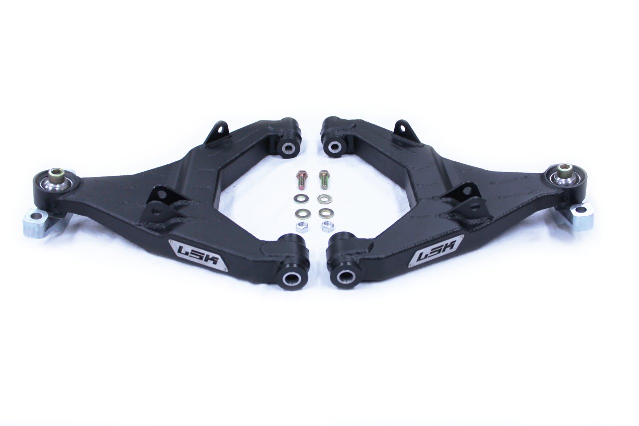

    Lower Control Arms are here!

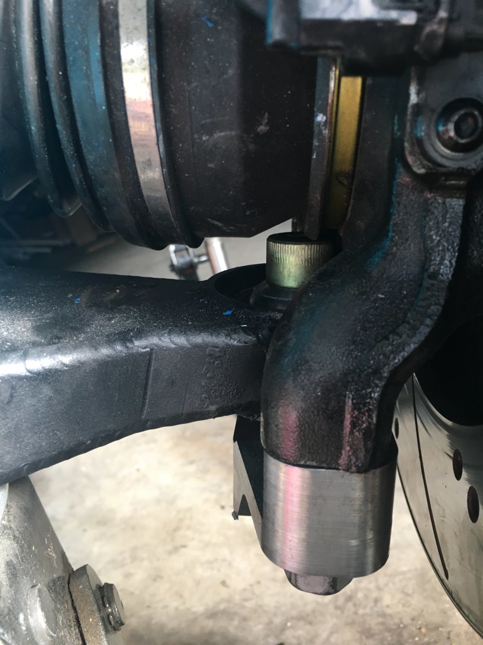

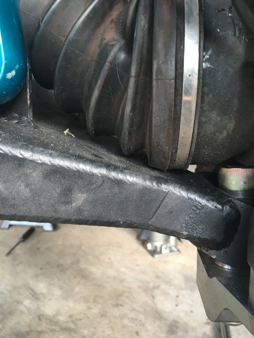

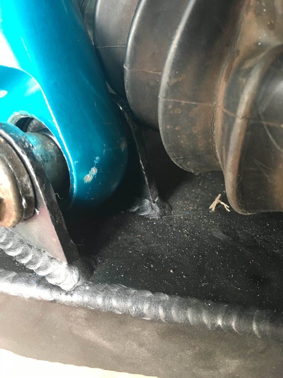

    I have installed many different mid travel kits and long travel kits. They were def installed correctly. I’m not really too sure what’s up but these are not fitting on the 4wd tacoma.
    Issues~
    -cv seal hits uniball bolt head
    -cv axle physically hits/rubs lower control arm and the boots rub the shock tabs bad
    -had to spread the pivots to get the lower control arm in
    -shock tabs were too narrow for the OEM King coilovers to drop in

    Definitely not enough room for a allen bolt in there, it'll have to be swapped out for a flanged 12point bolt or something with a similar low profile.
    The shock boot rubbing may be from the lower bearing spacers being backwards, AFAIK the longer one should be in the rear.
    Some of the other issues I've seen too, but are minor, and you can bend/shift things around slightly and make them fit.

    Basically the first issue was with the uniball being too big and contacting the CV dust cover from the wheel bearing. I was told by LSK to grind down the uniball so it wouldn’t contact...so I did.

    D3C11E87-DBA7-44D9-BD56-22660B7E7B3D.jpg A94C2625-62E2-4C8E-B471-F2EA090A670F.jpg 0C3763EA-6BDC-4C75-BAD2-EFB2E058403F.jpg
    Here is how it sat before we connected the UCA. We had to grind the bolt head to get it to clear. Once connected at the uca is when we discovered the hub will barely even rotate because it is rubbing the lca so bad.7B81B637-6EB0-4CC3-BD6D-A94F0D4B8C07.jpg

    Check the pics. It’s a lot more messed up than it sounds

    Dirt kings had the same interference issue with their LT kit between the CV and the broadside of the LCA. They ended up issuing spacers (basically washers) to fit in between the spindle and spindle cup to space the LCA further from the CV
