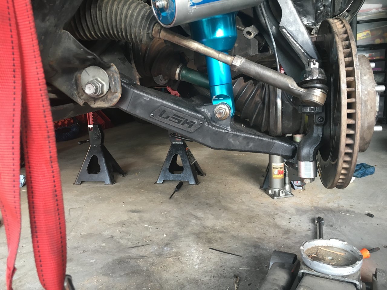

    Yeah it's a bummer, sounds like when they tried to get as much clearance as possible they shifted the LCA too high

    Definitely, I can't see those allen bolts through the uniball would ever clear properly, there's barely any clearance with a correct bolt. Good luck getting this shit show sorted out. :annoyed:

    I think LSK just designed these up for a prerunner and didn’t actually test these out on a 4x4. I guess I’m the test dummy hEre

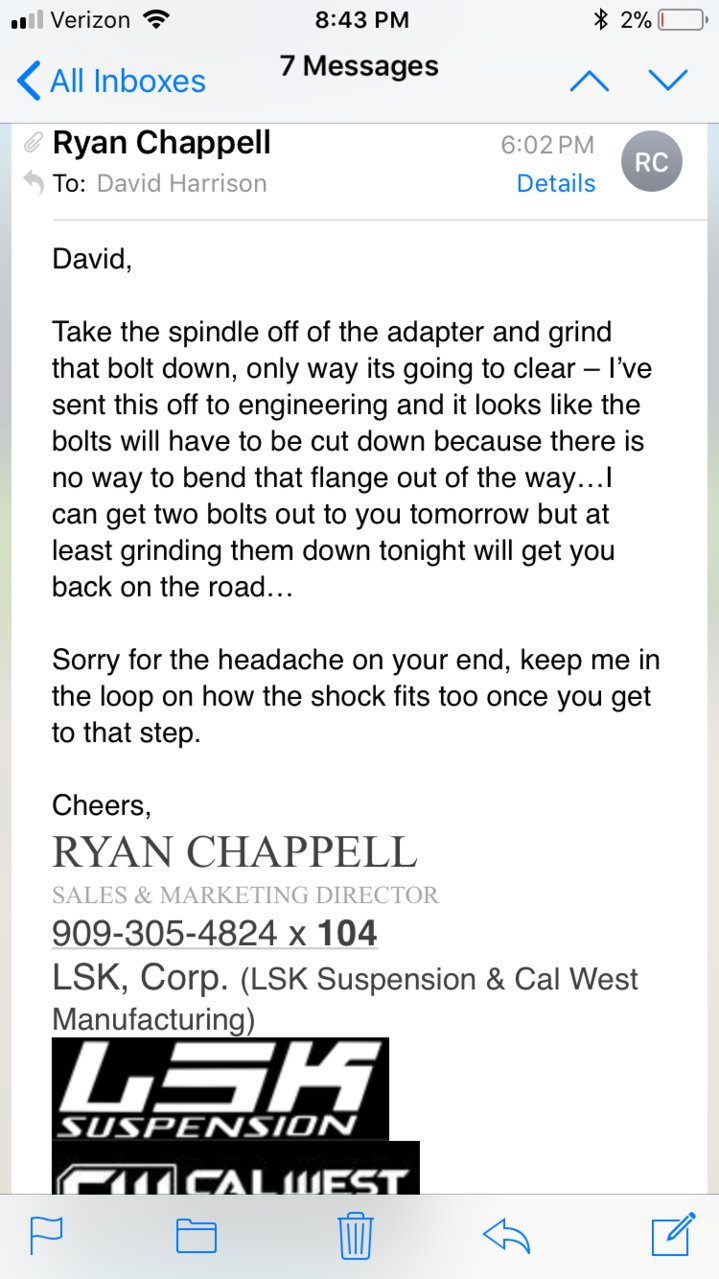

    Here’s the reply from LSK after I informed them of the first issue with the uniball bolt.
    EDDO likes this.
  13. Jul 10, 2018 at 8:46 PM
    #73
    anthony250f
    anthony250f Well-Known Member
    Feb 18, 2012
    #73066
    16,772
    Anthony
    San Diego, CA
    2008 dcsb trd offroad 4wd

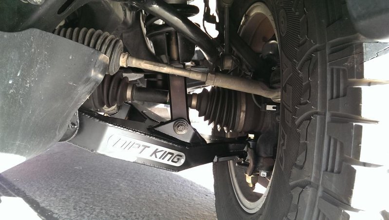

    The dirt Kings still have way more clearance.

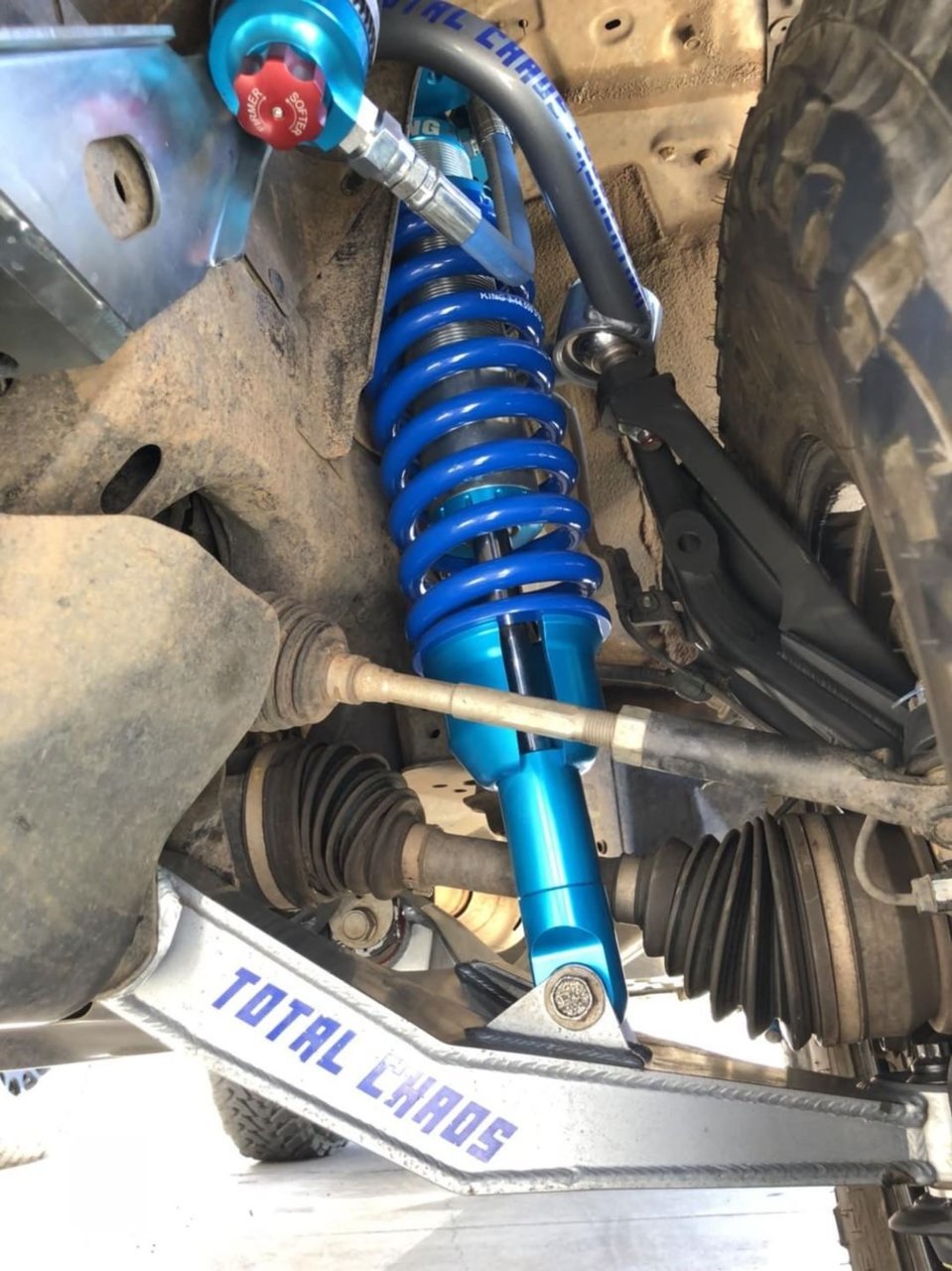

    The issue was on their LT arms at full droop.

    Ah ok. You can see the LSK arms have no bend in them. That bend def helps clear the cv axle

    That billet adapter from LSK appears to hold the uniball too high.

    I could always just shave the billet adapter down some...riiiiiight

    2-3 washers should bring that low enough to clear the CV and uniball bolt.
    LSK needs to redesign the bracket.

    I think that would make it worse, it needs to be spaced farther from the spindle/CV. If you're desperate throw some washers and see how much spacing it needs to clear. I wouldn't offroad with a bunch of washers in there but you should be able to DD it with proper torque and thread locker until the issue is correctly addressed
