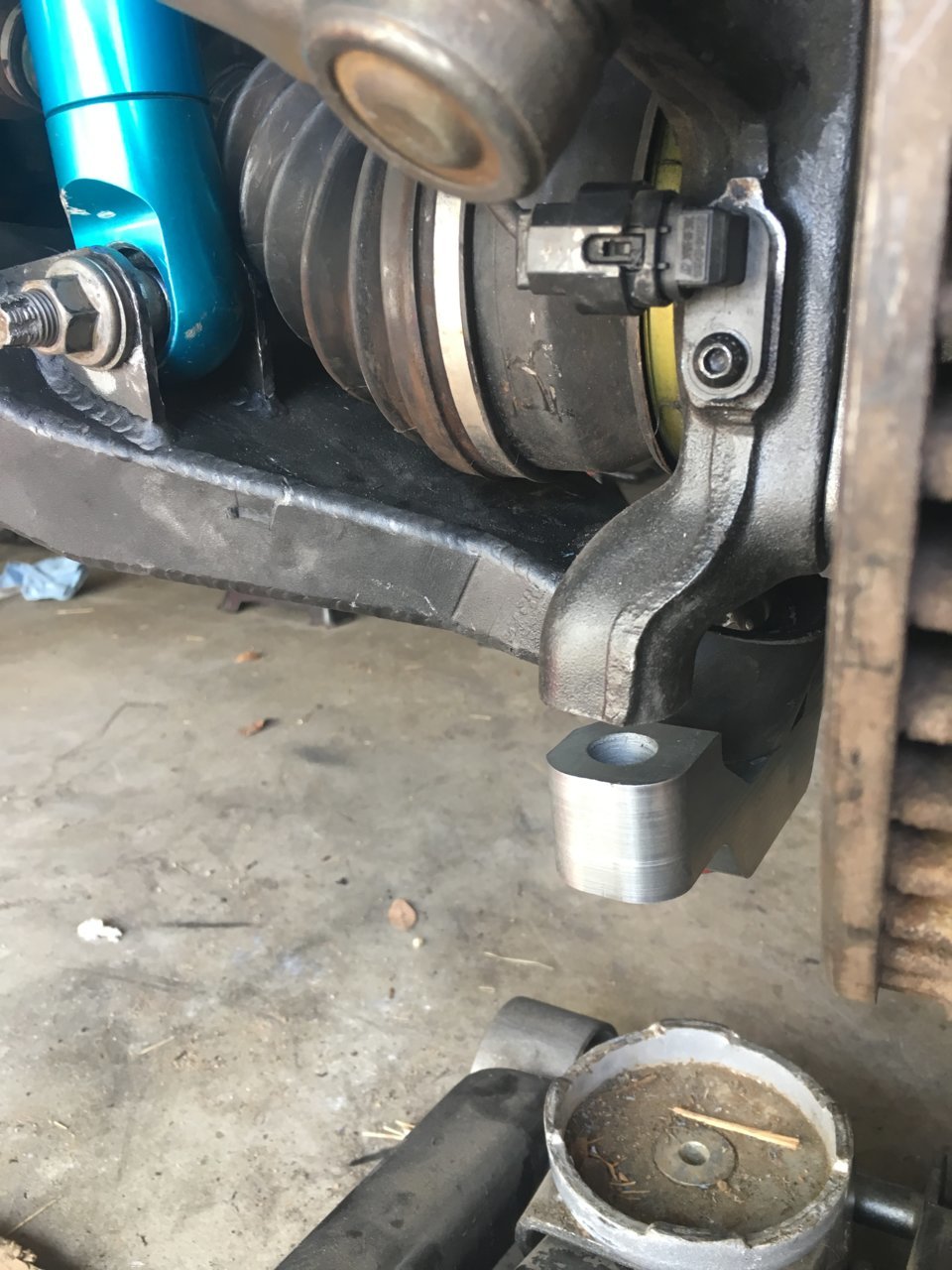

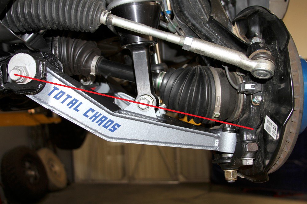

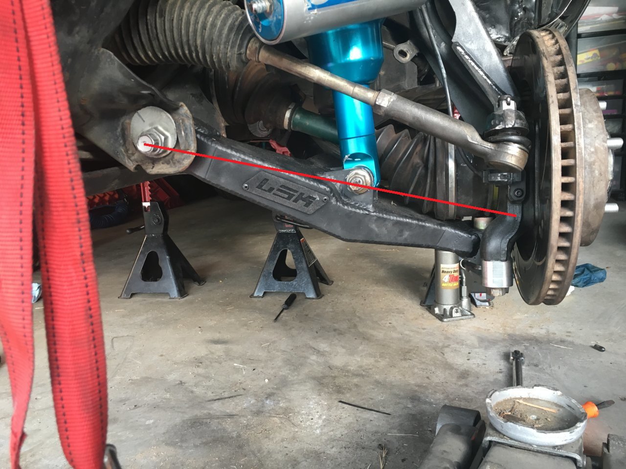

    Very rough illustrations but that geo line isnt even close. The spindle is sitting WAY lower than the TC kit.

    The spindle is sitting way lower. It was very noticeable when we went to attach the uca bolt. The uca was MUCH further away from the spindle than before. We had to jack the truck WAY up to even attach the spindle to uca bolt.

    So I talked to Aaron the owner of LSK and he is doing everything he can to make this issue correct

    Aaron said the adaptor piece may be the wrong piece and that most likely is the issue with the CV boots rubbing. He was very professional and really wanted to handle this the correct way and I appreciated his honesty and help. He also said they are mocking up the lower with a 4x4 Tacoma today to get things sorted out and so they can post pictures so stay tuned...

    So the arms aren’t going to work even with washers or a huge spaced adapter. The problem is that the boot is still rubbing the shock body/shock tabs. I have a rebuilt CVJ axle so they may have put beefier boots on the rebuild. I didn’t try the other side of the truck because I was too frustrated with the figment/hassle of my driver side.

    If you didn't specify OEM outer boots then CVJ most likely put on their silicone boots, which are wider/thicker than OEM. That's not a LSK issue, it's a mixing and matching parts issue. When I had stock length DK lowers I had the same problem. The shock mounting tabs were thicker and beefier causing the interference. I just ground down the tab a little bit to clear the boot. It sucks but that's how it goes when you're installing different parts from different companies, there are likely going to be issues since they can't account for every possible combination of components.

    First off I would like to thank everyone for being civil in a matter of a member sharing their experience with parts not working on their particular vehicle - I know I'm not the only person who's had something similar happen in the past - It sucks, it's beyond frustrating, and certainly can leave a bad taste in your mouth with a company if not handled correctly.
    To respond to my email screenshot that was posted - I knew BBtacosurfer was in a predicament and needed to get these arms installed that evening so he could be driving his truck as soon as possible - my recommendation on grinding the top head of the bolt to clear the cv flange was just to get him back on the road - we were going to send him a replacement bolt the next day for him to exchange in the future at his leisure - I also recommended shaving the misalignments down on his King coilovers as they did not slip into the LCA tab as designed - We've checked our tab width measurements and they correspond with King's misalignment measurements, so if this turns out to be an issue we will supply custom misalignments and include them with the arms so no one has to grind down their misalignments (Though we are hoping this was an isolated case, as it appears to be so far as of 7/12)...
    We went ahead and refunded BBtacosurfer's payment for the arms and even payed for his MOOG replacement arm off Amazon as an extended courtesy - he was in the unfortunate circumstance of not being able to re-install his original OEM arm - all the more reason this was an unfortunate situation. We stand by our products and want to make sure people are more than satisfied with what they receive...after all, most of us work our a$$es off to outfit our rigs so every cent should be well spent...
    That being said, the 15' 4x4 Tacoma I have in the yard that we used for mockup clears everything at full droop with the current configuration you've seen pictured - however, based on this feedback we are going to modify the current spindle adapter to allow for some more grace room for both the uniball bolt and cv boot. With those changes, we will also with make a disclaimer that if you are running aftermarket CV's with larger boots that attach farther up the axle shaft, it's probably not going to fit :(
    I'll have some pictures up of the final revision so everyone will get an idea of how the system should look as soon as I can get a set processed in the mill. Should anyone have any questions whatsoever, please feel free to comment here, PM, call, email, smoke signal, whatever...we're pretty easy to get a hold of.

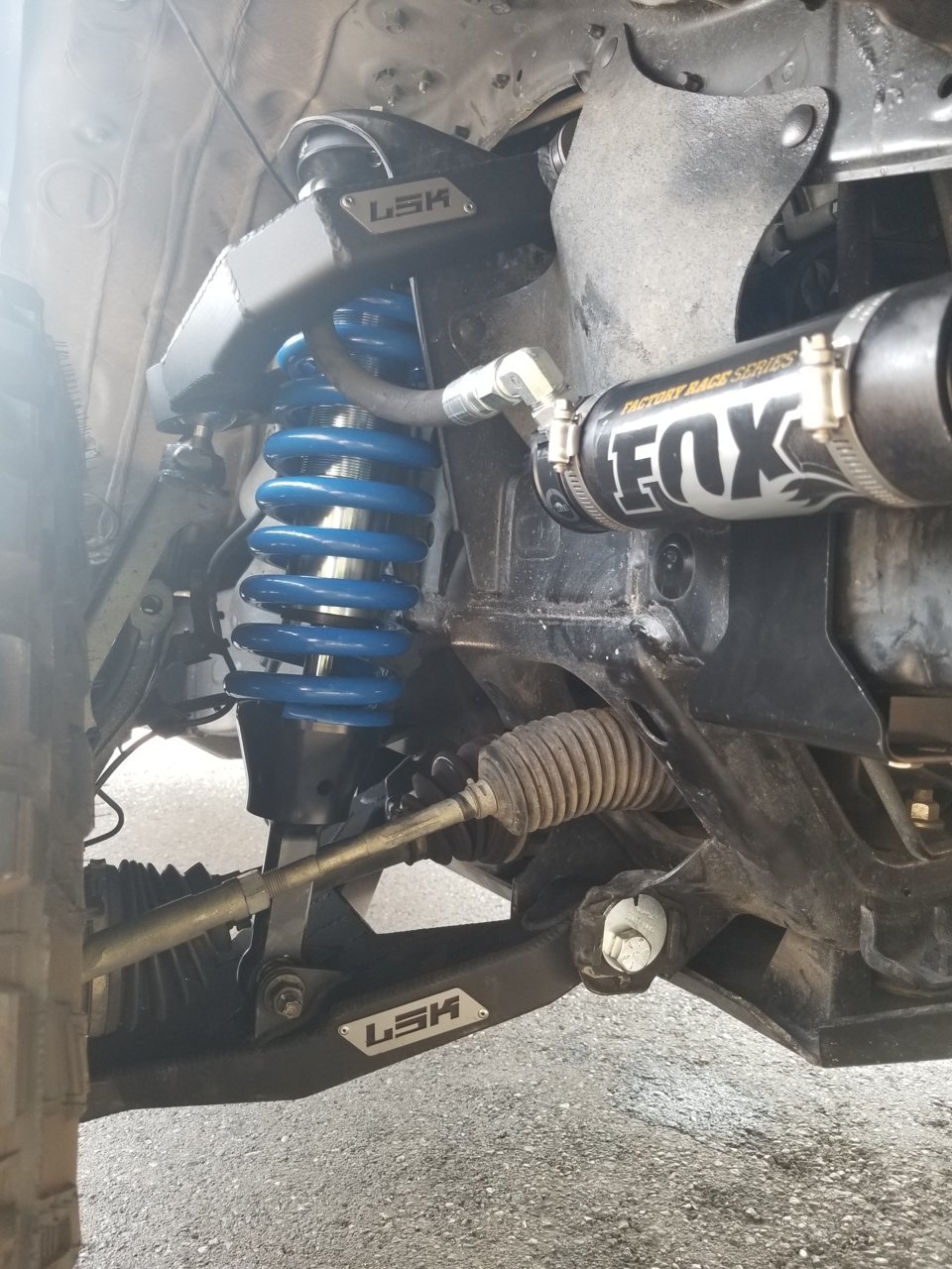

    So far everything went fine, need to drop preload but no rubbing. I'll post further pictures later and gather some thoughts on the arms after a few days driving with them 20180809_153832.jpg 20180809_173350.jpg

    Not gonna lie man...that set up looks mean as hell with the upper and lower LSK arms.

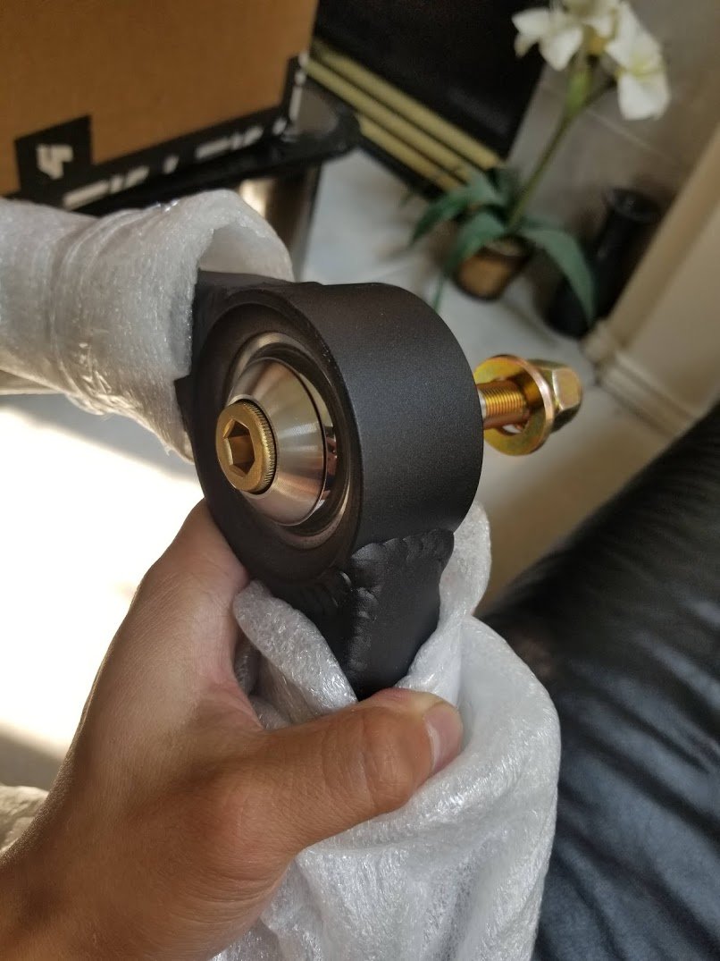

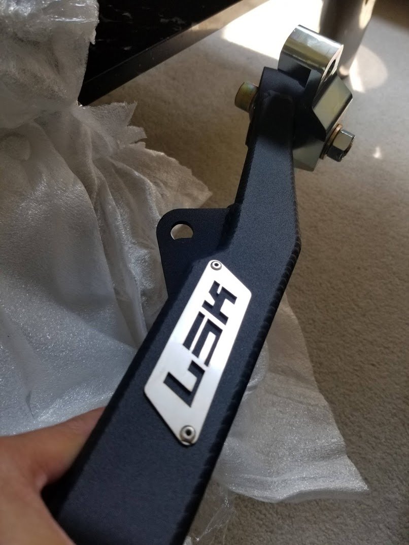

    Below are photos of how they arrived, I got the newer spindle adapters with the taller length so they do not rub the stock cv boots
    - the shock mounts are flared to make the install of shocks much easier -- they position normally when you torque them down.
    - the top allen you need for the uca is an odd size, its an 11mm or m11 so i had to special order it through my mac tools guy to get one
    - make sure you torque the bottom of the uniball to spindle adapter as they come pretorqued but found later they needed to be tightened since it had play with the weight of the truck and caused the waster to spin freely when truck was at resting height
    [​IMG][​IMG][​IMG]
    [​IMG][​IMG]

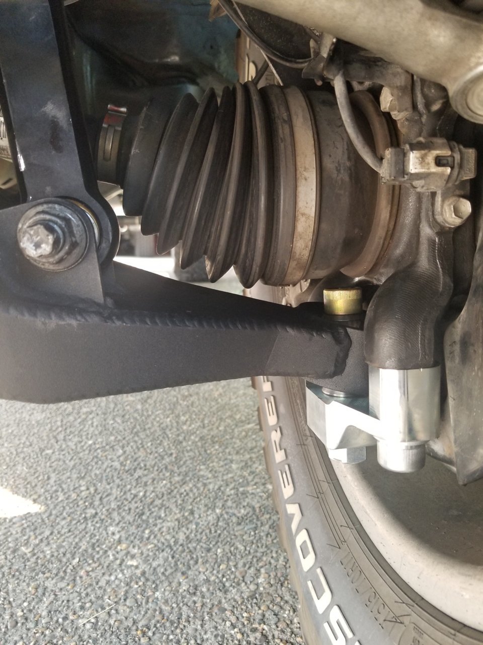

    Below are pictures of the clearance of the boots in relation to the lca
    [​IMG][​IMG]
