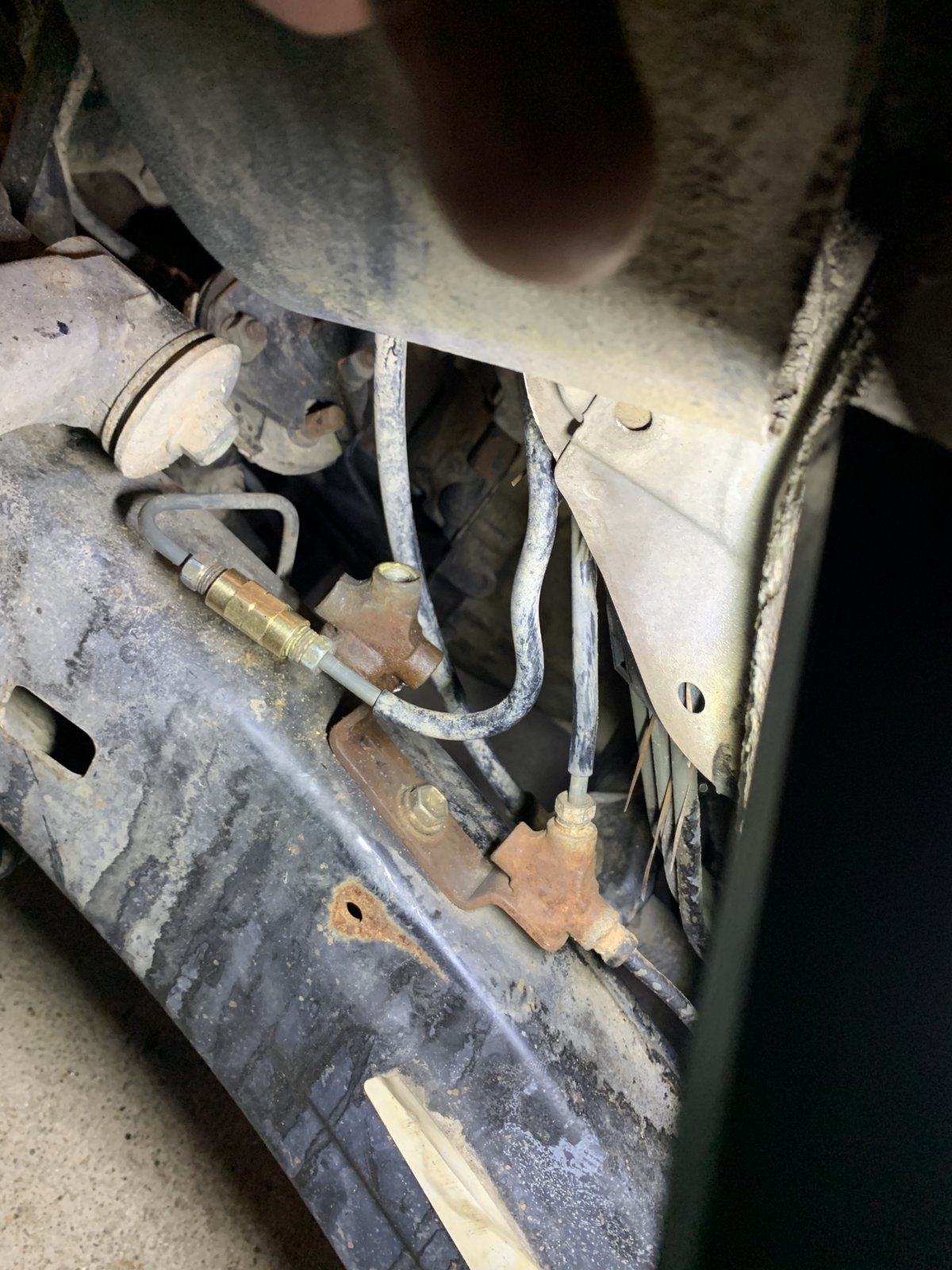

    BTW
    I traced return line from LSVP
    Found the T on L frame rail
    2 inches away from another T fitting on same rail
    I’m currently thinking what is best order to unconnected which brake lines
    And
    Making a bracket for the P valve
    keep everybody posted

    Update
    Traced lines….3 times…..found return line
    I was too pissed/embarrassed to post last weekend
    I stripped the return line plug to the T connection bolted to the front L frame rail. Where the (deleted) hard return line goes
    The whole cul de sac heard my cursing
    MC ran dry
    Cuts on my hands were soaked with caustic brake cleaner
    Really good time.

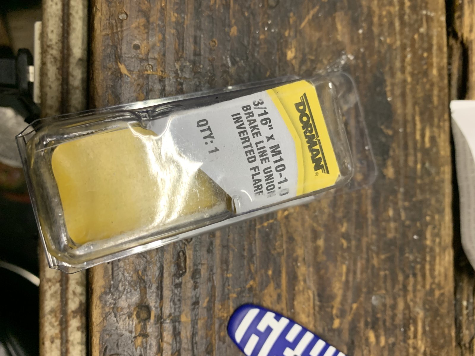

    backed off
    Found this from Oriellys

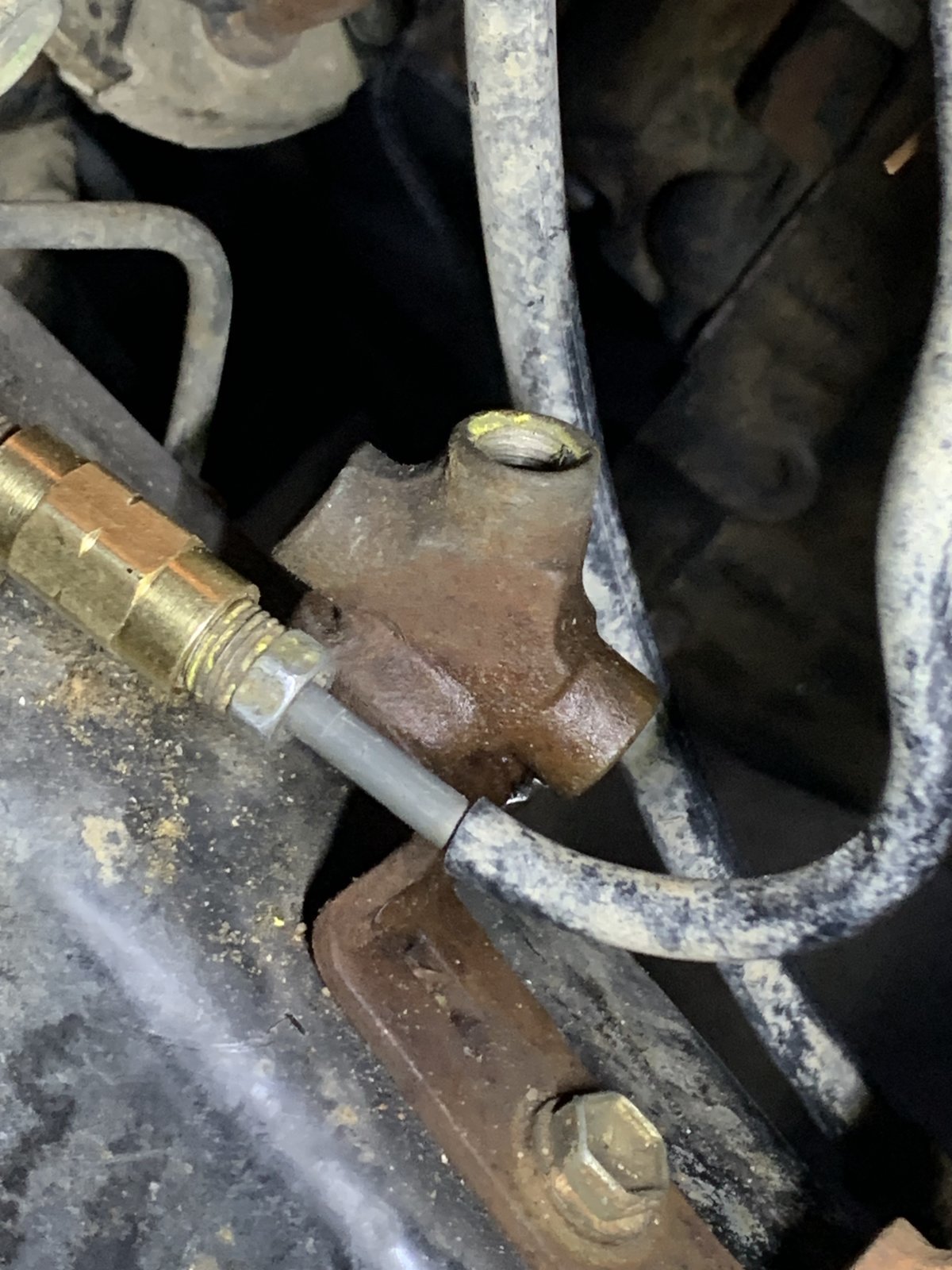

    I really wanted an elbow
    But
    The two T fittings are welded to bracket
    Went to one of my boat shops
    Mechanic owner showed me similar fitting on his race boat….that they got from auto parts store
    this is result:

    Here is hanging return line:

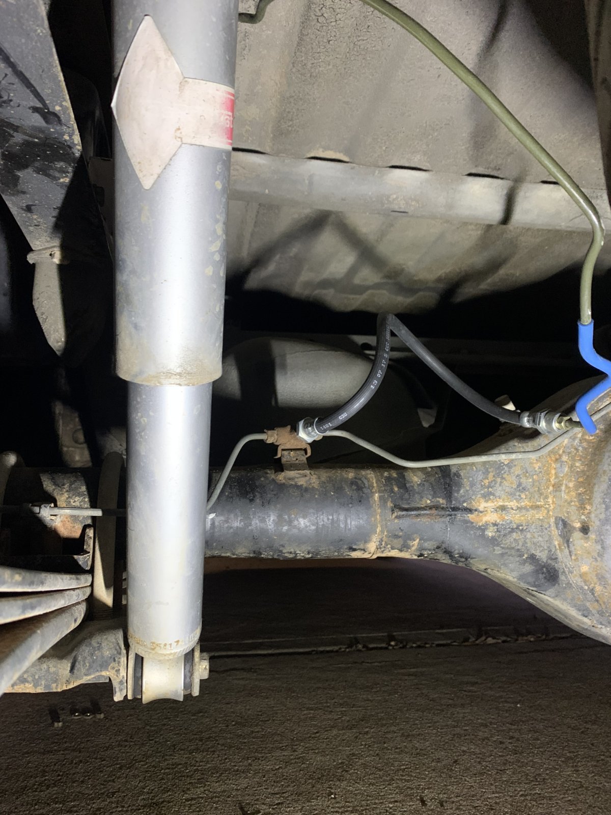

    I was A.D.D. About letting MC run dry
    So added fluid after the brake line union installed
    rear portion valve/new soft line/added hard line installed too
    But will wait to post

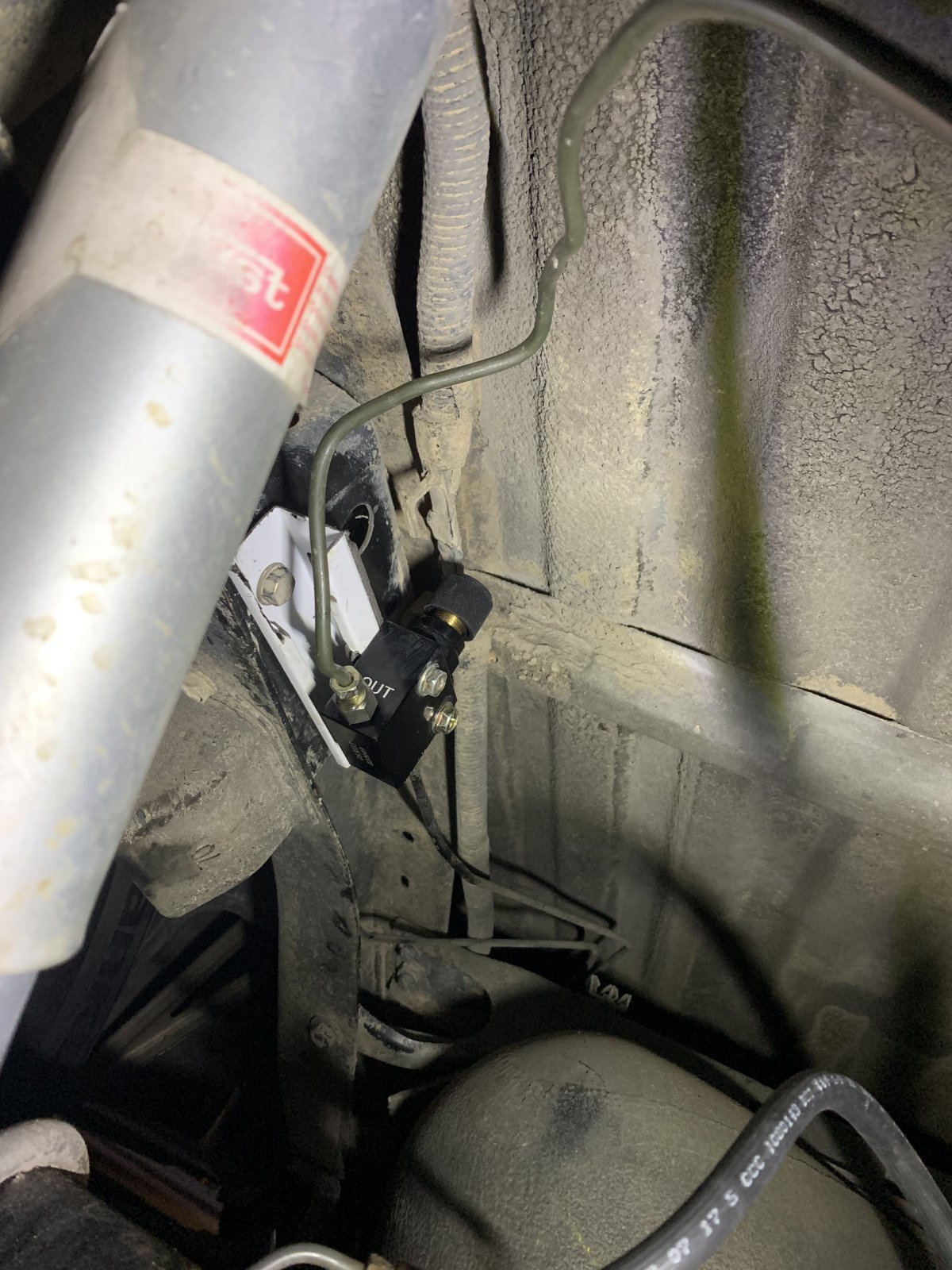

    Like I stated
    I HATE bleeding brakes
    Seriously, 2.5hrs with lil hand pump(tht broke BTW…..10min to fix that issue)
    But wow
    What a freakin difference
    I now got 4 tires skidding/stopping!
    Still messing with portion valve setting though
    I’m 100% convinced that my LSVP plain out failed, only front brake bias present before the delete.
    post pix of rear later
    Plz don’t crack on me too hard on my fab’d bracket and use of the shortest Subaru brake line I had in attic!

    Glad this is done!

    Took 2 more test drives for lock up brake test
    I got all 4 corners skidding same time
    Did have leak at proportion valve
    Both adapters needed a lil more torque
    job done
