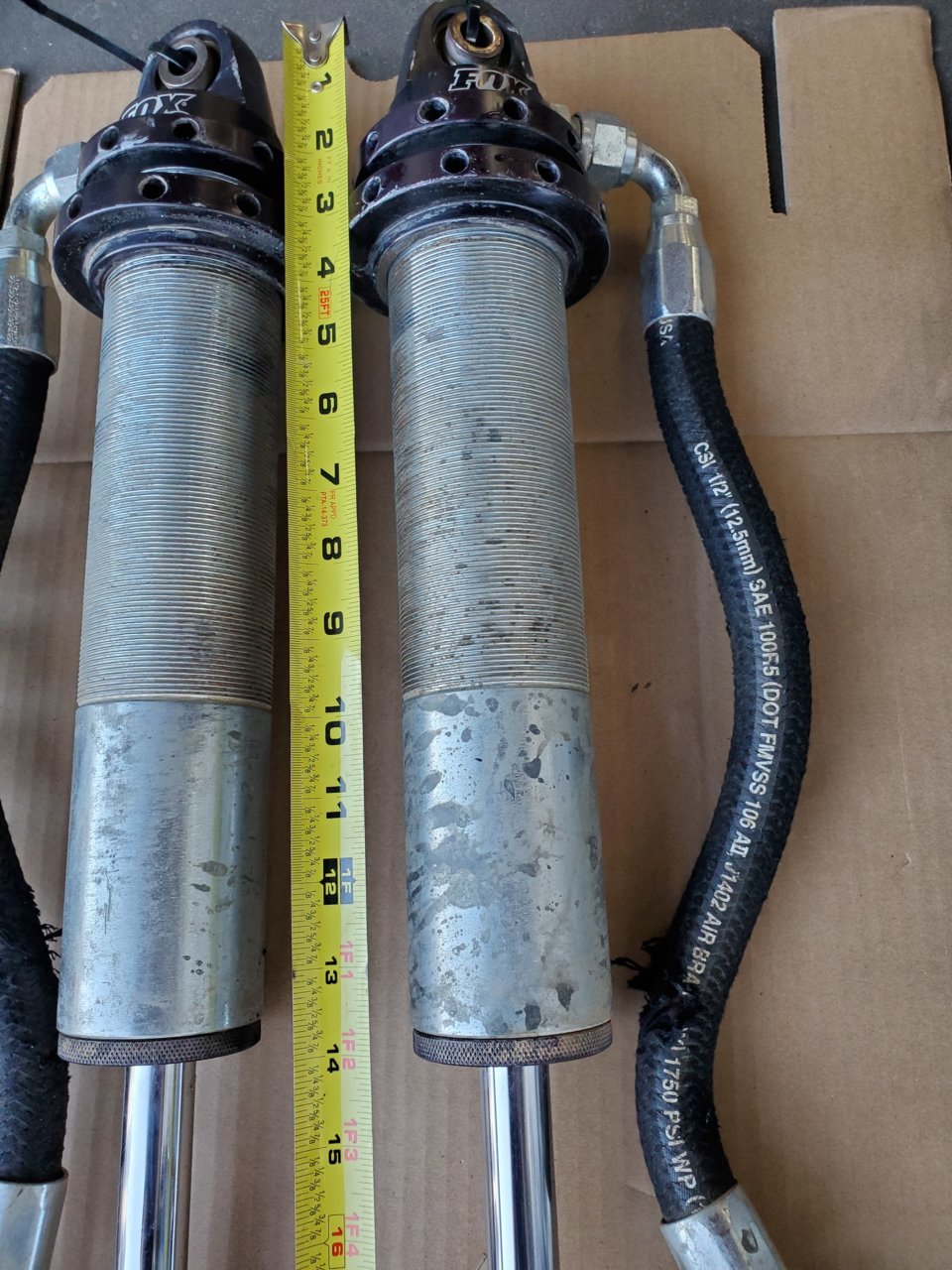

    Fox 2.5 8" coil over shocks.

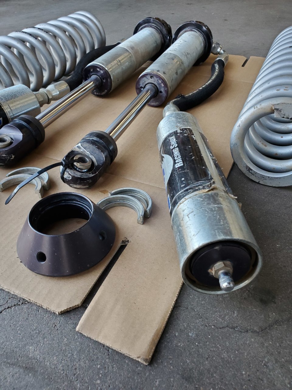

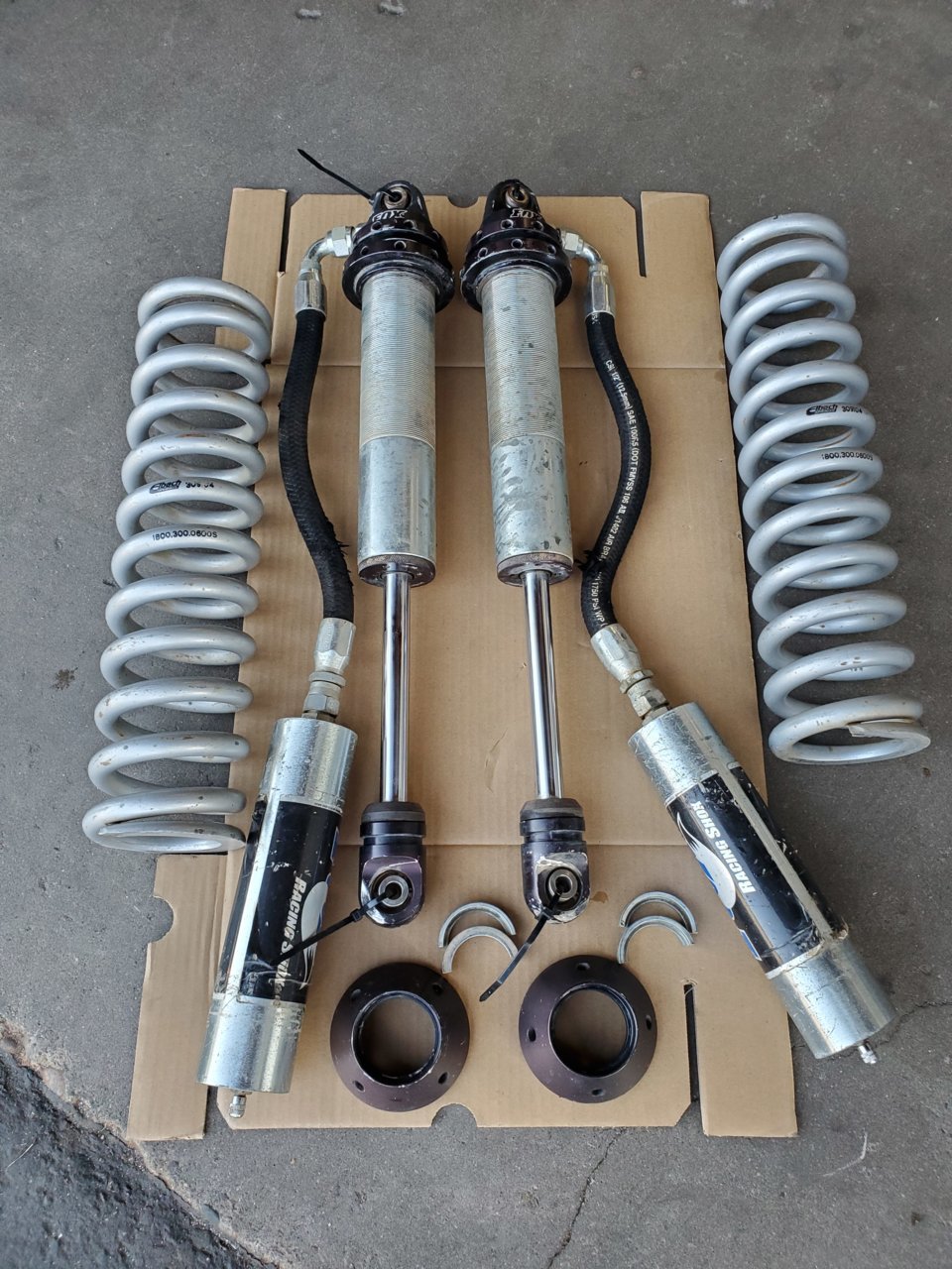

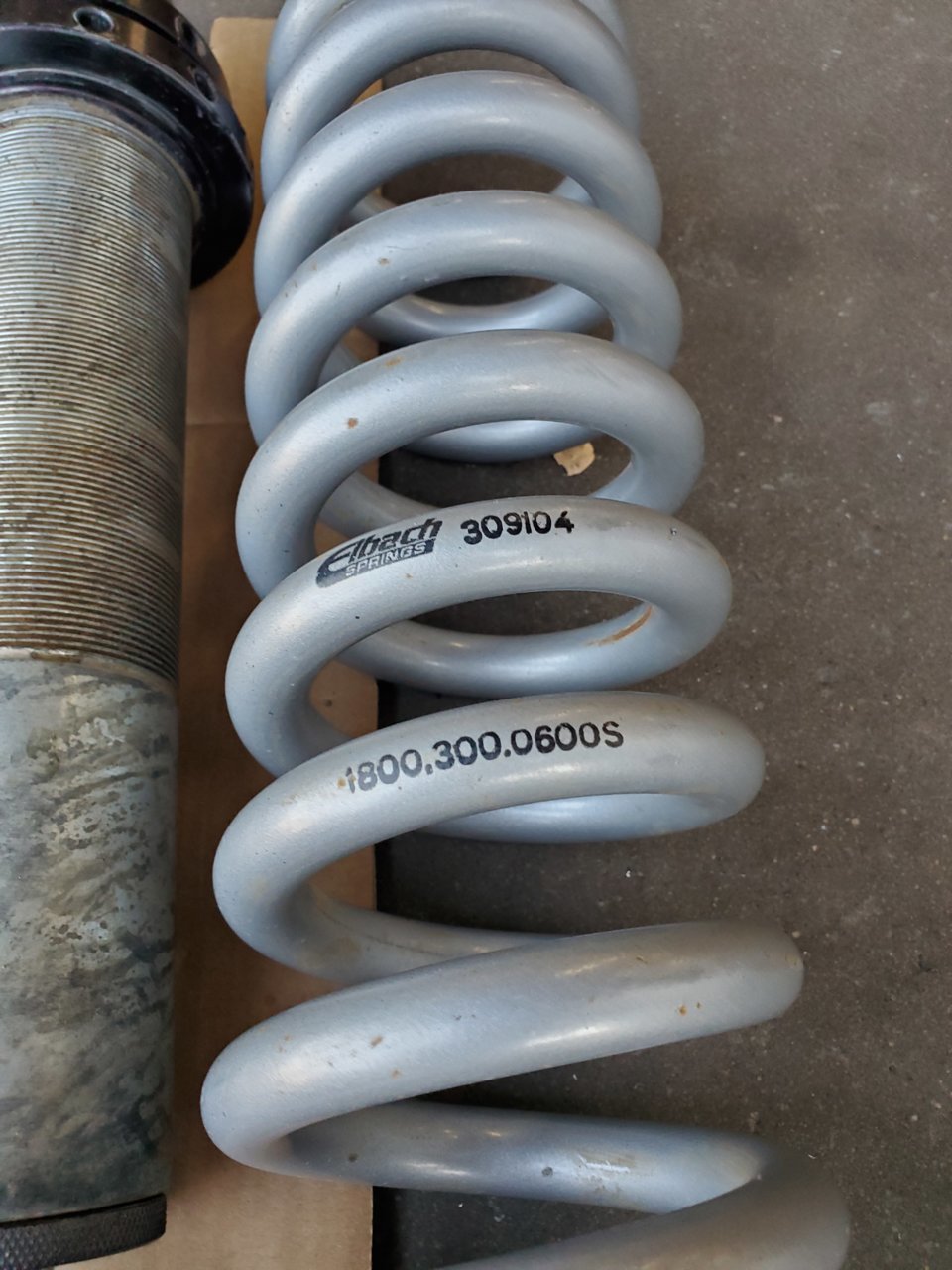

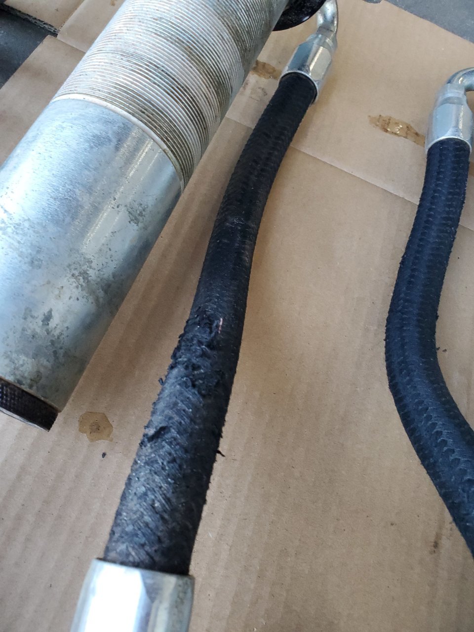

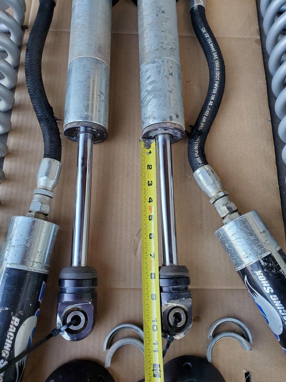

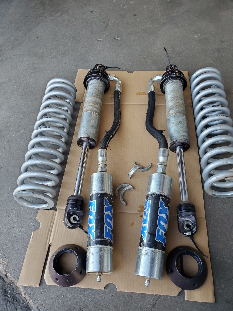

    SOLD
    Used, in working condition.

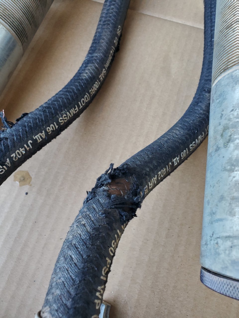

    Remote resivours, hoses lightly abraded from rubbing spring. No issues.
    18" 600lb springs.
    Light wear and tear on shocks, but overall function fine. No leaks. Valved very light, were used with bypass shocks. You may need to re valve these. New seals and oil 2 years ago, have been on the shelf for 1 year.
    14" from upper eye end of body/dust cap.
    8" stroke
    These are a little long for 1st gen technically, but will work. My current shocks are the same length. I used the Wheelers bump stop on the frame. You could also cut the coil bucket and move the mount up for max travel. Might be fine on 2nd and 3rd gen trucks as is. These have worked well for me.
    Located in Phoenix
    20201012_165812.jpg 20201012_165647.jpg 20201012_165658.jpg 20201012_165714.jpg 20201012_165737.jpg 20201012_165819.jpg 20201012_165824.jpg 20201012_165836.jpg
