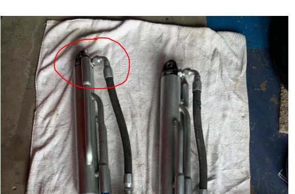

    Still looking for a set of fox 2.5 or 3.0x12 in triple bypasses.

    Shane
    2011 MGM DCSB TRD Sport 4x4
    Check My Sig.
    Specific layout?

    No specific layout. The standard right/left you can order from kartek would be fine

  12. Jan 7, 2021 at 8:56 AM
    #3452
    malburg114
    malburg114 Well-Known Member
    Dec 26, 2012
    #93766
    3,816
    Las Vegas, NV
    2001 Toyota Tacoma TRD
    Not sure I follow? These would be for the rear
  13. Jan 7, 2021 at 9:00 AM
    #3453
    desertjunkie760
    desertjunkie760 @DesertJunkie760 (IG)
    Apr 11, 2016
    #183963
    9,144
    Shane
    Check My Sig.
    Typically the resi port is on the bottom of the body to increase the compression dampening and reduce cavitation.
  14. Jan 7, 2021 at 9:34 AM
    #3454
    malburg114
    Dec 26, 2012
    #93766
    3,816
    Las Vegas, NV
    Hmm good to know. so not a normal thing to have the resi exit at the top?
  15. Jan 7, 2021 at 9:47 AM
    #3455
    cdex8357
    cdex8357 “Everybody gotta die sometime”
    Apr 7, 2018
    #249677
    1,004
    “Dex”
    H-Town
    2013 Taco OR
    Mid travel FOX 2.5 Coilovers FOX 2.5 secondary bypass FOX 12” Triple Bypass
    Get the part# and call fox, they will let you know what’s up. Sure they will tell you why they were made that way or for what application. They are helpful..

  16. Jan 7, 2021 at 10:26 AM
    #3456
    desertjunkie760
    Apr 11, 2016
    #183963
    9,144
    Shane
    Check My Sig.
    Not on a bypass.
    malburg114[QUOTED] likes this.
  17. Jan 7, 2021 at 10:32 AM
    #3457
    snowsk8air2
    snowsk8air2 how hard can it be?
    Sep 16, 2011
    #63607
    10,540
    Flagstaff, AZ
    Supercharged TX Pro
    2011 S/C and basic mods
    What he said. It’s just an older style shock. They’ve mostly all moved to bottom port Resi now

    so please school me on these. They are an older style bypass and the price seems right at 1200 for the set if I can find someone to pick them up or I’ll meet him half way. I tried reading up on the difference in location but not getting much and desertjunkie mentioned cavitation issues. They’re for a leaf spring rear. Hold out for a newer style/non remote resivor style or will these perform well for a leaf spring rear
    picture of bottom cap part number. Doesn’t return to anything on fox’s website but neither did my front bypass part numbers.
  20. Jan 8, 2021 at 3:02 PM
    #3460
    cdex8357
    Apr 7, 2018
    #249677
    1,004
    “Dex”
    H-Town
    2013 Taco OR
    you will have to call them with that number. they make shocks custom. May be able to tell if they were made for a company or to a customer Specifications. But what people said regarding where the hose is positioned looks odd.
