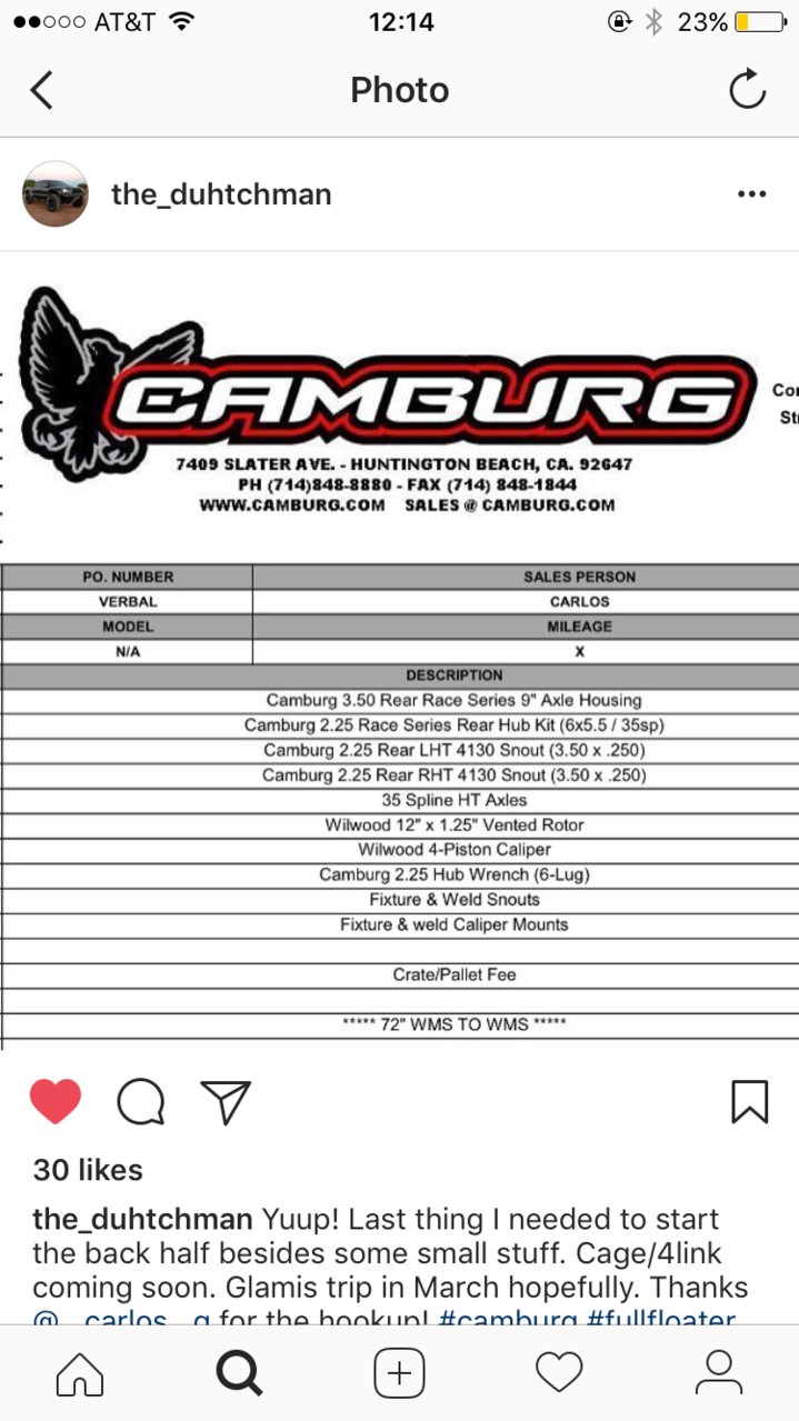

    Both the Dutchman and I are solo 4.5 kits
    And my front outside of tire to outside of tire is 95”
    And my rear from camburg is 71.5
    and this is the spec’s from the Dutchman’s old truck
    Only major difference between his and mine is he was a long bed and I have a short bed
    And he was on 37’s or 35’s I think
    And mines on 40’s
    I also remember him saying that his ended up more like equal width front and rear
    but I’m not an expert and I’m still learning
    Who knows
    Maybe I’m wrong
