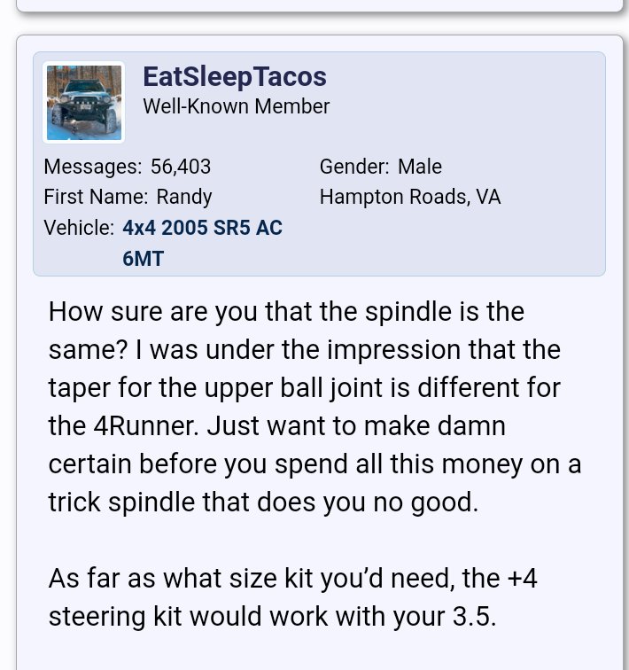

    Question, this Solo kit I’m trying to sell. I have a potential buyer asking what years of 4Runner it will work on. I’m not super familiar with 4runners, anyone remember which years it was that share the same geometry with the FJ cruiser and 2nd gen Tacoma?

    I think the spindles have a different taper for the upper Ball Joint. This is a convo I had w Randy @EatSleepTacos awhile back. Not sire if it will affect his install.

    I got that info from @y=mx+b as he is well versed on the specifics. He would be able to say for sure.

    Yes the 4runners have different upper and lower ball joints. 4runner taper shaft on the ball joint part is definitely bigger, which would mean the little mating surface in the spindle would also be different. At one point I had both tacoma and 4runner ball joints on my bench and there is a visual difference in size. Story behind that is I bought Tacoma SPCs 2nd hand and swapped ball joints for my 4runner
    Inner tie rods are also different. I think its the same dealio with the taper. Not sure if the rack threading is the same, because if it was the same, could just swap to appropriate ITR.
    Wheel bearings and CVs the same
    The UCA mount on the coil bucked is for sure the same, because the arm itself, sans UBJ, is the exact same on SPC arms. LCA mounting points I'd assume are the same, but don't have any direct experience there
    Front shocks transfer 4runner to tacoma easily
    As far as 4runner to 4runner year compatibility, 03-22 is mostly the same. Technically the 5th gen lower shocks eye is like 1mm wider or something, but you can either do a little shaving on that or spread the ears on the LCA. 14+ 4runner brakes also use larger bolts into the knuckle (I think its 17mm vs 14mm). but for the most part, they did a little ctr+c for the last 20 yrs of 4runner.

    I'm not sure whats all involved in the solo kit, but the short answer is that you need the UBJ, Spindle, OTR, and LBJ need to all be matchy matchy. If its a LT kit which probably replaces a lot of those, might be a good shot of it working
