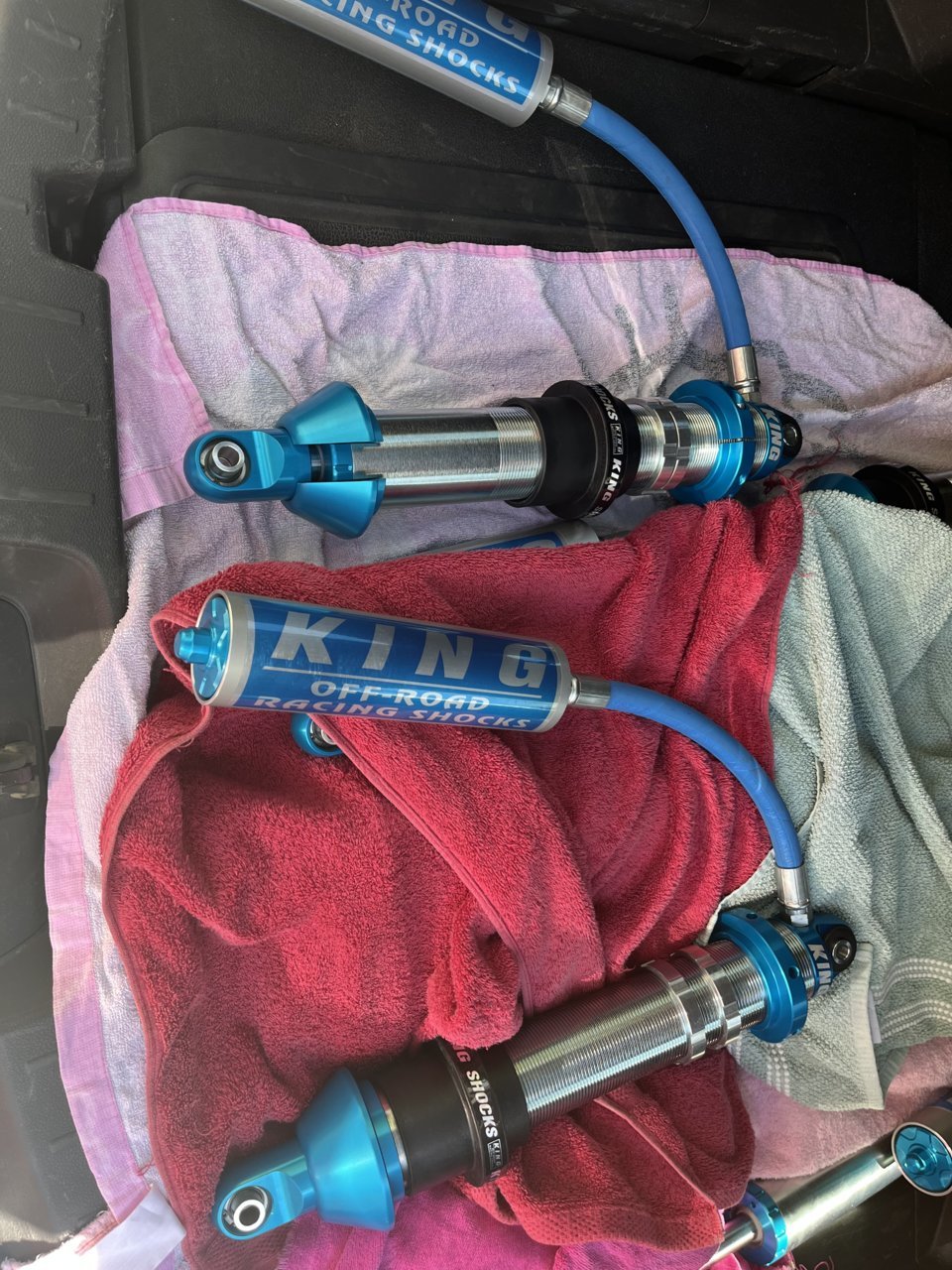

    Posible trades and cash depending on whats out there
    But cash is best
    Make me a decent offer

    What are those sliders made out of? Same or different as the blue ones?

    Yes
    I think the upgraded sliders are delrin

    Same, dif color

    I was thinking that could be a good material too. One of the guys I chat with online said the aluminum AGM ones shredded his threads.

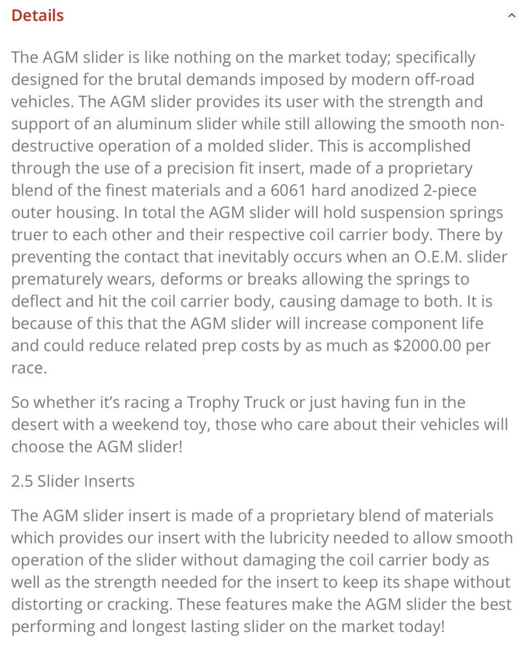

    I’ve been running the AGM sliders for a few years with no issues. They have a sleeve / liner inside the aluminum. The advantage of the AGM slider is the length and the stiffness so it does not get twisted like the oe ones

    you sure ? previously they did have two different sliders one was a two piece construction and softer which is the stock one that deforms / twists really bad and the other they called the pro slider which was one piece machined delrin

    The AGM is not aluminum on the inside it has an internal delrin sleeve.

    I ran the regular King and the Pro King and even with the stiffer pro you could see that it sat twisted vs parallel with the shock body. I have found that the longer ones like the AGM do not deflect and rub the shock body as bad
