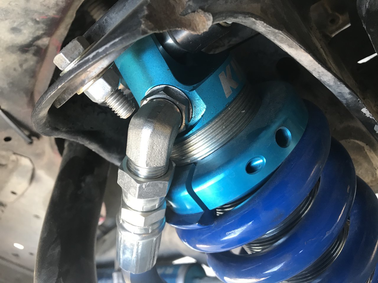

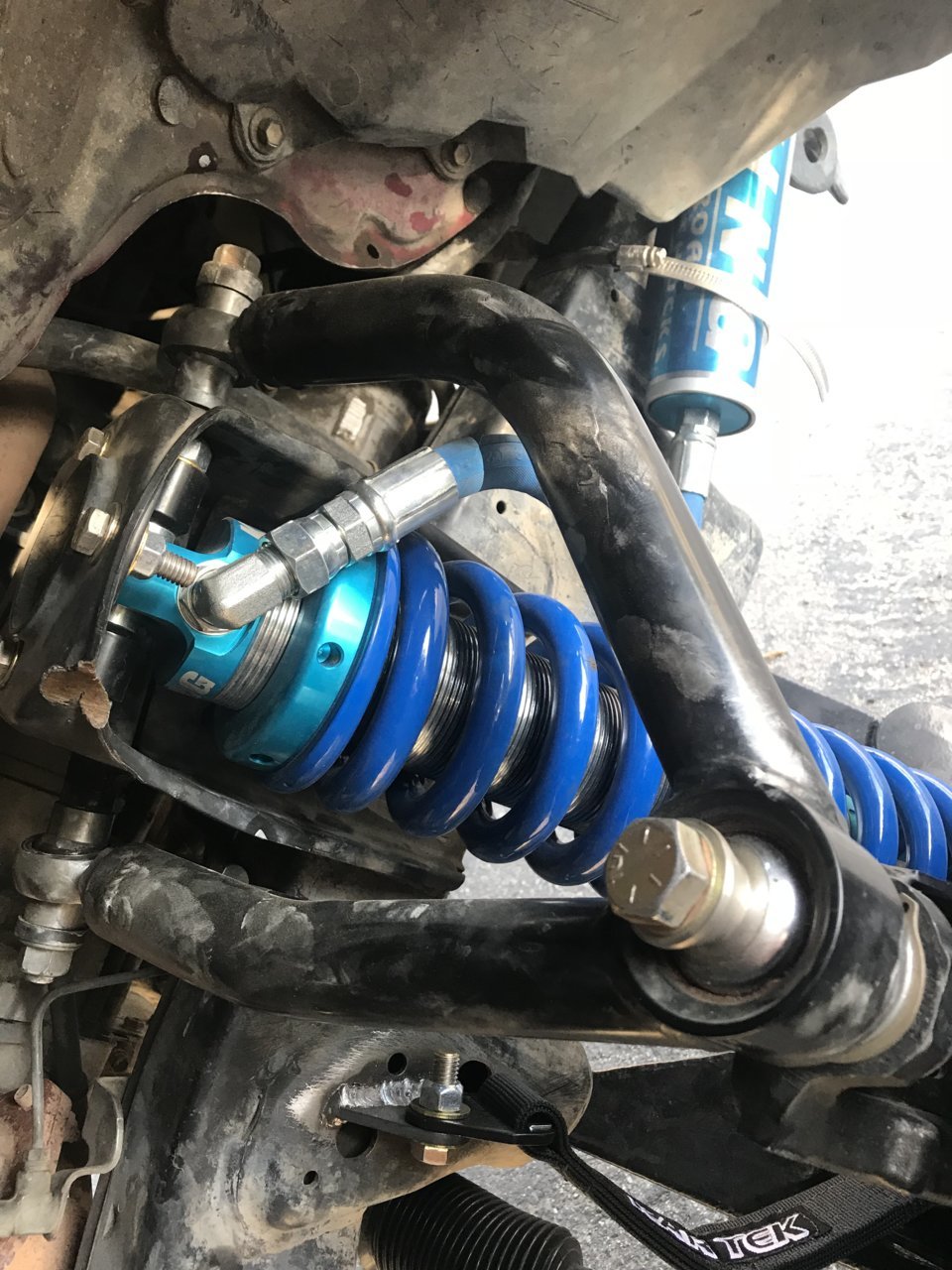

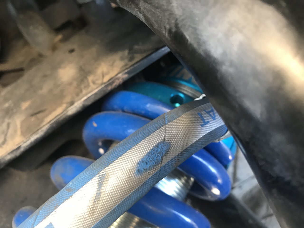

    Anyone run into this issue where the hose is a bit too long and rubs on the UCA. Thinking I can compress my coil more( I really don’t want to) cause the hose attachment hits the top hat. Suggestions? Maybe going over? Also I bought from king for my truck specifically could they have possiably got the wrong hose length?

    The hoses on my lt kit on for my 2nd gen had the same issue. This is how I solved it:
    My roommate works for Marlboro so he has a bunch of giant zip ties for securing signs. I used one attached to the uca bolt sleeve, a few regular zip ties and some shower pan liner even though they didn't rub once they were held in place with the zip ties - I just didn't want them possibly rubbing on the zip ties. I'm pretty sure some decent zip ties would get the job done even if they aren't the industrial strength ones like this one.

    Try twisting the resiviour, this will make the hose curl a little more, then clamp it down. Or change/adjust resiviour mount locaton.

    What are you resi’s mounted with? Did you try adjusting to get a better hose angle?
