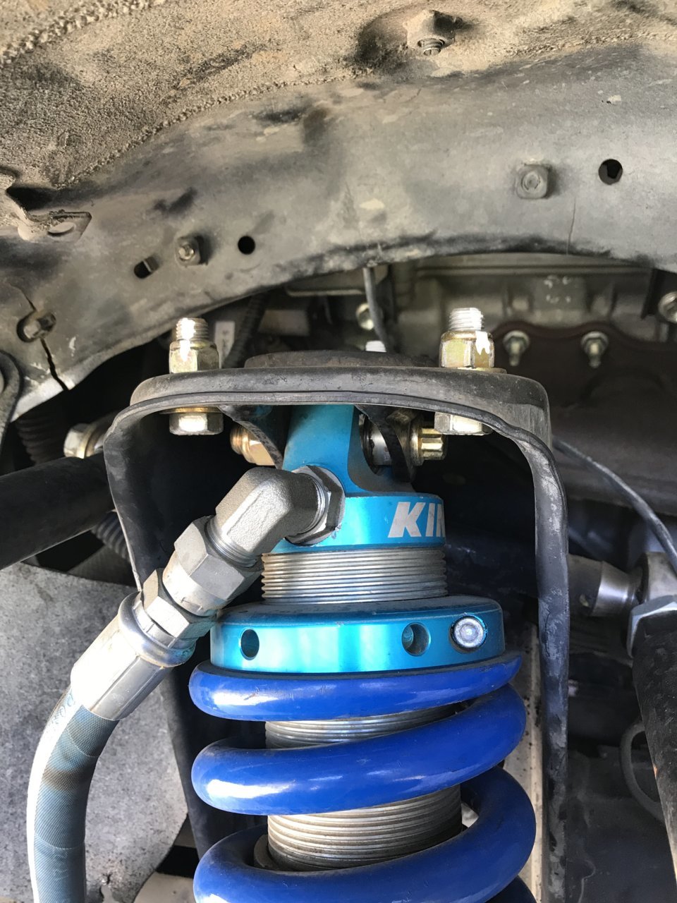

    I believe this is what hea talking about, as you can see the pressure point is in the center hence the rounded hat caused by real off roadding

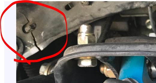

    whats going on here

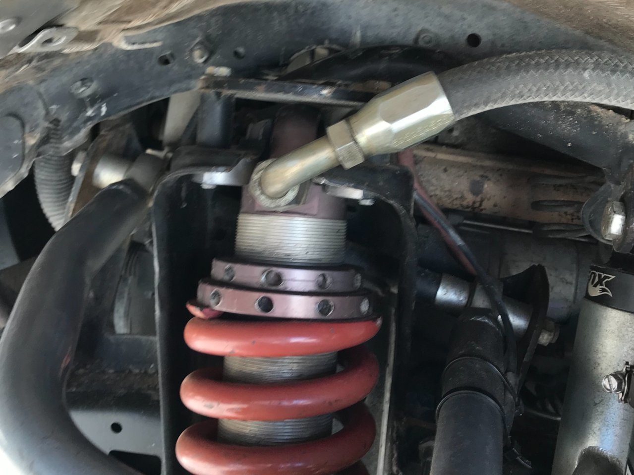

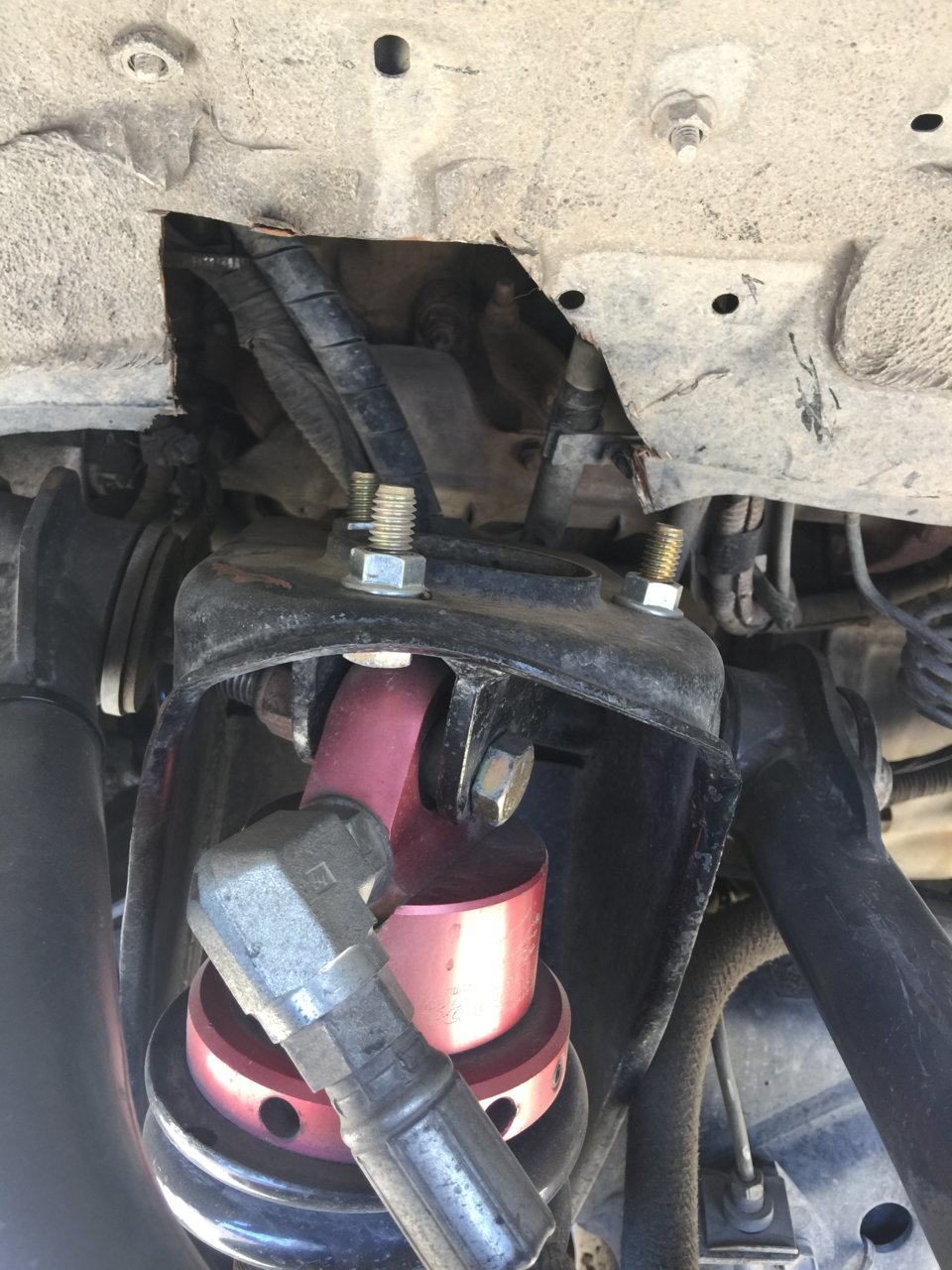

    This is the "bevel" I'm talking about. Are you 2wd? With 4x4, Fox and TC requires a tall lower shock eyelet and moves the upper shock mount up (reversing or flipping the aluminum mount over) and notching the coil bucket for the shock hose. The two pictured above are King and SAW shocks. Not sure if 4x4. I want to eliminate this aluminum mount and use the 1/2" upper shock bolt to remove the shock, not the 3-3/8" bolts to the coil bucket.

    Just breaking stuff, flimsy core support can’t handle the weight of my battery I guess, I’m gunna move it to the rear soon though
