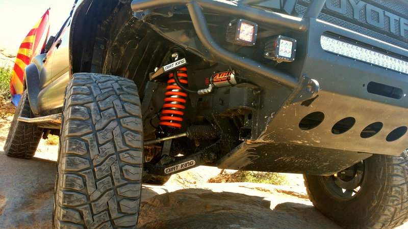

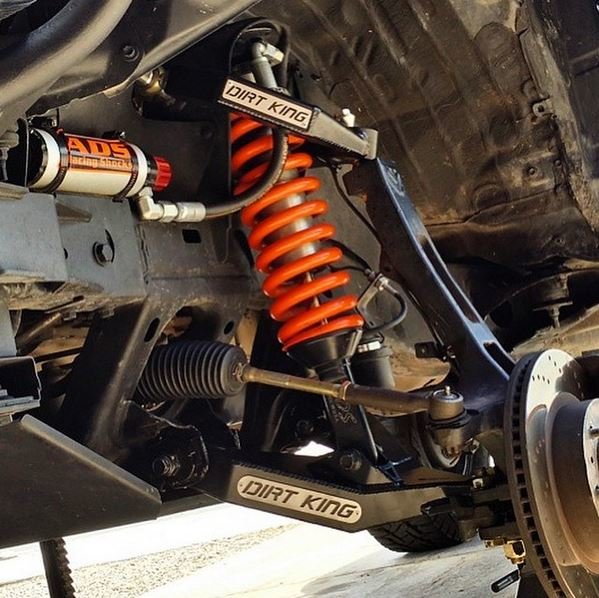

    We have had a few of our customer's run our 3.5 long travel kit with lift spindles. I do not have any pictures with our 3.5 LT kit and Maxtracs but do have some with our performance OE width lowers and uppers. The lower arm mounts the same as our 3.5 long travel kit.05TacomaLCA-2.jpg 18381647765_a2f2f48c82_h.jpg

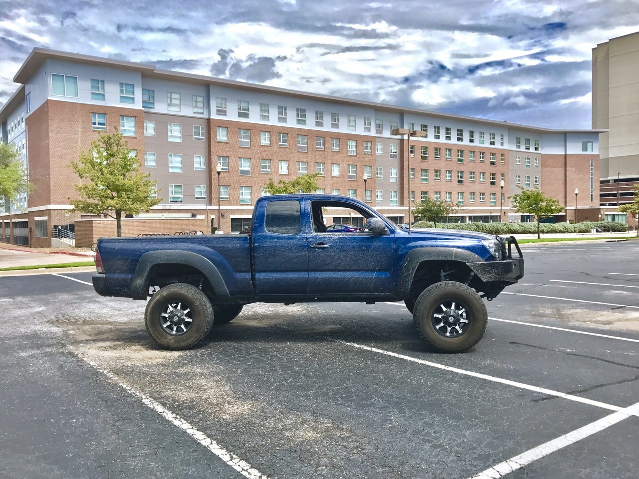

    Here's my Total Chaos race kit with Maxtracs

    That looks good!

    Thanks, it went together suprisingly without a hitch. She's a big prerunner with those extra 4" in the front

    Just gotta play with the ride height on the coilovers

    In that picture it looks super nose high for some reason. But if you look at the bed compared to the bike racks behind it and the roof to the windows it's pretty level. And they're at the preload icon sends them at and recommends

    Did you tell them you were running a lift with spindle with?

    No. I used to have 3" spacers with the spindles in the front and 3.5" lift in the rear and was nose up. Now it's got 2" lift from the coilovers and 4" spindles, but my bumper sags it down to about 5.5 in the front and 3.5 in the rear. I'm getting a different bumper eventually and the coilovers will probably settle a bit
