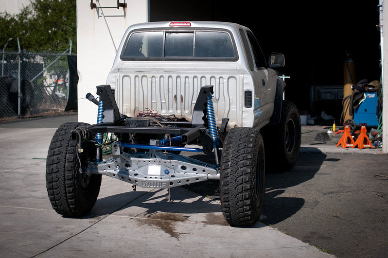

    I had a blast building mine if you can link the rear some day it's totally worth it here is some inspiration.
    It's a 3 link with a pan hard so the gas tank can stay in the stock location. 16" in the rear and 14" of vertical travel in the front and 51" of articulation.
  15. Sep 25, 2015 at 2:56 PM

    That is nice!!!

    Thanks and it's been my DD for the past 2 and a half years!
