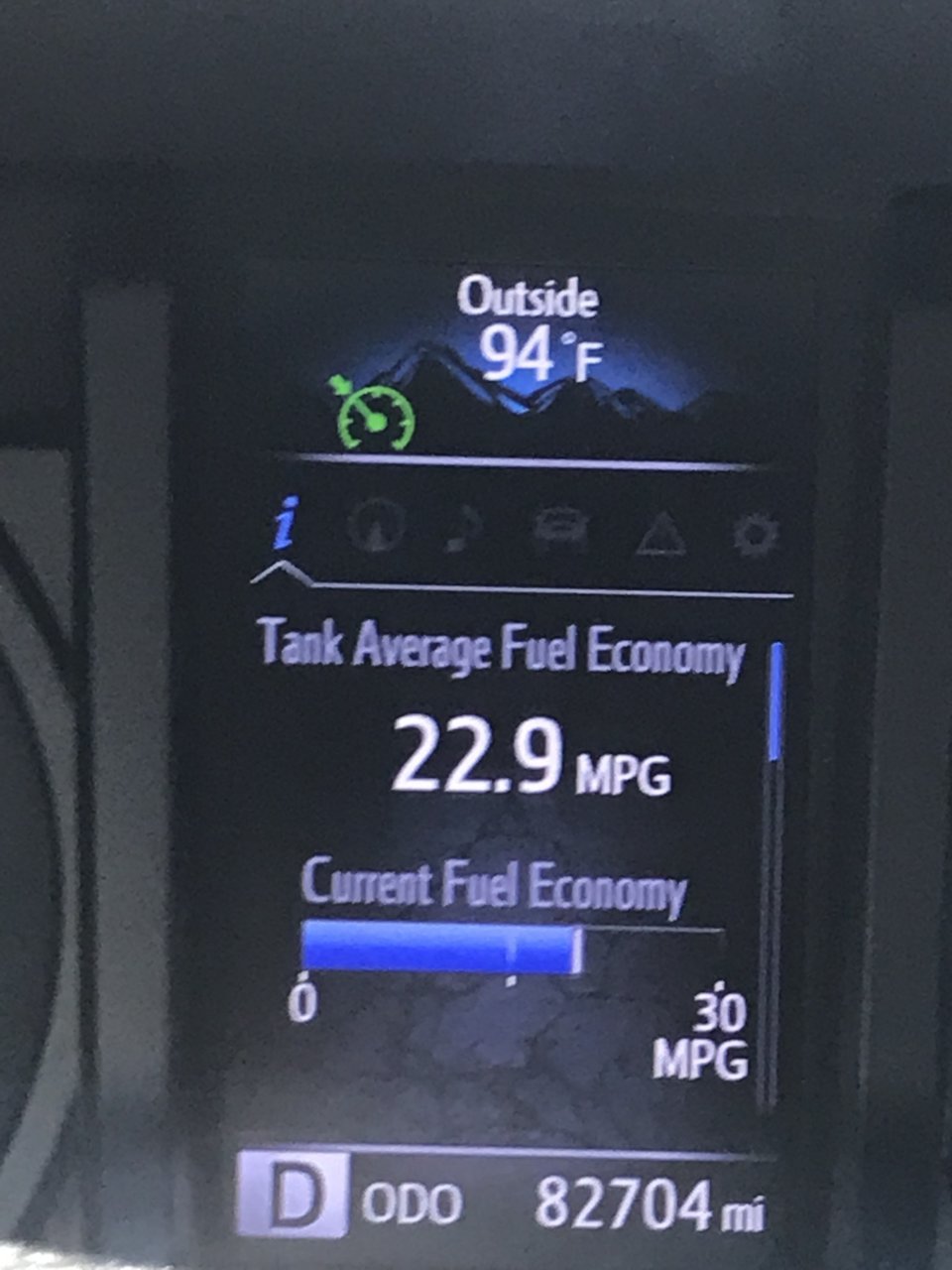

    I’m running General ATX (E) set at 38lbs cold, getting 21 to 23 mpg. 101 miles round trip daily commute but, that’s on relatively flat terrain and really good ankle valve control.
    Oh and size is 265/75/16

    And getting full tread patch contact? I can get better mileage by pumping in more air, but what about tread contact?
  15. Sep 22, 2019 at 12:14 PM
    You did what?
    You did what? Well-Known Member
    May 30, 2018
    #254934
    52
    James
    Ar.
    ‘16 TRD Off-Road
    Yes sir, tread wear is even side to side. I’ve got around 33k on tires started with 16/32nds and was just rotated (done every 5k) and they gauged at 13/32nds, outer/middle/inside gauge points.
