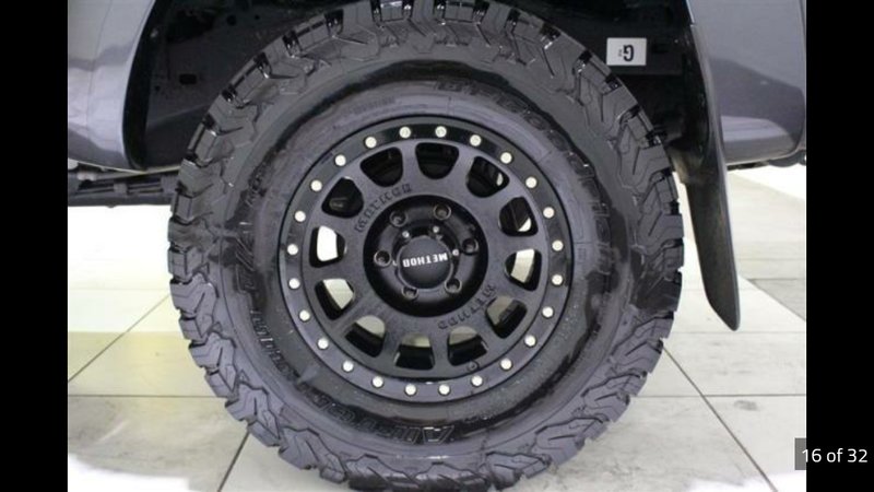

    Don't bash me too hard but I'm new to the different tire size game. My truck has Method wheels with LT265/75r16 and my spare is the stock P265/70r16. I plan to buy a new rear bumper.
    My question is should I buy a new rim and tire to match my current set on the truck or will the spare work in a pinch? Also if I have to buy a new one to match will it mount where the factory spare is ok or do I need to fork over more money for a swing gate?
