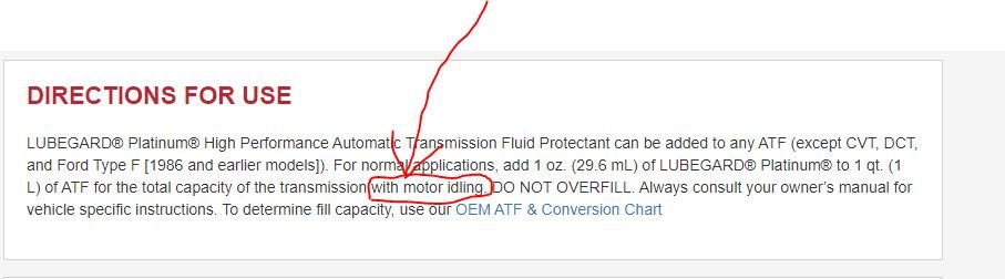

    Uh it's actually very easy to do with a funnel and tubing.
    And here's the directions right from "the horse's mouth" as they say...
