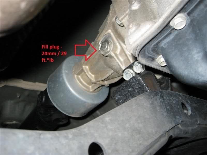

    Can you put Lubegard synthetic ATF protectant in a 2007 Toyota Tocoma Prerunner SR-5 and where, how? V-6

    Yes. There’s a fill plug near the top towards the rear of the transmission. What are you trying to fix? Drain and fill with Maxlife or Amsoil blue cap atf.

    I don’t want to change the fluid I just want to know if I can add the Lubegard to keep it from jumping.To see if it will help.But I don’t know where and how to put it in
