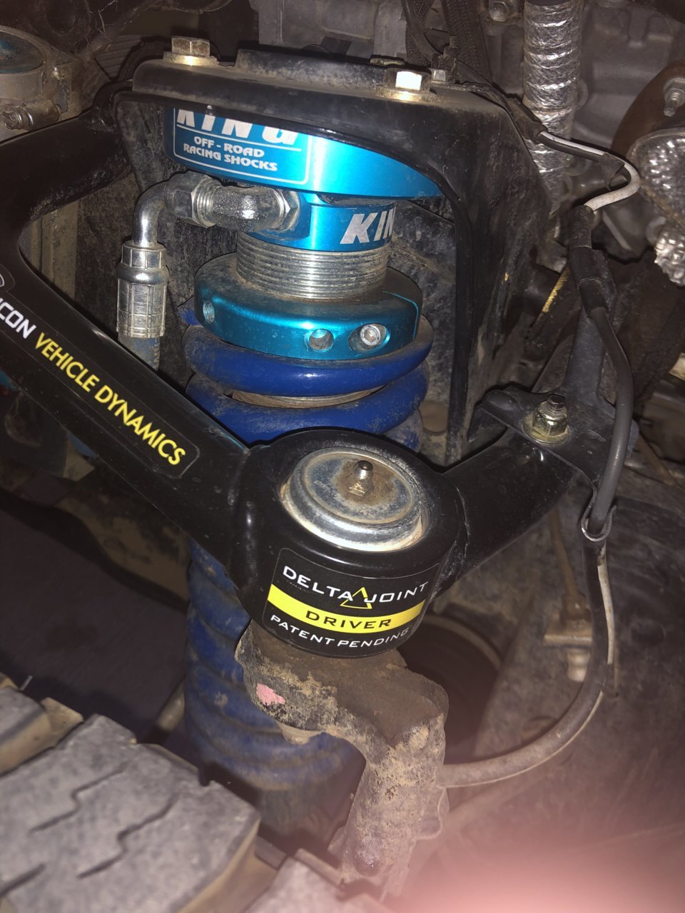

    Got it. Thank you for that! And I think I need a needle tip for the delta join. Is that correct?

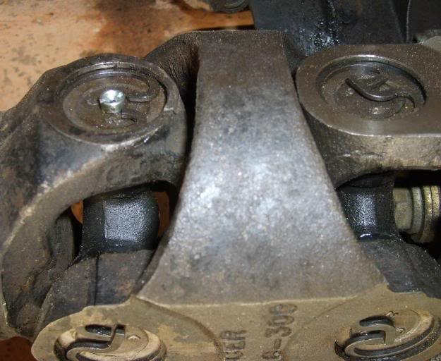

    Your picture shows a normal zerk fitting on the delta joint. :notsure:
    Needle tip couplers are meant for flush-mount fittings as seen on some aftermarket U-joints, e.g.:

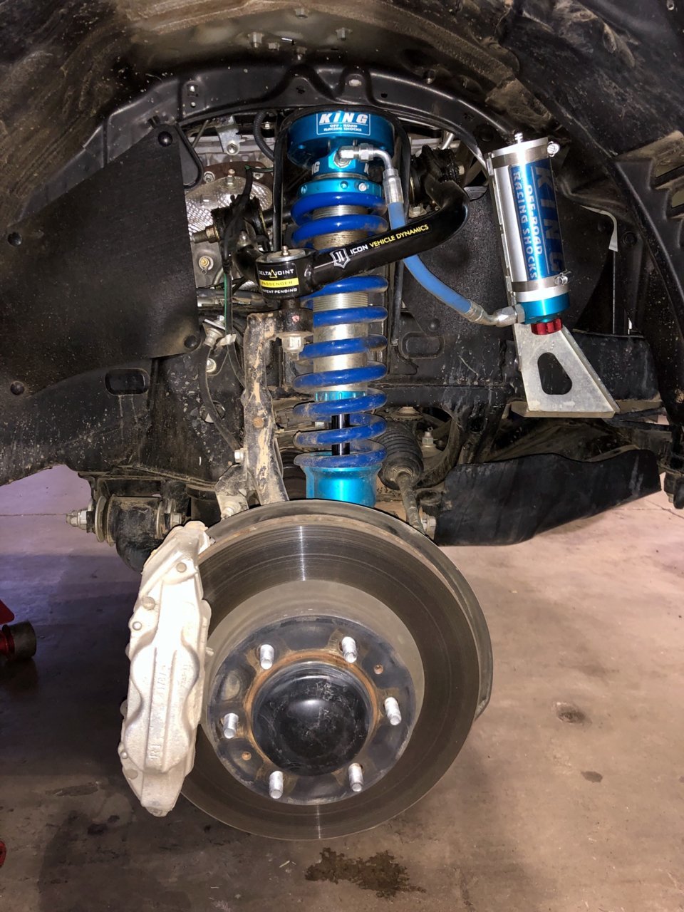

    This is what the fitting looks like

    That's a normal grease zerk
