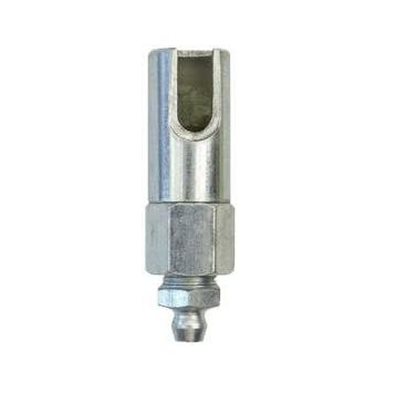

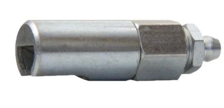

    Just greased mine... other than having to turn the front driveshaft the rest of the zerks were accessible after parking in the garage the night before. Was barely able get on the pita zerk up front... even harder getting the coupler off. Got this for next time. Hoping it works out better than having to use a needle attachment.

    I just might buy one of those some day -- sure looks handy. I've been getting by with a needle attachment for more years than most of you guys have been alive.
    Nothing wrong with one more little thing to make life just a bit easier.

    I just picked up one of the locking grease nozzles as well. Getting a non locking one to stay on the zerk is a PITA.

    I had to get one of these for that front zerk and even then I had to shave the round side of the end a bit more so that it would fit.

    I hate Amazon so I went to locknlube.com company website. I got the extended adaptor and a can of Kroil.
