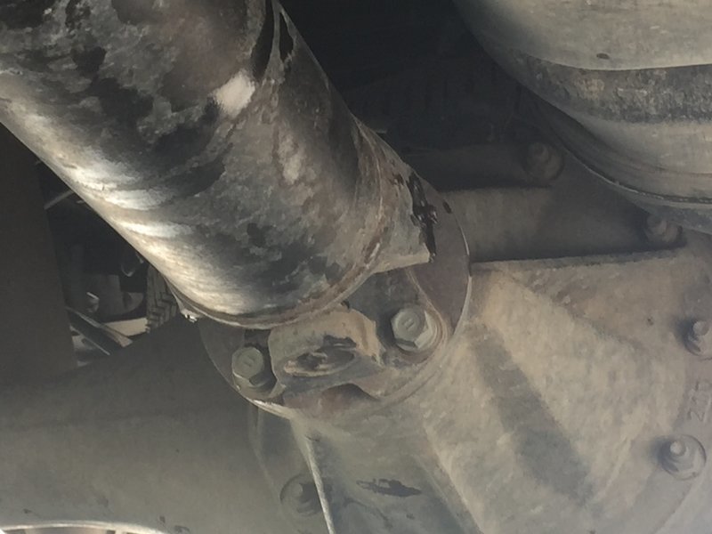

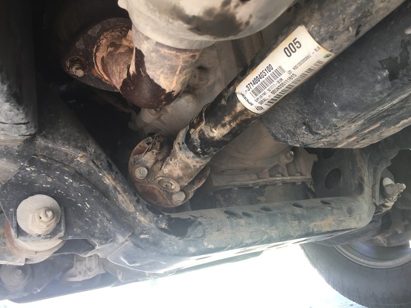

    I do all my own maintenance, but I have been ignoring the "lubricate the propeller shaft and re-torque bolts" recommendation in the maintenance log because I didn't know what a "propeller" shaft was. At 45,000 miles, I decided I better find out. Thanks to this forum, I learned it is simply the drive shaft and U-joints. Glad I checked here. All 5 joints took quite a few pumps for the grease gun before they were filled. I used Lucas Red and Tacky #2 grease.
    The three zerk fittings were easy to find on the rear propeller shaft joints. Toyota was even nice enough to line them all up, so when one is pointing down, the others do too. The two on the front drive shaft (for 4x4's), were harder to find and grease. They are sort of hidden inside the U-joint. Really hard to get the grease gun fitting over the zerk and try to screw it tight. Almost impossible with my type of grease gun, but somehow I managed. I wonder if there are other types of grease guns which can snap over the zerk fitting without needing to screw the end tight.
    Here's some pictures in case others might find them useful:
    Rear U-joint zerk fitting with grease gun attached:
    Better view of the fitting:
    here's the one near the middle of the drive shaft:
    and the one near the transfer case:

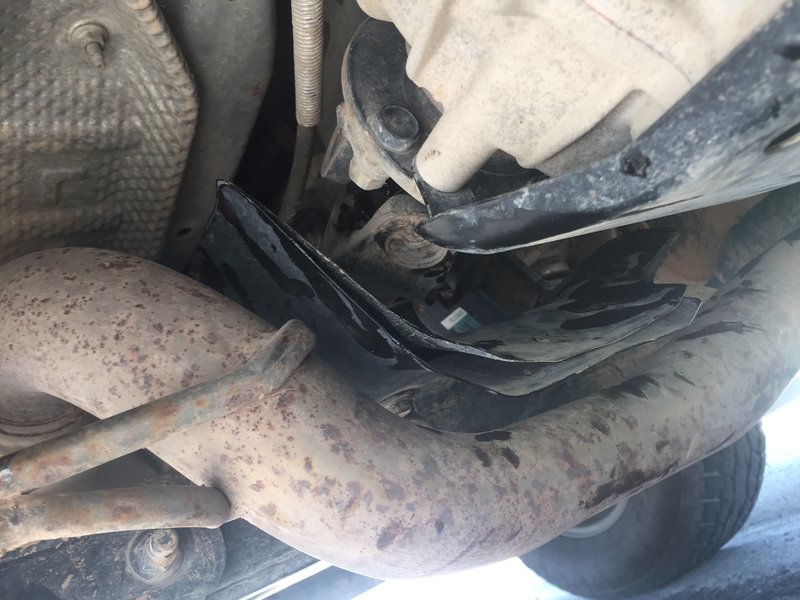

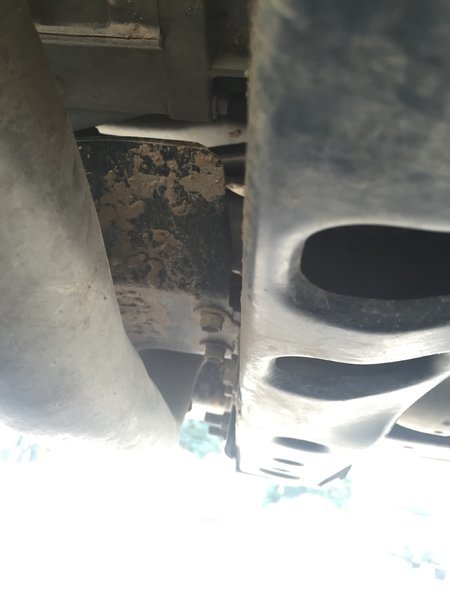

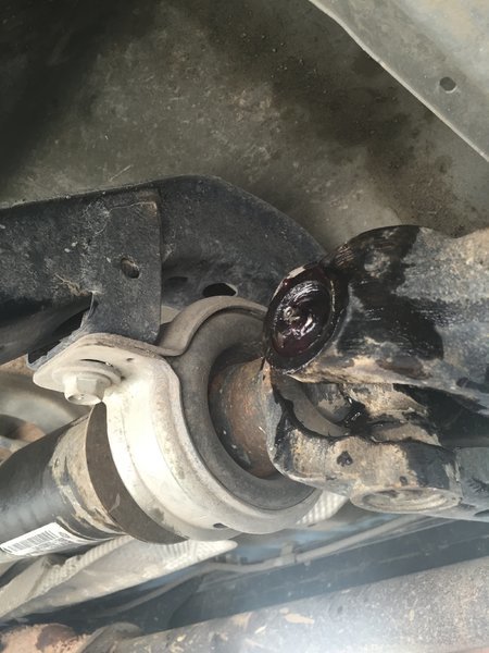

    Can someone confirm the lube locations for 2013+ 4x4? I have read that there are 5, I'm assuming one at each joint. 3 on the rear drive shaft, 2 on the front. Is this correct?
    Thanks
  20. Aug 1, 2016 at 2:45 PM
    #180
    Ihatetacomas
    Ihatetacomas Because tacomas hate me
    Aug 18, 2014
    #136475
    988
    Dylan
    Elko NV
    '12 White LB TRD Sport
    Used @ 23,283 Volant Intake (w/ scoop)(removed August 2016), BAKFlip G2 Tonneau Cover, (drain tube mod), Pop & Lock Tailgate Lock, Stampede Vigilante Premium VP Series Hood Protector, 5lb Extinguisher, Shovel & Axe mounted in bed, Shok Industries Sound Deadener, Mercury: (K62, MGR-1200, MGR-495) Triton 8" Subs, Custom-Made: Sub Box, Speaker Templates, Vapor Barrier, All-Pro Bumper w/Kickouts, hidden trailer hitch, wooden cup-holder Misc: Knukonceptz RCA, speaker, and power wires, Big 3 Upgrade, a very full Husky technician tool box
    I can confirm all 5 for my 2012
