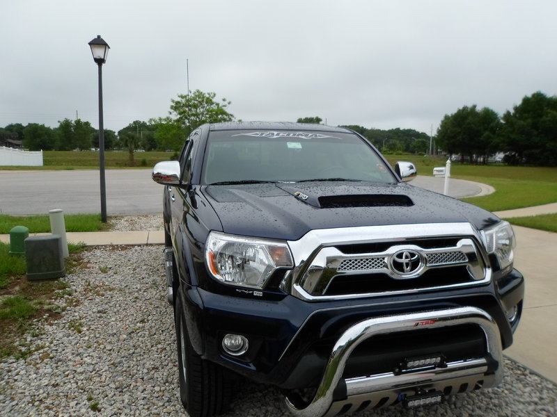

    Your truck is a duplicate of mine but I don't have the front crash bar or window decal. It's a beauty.
