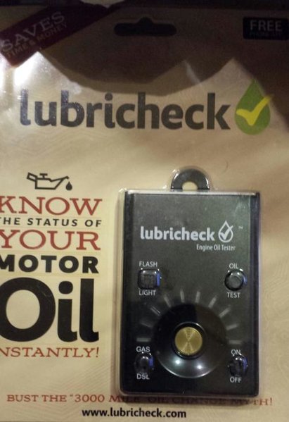

    Aaaand.... it's here.
    I'll check it tomorrow on:
    2004 Rav4 that just had the maint light pop on a few days ago.
    136k, Mobil-1 5w30
    2008 Tacoma with 100k, Mobil-1 5w20, about 4300 on this change.

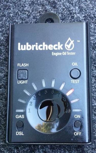

    Marginally worthless.
    Because of the turns in the dipstck tube, it was difficult to fill the sample spot to the line.
    I could not get ANY oil to drip off of the dipstick on the Rav, so it was impossible to get a reading.
    It took at least 10 trips back to the dipstick tube to get what I believed to be enough from the Tacoma, but I don't trust the result and really don't know if I had enough in there... read on....
    Here's the Tacoma's reading. Mobil-1 5w20 with about 4300 miles on it. It's got 700 left before it's due for a change, and by all rights, the oil SHOULD be good for another 5700.....

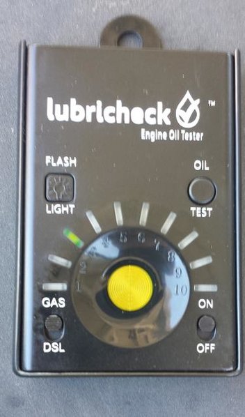

    Okay, maybe it's out of calibration. What does it show for brand new 5w30. Grabbed the half-quart of M1 5w30 left from the last time I changed the oil in the Rav...
    Okay... #3, 3-7 is "good oil" so at least it's not worse than 7... but I would have expected brand new oil to have been a 1.

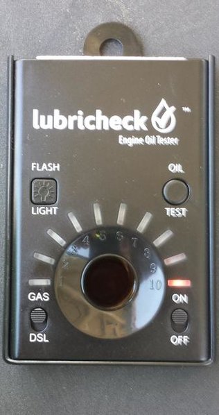

    Ahh... here's a 5qt jug that I haven't taken to Vatozone to dump yet. I have no idea if this is from the Rav or the Tacoma, I do know that this oil has between 7500 and 10,000 miles on it because I went over on the last change for the Taco, and my wife is not good about telling me when her maint light comes on. It gets noticed when I'm riding with her.
    Okay... that looks more like it and more what I would expect from an oil that's been running for 7500-10k.
    But... Like I said, the problem is getting a decently sized sample to test. I have the Fumoto, so I could easily crack the valve and drain a few drops of oil to perform the test, and I might do that to see if anything shows differently, but I only have a Sure-Drain on the Rav, so it would be difficult to pull a small sample.
    As far as I'm concerned, it's good for verifying whether or not I should have changed the oil at 5k (and from the last picture, I would imagine that it would read "8" all the way from 5k to 10k).
    Without a suction device to draw oil out of the dipstick tube, there's just no reliable way to get enough oil out of either of my vehicles to sample.
    When I change the oil in the Taco in a few weeks, if the Lubricheck shows the same as above, I'm going to send a sample to Blackstone just to be on the safe side.
    The oil does seem quite dark compared to what I'm used to seeing at this mileage.

    BTW: Yes, the 2nd picture was shopped.
    The LEDs are flashing and I was not able to capture the green LED when it was on. I got lucky on the two red indications.
