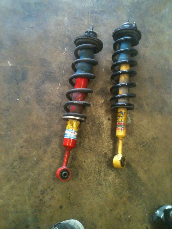

    In the hunt for the noise which was the ball joints I took my coil over assembly off and had a chance to compare the TRD bilsteins to the regular toyota ones. picture shows the difference in diameter clearly.

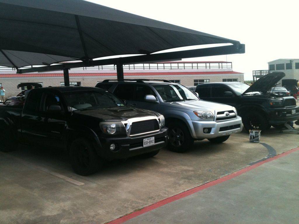

    Then I went off to race at MSRH and had a blast.
    Calm before the storm was the thought in my head when I snapped this picture, however, I did not meant it literally.
    As it turned out it rained on race morning. Still lucky for us it turned out to be a nice day for racing.

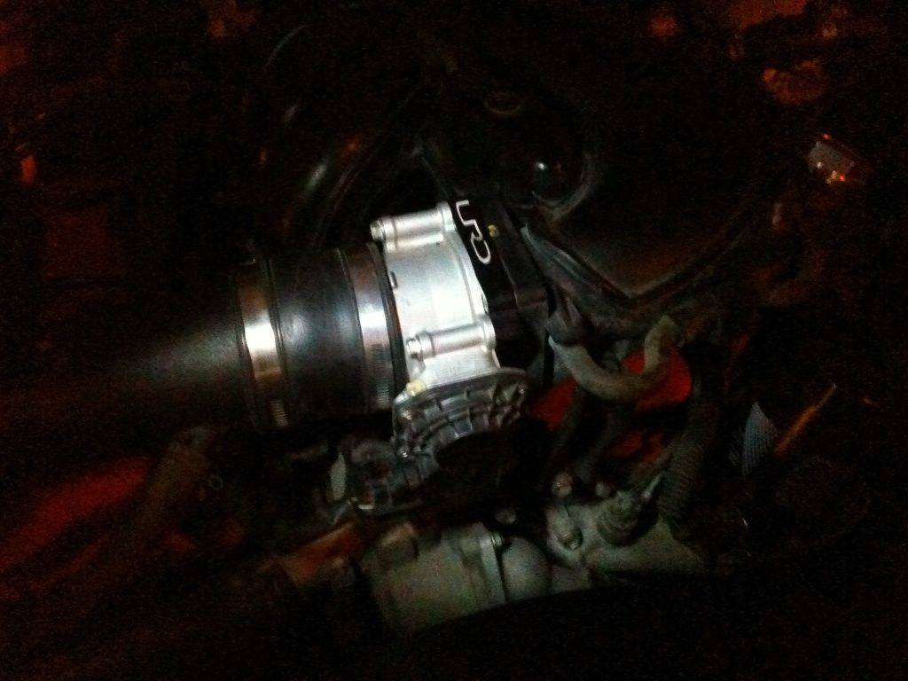

    Latest mod, 70mm dual vvti 1gr throttle body.

    its the throttle body from the 5th gen 4runner and newer fj's. Just get one of those and the adapter from urd and install it. very simple.

    It can work on the tacoma with no issues. Benefits, more air in with less resistance at wot.

    a little more power, no difference in mpg.
