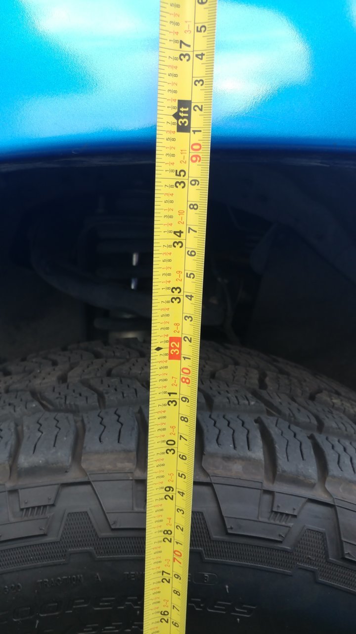

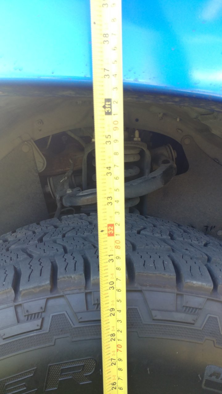

  14. Jun 16, 2020 at 3:56 PM
    #514
    Lucario Runner
    Lucario Runner [OP] Resident Truck/SUV racer
    Jun 29, 2011
    #59067
    7,073
    Robert
    San Antonio, TX or nearest race track
    06 Toyota 4Runner
    AFE stage II intake, APR X1, URD 70mm Throttle Valve (ported and knife edged), NST intake manifold spacer, URD spec U headers, Denso IKH20, URD fuel pump, APR fuel rail, URD Y pipe, URD spec u catback, lightweight water pump pulley, Greddy sandwich cooler plate, Earls oil cooler, IPT valve body, FJ TRD shocks, Cusco front and rear sway bars, Energy Suspension rear track rod bushings and rear link bushings, Carbotech pads, Stoptech ss brake lines, Stoptech slotted rotors, Motul 600 rbf, Limited Grill, Painted hatch cover by me, Painted valve covers by me, Cobra CB, TRD rad and oil cap, Escort 8500, Autometer oil psi and temp gauges, AEM wideband afr gauge, Flexpod, Pioneer 400w speakers.
    Just documenting the height deference for now.
    Driver
    Passenger
  15. Jun 16, 2020 at 6:12 PM
    #515
    loginfailed
    loginfailed Well-Known Member
    Aug 29, 2016
    #195923
    5,156
    Dwayne
    Houston, TX
    2014 DCSB 4WD
    Whatcha about to do?
    EDIT you got that gangsta lean going on. I wonder how different mine is I cant remember if I ever measured.
  16. Jun 16, 2020 at 7:06 PM
    #516
    Lucario Runner
    Jun 29, 2011
    #59067
    7,073
    Robert
    06 Toyota 4Runner
    Coming up with ideas to correct the lean. The easiest in my mind is a 1/4 spacer. Cheapest would be to move the driver side spring up one notch, not a fan of that one though. This will be addressed when I overhaul the front end.
  17. Jun 16, 2020 at 9:49 PM
    #517
    nudavinci64
    nudavinci64 Robert @ Holy Horsepower
    Nov 14, 2013
    #116533
    9,881
    Robert
    San Mateo/Cayucos, CA
    13 S/C TRD OffRoad 4x4
    Boosted Money Pit....
    I would go the notch over the spacer. I had some friends run the spacer so they could avoid the adjustment and ended up returning the spacer and just added a thread or two on the side that needed it. Assuming its the drivers side.
