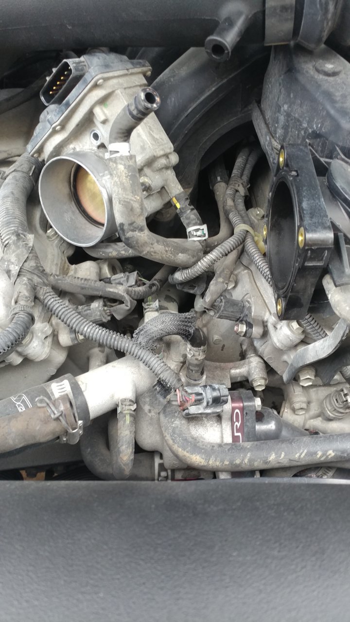

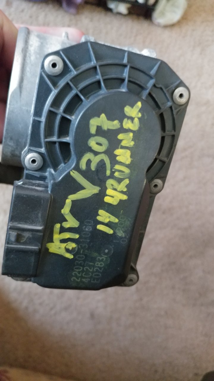

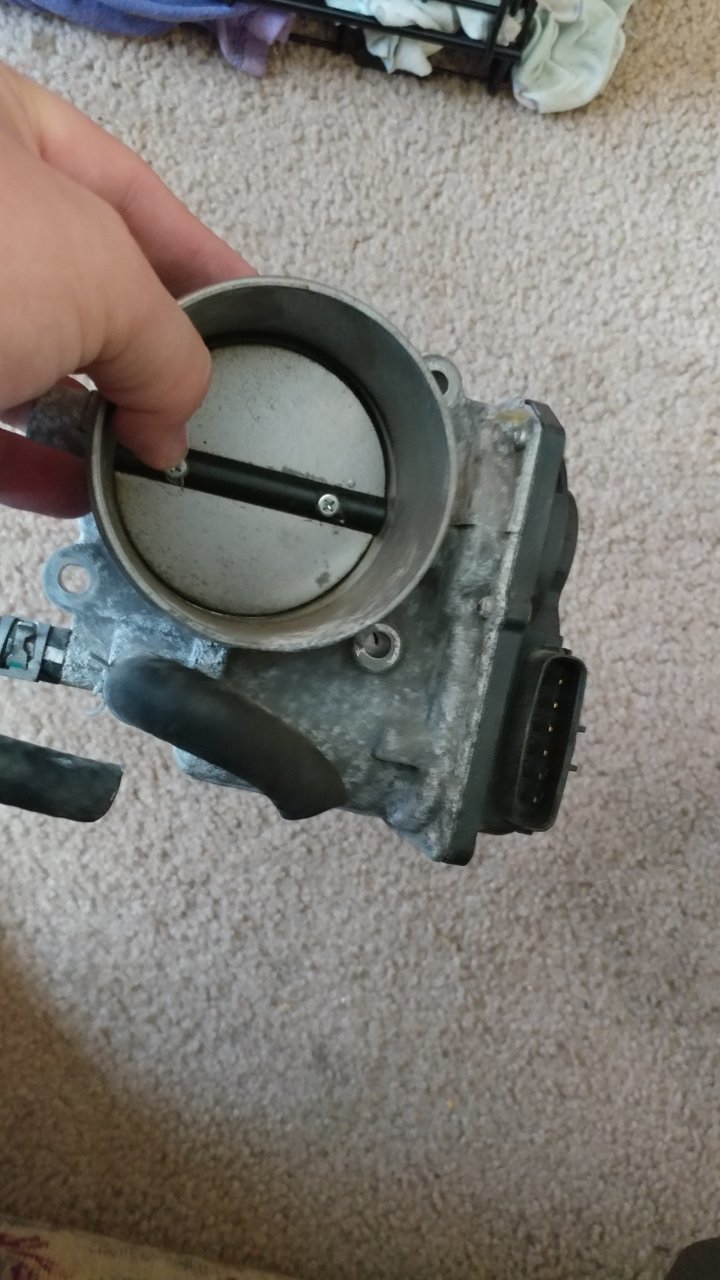

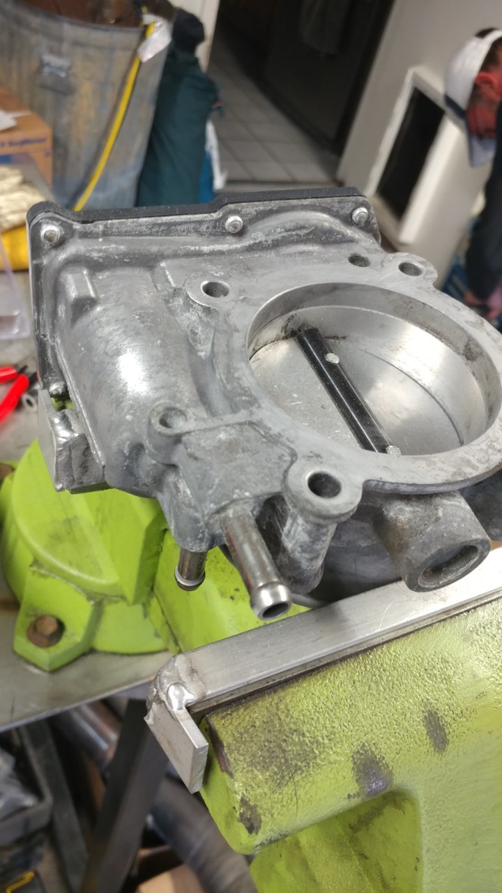

    70mm throttle body off a 14 4runner. Dont know wherr its been, under an ocean I guess. Will clean it up and bolt it on when the adaptor arrives next week. Also planning on buying a walbro 255 pump and install a fst fuel filter.

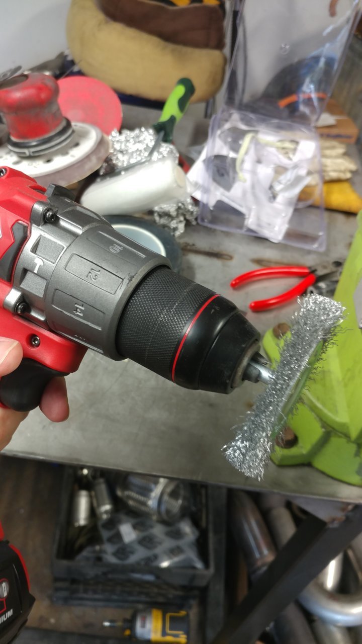

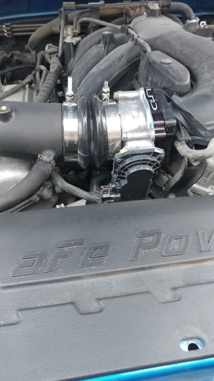

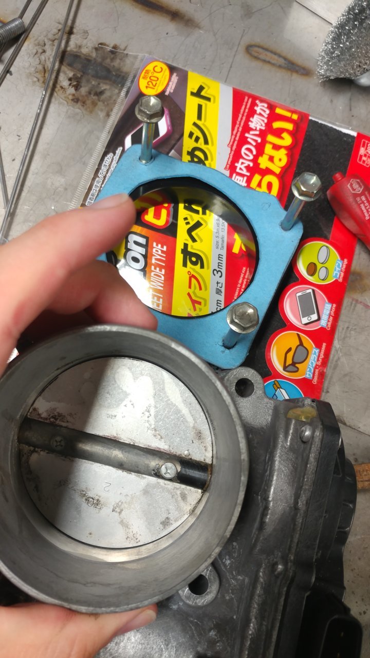

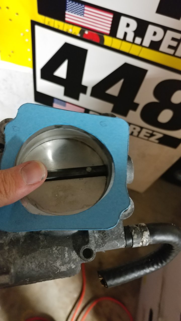

    So I made two gaskets for the 70mm throttle bodies since there is no place for a stock gasket on the urd adaptor. Kinda roadkilled the holes for the bolts since I lost my exacto knife. This is for the Tacoma. I'll try and finish up the install tomorrow.

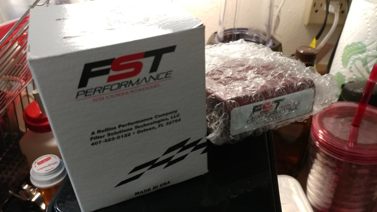

    So this is part of my new fuel system, better filtration than stock as well as much easier to maintain, screw on-screw off, still awaiting 6an ptfe hose to arrive as well as other mixed fittings. Last thing I would need to order is a fuel pump. I plan on installing that when I am able to get free time.

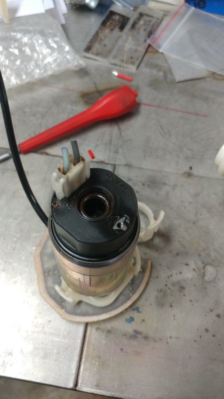

    Decided to go with the aem e85 fuel pump.

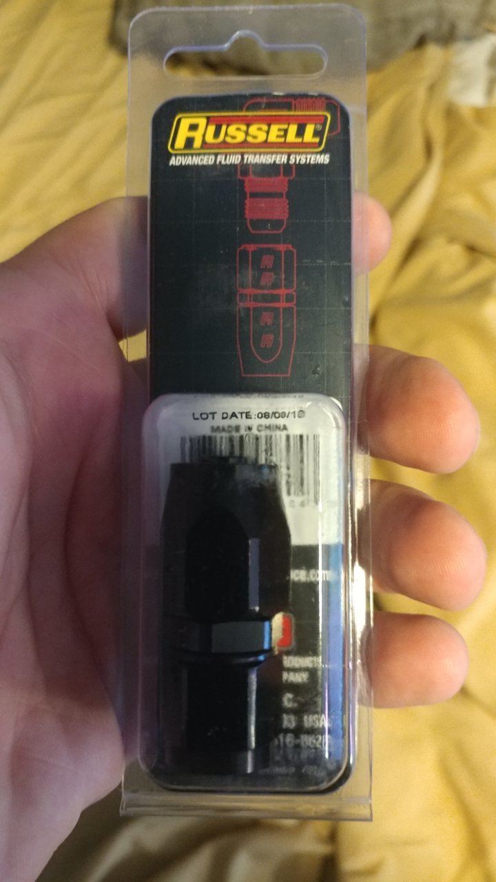

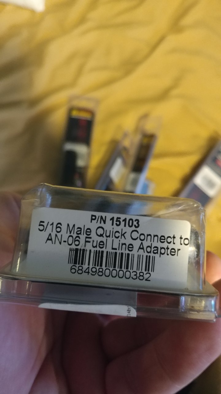

    You're using quality parts, for sure. I recently did this upgrade- I returned the quick connect push-ons for the Russell 641303 & 644113 because I was reading they blow off. I test fit and gave a very slight pull on the fittings and sure enough they both popped right off. I also heeded to use the ATL CFD-402 Fuel Tube. You're going with a much nicer filter, I'm just using Motorcraft FG-1114 with Aeromotive 12701 clamp.

    Thanks man, my plan was to implement quick disconnects too, however I figured to avoid the need to use them if I had a spin off fuel filter. So it works out to make life easier.

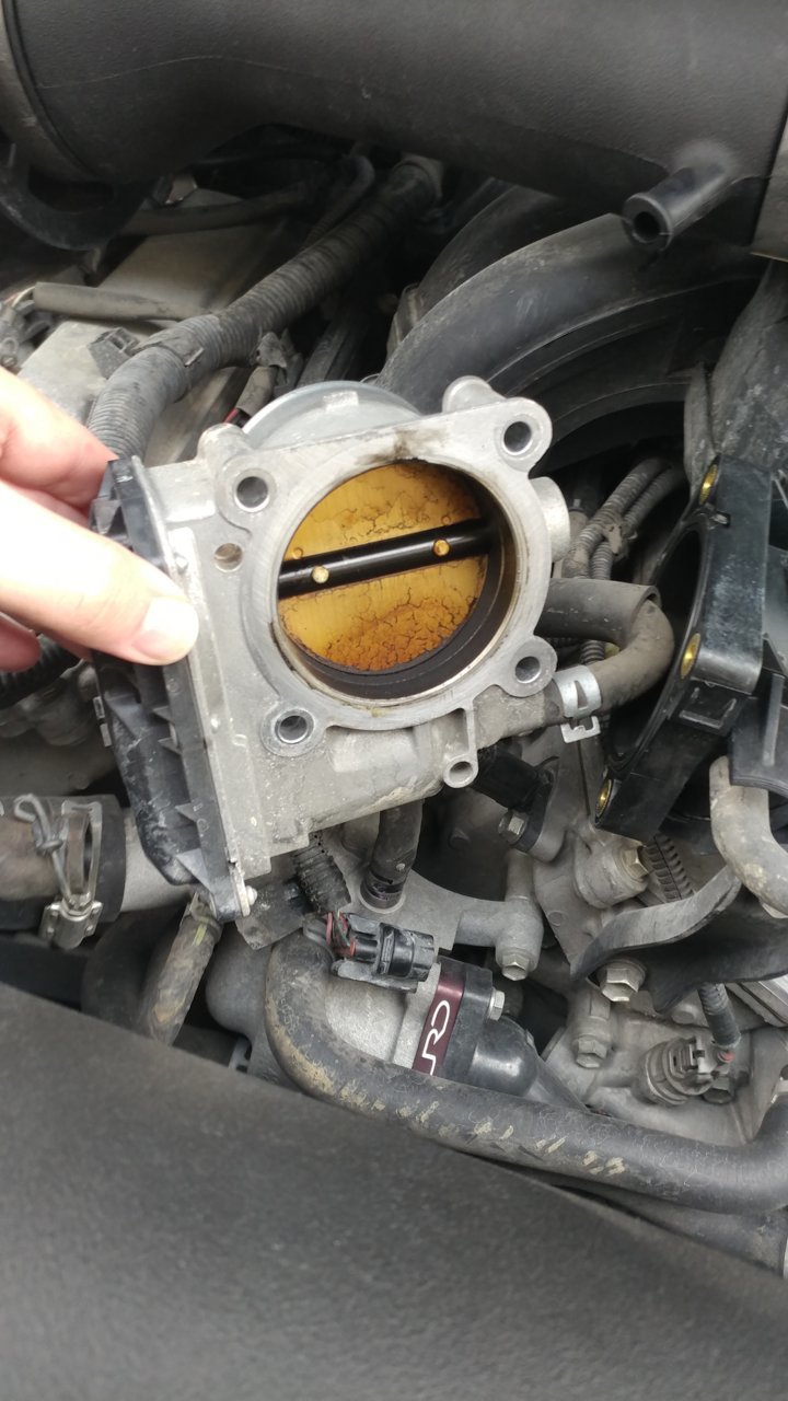

    Bypassed the tb coolant for cooler iat's.
    Done. Needed to reset efi 4 idle control.

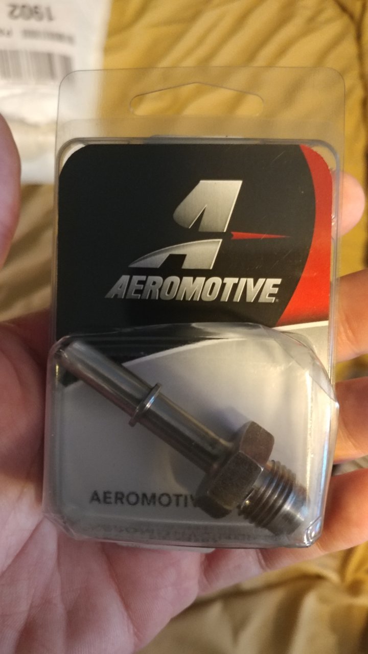

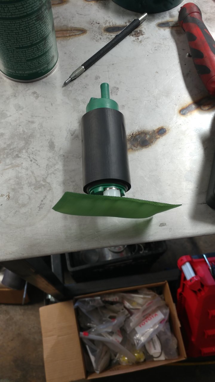

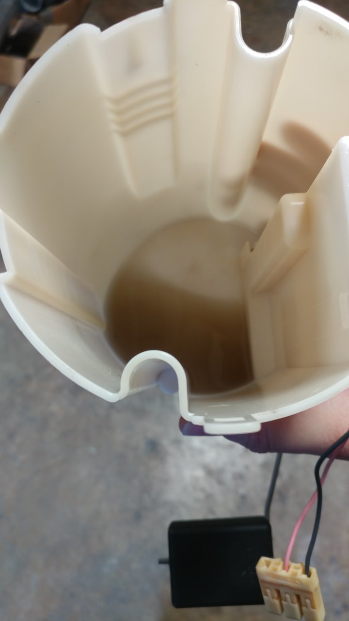

    Got the fuel pump in and runs good for now. Needed to use a gates 5/16 by 12in submersible hose. Its only rated for 50psi, good for now in na trim. I have bought two radium ptfe submersible hose for both the 4runner and the tacoma.
    http://www.radiumauto.com/Submersible-PTFE-Fuel-Tubing-P672.aspx
    What goes to engine. Dirty.
    Tiny and ungood. Bye.
    Roadkill also set in as I had ordered the wrond non ptfe fittings so I'll need to wait to install the fst filter for now. Truck runs great otherwise.
