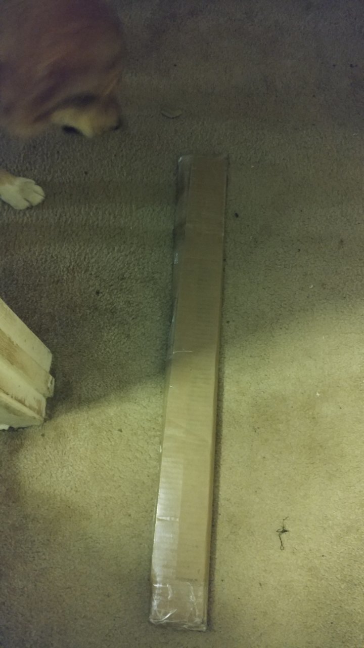

    Archive leaf springs showed up today. So minus the rear sway bar, and maybe a traction bar and a panhard bar, the rear suspension will be complete. Will wait till it gets warmer cause its starting to get cold.

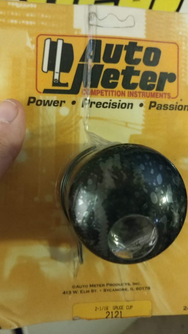

    Carbon fiber pod for a pillar.
