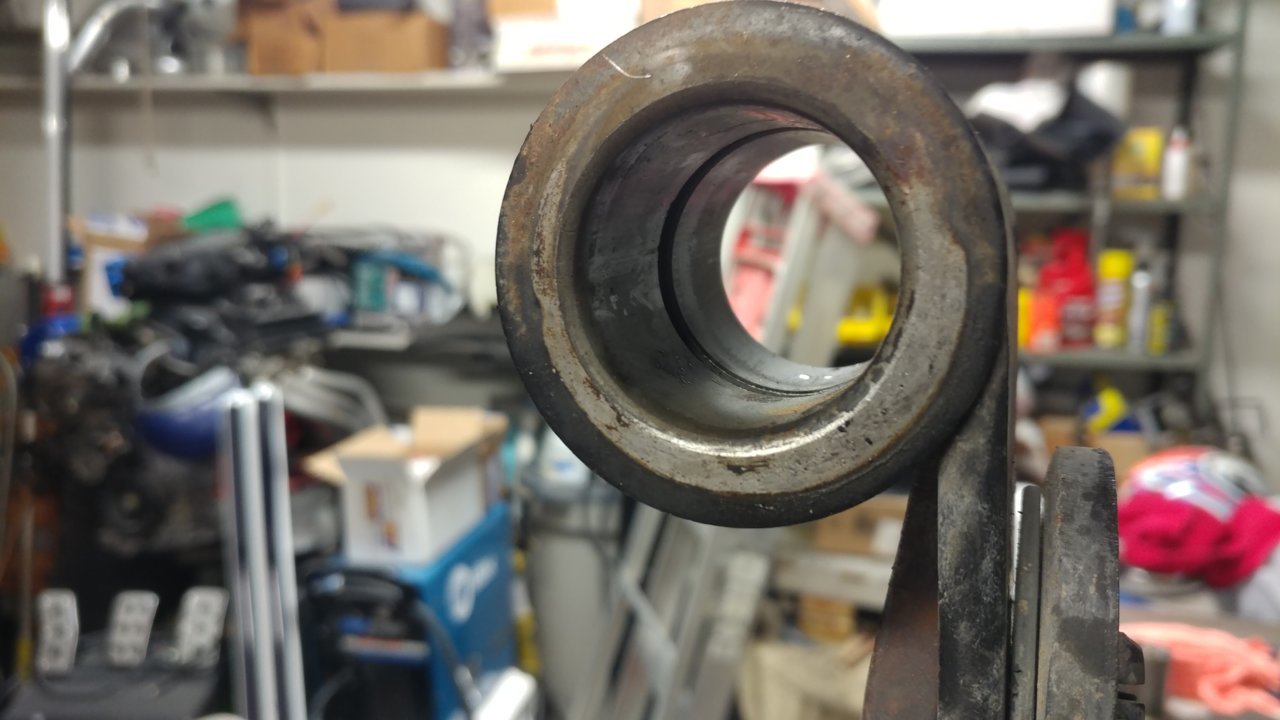

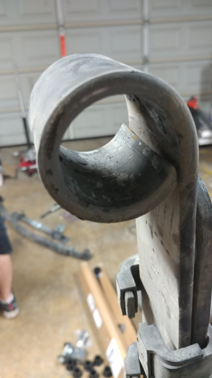

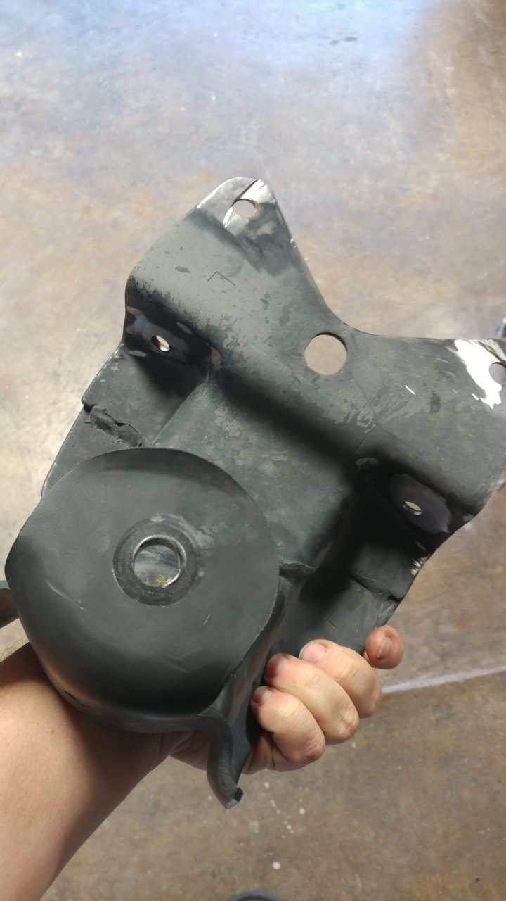

    Pressing bushing out. Rear oem has a split rubber and sleeve deal.
    Out. One more side left, then install and grease bushings and install add a leaf.
    Torspd and 05Taco4x4 like this.

    I have no recollection of the 06-08 leaf springs having those metal sleeves. Anyone else done bushing swaps on early models come across that difference?

    These are the tsb springs if that makes a difference.

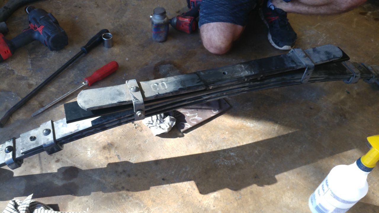

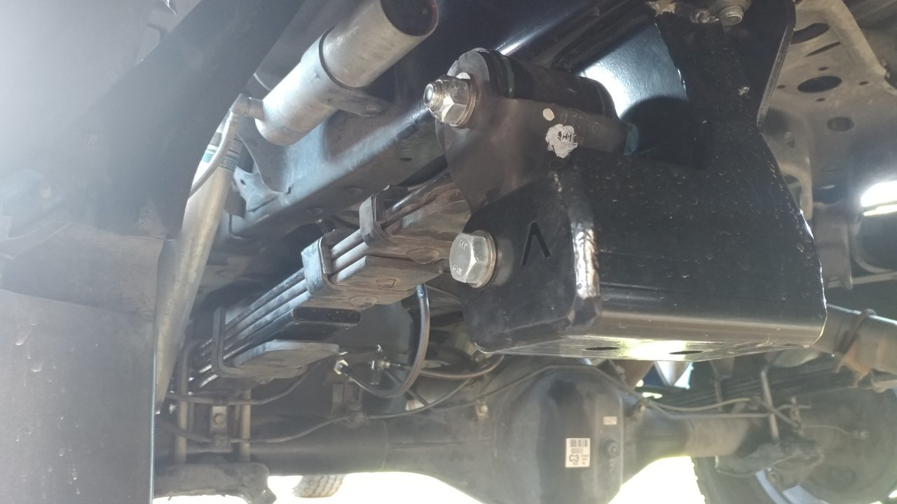

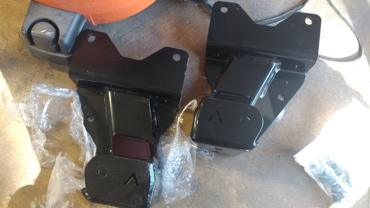

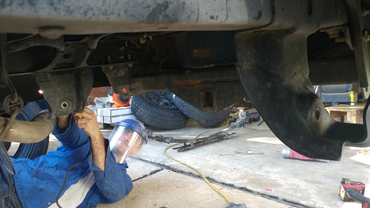

    Working on installing the hammer hangers, unfortunately I forgot my cross tube and to order oem shackels but I'll install those when I install my rear disk brakes.

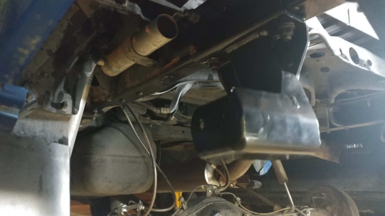

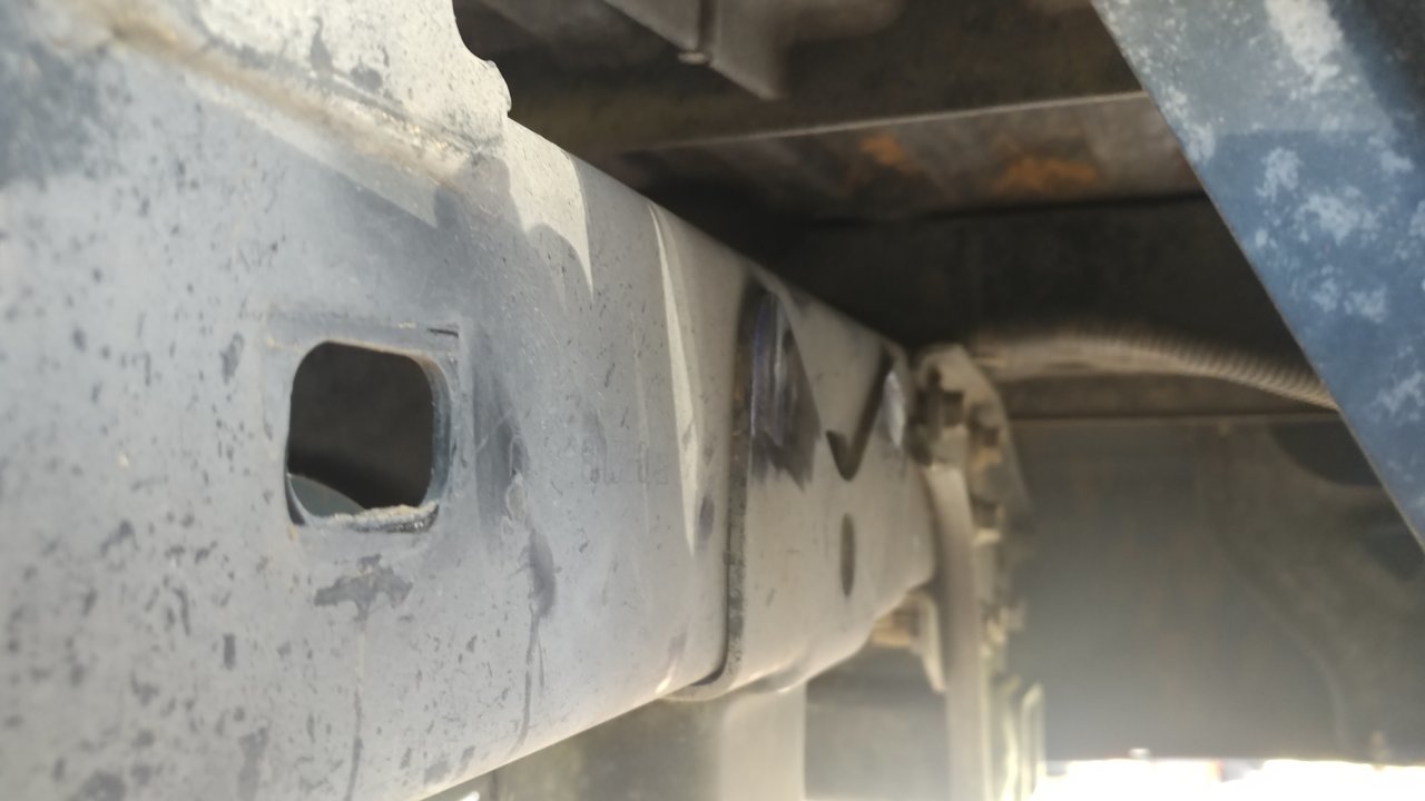

    20191124_160510.jpg driver side out

    Pass side done. Now for paint and install.

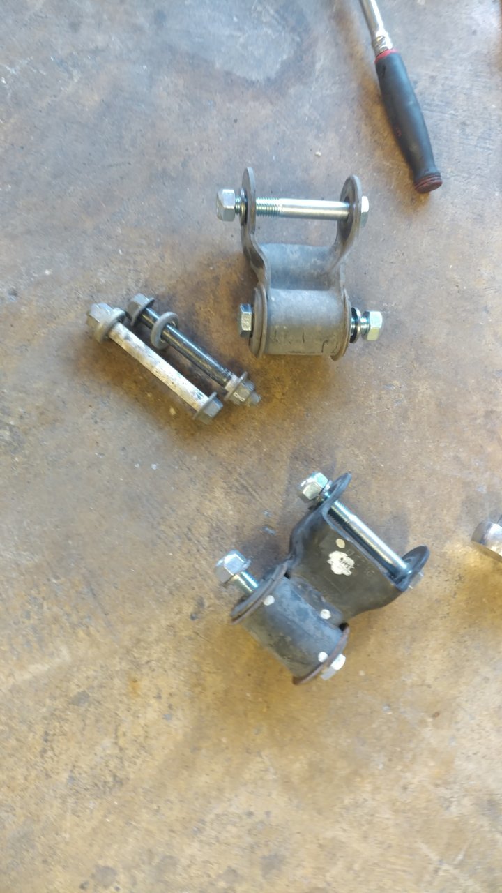

    Both hangers torqued down. Almost done.

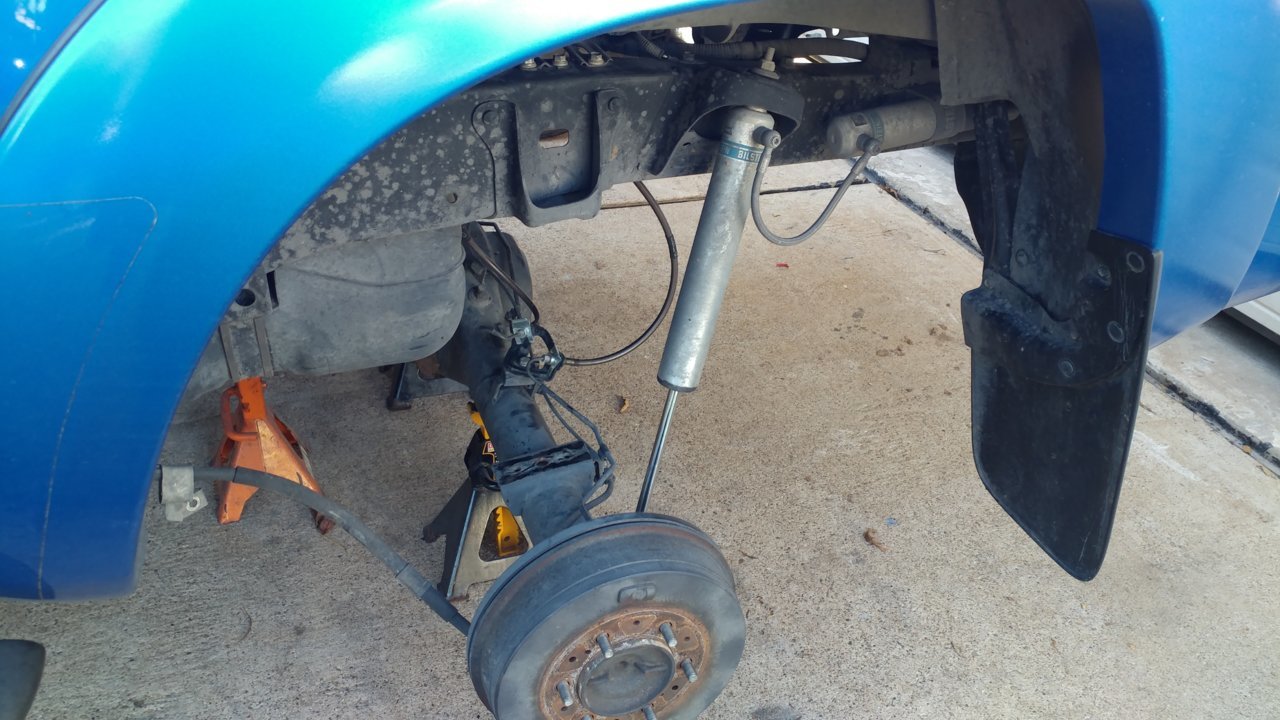

    Pass side spring in. Steak tyme

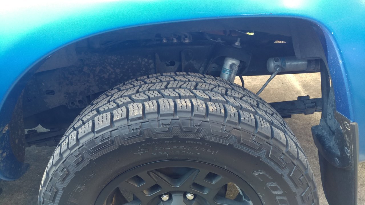

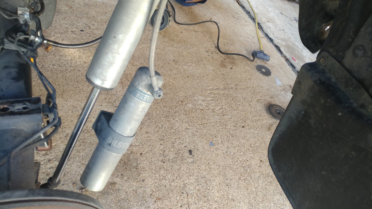

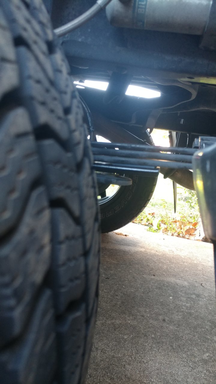

    20191201_163018.jpg 20191201_163028.jpg 20191201_163334.jpg 20191201_163045.jpg
    So this is probably the first test of the @ARCHIVE add a leaf for my truck. So far so good. I loaded go my truck to dump at the metal recyclers w/maybe 500-600lbs and truck barley squatted whereas before without the add a leaf it would squat an inch or two at more than 200lbs. Pretty happy.
