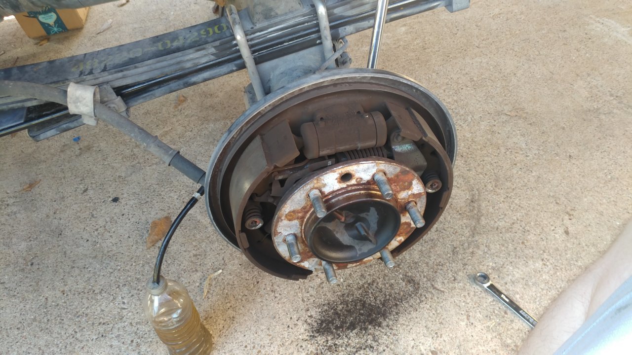

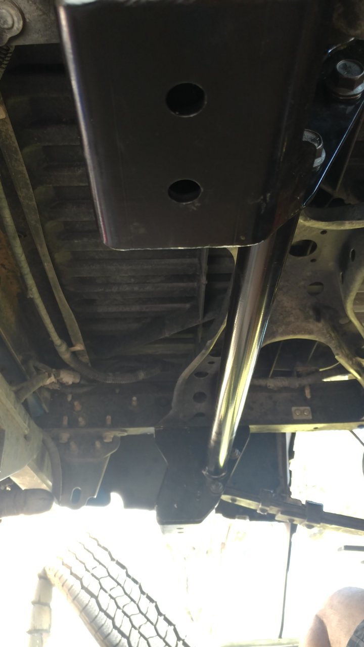

    Gonna install the rear cross tube for the hammer hangers and poly bushings for the shackle. @Torspd and I will also install the sos master cylinder upgrade and rear disk brake kit.

    ha! i saw that pic and immediately knew it's the HH crosstube. i have my eye on that, looking forward to hearing your report. i would have done mine initially but i haven't relo'd the spare yet.

    Sure thing mate. It'll be a lot faster than drilling out the rivits. Lol.

    Cross tube in. Rear disk tyme

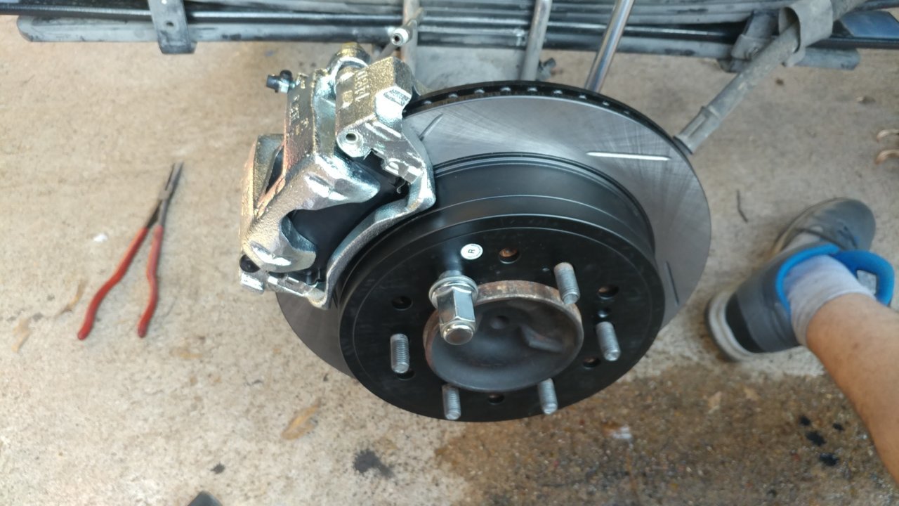

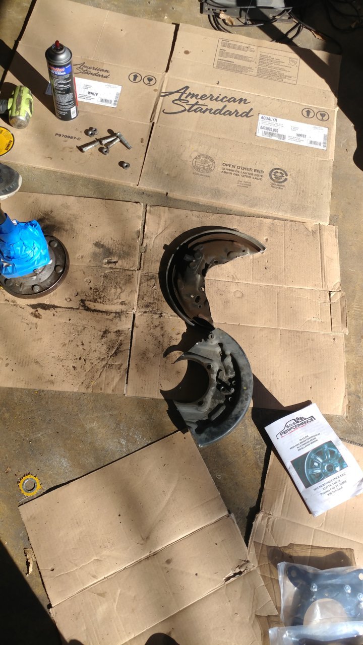

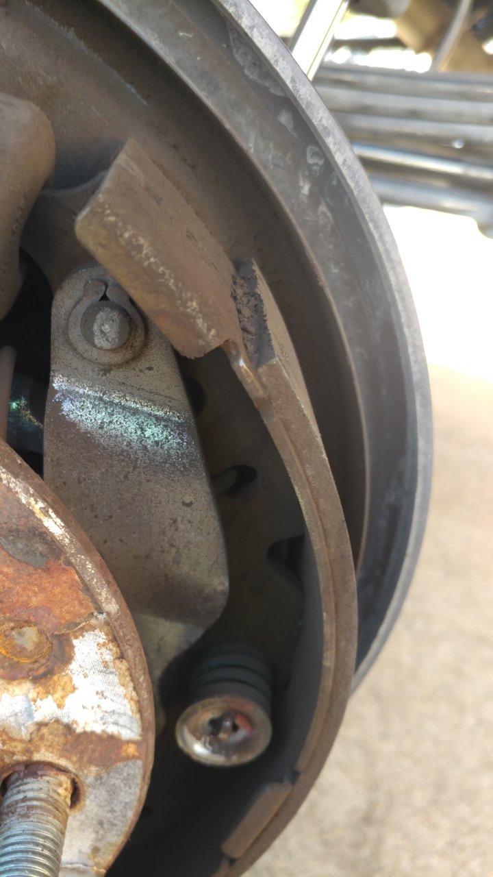

    The instructions sucked. Luckily sos picked up the phone for some tech support and helped in informing to reclock the housing for the abs sensor. Not bad not 100% still needs master cylinder install. There is no ebrake however which I want so I'll need to order that bracket. I hope its interchangeable with the caliper and rotor. I had interpretted it on the website as reusing the pen drum hardware as it had parking brake instructions on that page. Its not the end of the world being an auto just like to have that feature. Testing will take place tomorrow.

    Why did we change the drums? They could have gone another million miles.

    I like to stop when I want too with confidence, not by parasail.

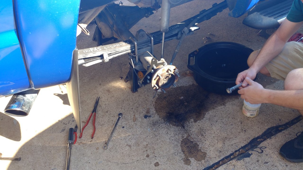

    We'll know tomorrow how well the work paid off. The instructions were frustrating yes. The components are good. Change out the master, bleed the master, ABS pump, then the lines.
    Our last venture into changing lines created an air in the system issue that I had never encountered before, and am 100% prepared for this time.

    Pneumatic bleeder will save you lots of time. Best thing ever
