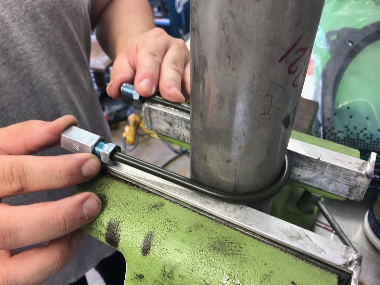

    Tubing bender.

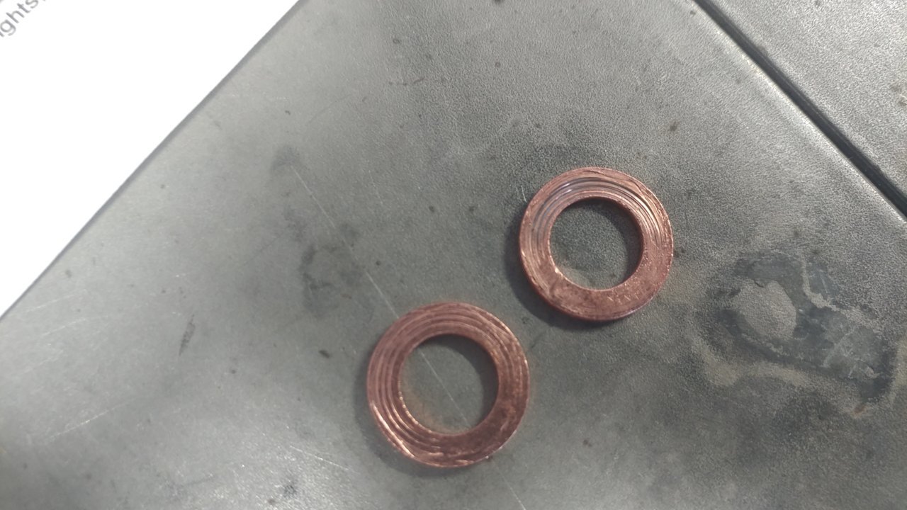

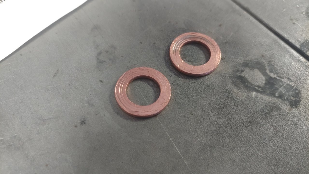

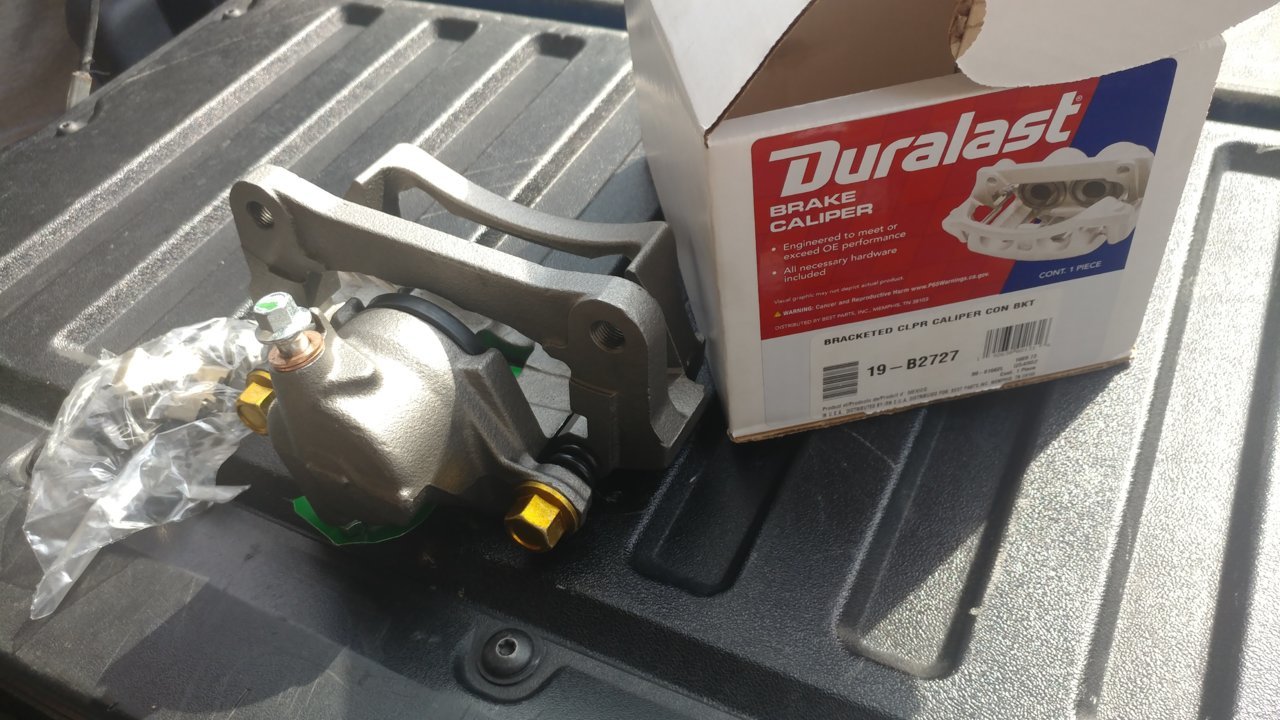

    So roadkill has begun. The driver side rear banjo bolt is at an angle when fully seated on the caliper so the threaded hole and bolt are not on the aame plain. Need a new caliper.

    New caliper

    Initial test drive is good. This is the best the brakes on this truck have ever felt.

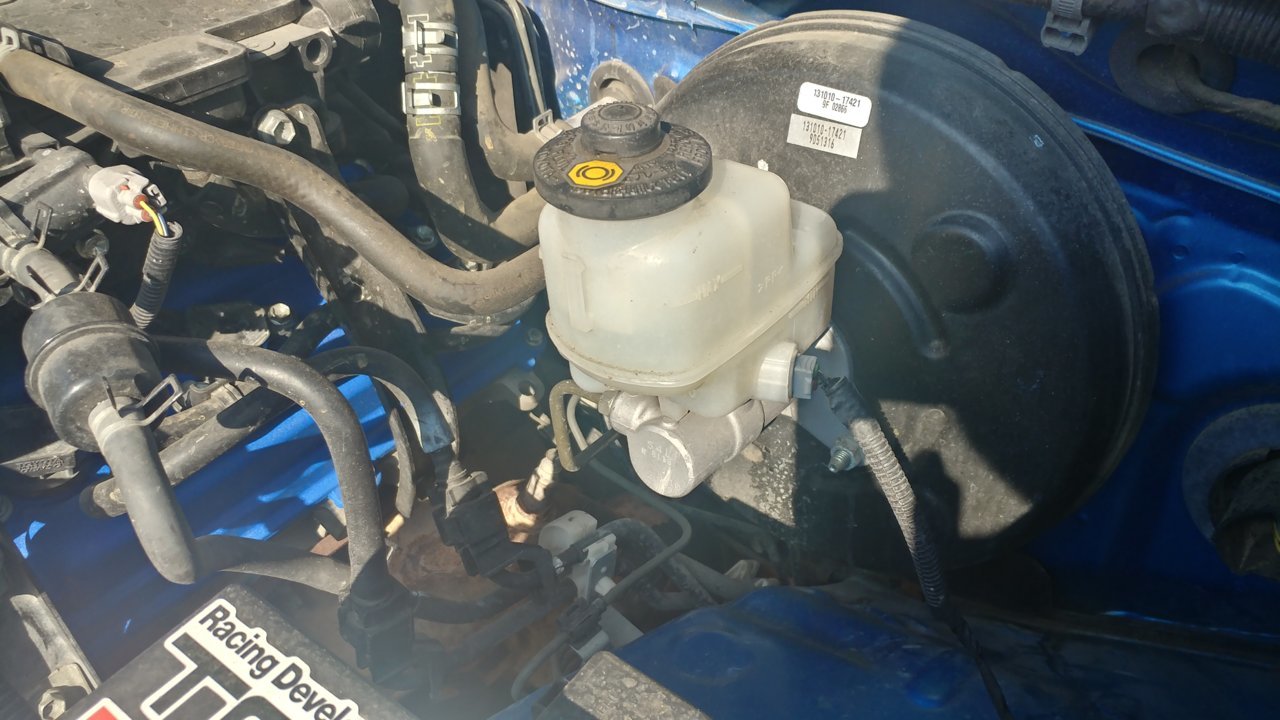

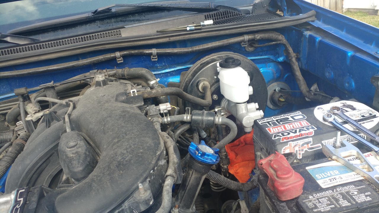

    How did the install go for the MC? Any issues to be prepared for, or just straightforward?

    Pretty straightforward. Much better than installing the rear brakes playing jeopardy following the instructions. Lol.

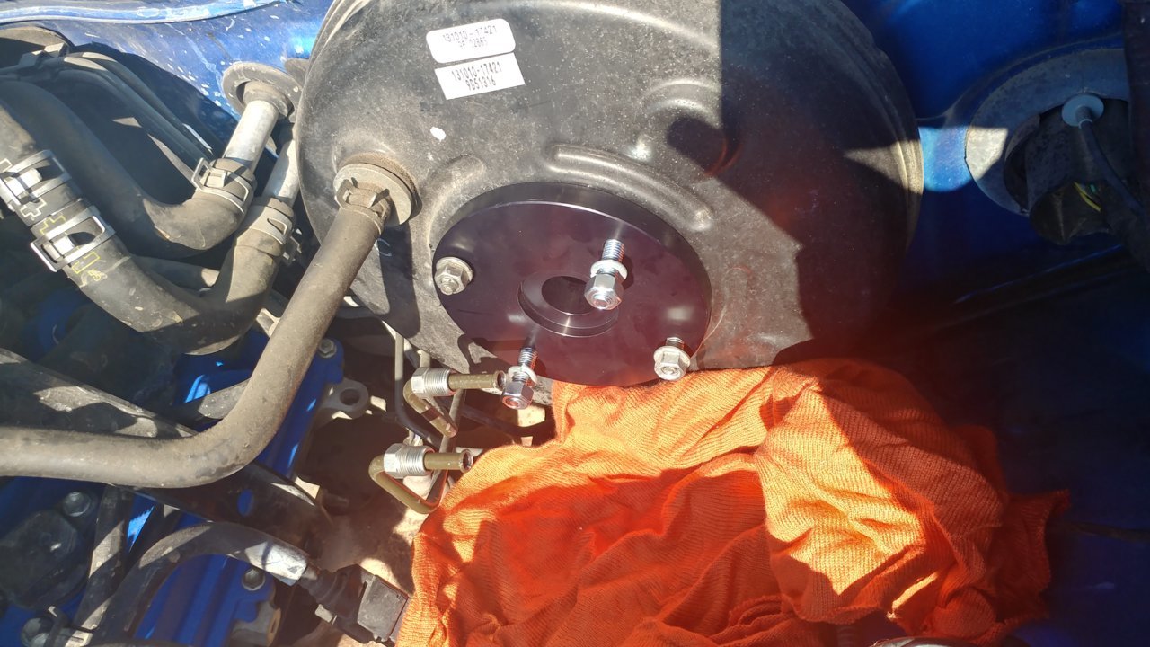

    Very good to hear. So no problems with the pushrod extension being too long or the wrong length? Read somewhere that someone had an issue with it being too long and not letting the brakes release.

    It comes with two bolts for that clearance.

    Two bolts to use for matching the proper length. Easy enough to find the depth necessary. Took me three tries.

    Theres a cnc piece that goes between the master and the pedal. The bolt acomadates for the cleanance difference. You just need to bolt it on and try with the pedal to get it right so it's not binding. Preferably dry with the metal plugs in the bottom.

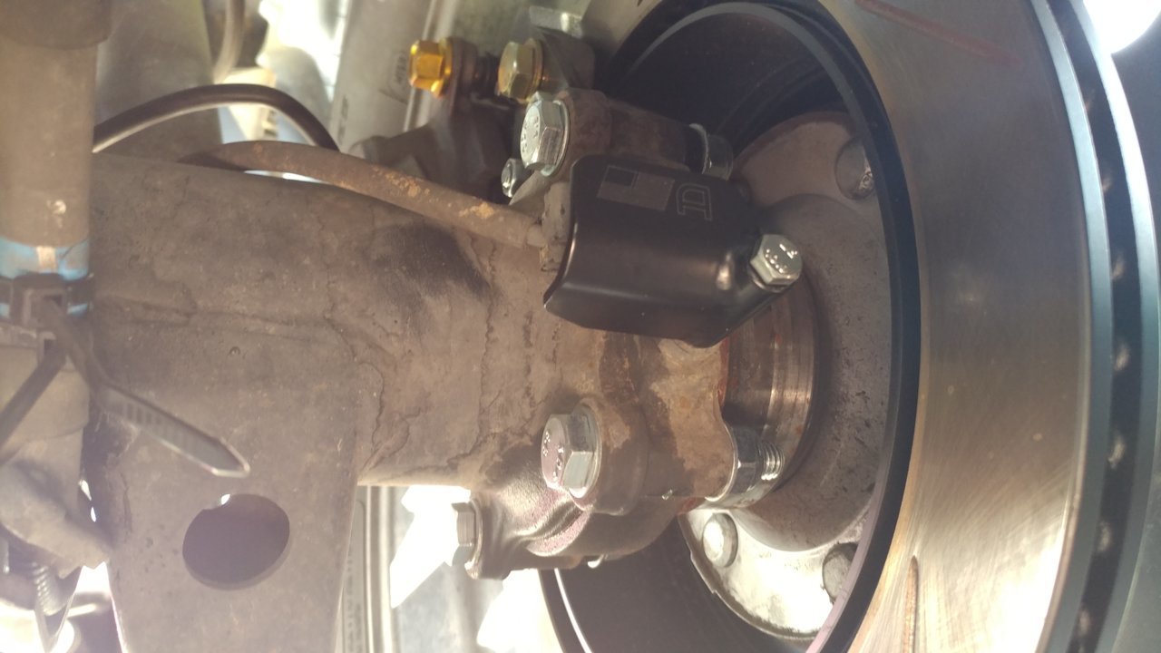

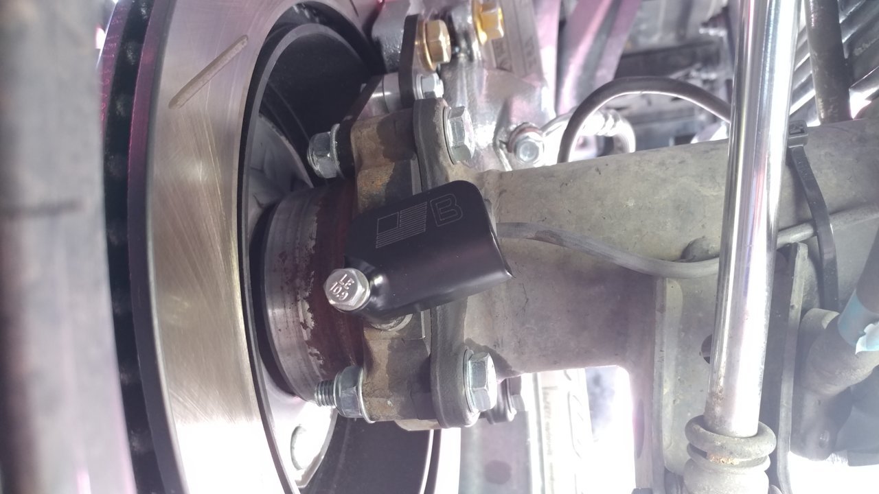

    Rear abs guards installed.

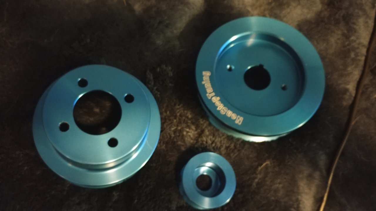

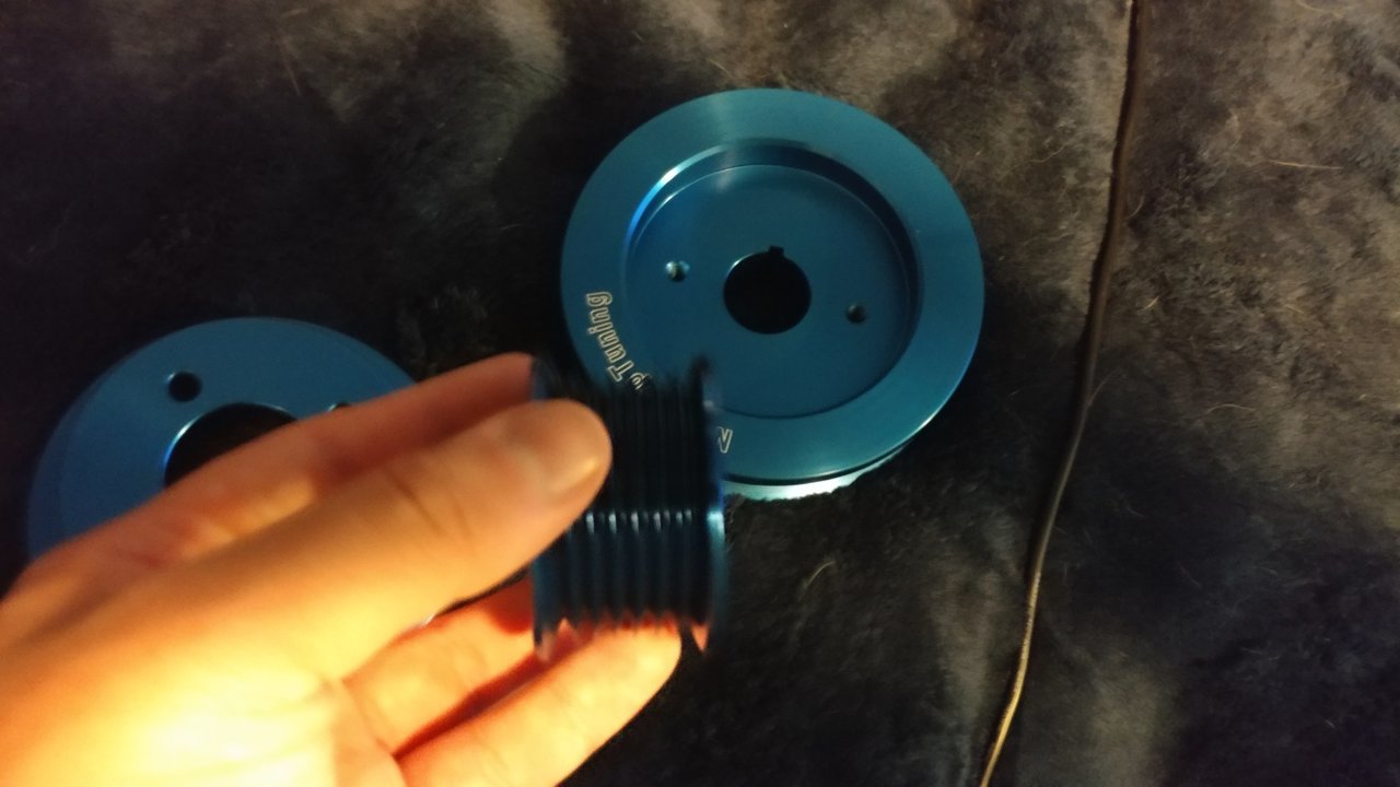

    20191216_161537.jpg Got my nst pulley set. Good news is that the alt pulley doesn't have a forward offset so it should work on my alternator. I'll need to get another one for my 4runner if this is the case.
