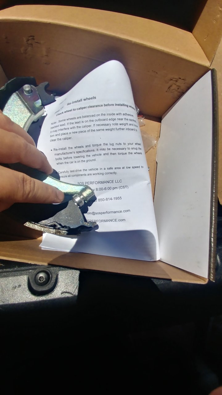

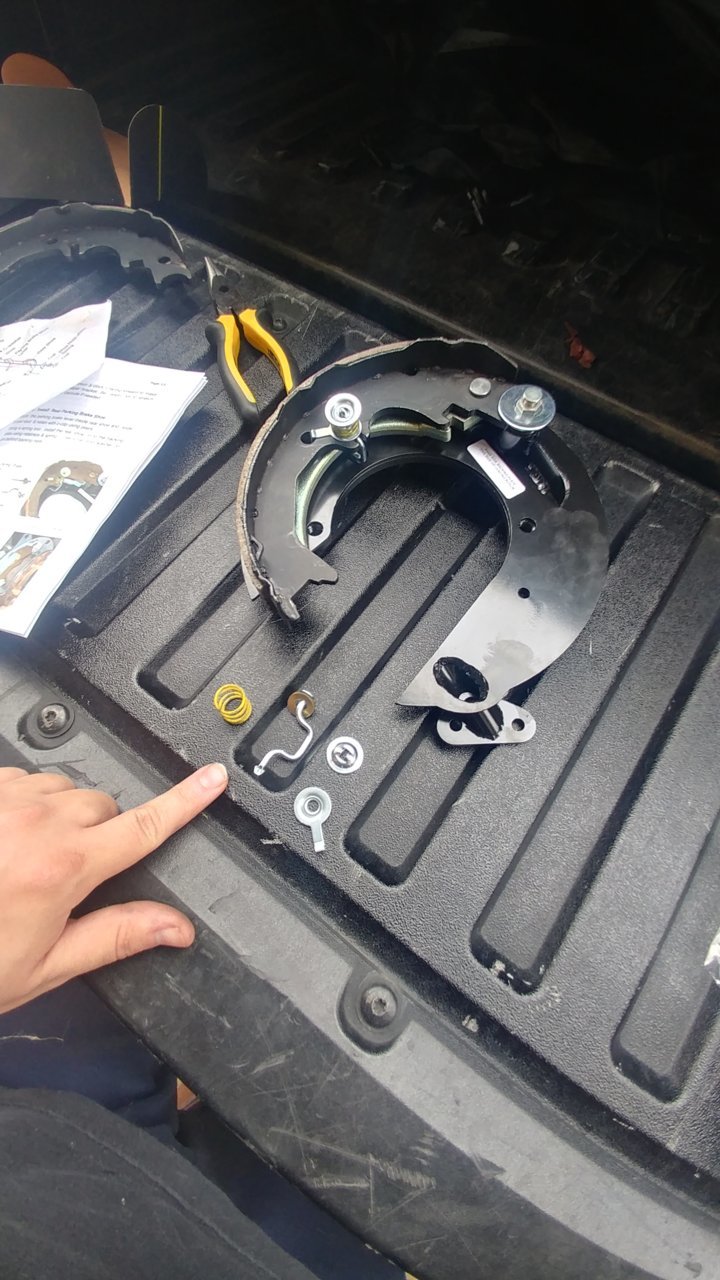

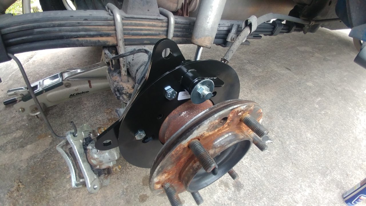

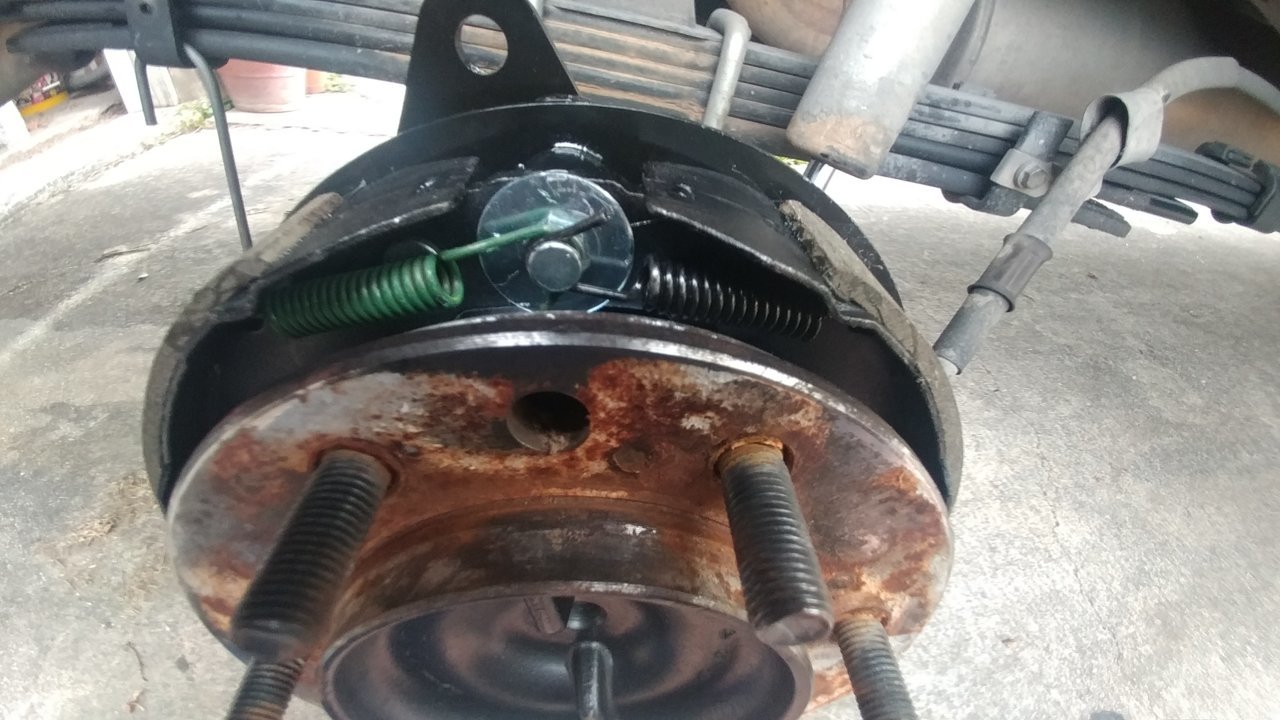

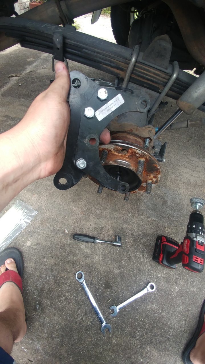

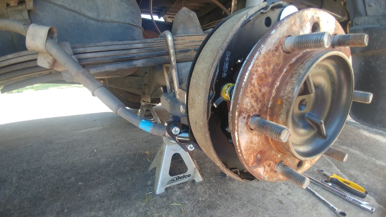

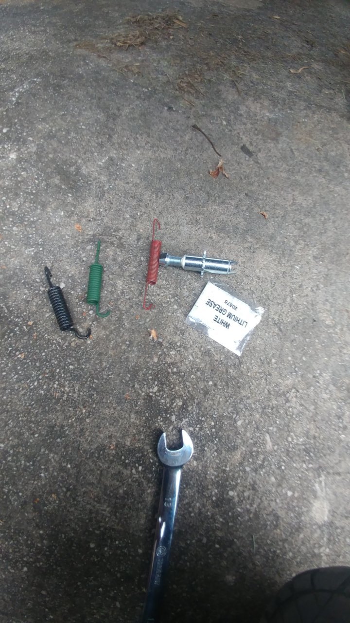

    Took a break from being essential and did half of my rear disk/ebrake revision. End results works well able to torque the wheels with the ebrake.
    Lining up orientation.

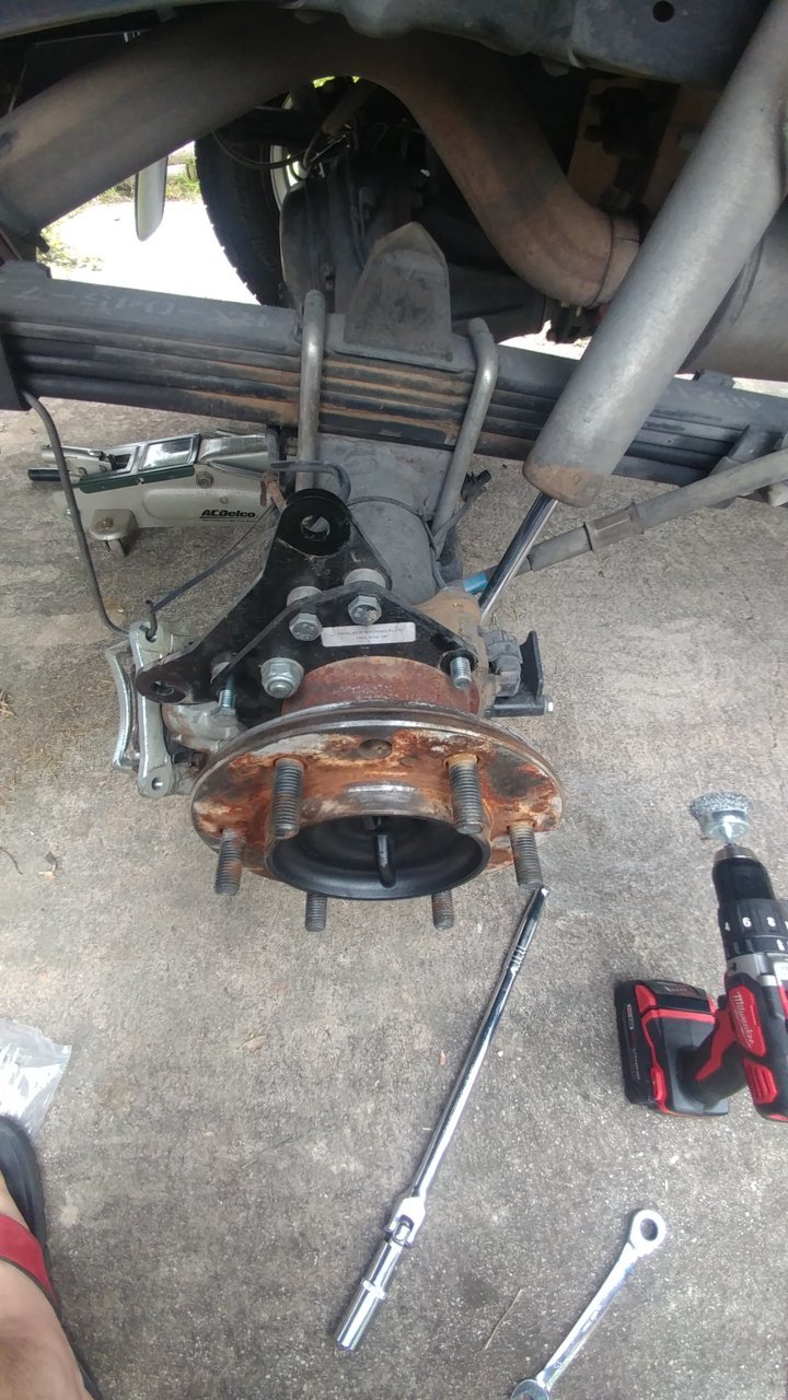

    Cleaned up hub and put more antiseize of the wheel studs. Driver side later.

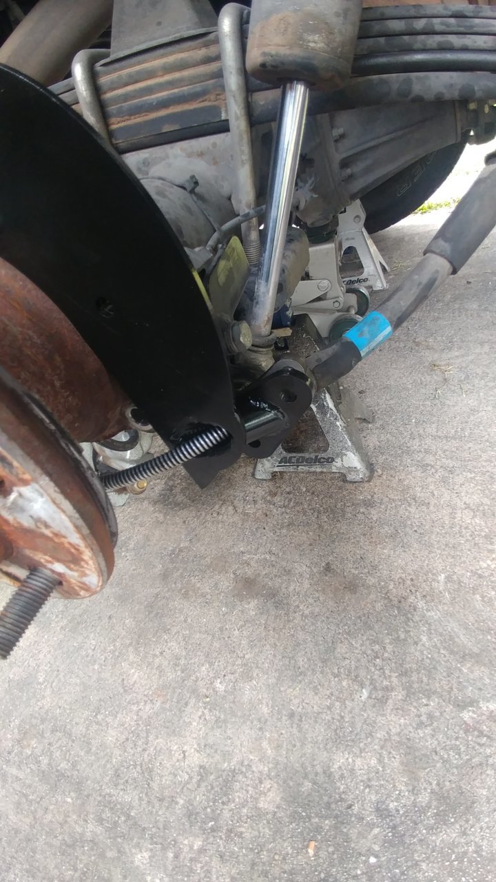

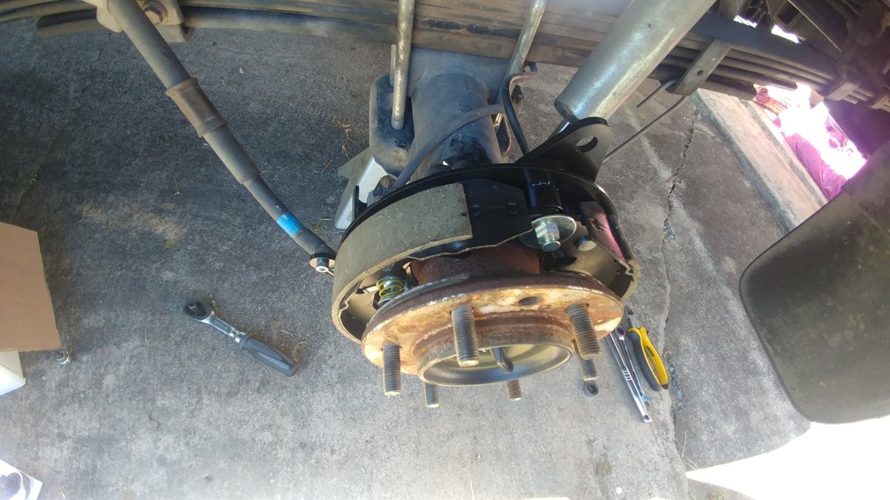

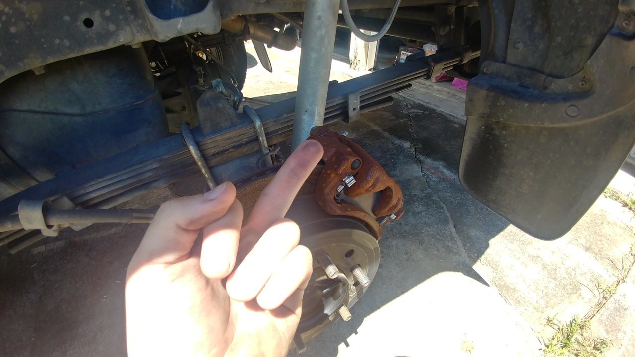

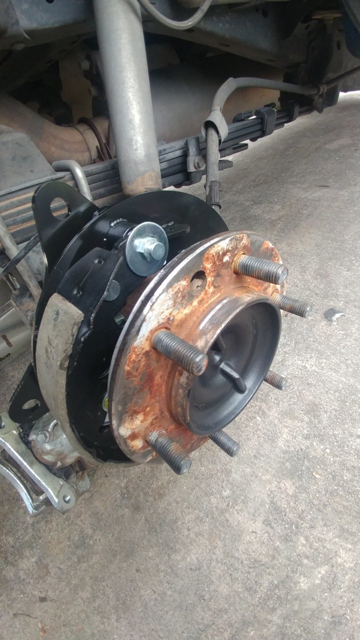

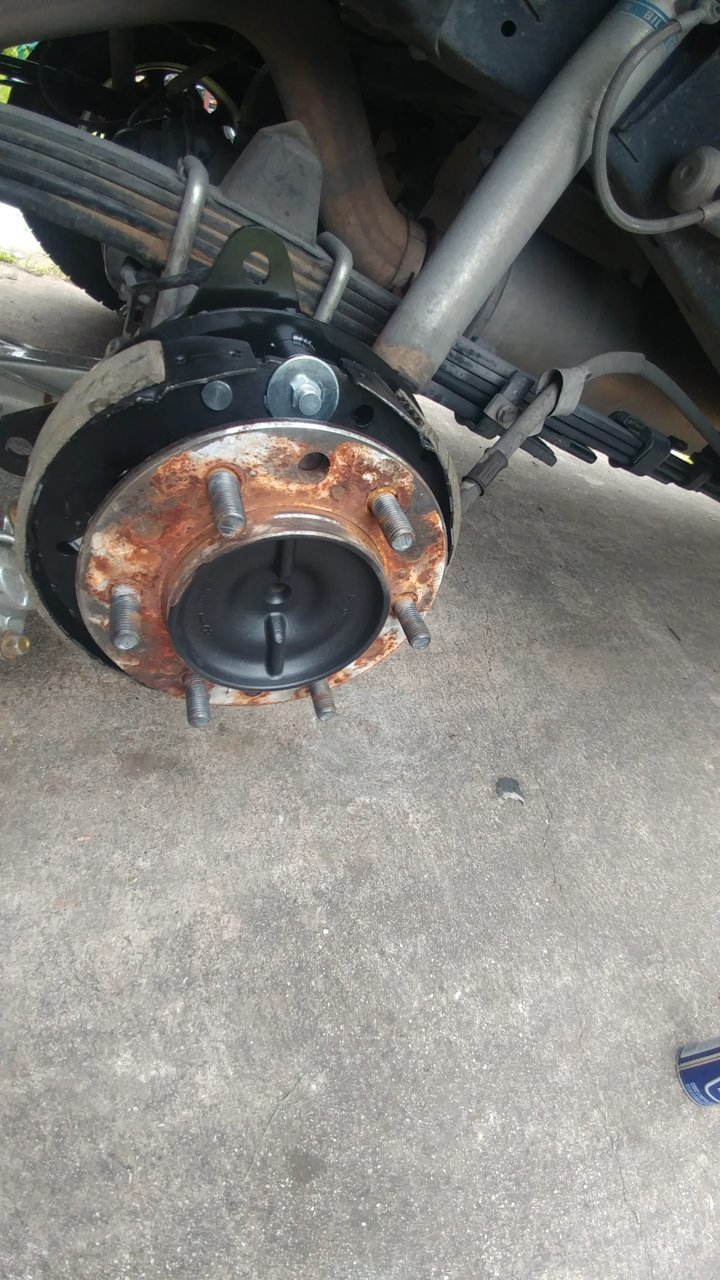

    Driver side done.
    That little collar makes the magic happen.

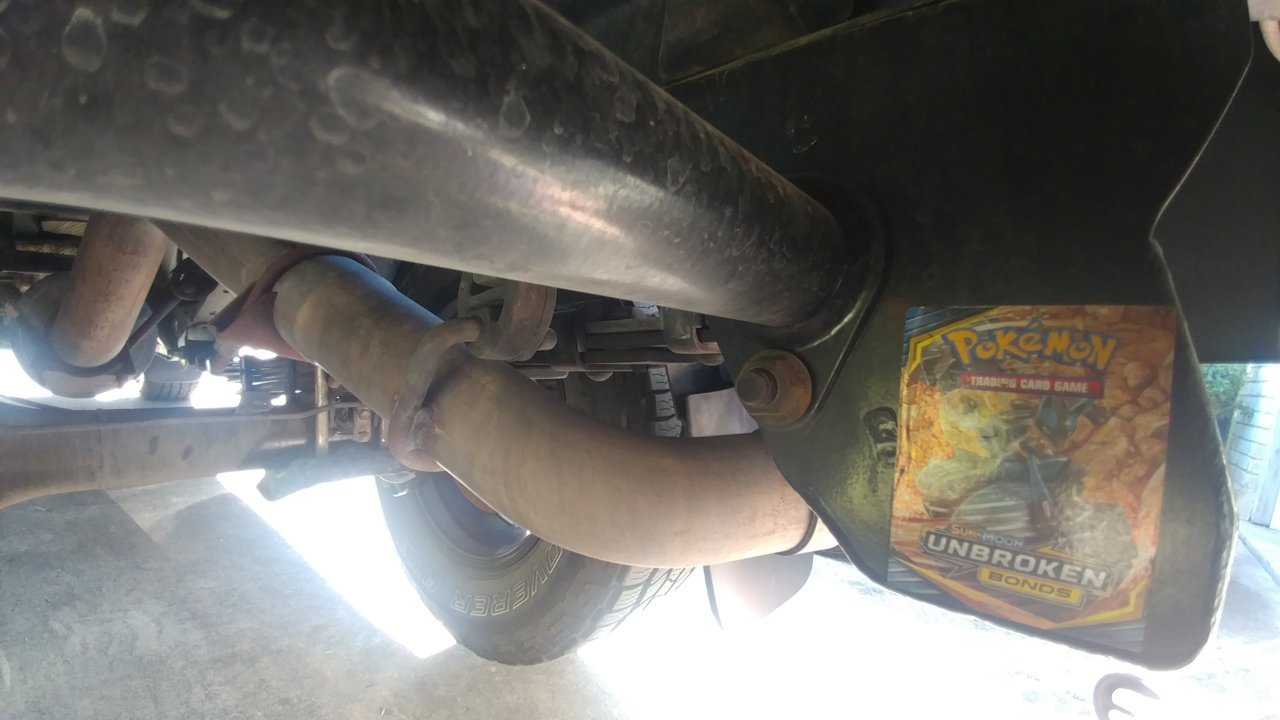

    PSA fuck duralast. Fix with paint soon.
    Secret mod.
    So mechaniclly the ebrake works great however on the dash the ebrake light is on. It illuminated during the last rally I participated in so I'm assuming bad connection or the switch is broken like the brake pedal one was. Good thing is that it doesn't interfere with driving. I'll troubleshoot when I get more free time.
    hemitruk and Flake Boost like this.

    Thanks for pics . Just got my kit in today . Going make my swap so much easier . Those pic should be included in SOS install manual also . :thumbsup:

    Np, figured it would help others w/the rear disk install.

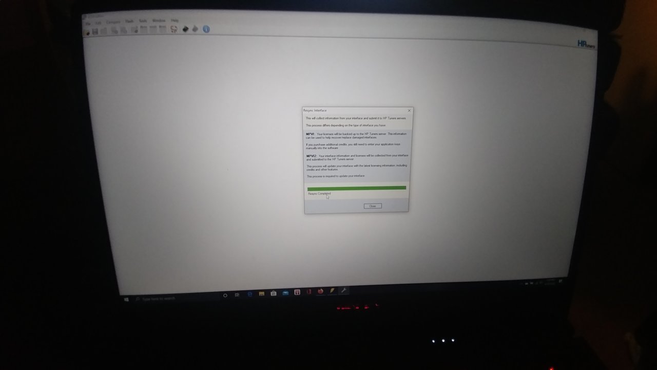

    Almost ready to start tuning.

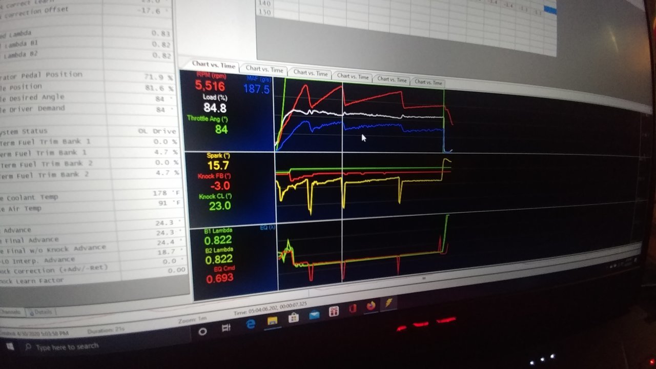

    Wanted to provide feedback from tuning. The truck now actually feels fun to drive. Easily one of the best mods and cheapest when you factor what you can do compared to other units. 20200430_182039.jpg
    One if the datalogs from tuning.
    I have to thank @JustDSM for help in setup.

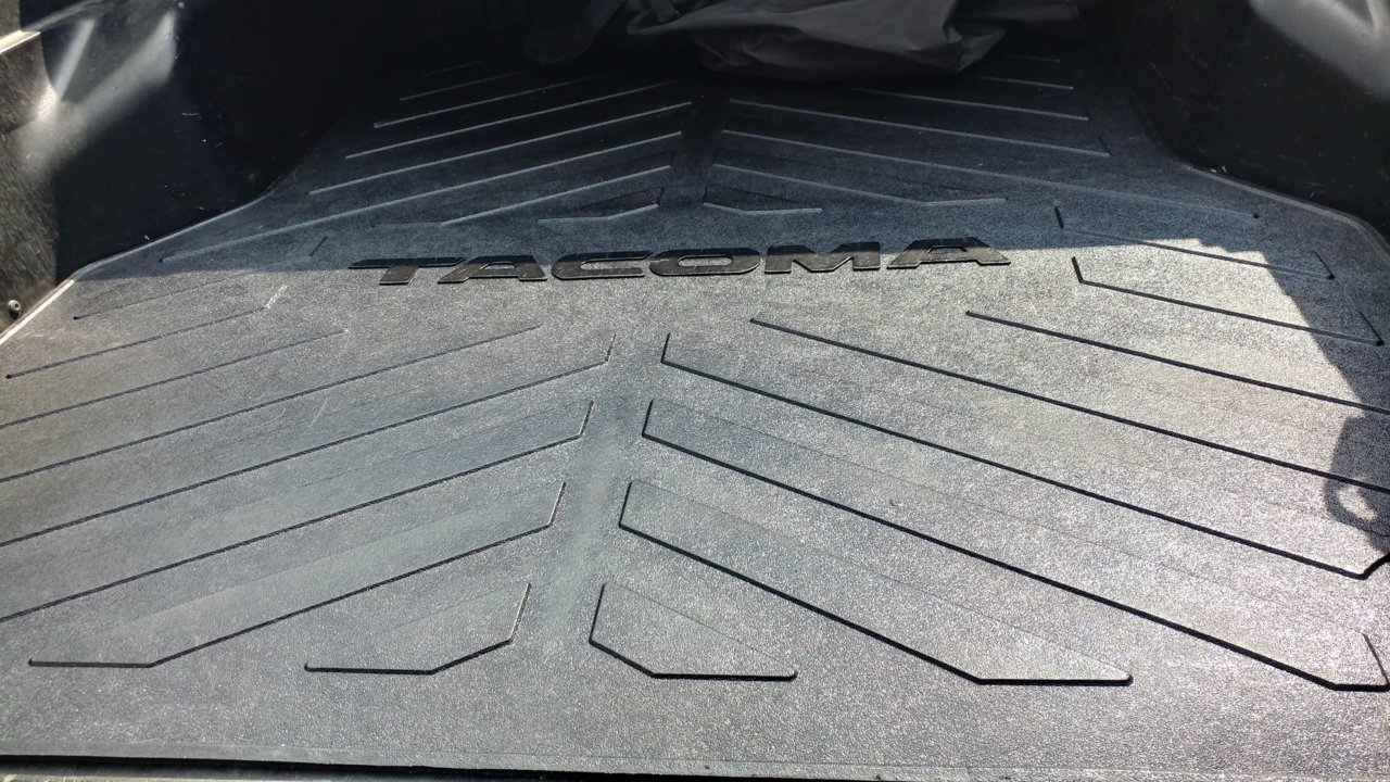

    06 Toyota 4Runner
    AFE stage II intake, APR X1, URD 70mm Throttle Valve (ported and knife edged), NST intake manifold spacer, URD spec U headers, Denso IKH20, URD fuel pump, APR fuel rail, URD Y pipe, URD spec u catback, lightweight water pump pulley, Greddy sandwich cooler plate, Earls oil cooler, IPT valve body, FJ TRD shocks, Cusco front and rear sway bars, Energy Suspension rear track rod bushings and rear link bushings, Carbotech pads, Stoptech ss brake lines, Stoptech slotted rotors, Motul 600 rbf, Limited Grill, Painted hatch cover by me, Painted valve covers by me, Cobra CB, TRD rad and oil cap, Escort 8500, Autometer oil psi and temp gauges, AEM wideband afr gauge, Flexpod, Pioneer 400w speakers.
    Not much but makes the truck more practical.
