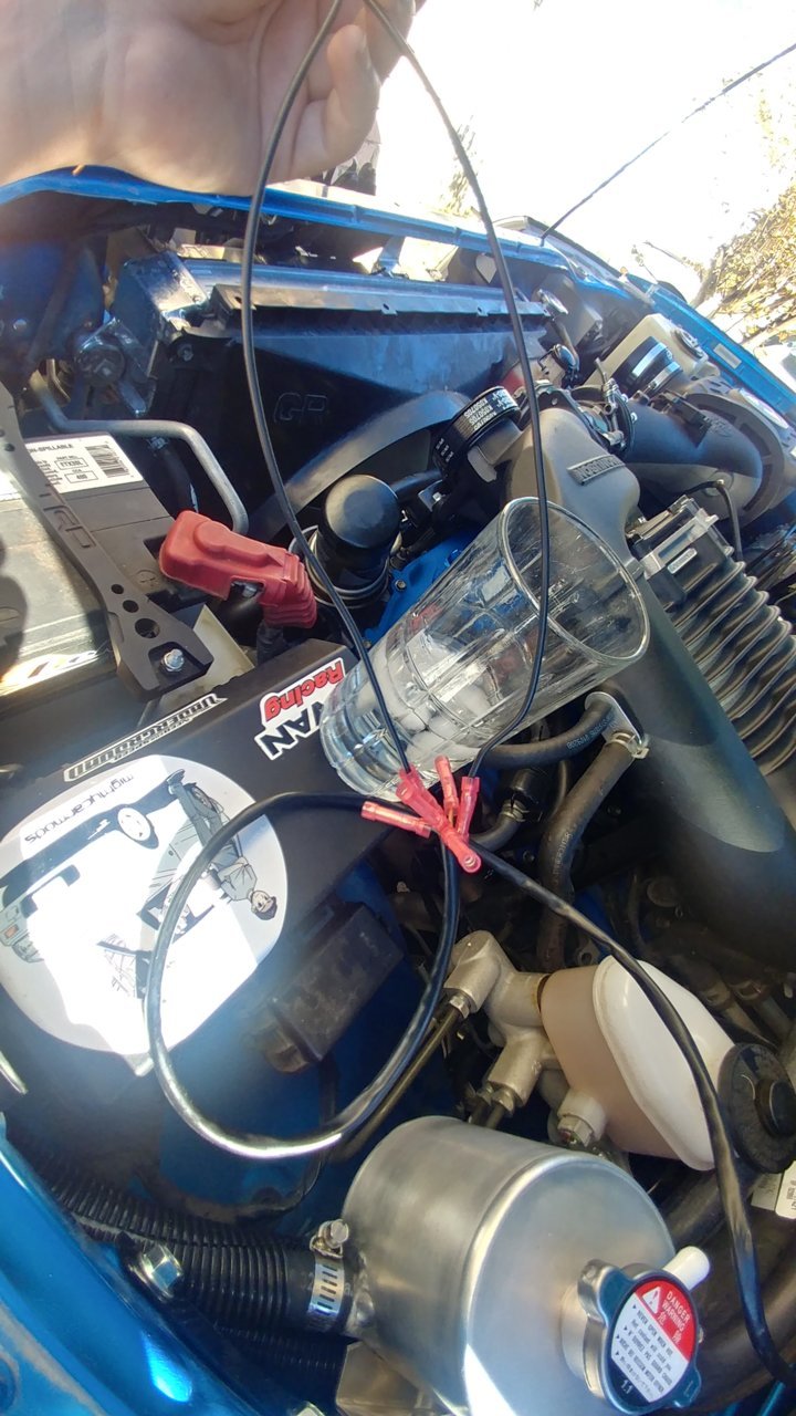

    AFE stage II intake, APR X1, URD 70mm Throttle Valve (ported and knife edged), NST intake manifold spacer, URD spec U headers, Denso IKH20, URD fuel pump, APR fuel rail, URD Y pipe, URD spec u catback, lightweight water pump pulley, Greddy sandwich cooler plate, Earls oil cooler, IPT valve body, FJ TRD shocks, Cusco front and rear sway bars, Energy Suspension rear track rod bushings and rear link bushings, Carbotech pads, Stoptech ss brake lines, Stoptech slotted rotors, Motul 600 rbf, Limited Grill, Painted hatch cover by me, Painted valve covers by me, Cobra CB, TRD rad and oil cap, Escort 8500, Autometer oil psi and temp gauges, AEM wideband afr gauge, Flexpod, Pioneer 400w speakers.

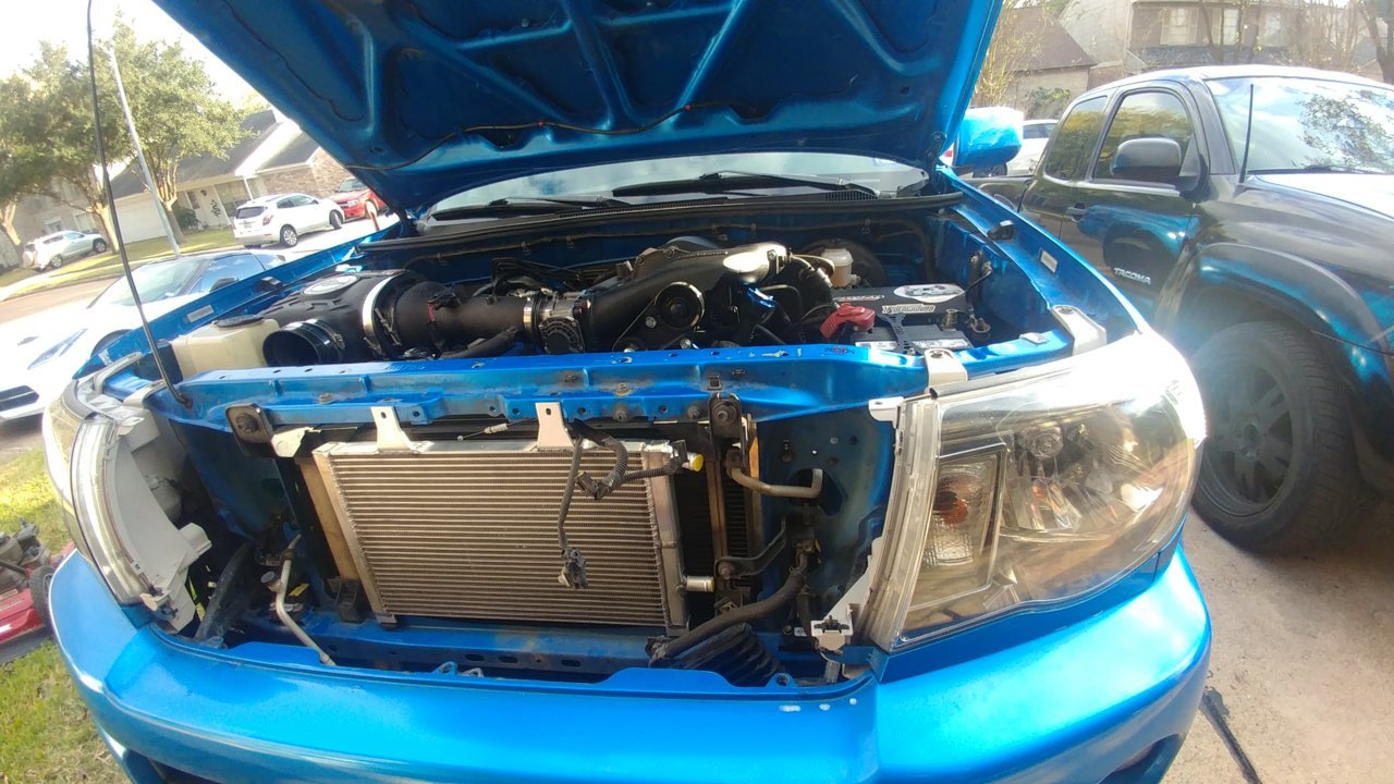

    @Torspd and I are almost done. Fill the supercharger coolant and engine coolant, install edu that @JustDSM kindly flashed for us, some wiring for the pump and afr sensor, and finish the exhaust and the truck will be dialed. The only issue that will be addressed later is the air intake as with the urd adaptor its a super tight fit.

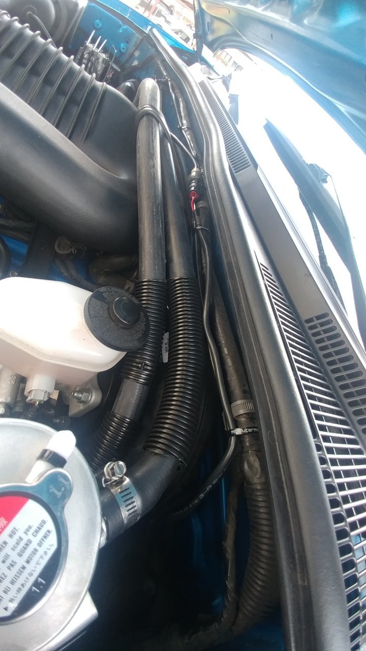

    Modified the oem bracket for a cleaner look.
    Added this thanks to @Torspd over the one magnuson sends for better contact and rigidity.

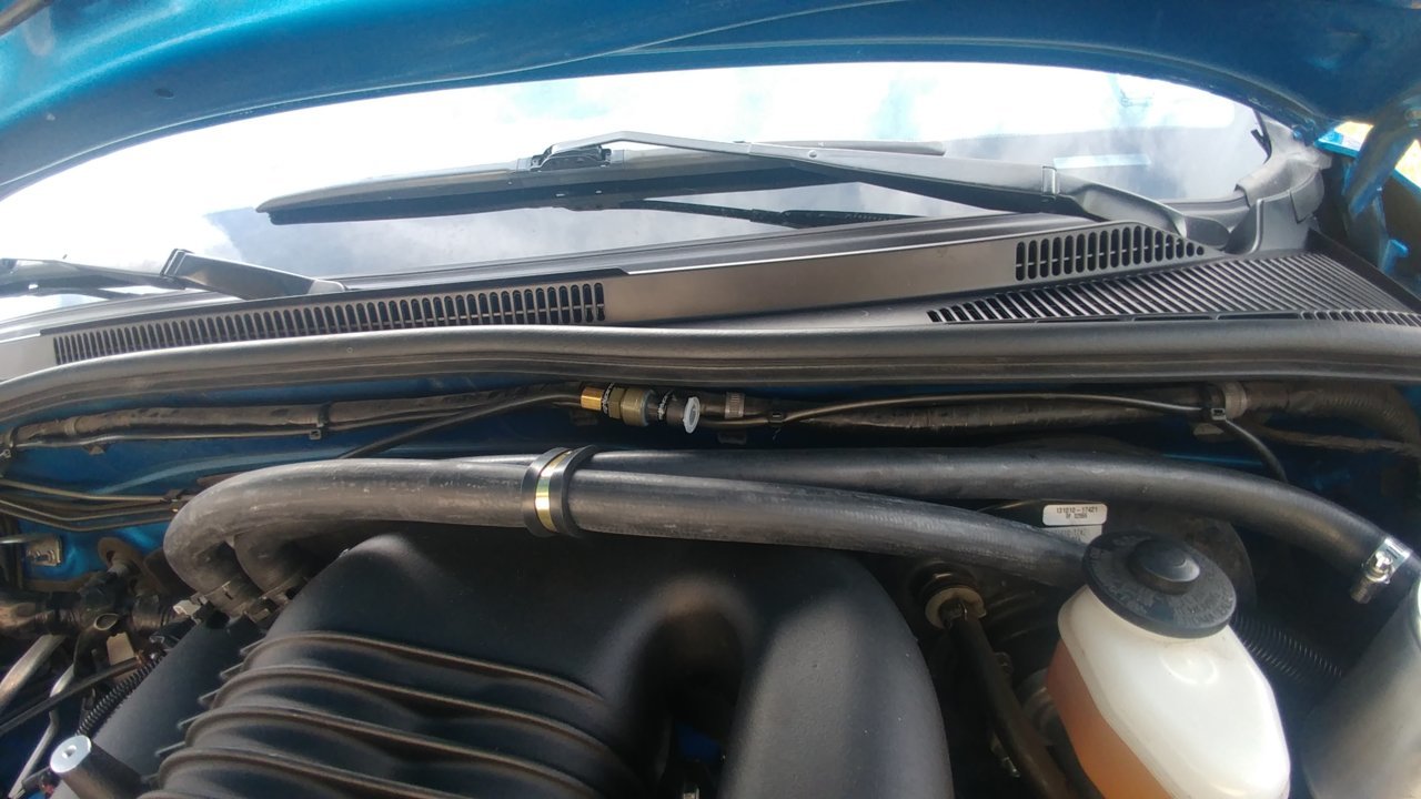

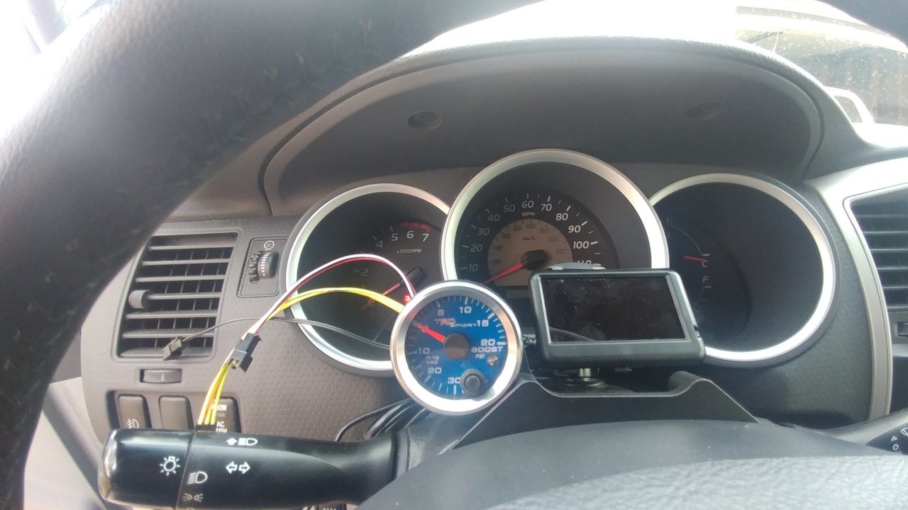

    Wired up my afr sensor.
    Ecu back in with trd calibration.

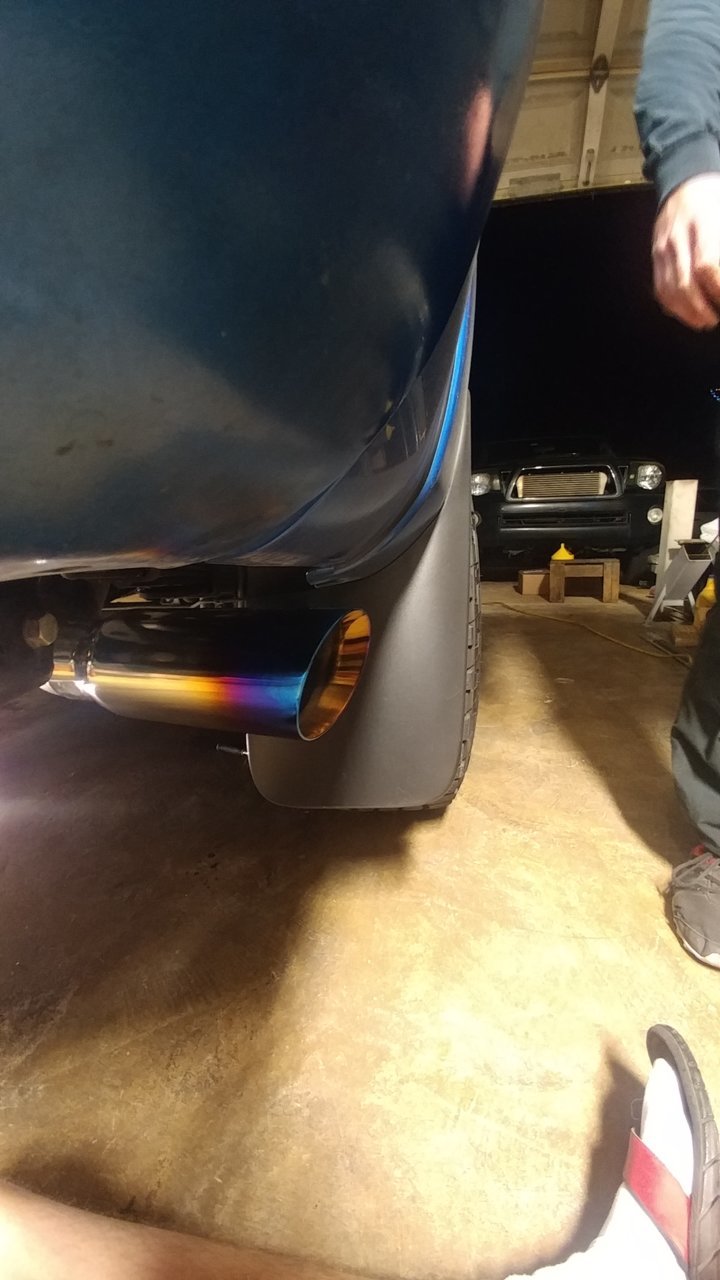

    So far. Still need to finish up the muffler welding, as well as exhaust tip installation. Nearly there. Coolant fills as well.

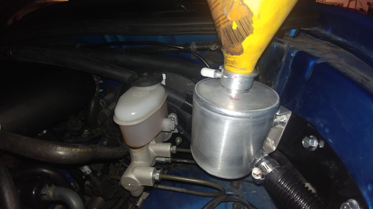

    Glad things are going smoothly! Looking forward to some more updates. Did yall run into any clearance issues with the sequoia master? Looks like things are a little closer over there.. Do you think the 6 spd trucks would have any fitment issues there with the hard line for the slave cylinder? I think it's somewhere in the same vicinity

    There might be an issue with manual trucks but you could get a universal reservoir but on my truck, there was no issue.

    Had not one clearance issue with the Sequoia master. There is a good 1/8" minimum of clearance from those hard lines to the bottom of that reservoir.
    I don't think the added size of the reservoir should create any issues of fitment.

    Need to get a drive-by video, to accurately capture the exhaust tone change. No longer can get an accurate comparison from in the cab. Due to boosty noises.

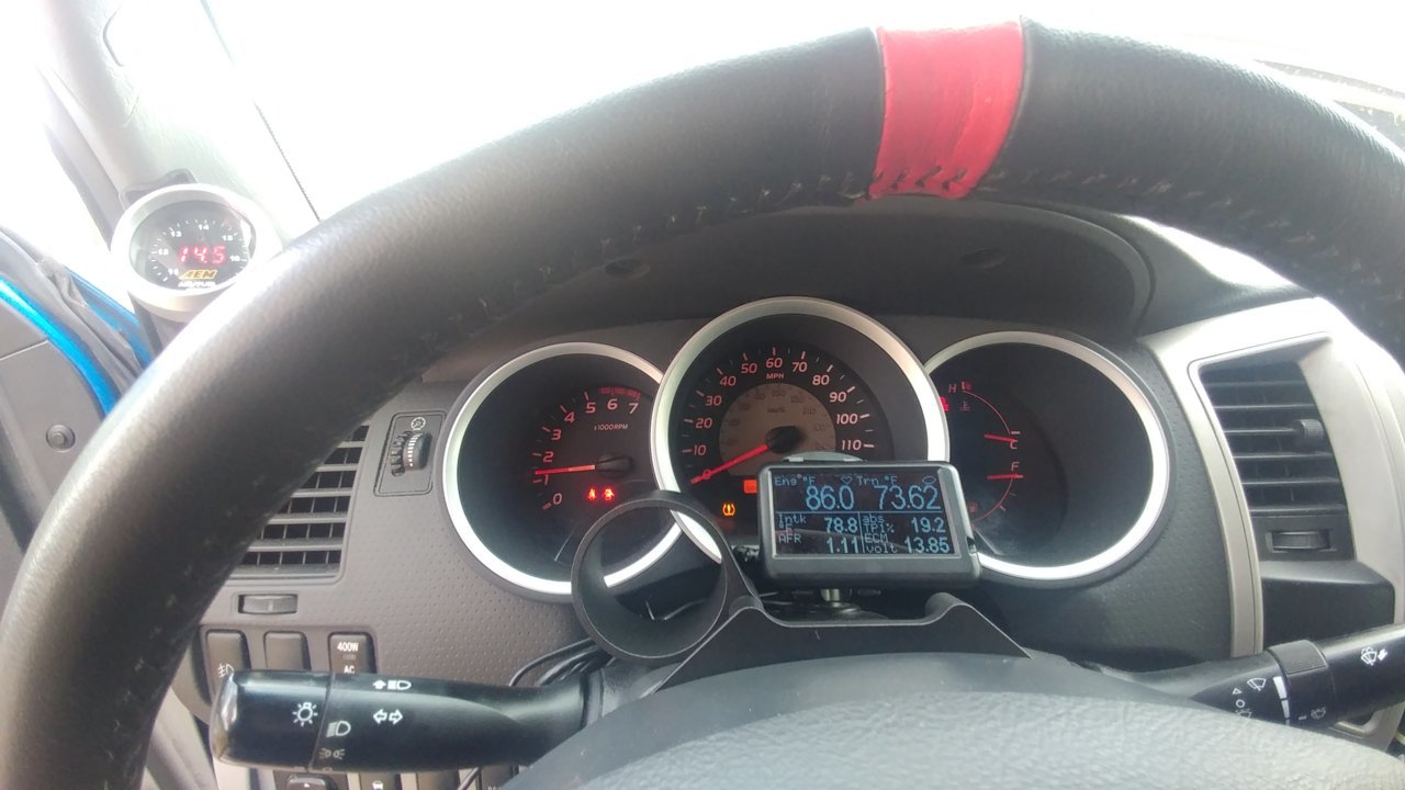

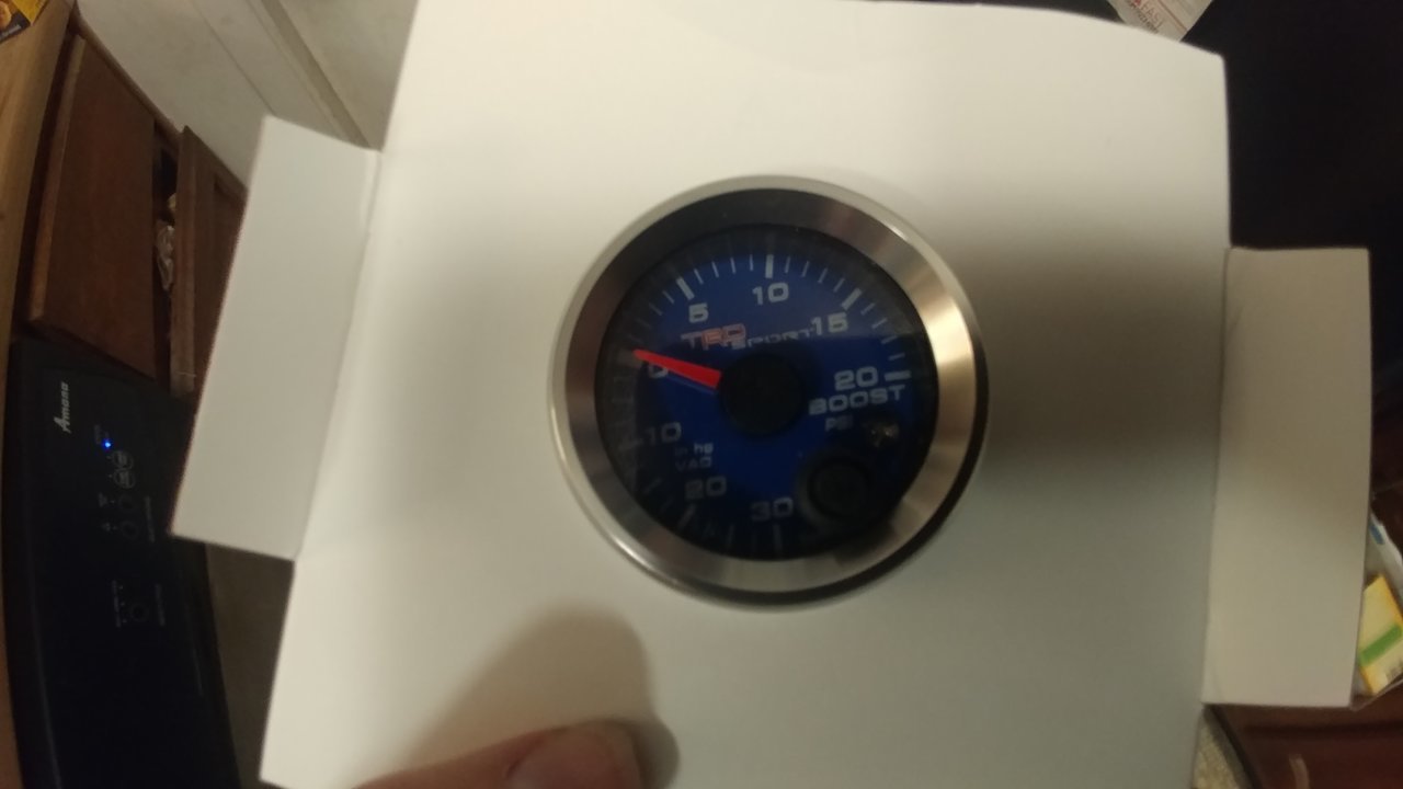

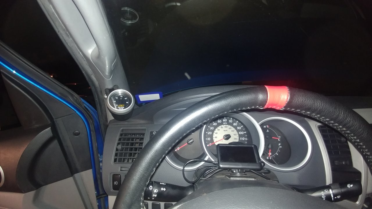

    Drive Back home went well no issues. Got my boost gauge and looks awesome! I'll need to buy new hptuner credits and reflash my truck and do some datalogs but truck feels really good.

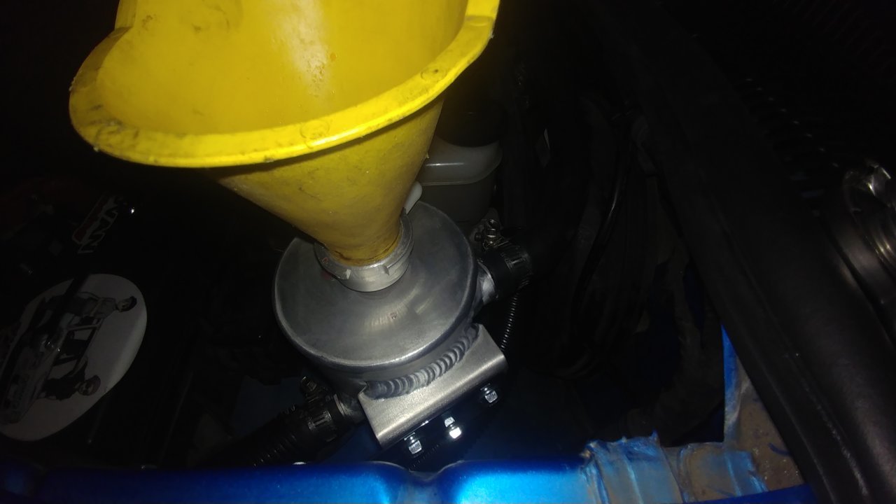

    It was a challenge to get these two mounts to work together but it works well enough.
    Now onto my favorite job. Wiring.

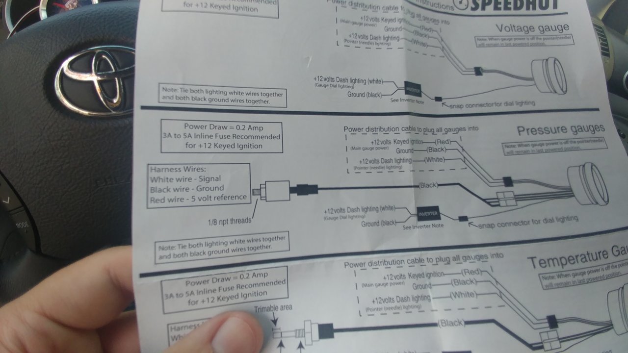

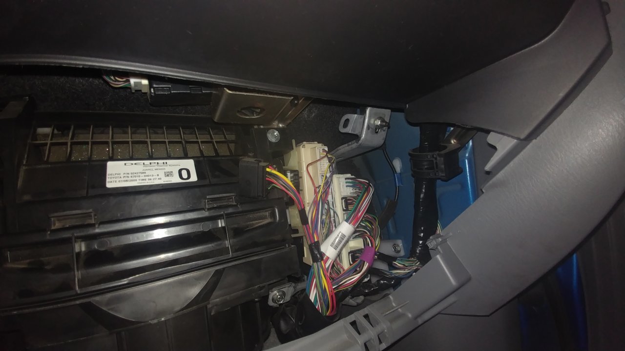

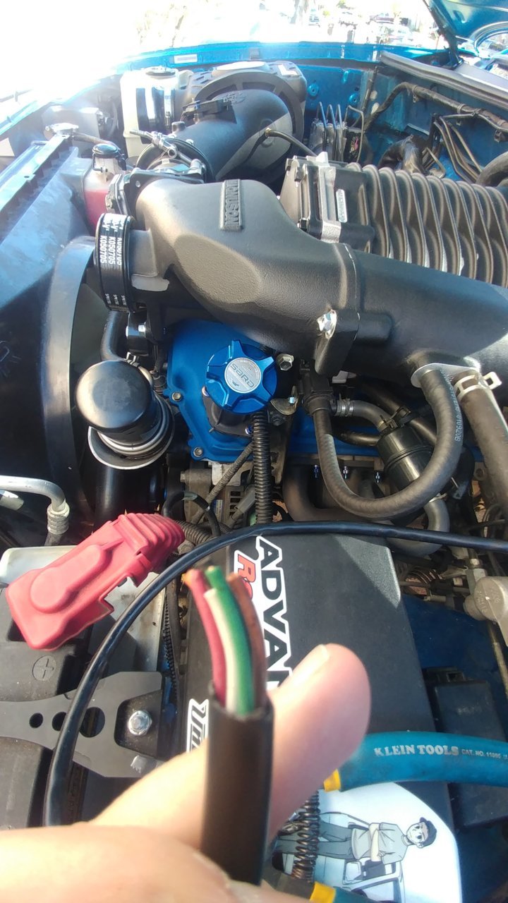

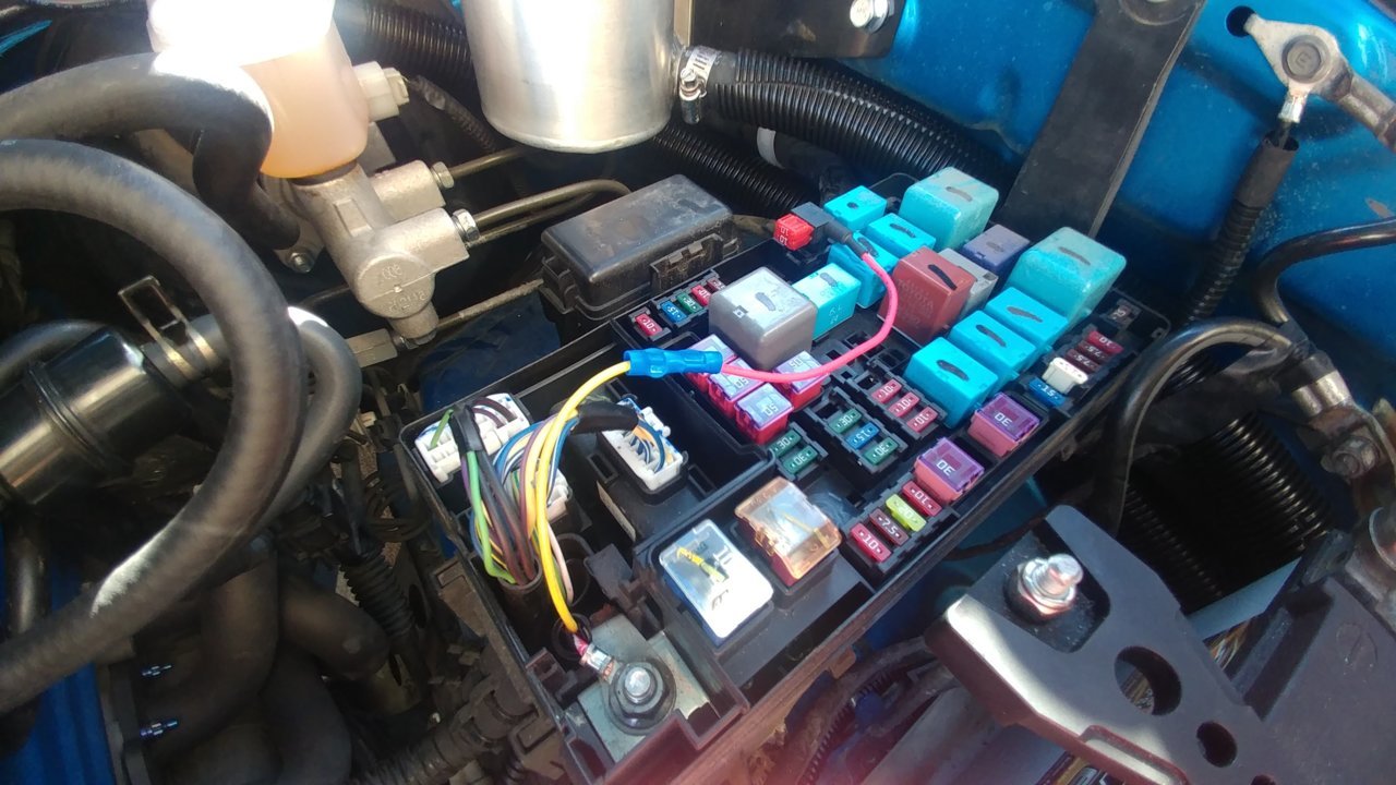

    Sensor wiring all done minus cleaning it up under the dash. Next will be power
