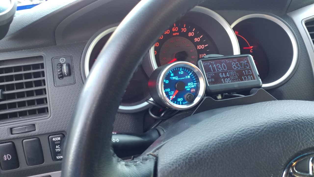

    Install is about 3/4 done. Cleaned up wiring and powered the gauge. All thats left is the signal for the light. I'm hoping the fuse 10a tail dash panel will be correct. I only stopped cause the wind is super strong right now. So now I can go back to playing cyberpunk.

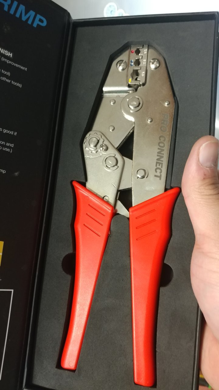

    Wiring drives me nuts. I can do automotive electrical projects, I just need to be in the right frame of mind. My last project was wiring up the dual ARB compressor in the bedside cubby mount. Took me a few hours to get it all done right. :oops:

    Crimpers like that are the cats ass. Helps make everything look pro!
    How are you liking the SC so far? Great job on all the mod installs, everything looks so well put together and clean :thumbsup:

    They are man crimpers for sure, sometimes gotta double fist it but its a tight crimp. Lol. Supercharger has been fun. Surprised many peps even myself. Per the boost gauge when it's at peak tq its a 5psi and at the end of the rev range its at 6.5-7psi (not jet in bypass and cooler weather?). This is with the stock trd tune so I feel there is potential even on the stock sized pulley with the hptuner. I also learned from @JustDSM that hptuner for the license needs more than the just the vin to license so you can tune. Its vin, calibration id, and one other thing I'm forgetting. Im not upset about it just a learning hurdle and food for thought if peps wanted to tune n/a then go supercharged. I did finish this today.
    Tail 10a in the dash fuse box was perfect for the light. Also learned one white wire is for the needle and the other w/the invertor is thr light.

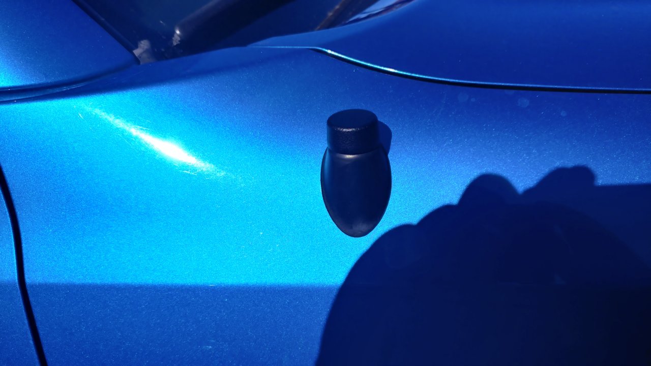

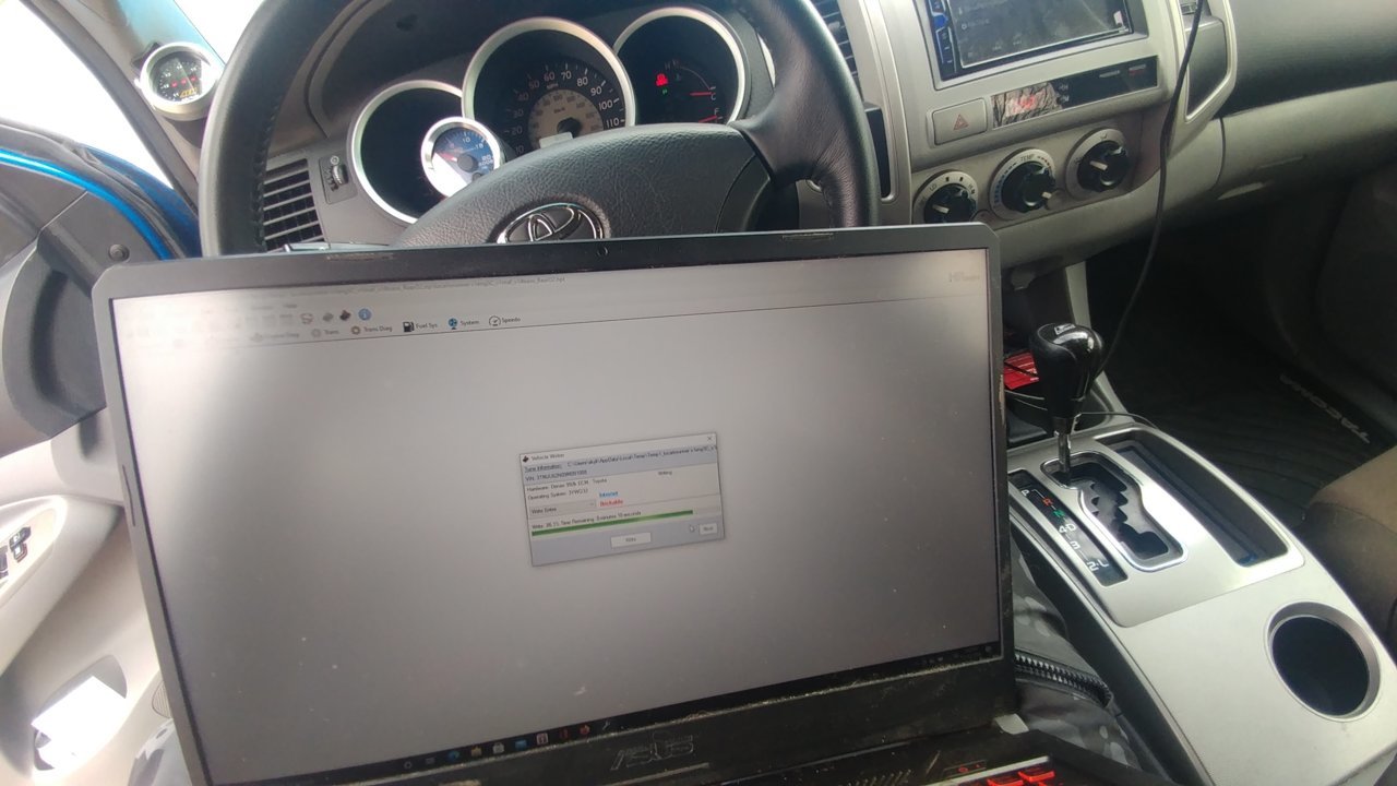

    Not much of a mod but its cleaner than an antenna. Unless I get that trd desert intake. I'll prob do some tuning later today, waiting for traffic to clear on the wangan.

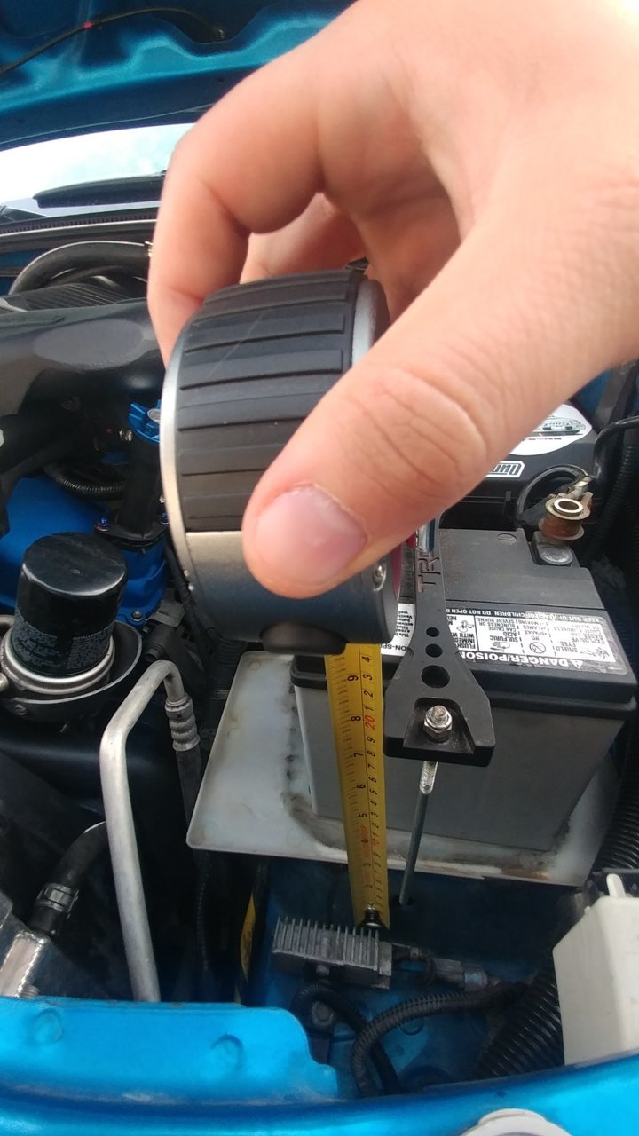

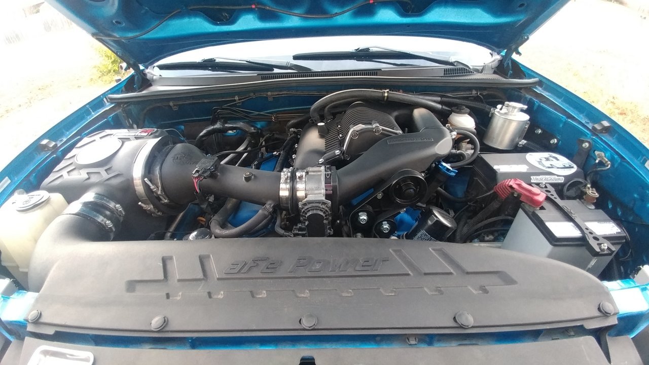

    Took some beauty shots

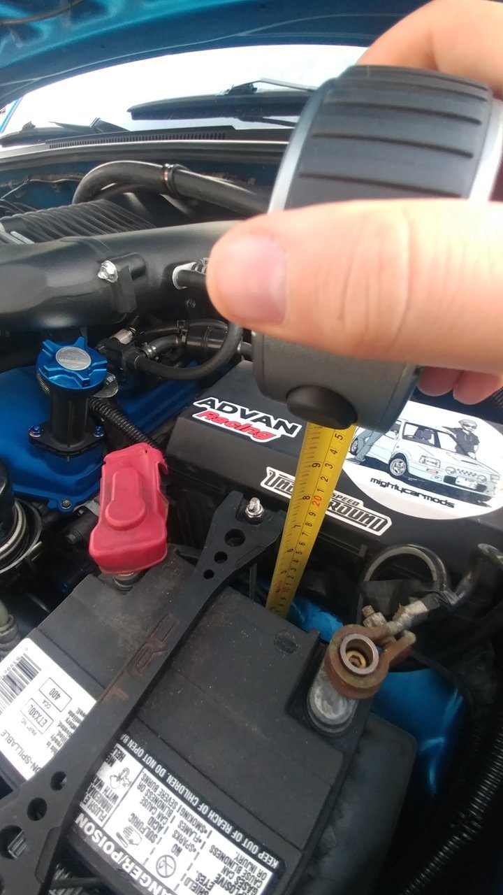

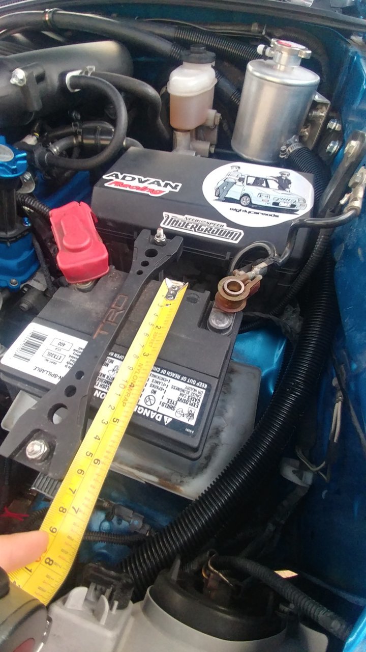

    For those wondering how small the battery is. Also did some measuring for a new titianium tie down I'm working on so I can put this one back in my 4runner so i can do race truck stuff with it.
    Front j hook about 8 1/2 in, back about 7in
    Retuned the truck with @JustDSM always hit it just right.
    Per the maf flow rate it converts this truck to make around 350 at the flywheel. Not too bad. ATM the moment I'm taking my cusco sway bar off my 4runner to see of it'll install in on the tacoma. The 4runner got a 3 way adjustable superpro sway bar vs the cusco which is not. After that its time to plan what tI add to the taco next year.

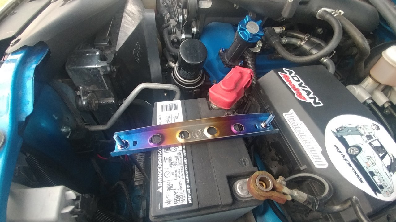

    Upgraded to a titianium tie down. Much lighter the aluminum one. Gonna have to get new terminals too.

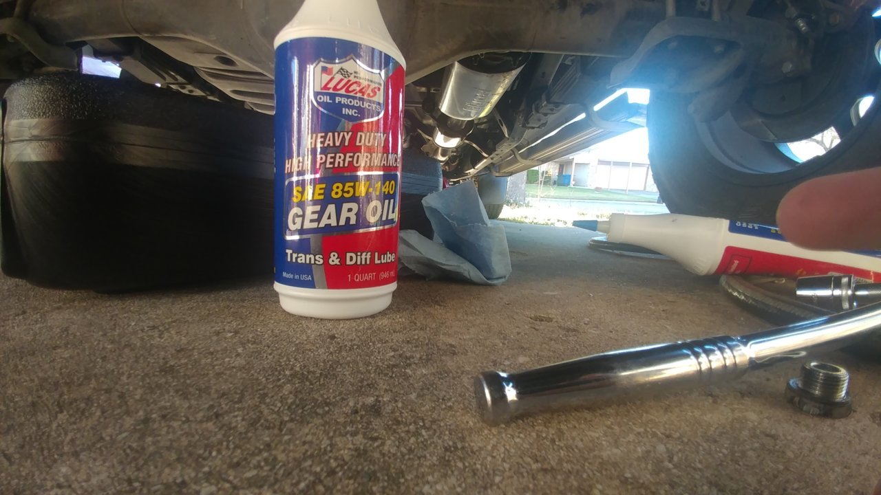

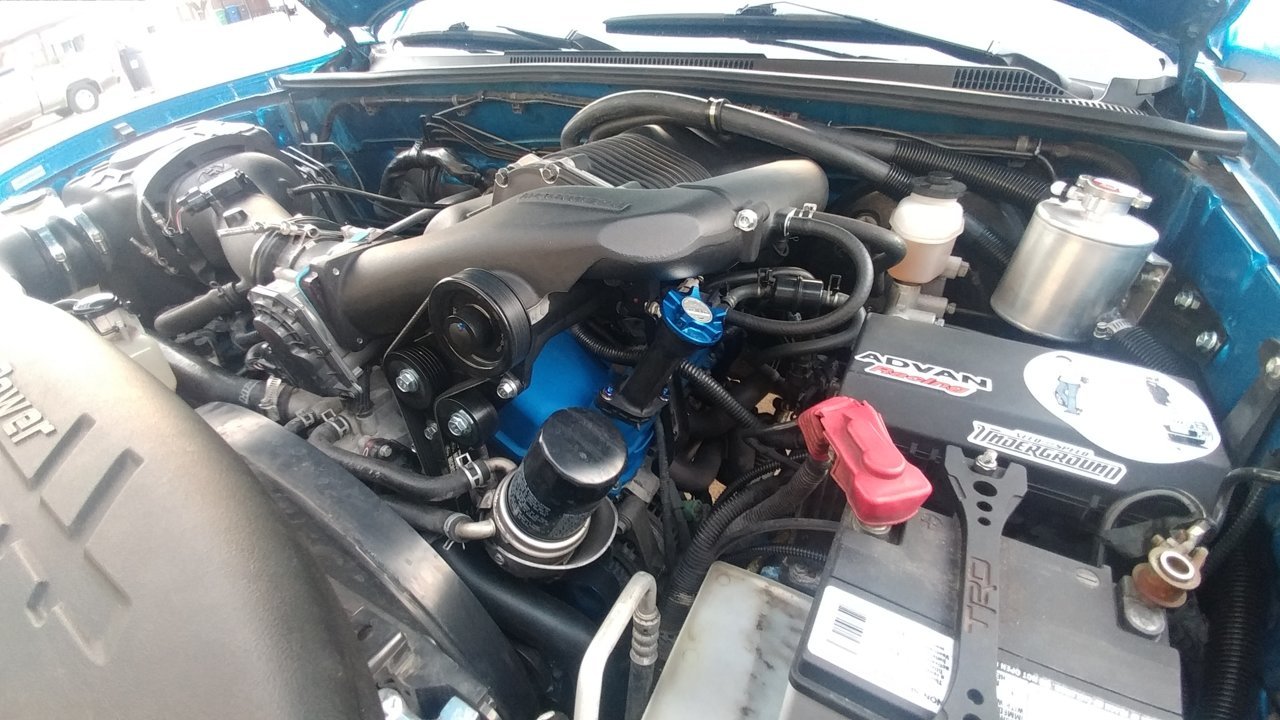

    Added some thicc sauce today too. Old oil was amber and no presents on the magnet.

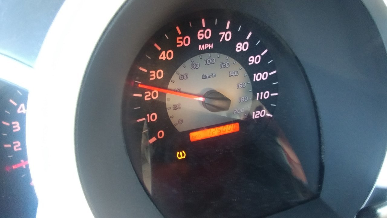

    Needs more air in them tires

    36 All around. Been like that since I got the tires discount didn't reset it and i haven't either. Lol.
