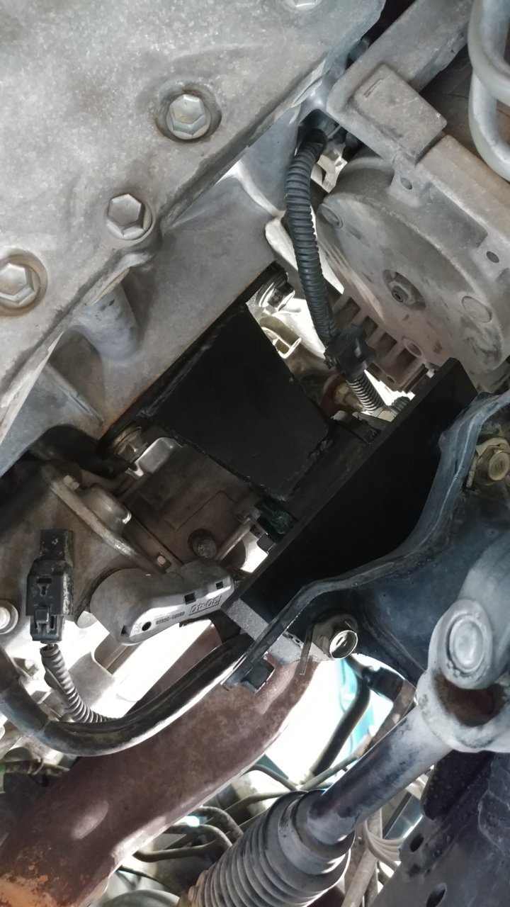

    Are you running their master cylinder and the bigger tundra brake booster too?

    Yes

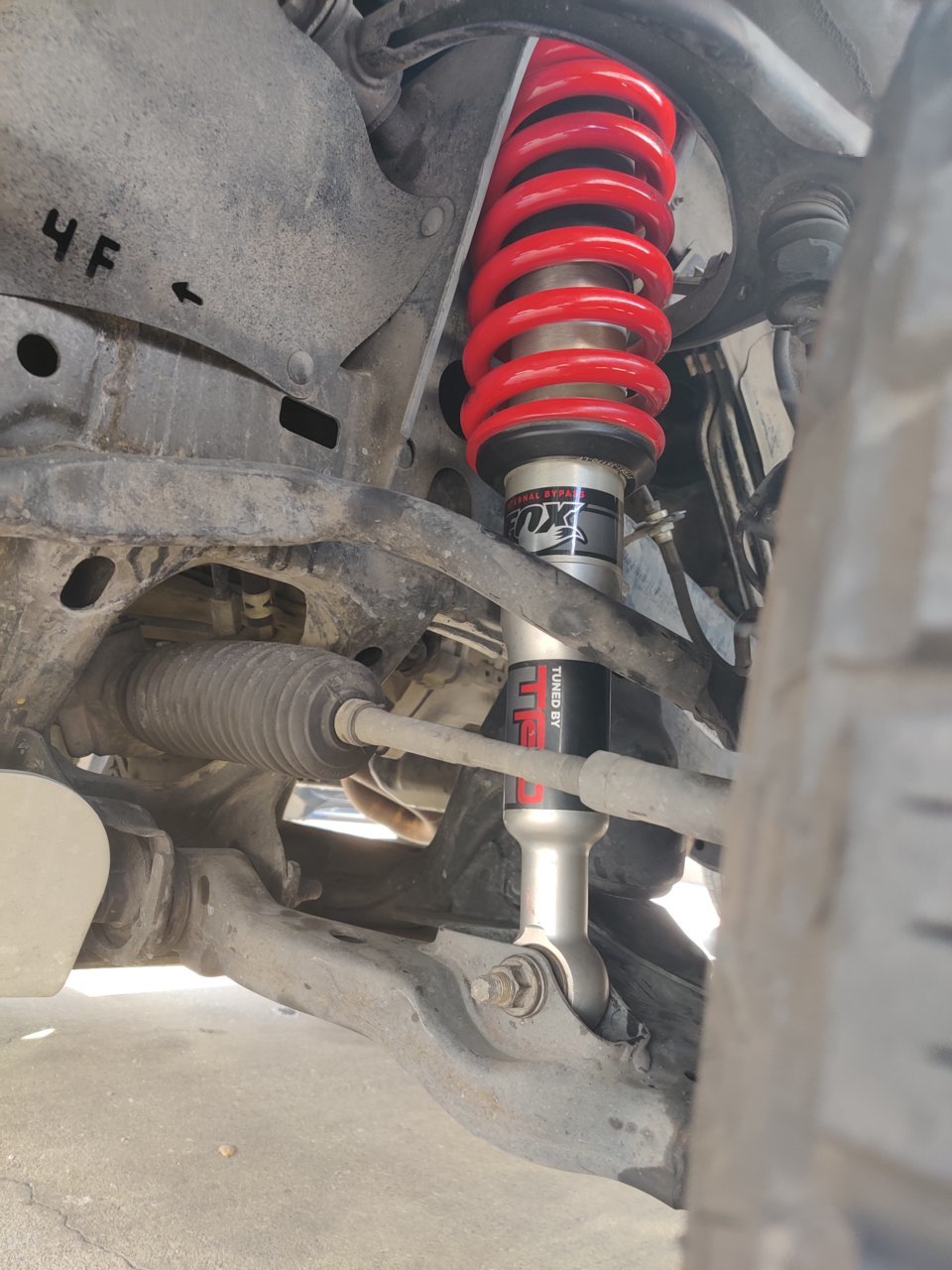

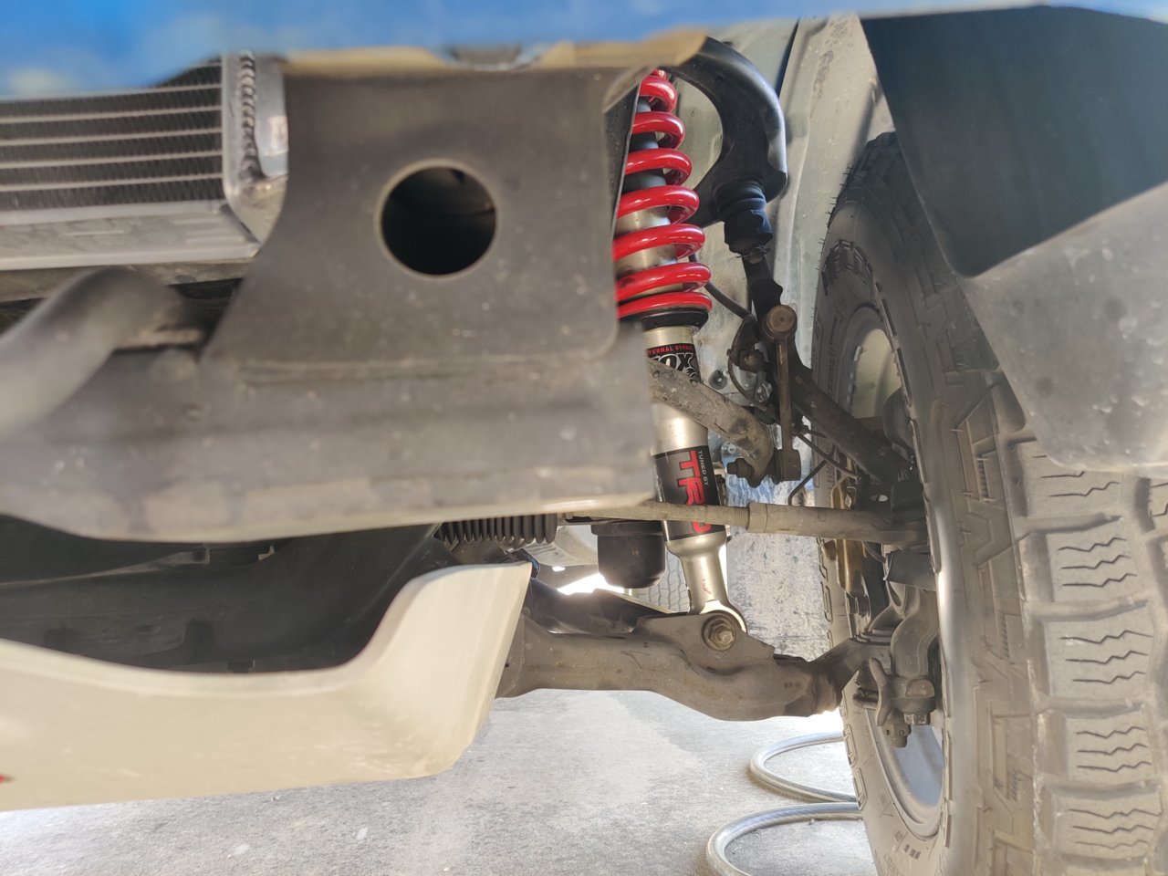

    Should be done on Wednesday, at least with the shocks.

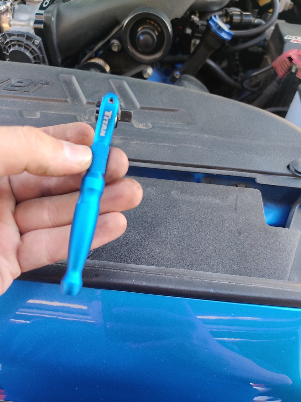

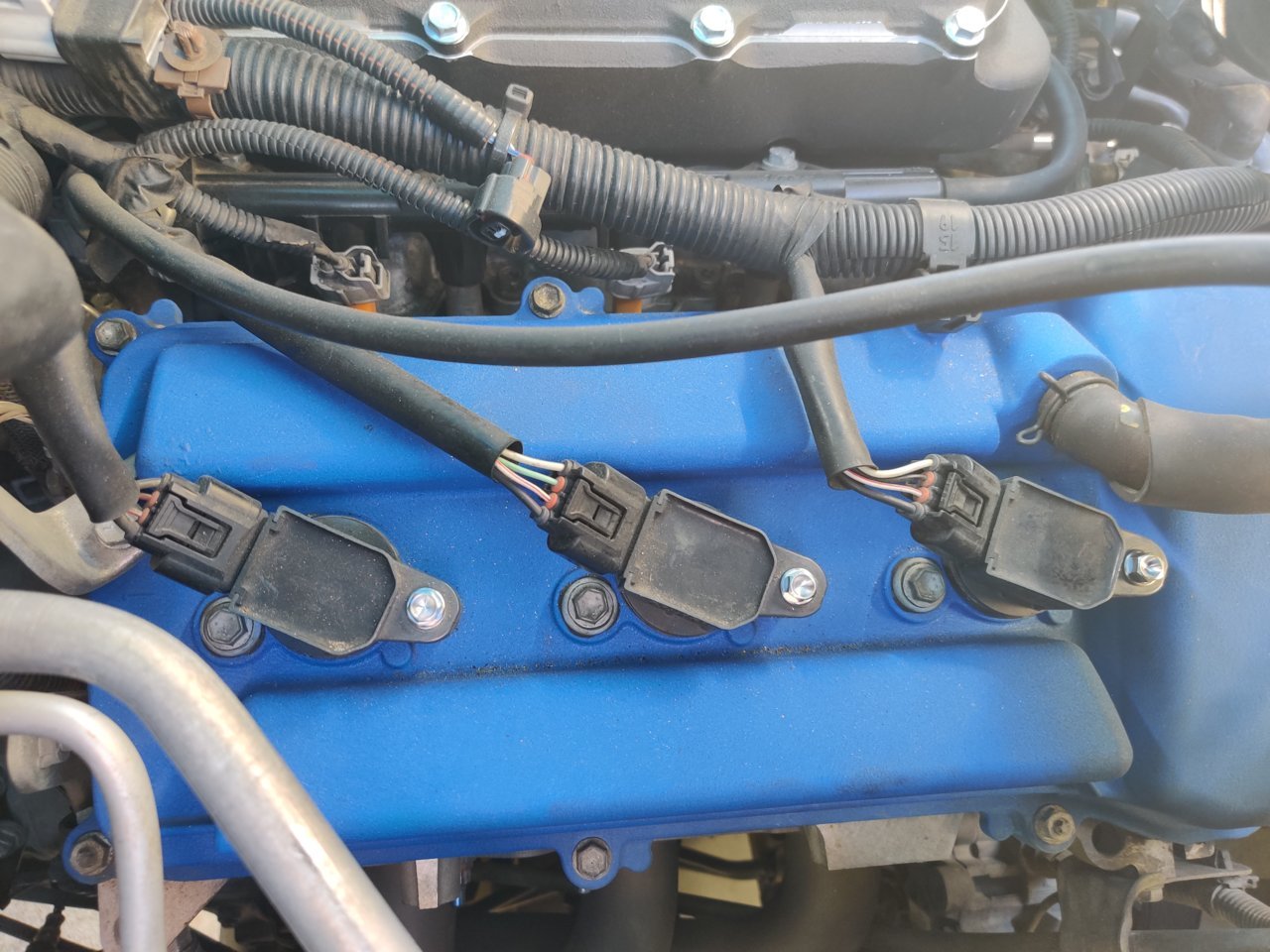

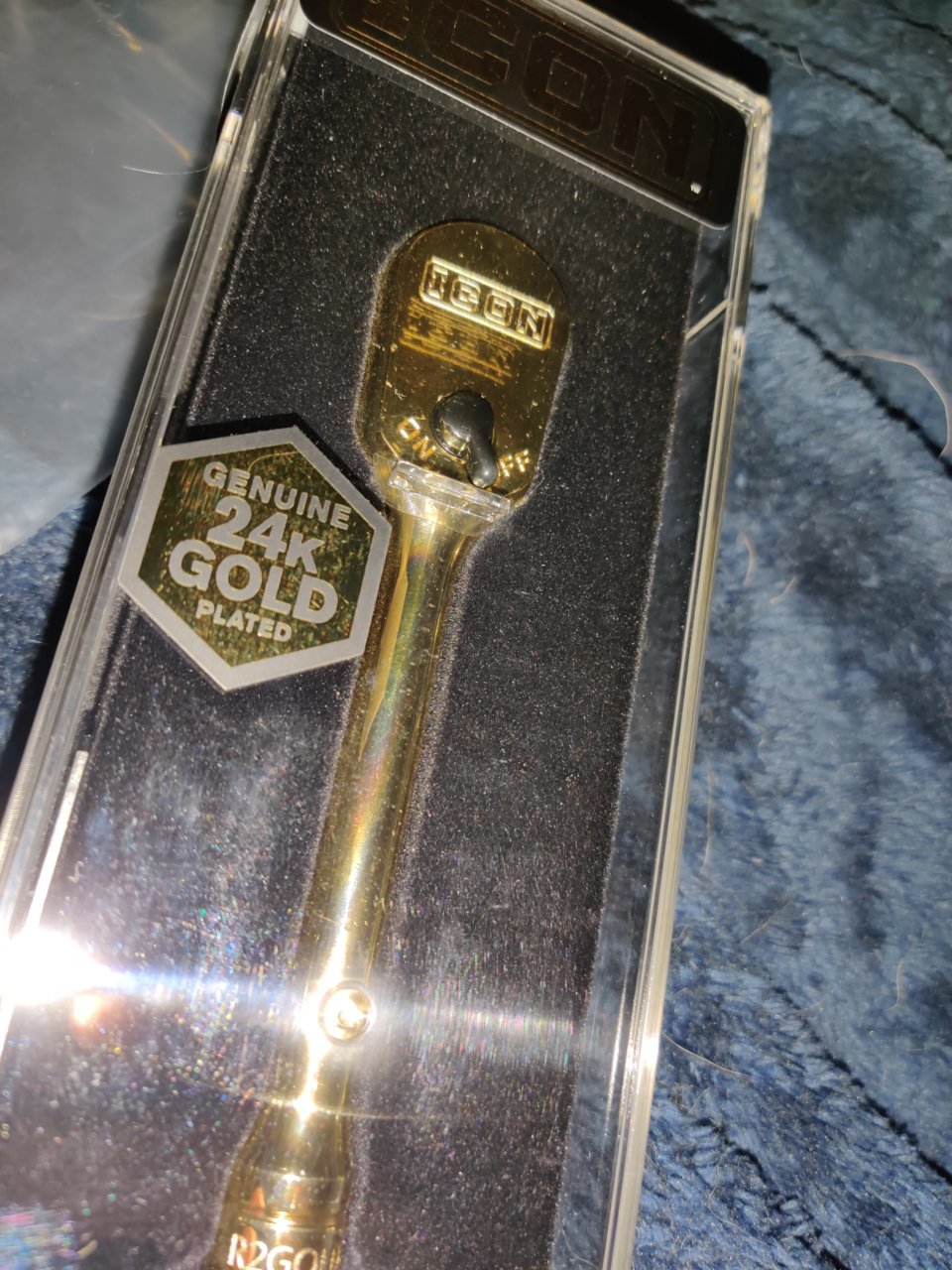

    I took a page out of @not_nick and got some ti64 hardware. Nice cheap (for titanium) and light hardware. Only negative thing is the head went down to 8mm. Just gotta get used to it using my taco ratchet.

    Nice, glad to see i've made an impression on such a well built truck! I've been meaning to do more titanium bolts but haven't gotten around to it. Coils were a good place to start because there's pretty much no load on the bolts and i had a few that size already. I was a little annoyed at the 8mm too, those are the only thing i use that socket on lol

    Thank you for the kind words! I agree with the no load was a good place to start lightening what you can.

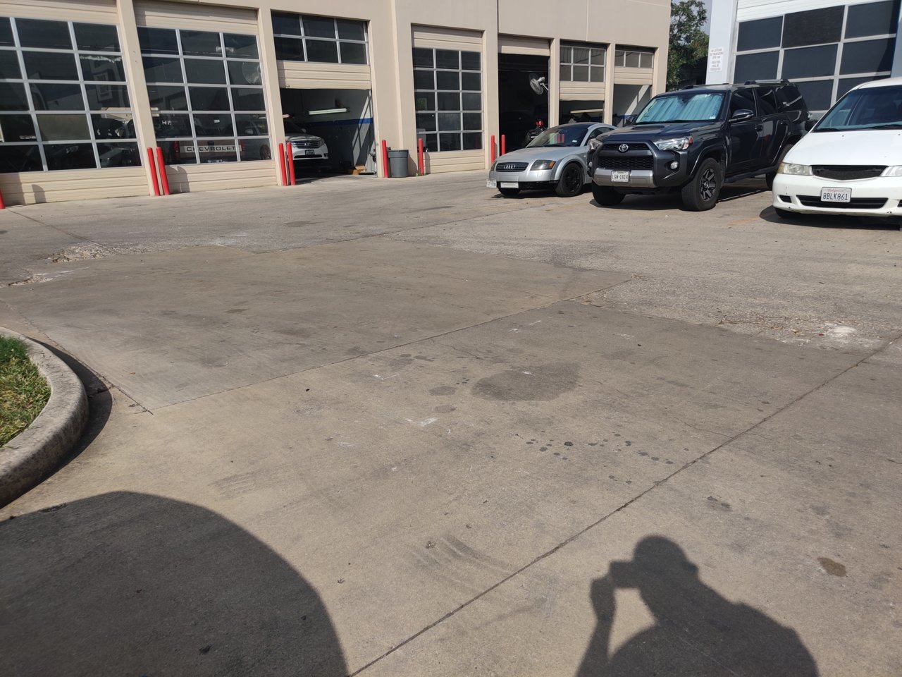

    Itza baja trok nao.
    Saw this at the alignment shop. Guy has a bigger led than most trucks on here.

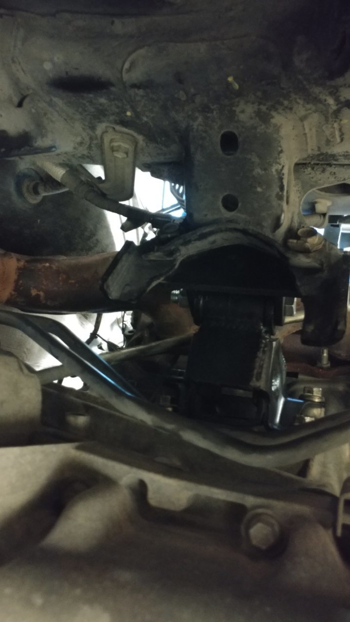

    Simple, cleaner, and a tad bit lighter with these frame caps. So I'm happy with that squareone creations actually delivered a product versus the scumbags at custom tacos (i don't remember the name but they stole $20) so all in all a easy thing to do.

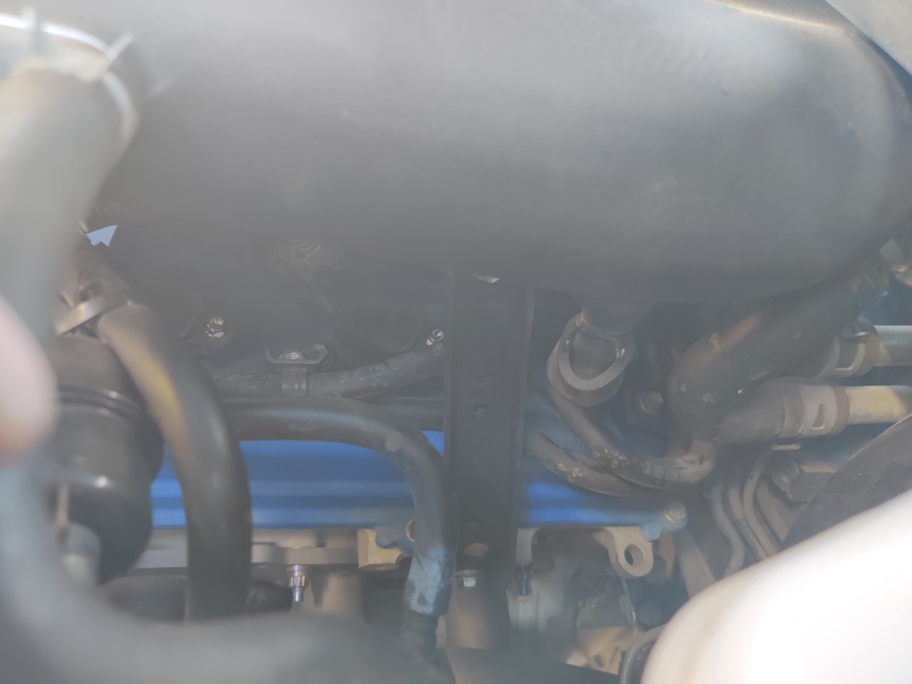

    What's the benefits of changing over the mounts? I'm curious and know very little in the performance automotive world.

    Fixes the engine in place so the engines own mass and inertia cannot rip the rubber isolator at best and at worst constant pounding cracks the frame or hits the oil pan and cracks it. For performance everything is much more immediate, no delay really, vs delayed overtime with the rubbers slower and weaker resistance. If you look at stock 1grs revving you'll see alot of movement. These mounts are also lighter than stock.
