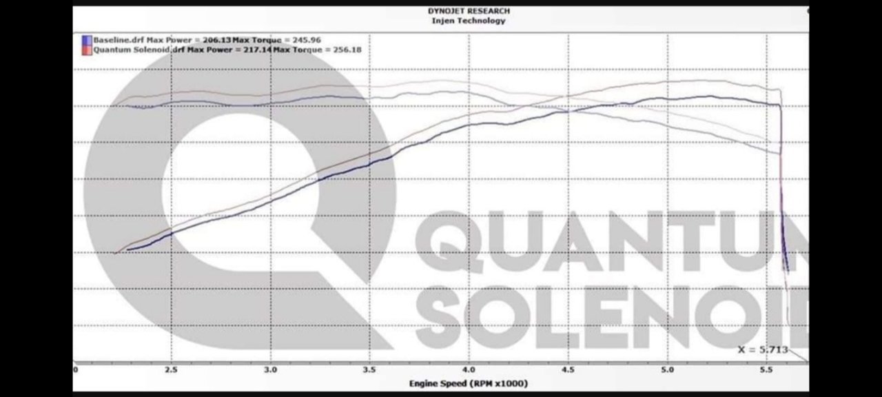

    Here is a dyno on FB

    Looks like it'll be worth investing and testing then. Might have to wait till I address my suspension and transmission.

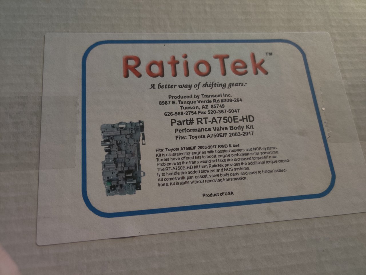

    shiftkit ordered. Will most likely install it by next week. Then we can get back to the power adders and other things.

    What kit though?

    ratiotek hd

    I'm surprised you haven't done it yet actually
    I mentioned in one of the threads about doing another "how to" of the trans-go kit. I was mistaken though- I meant the sonnax zip kit. Not a shift kit or pressure changer at all- it just fixes the common wear/tear spots. Being my trans is +200k miles it couldn't hurt to freshen it up some. Pending the miles on yours...and if you're in there anyways...

    The ratiotek being ~4 springs, changing a couple settings and boring 3 small holes,
    The sonnax looks like it's none of those things and doesn't change any settings per say. It just fixes known wear/tear issues.
    I would say with almost certainty that they are compatible with each other.
    Here is the a750 sonnax kit for you to look over
    https://www.sonnax.com/parts/3477-zip-kit

    https://oregonperformancetransmission.com/product/SNX-A750E-A761E-ZIP.html
    This is the same place I purchased the ratiotek. Thanks for sharing the sonnax looks like both will be going in then. Wot definitely has no problem.

    So in the research that I have done with both the ratiotek and the sonnax is that they are mostly compatible. The only issue I see is with the boost valve where the spring with the ratiotec will sit higher in the sonnax boost valve, causing a probable bind/ compressing more than it designed to. The solution seems to be to run the OEM booster and everything else will be fine. At least according to my brief research. I've only modified 3 of these transmissions so not an expert by any means but good enough to get by i guess. lol

    Once it's apart- you could mic it up to see if that has different dimensions. I would be inclined to use ALL of the rt kit and as much of the sonnax kit as I can.
