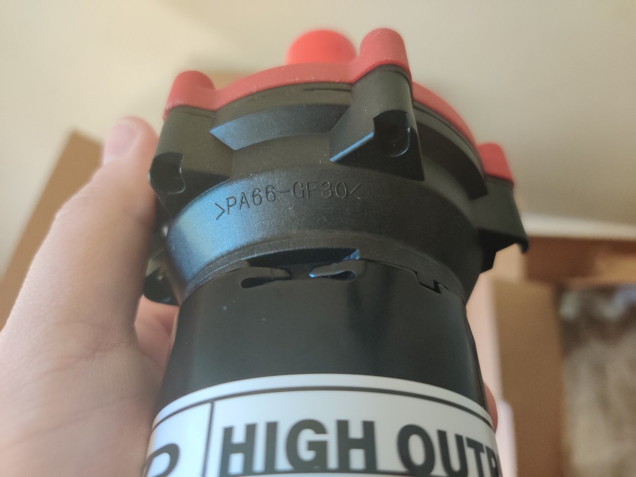

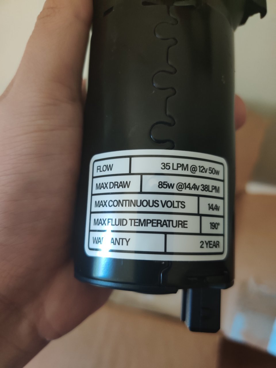

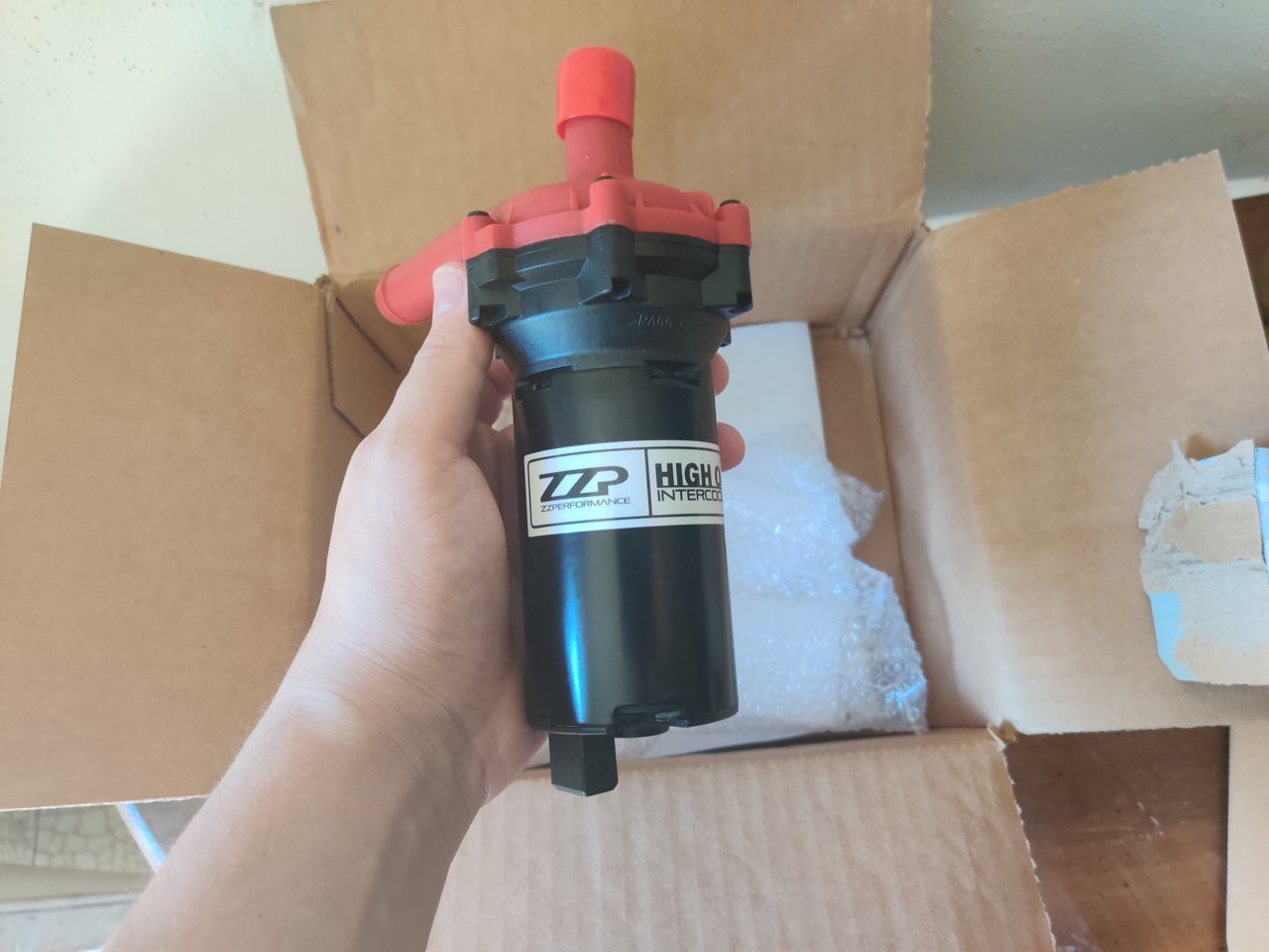

    Got the zzp upgraded pump.

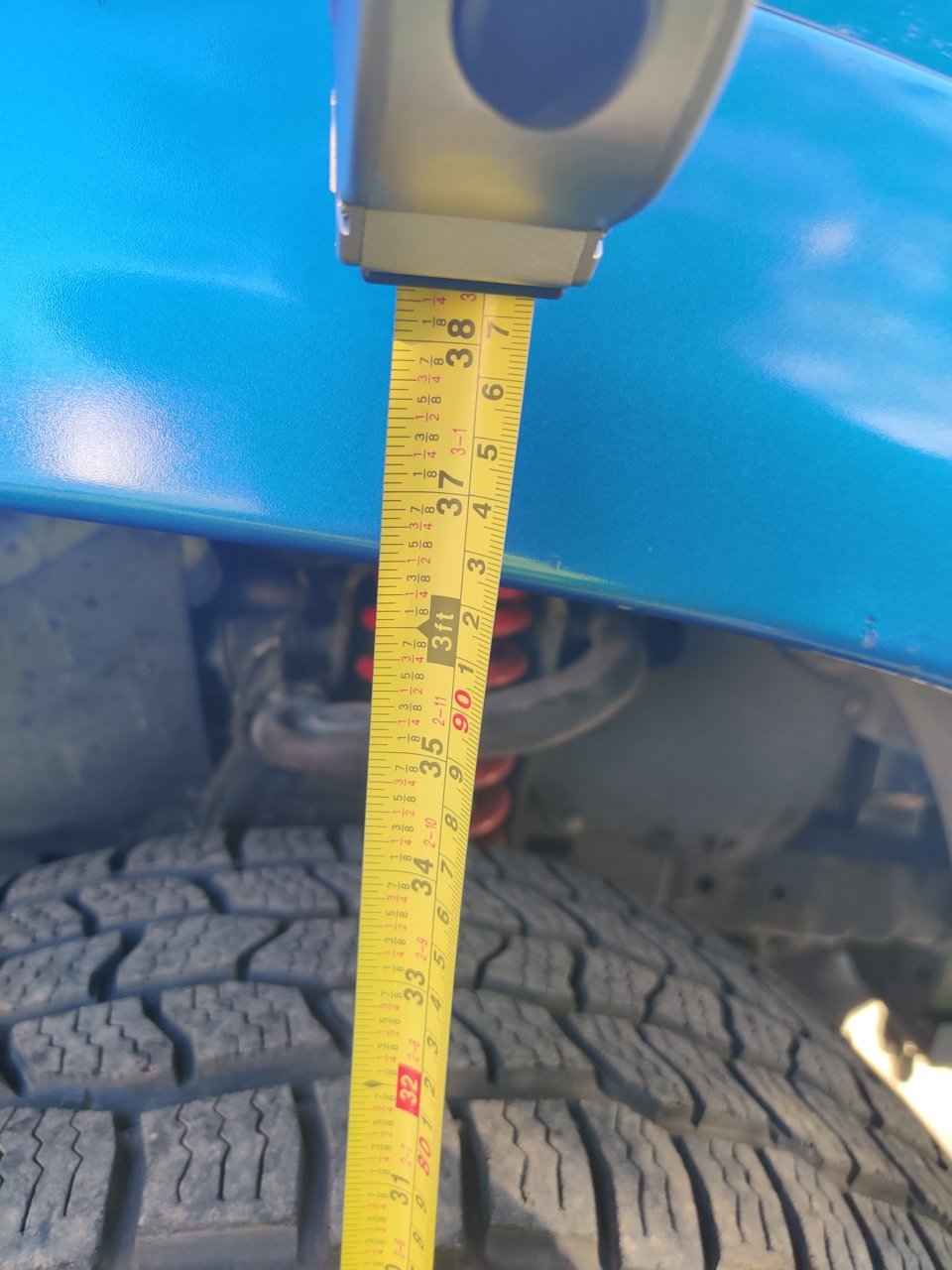

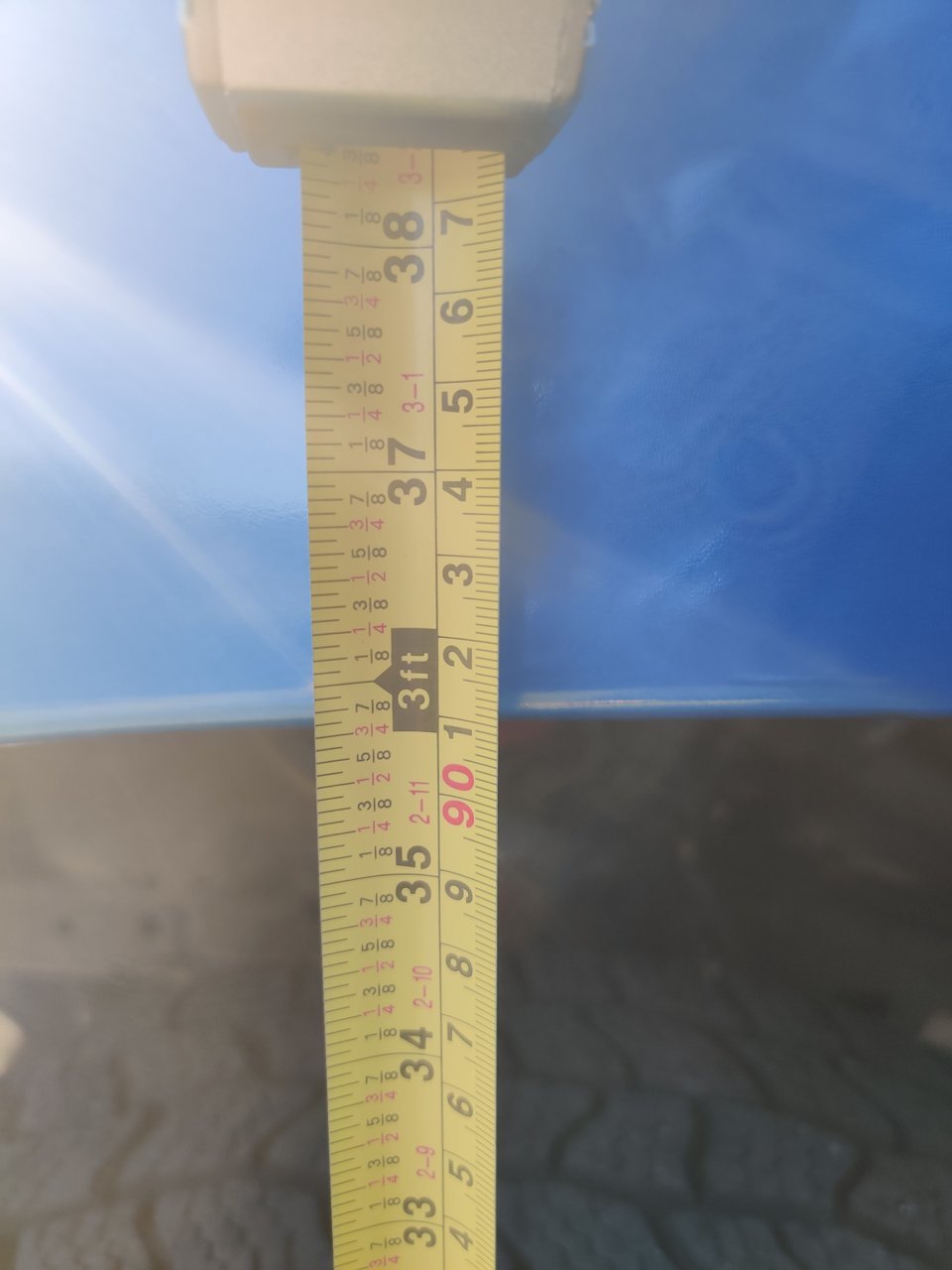

    Driver.
    Pass.
    I guess small improvement on the driver lean but the before was also pre supercharger so not Sure how much that's making a difference. Looks ok to me but could add a 1/4 spacer later when I change uca. Still like the ride more with the foxes.

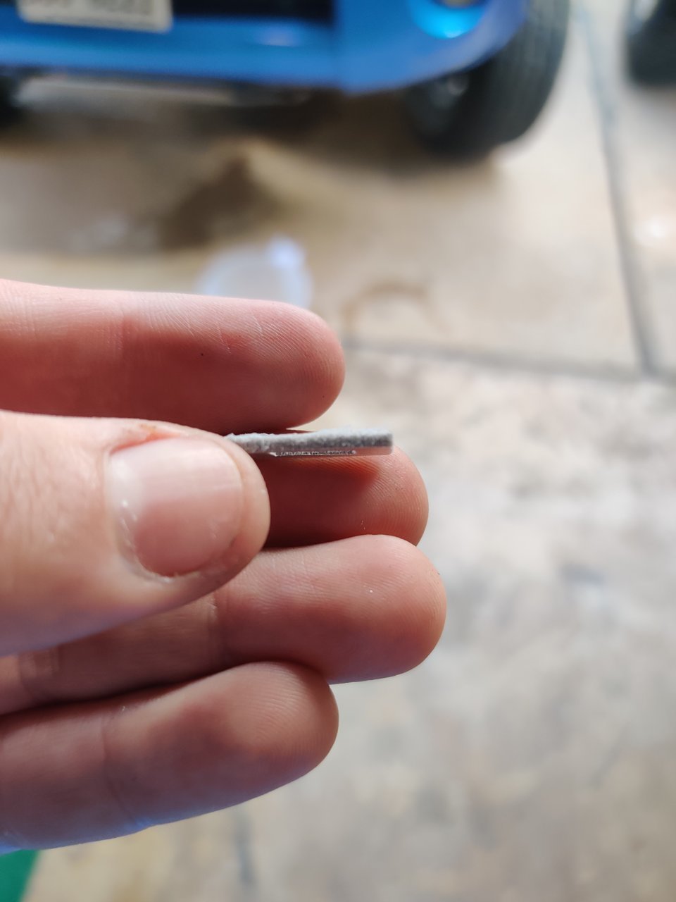

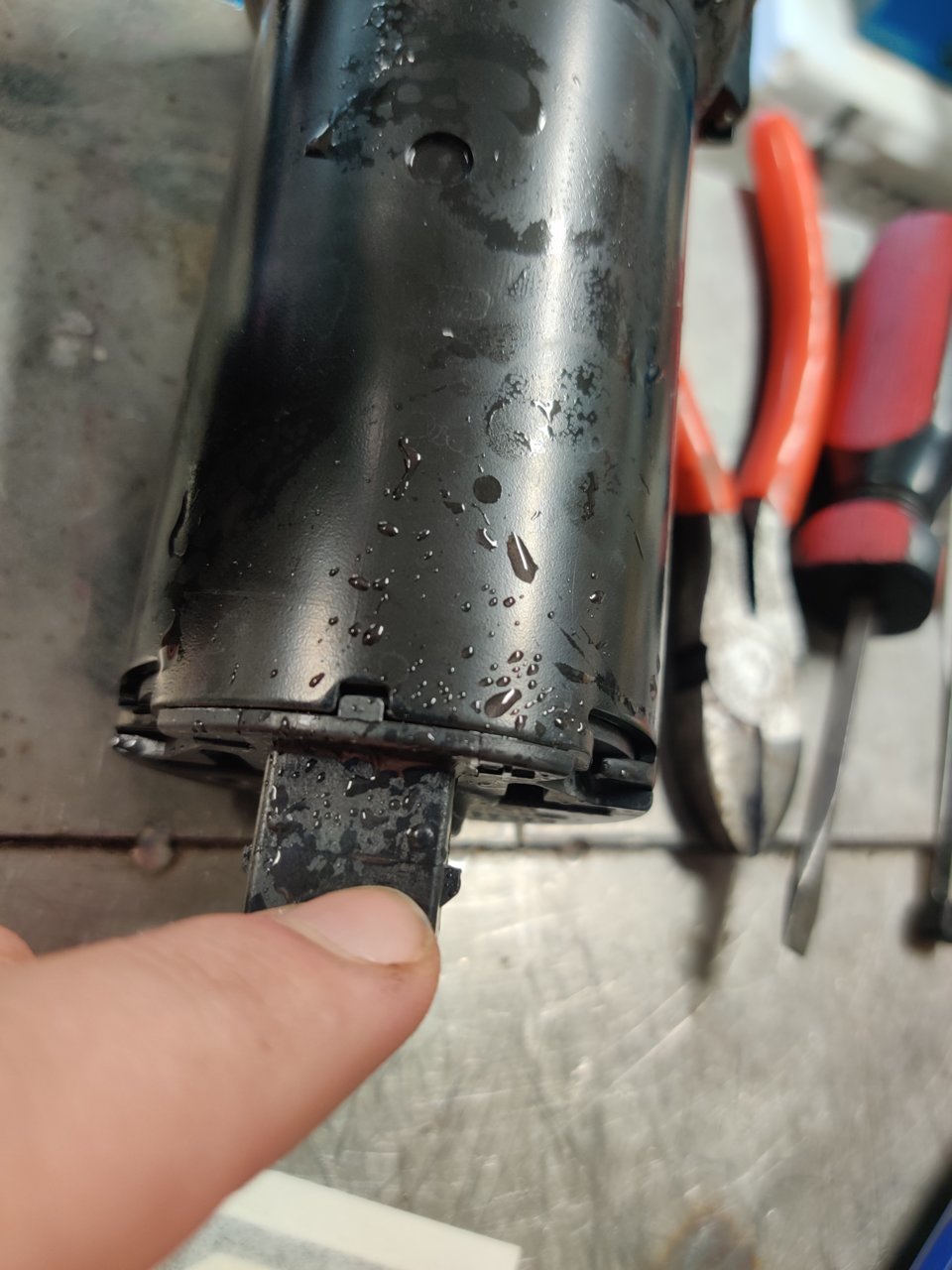

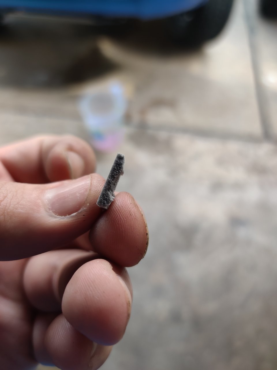

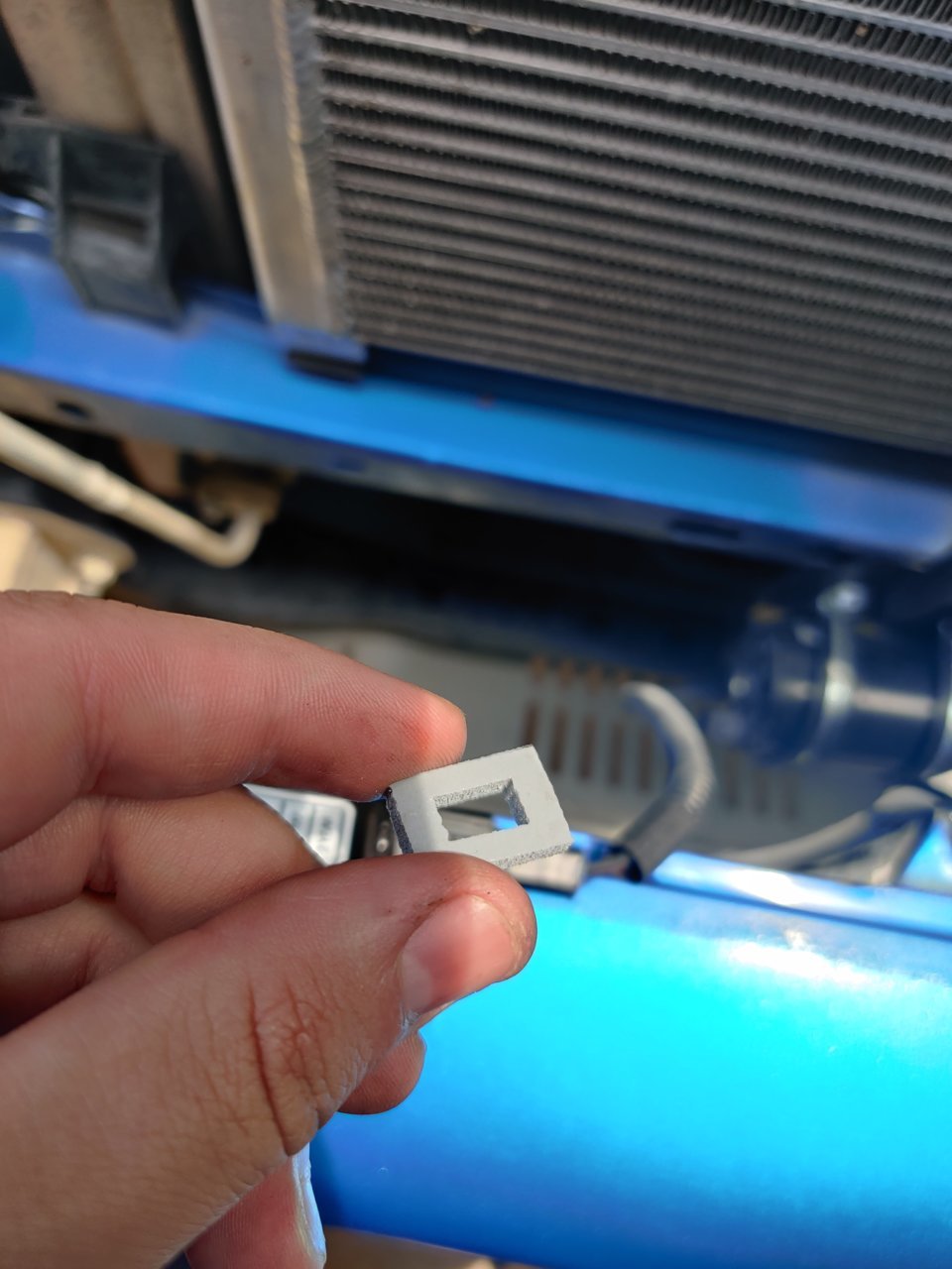

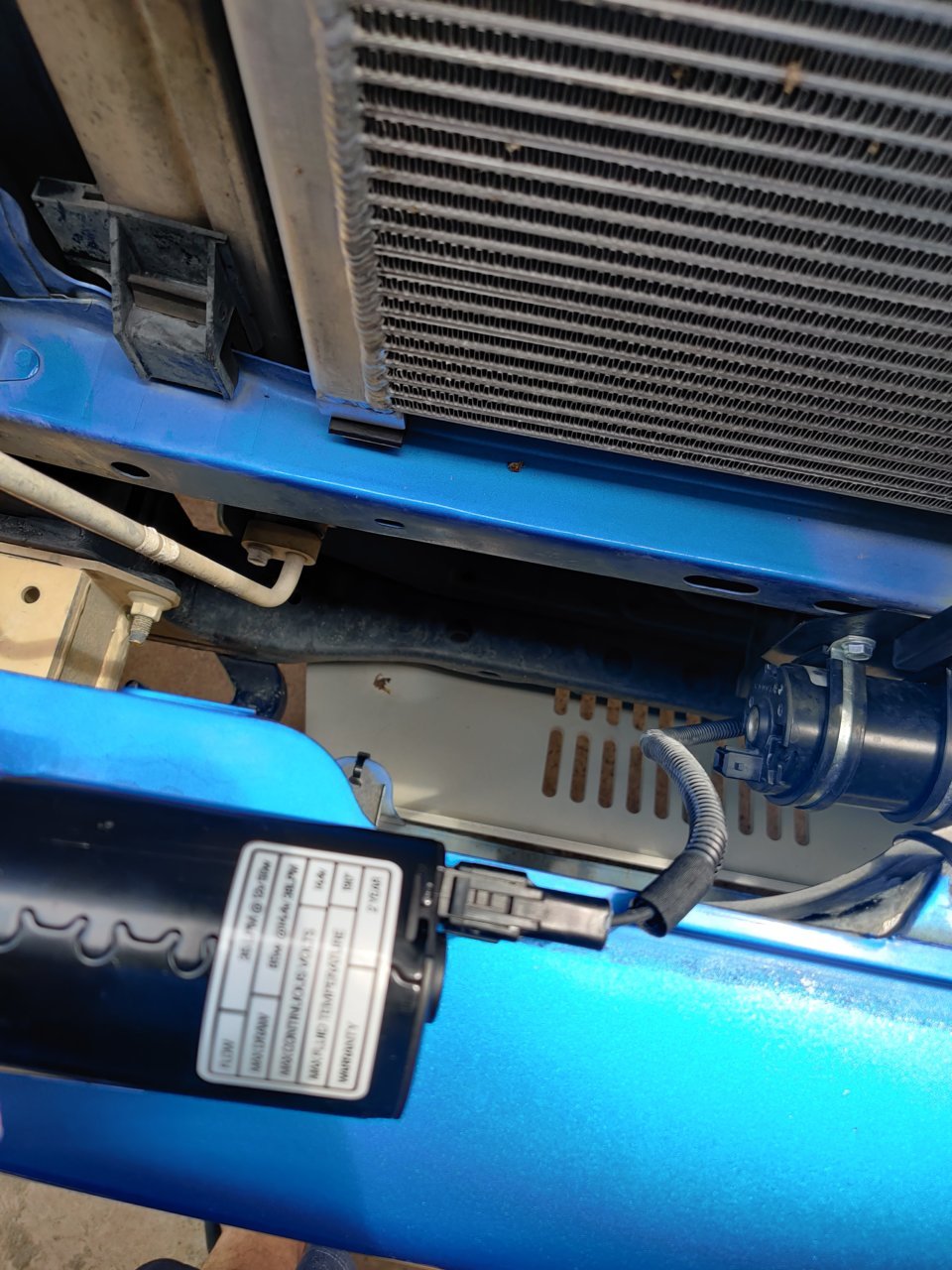

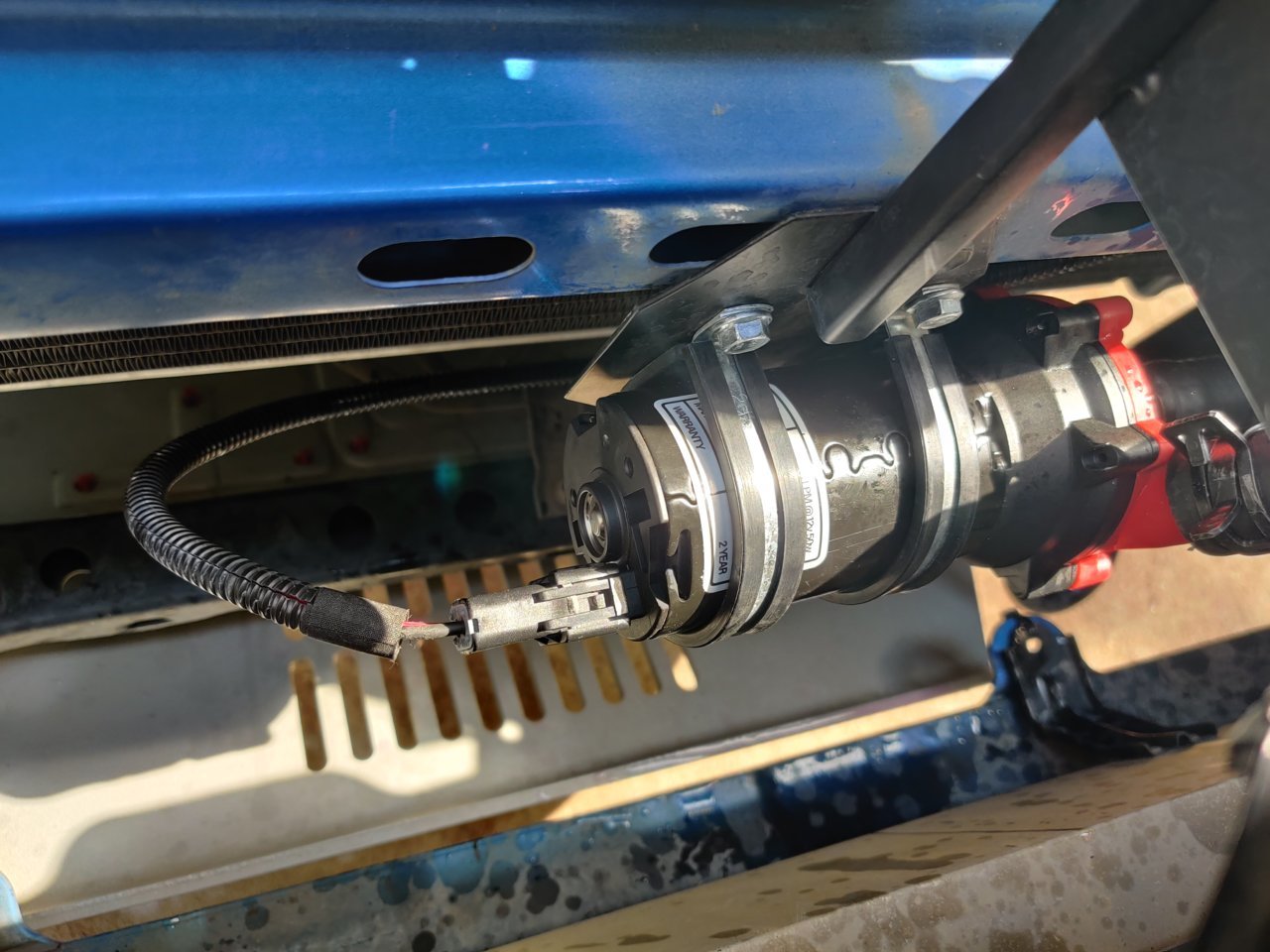

    So one of the reasons why the zzp pump has issues having a good contact are the tabs on the male end are really short when compared to the stock pump. Another is the foam seal pictured. I'll trim it down a bit and see if it'll seal better than work on the plumbing.

    Hmmm.
    So I cut the seal in half made a good difference in how well the plug engages.
    Tabs are bigger on the stock pump.
    Done so we'll see how the iat's do during the Texas heat over time.

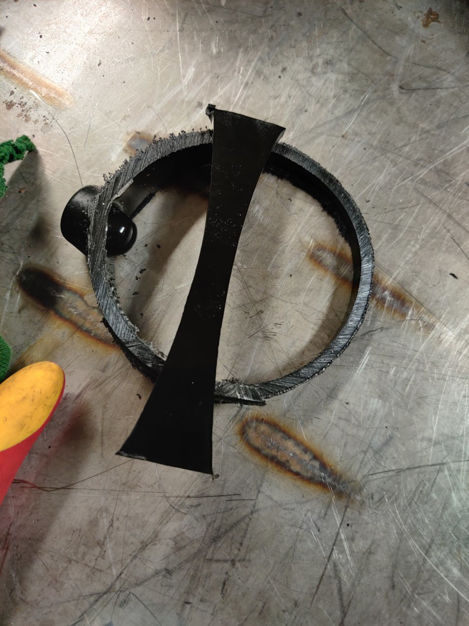

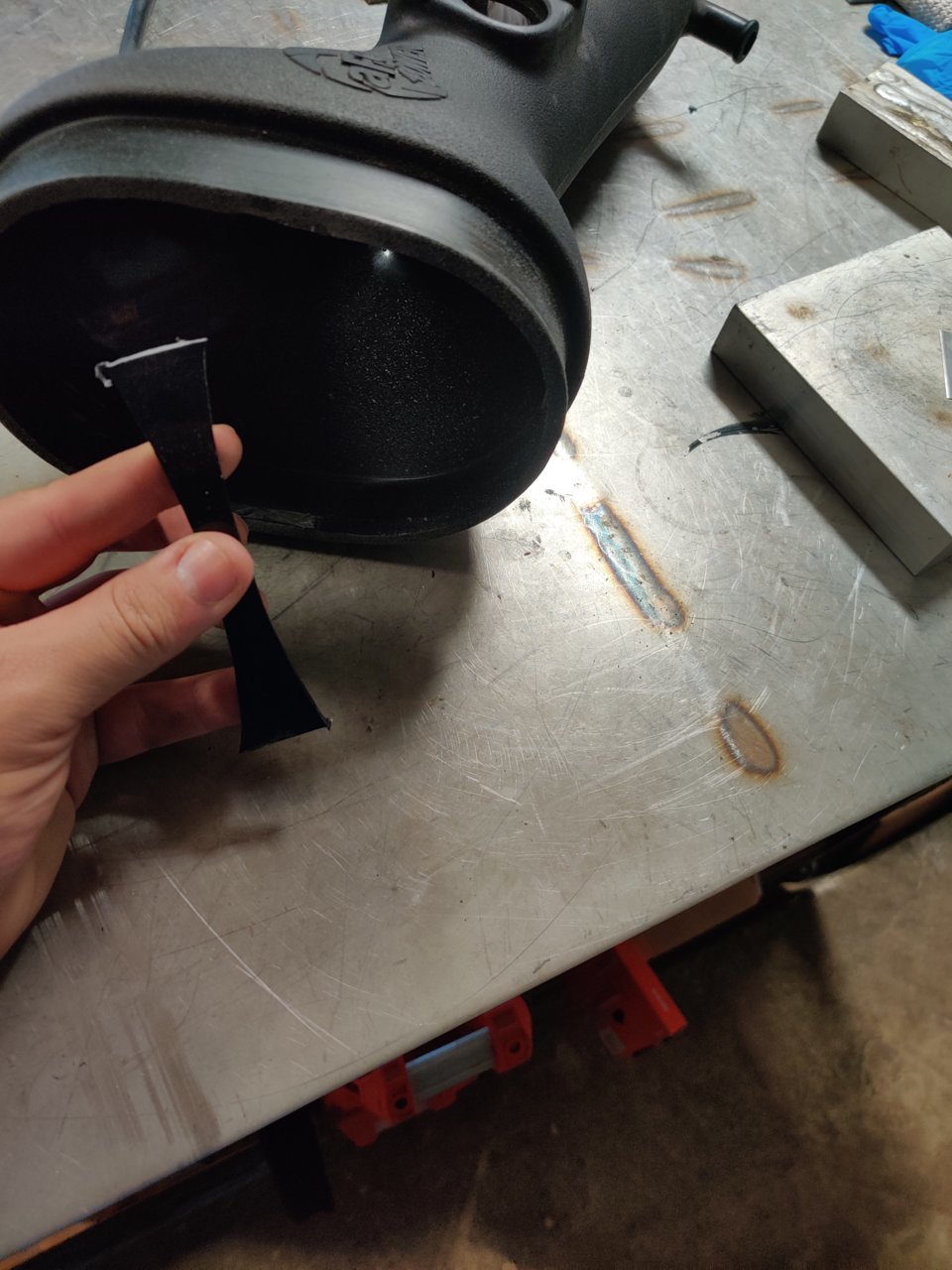

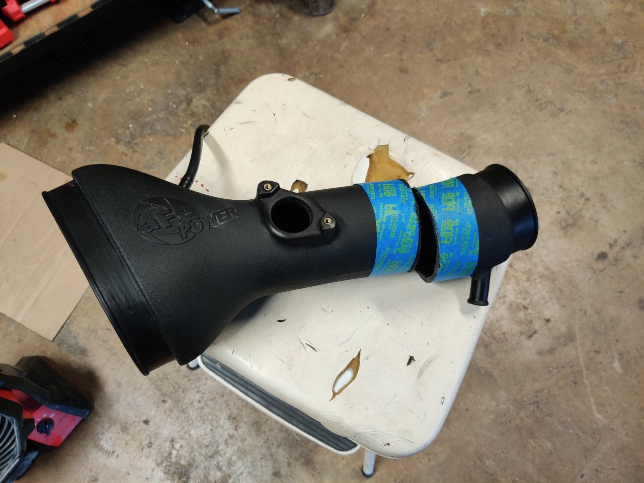

    @Torspd and I decided to improve the afe intake. First was get rid of this center bar. While it does add a bit of support with the when clamping the filter. I think it'll be ok without it.
    Next was to shorten the intake tube. With the throttle adapter the intake was basically in a bind. This will make installation and removal much easier.

    Intake back together and is holding well. Iat seem to respond better

    Still planning on getting the newer metal plug, for the pump? We can swap that in next time you're down, or even easily enough by yourself, if you cannot wait.

    I'll most likely buy it. It's super cheap anyway.

    whats the new pump plug? mine just came in seeing the plug fitment issues.

    AFE stage II intake, APR X1, URD 70mm Throttle Valve (ported and knife edged), NST intake manifold spacer, URD spec U headers, Denso IKH20, URD fuel pump, APR fuel rail, URD Y pipe, URD spec u catback, lightweight water pump pulley, Greddy sandwich cooler plate, Earls oil cooler, IPT valve body, FJ TRD shocks, Cusco front and rear sway bars, Energy Suspension rear track rod bushings and rear link bushings, Carbotech pads, Stoptech ss brake lines, Stoptech slotted rotors, Motul 600 rbf, Limited Grill, Painted hatch cover by me, Painted valve covers by me, Cobra CB, TRD rad and oil cap, Escort 8500, Autometer oil psi and temp gauges, AEM wideband afr gauge, Flexpod, Pioneer 400w speakers.
    JB weld. If it's good enough for a cylinder bore it's good enough for a intake.

    Torspd Custom Turbo kit [] Borg Warner 9180EFR Turbo [] Haltech Elite 2500 [] TiAL Q BOV [] TiAL V44 Wastegate @ 15psi [] CP Pistons [] CP Carrillo Rods [] ARP Head studs [] ARP Main Studs [] ARP Header - Head Studs [] Ported Heads w/ 1mm oversized valves intake/exhaust [] Brian Crower Forged Stroker Crank [] Darton M.I.D. Sleeved Block [] Kelford Camshafts [] Torspd 160* T-stat mod [] APR Large Fuel Rail [] Walbro 460 LPH E85 Fuel Pump [] FueLab FPR [] APR T56 Conversion Kit [] KP RACING Built T56 [] McLeod Racing Custom Twin Disk Clutch [] One Piece Aluminum Driveshaft [] MGW Shifter [] Custom lowering kit [] Ohlins Front Coilovers [] QA1rear shocks [] Custom Ron Davis Radiator [] Dual SPAL Electric Fans []
    A little sanding or a wrap, and mint!

    Most likely I'll just end up wrapping it in some gold tape. It worked well on the 4runner so should be ok here. Also for those that might be interested NASCAR will be at COTA so @Torspd and I plan on going there. In case others might be interested.

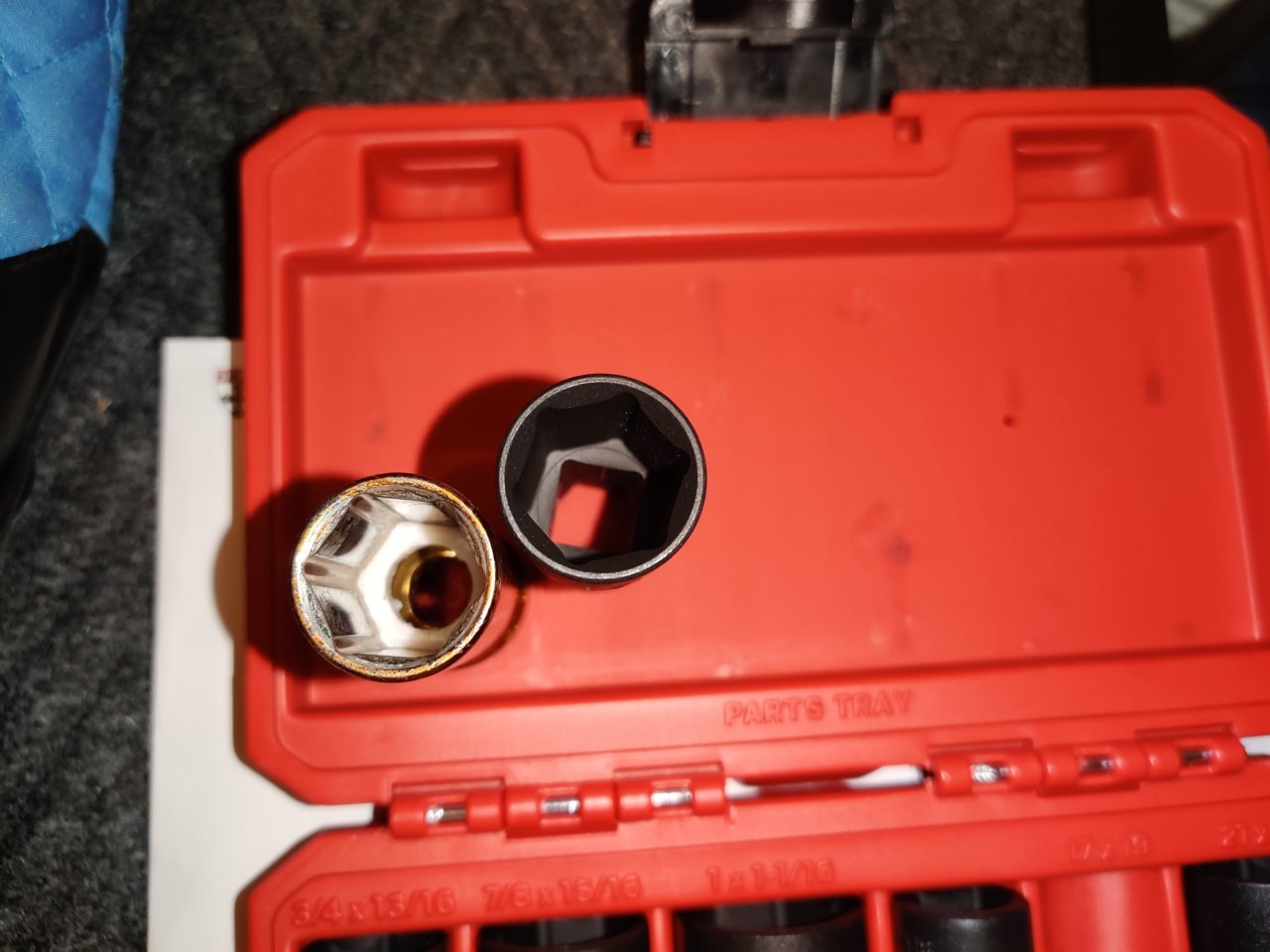

    Got these for the taco. And got a set of tekton flip sockets for the wheels. Look thinner then the old titan sockets without the sleeves.
