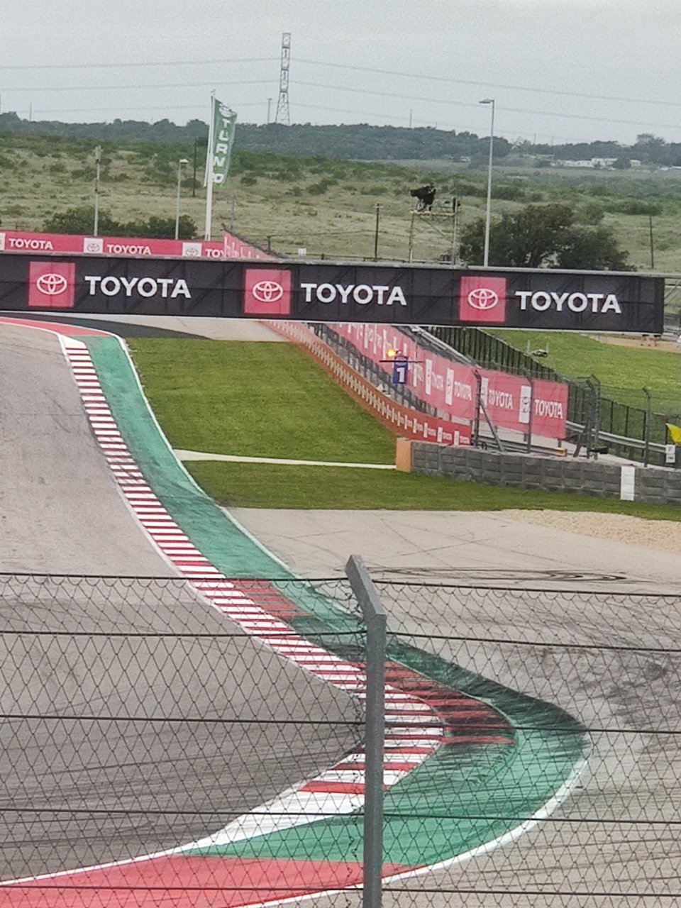

    Lots of people blowing that corner.

    Gotta cut that grass man.

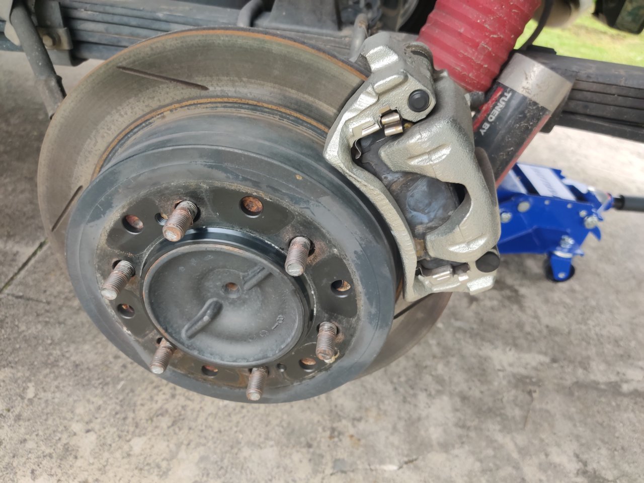

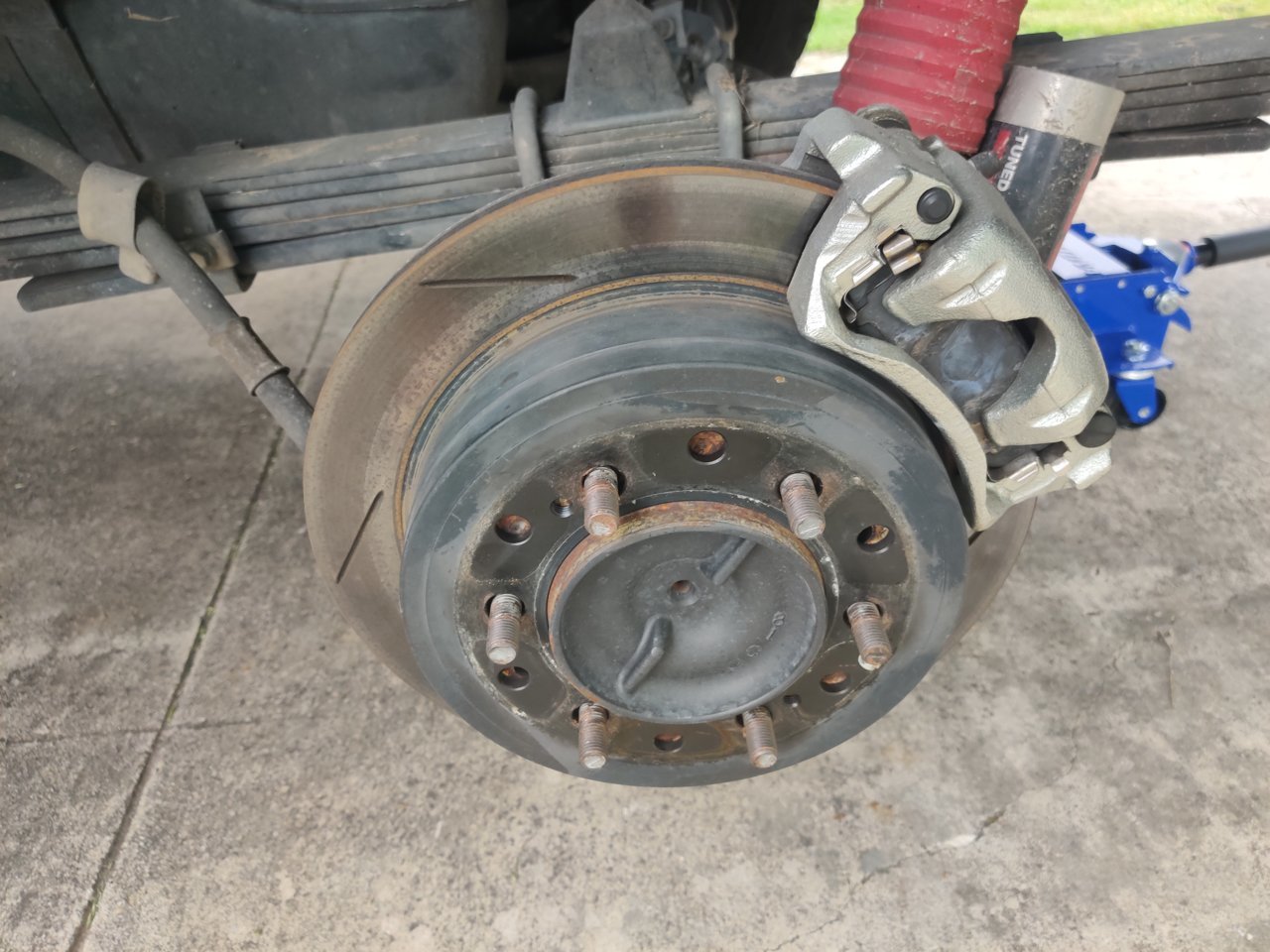

    Went from dis.
    To dis. Got tired of taking extra care to get the wheels as dead center as I could and still be a hair off. So far it feels better to drive the truck with these hub rings. I have not driven at my cruising speeds yet but up to 50ish feels better. I had to break out some of my engine building tools to find out these advans have a 112mm bore. Hub bore diameter of these trucks is 106 so hope that helps whoever needs this info.

    Trst drives should prove much smoother, yes???

    Yes

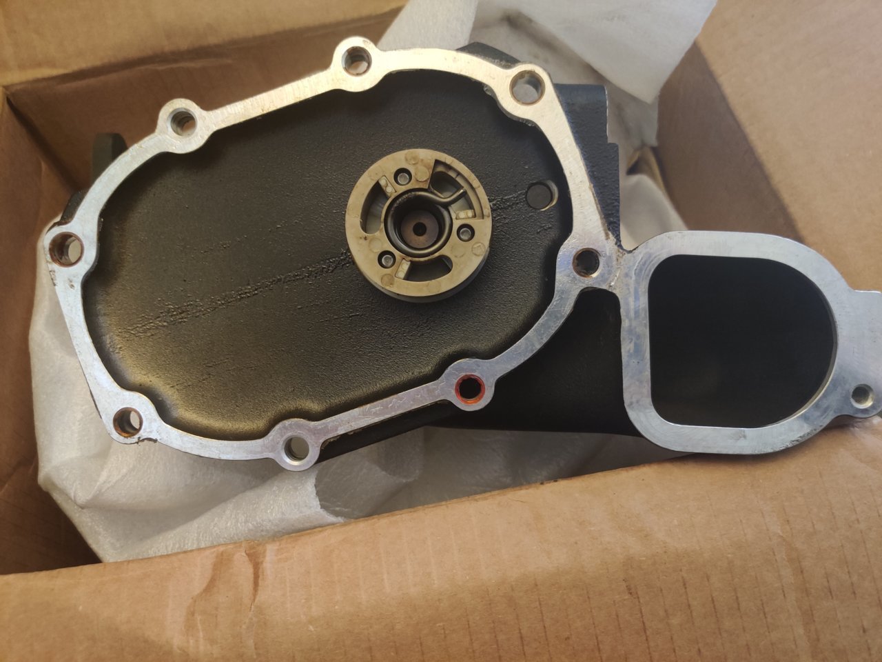

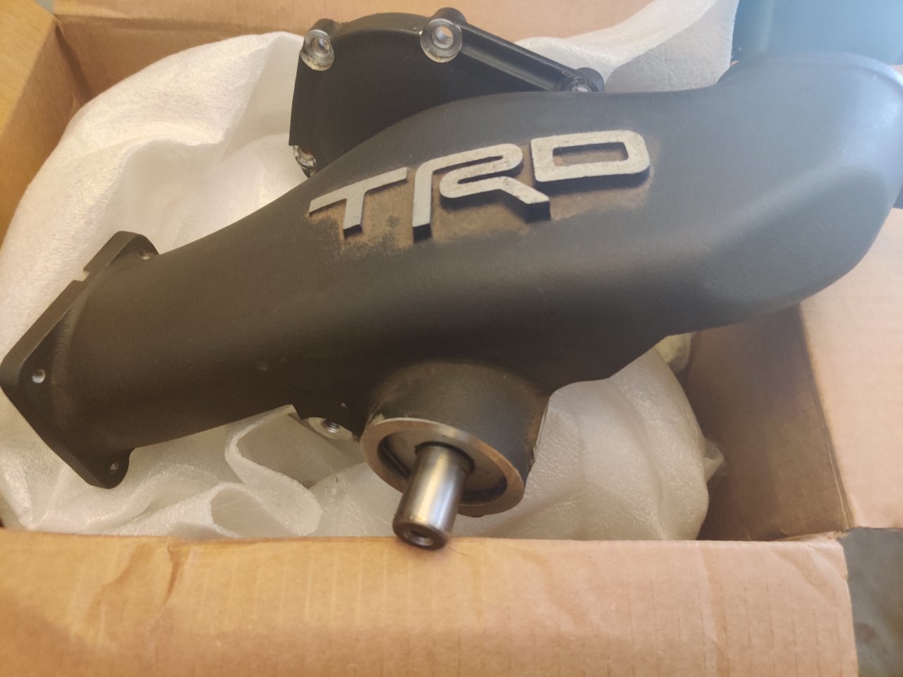

    Hmmm....wat dis?

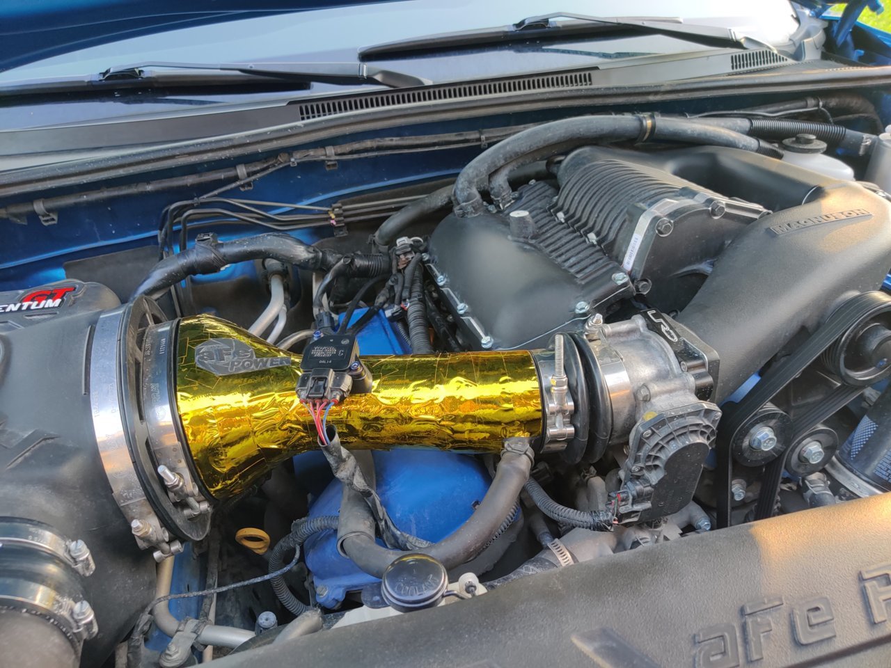

    Not much just wrapped the intake.

    It's for winners. I wrapped mine- noticeably slower intake air temps rising when at stop lights.
    I see a long bolt adding weight on the intake by the throttle body. Need to get a smaller titanium one

    It really does help reflect the convection heat.

    It helps slip the clamp over but yea I might cut it. I need a new boot as It got torn.

    Yep. Gonna be ported, rebuilt, and the trd painted.
