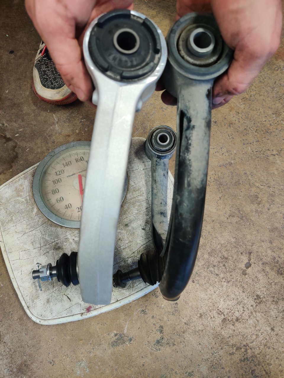

    Meant to add this during the uca install. It's thicc.

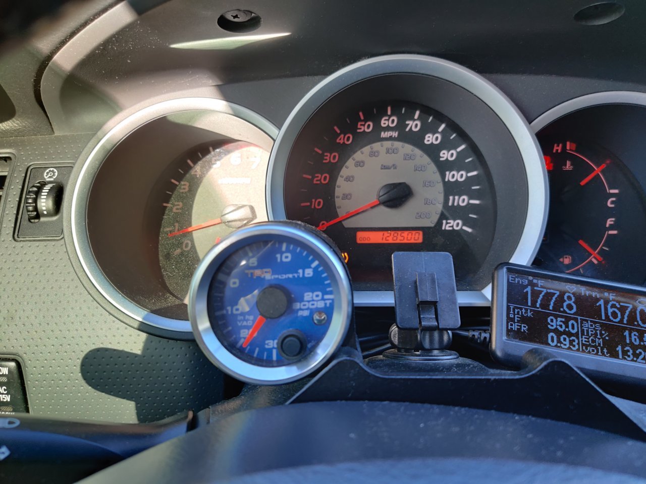

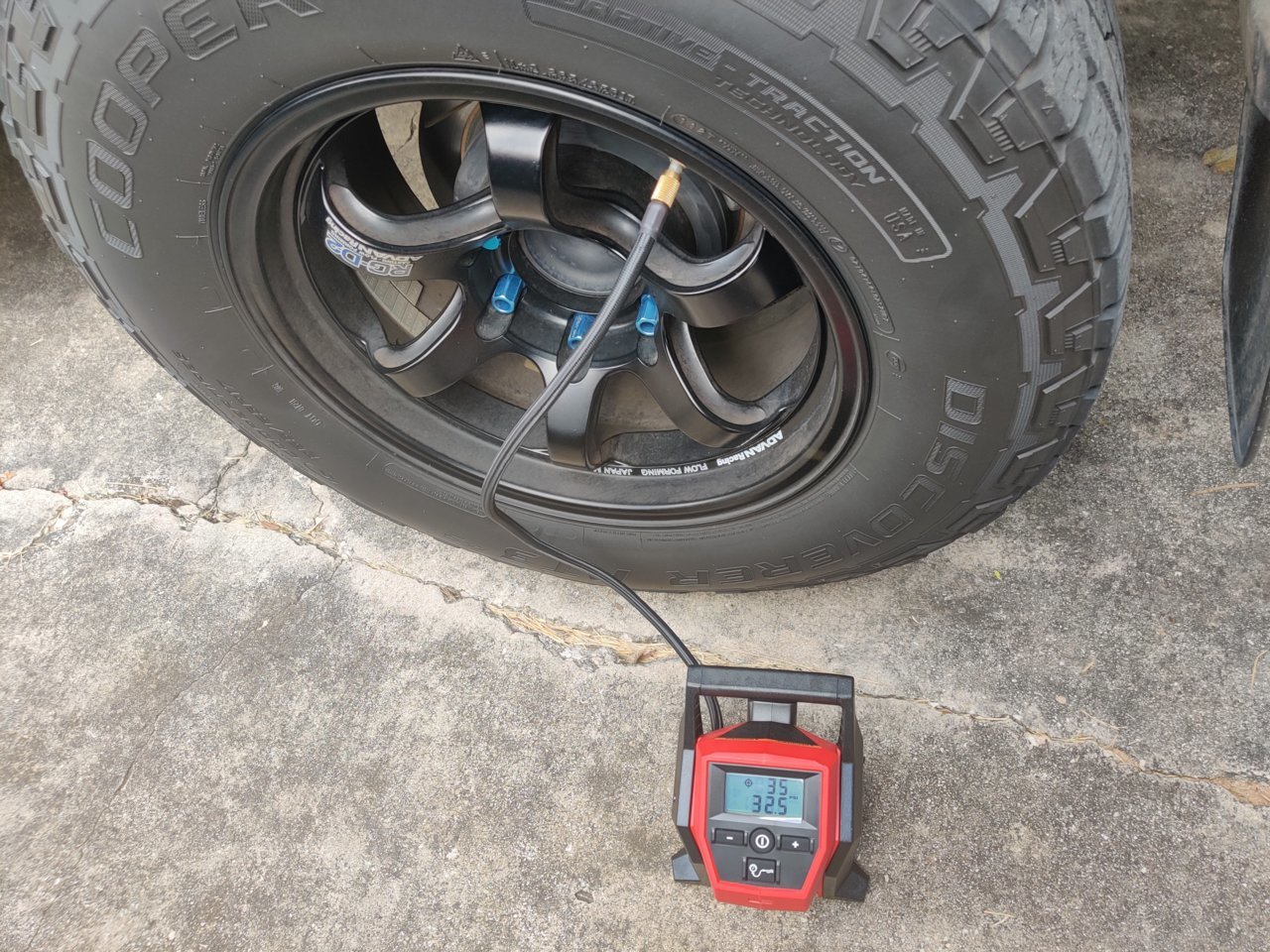

    Did some tlc on the Tacoma. Love this little air compressor. Checked all fluids and tested the rear sway bar settings. On the least resistance setting I can start oversteer whenever and on the most resistant setting it's pretty tight and have to really work to get oversteer and mostly wants to grip. No real understeer to complain of. Middle setting seems to be the best overall setting for a good compromise, a little fun when you want and grip when you need it. I still need test how the truck will behave with the trailer and in a rally environment. I think it'll be much better.
    I guess I got the high score. Lol so now I'm gonna work on my 4runner.

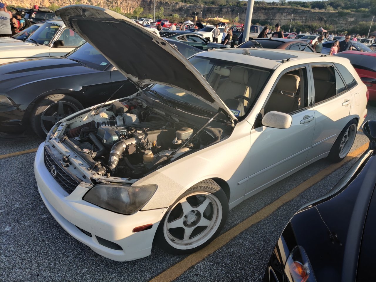

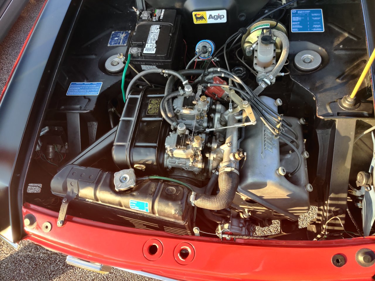

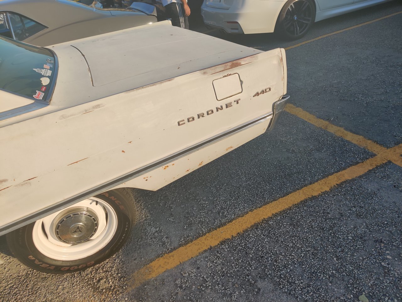

    Went to cars and coffee.
    Thicc
    Not a jeep
    Says 440 but...
    Pacific rim
    Arterial blood gas hunter? Like a vampire?
    Rug rats

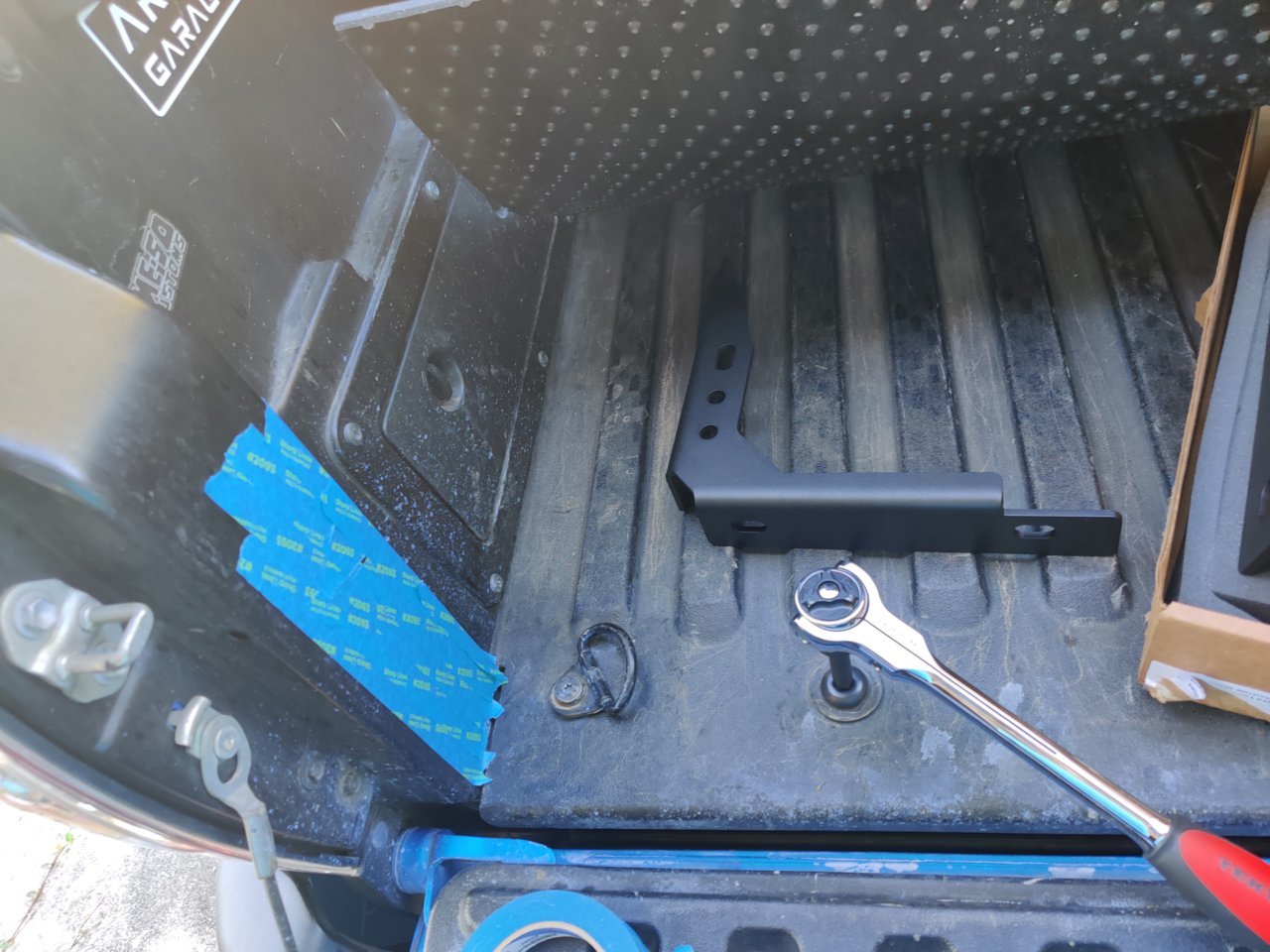

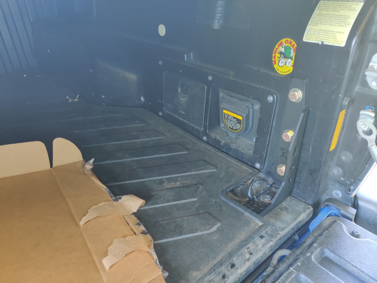

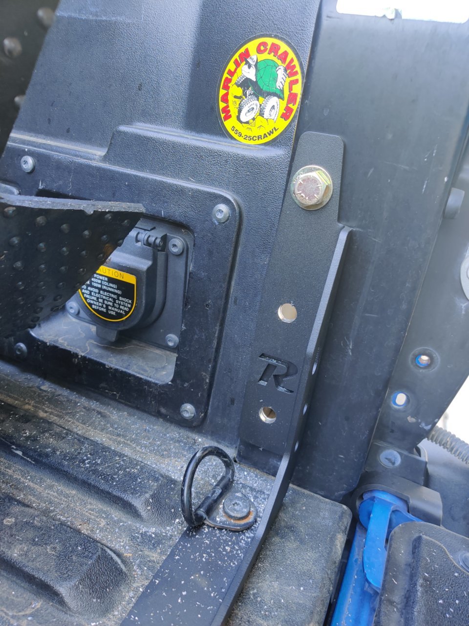

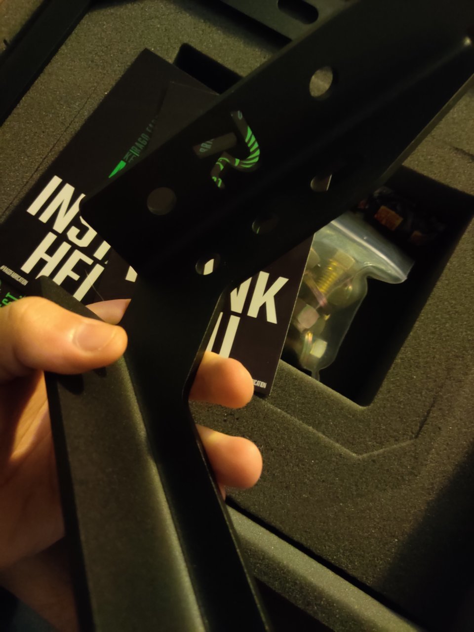

    So I got these rago bed stiffeners. I got these over the other options as this is one piece vs two pieces welded together and this is stainless steel.

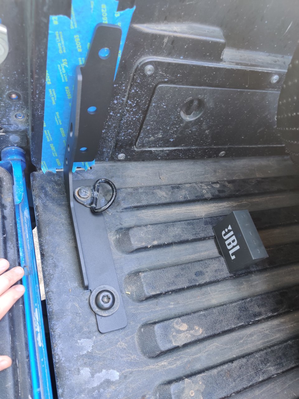

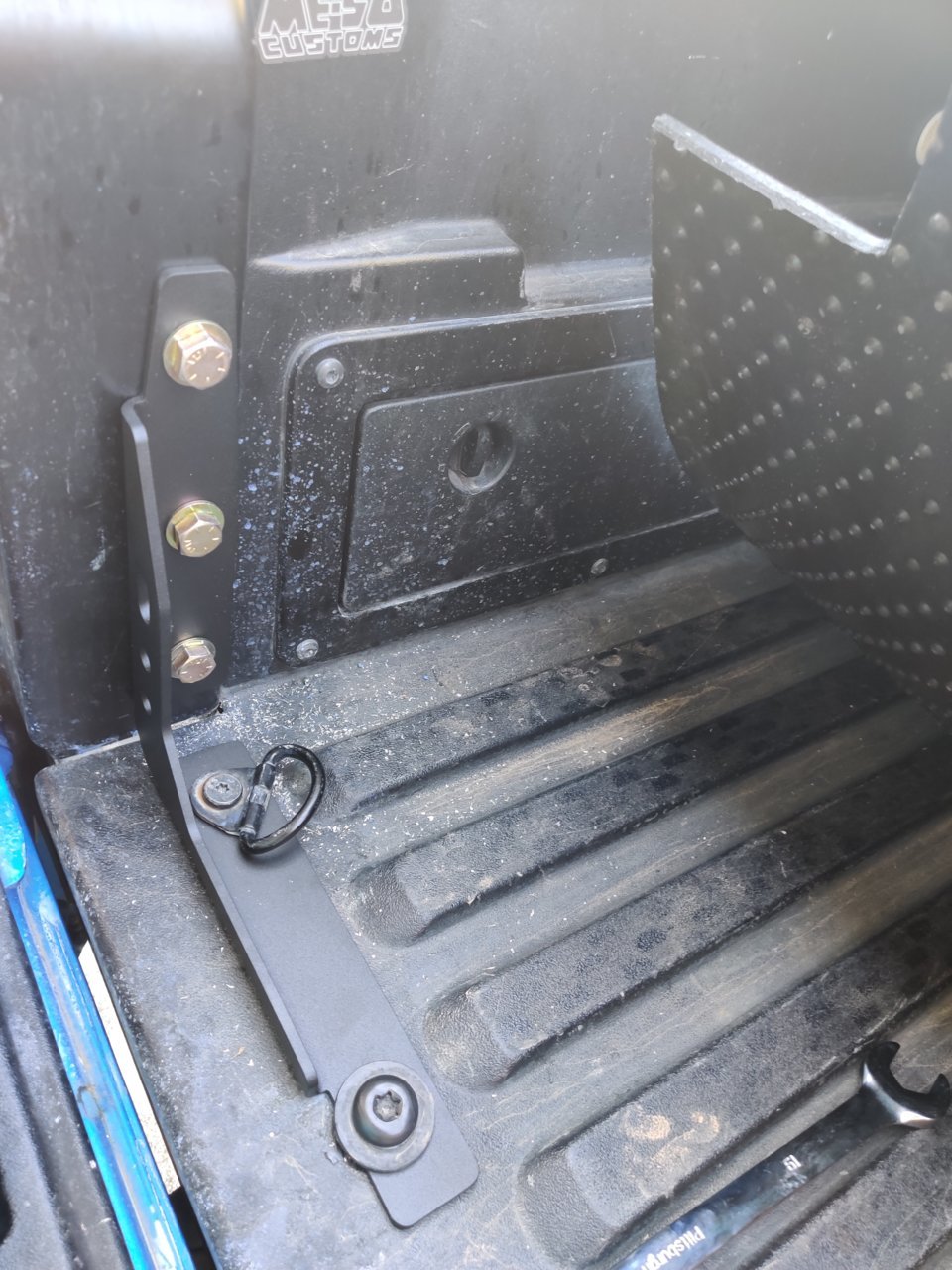

  18. Sep 17, 2021 at 10:05 AM
    #978
    Lucario Runner
    Lucario Runner [OP] Resident Truck/SUV racer
    Jun 29, 2011
    #59067
    7,205
    Robert
    San Antonio, TX or nearest race track
    06 Toyota 4Runner
    AFE stage II intake, APR X1, URD 70mm Throttle Valve (ported and knife edged), NST intake manifold spacer, URD spec U headers, Denso IKH20, URD fuel pump, APR fuel rail, URD Y pipe, URD spec u catback, lightweight water pump pulley, Greddy sandwich cooler plate, Earls oil cooler, IPT valve body, FJ TRD shocks, Cusco front and rear sway bars, Energy Suspension rear track rod bushings and rear link bushings, Carbotech pads, Stoptech ss brake lines, Stoptech slotted rotors, Motul 600 rbf, Limited Grill, Painted hatch cover by me, Painted valve covers by me, Cobra CB, TRD rad and oil cap, Escort 8500, Autometer oil psi and temp gauges, AEM wideband afr gauge, Flexpod, Pioneer 400w speakers.

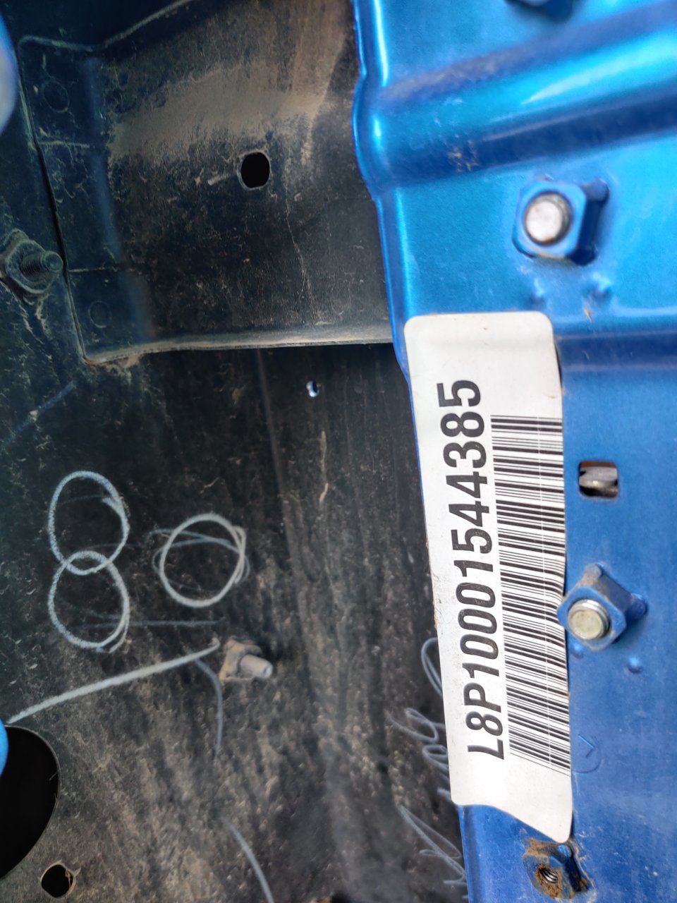

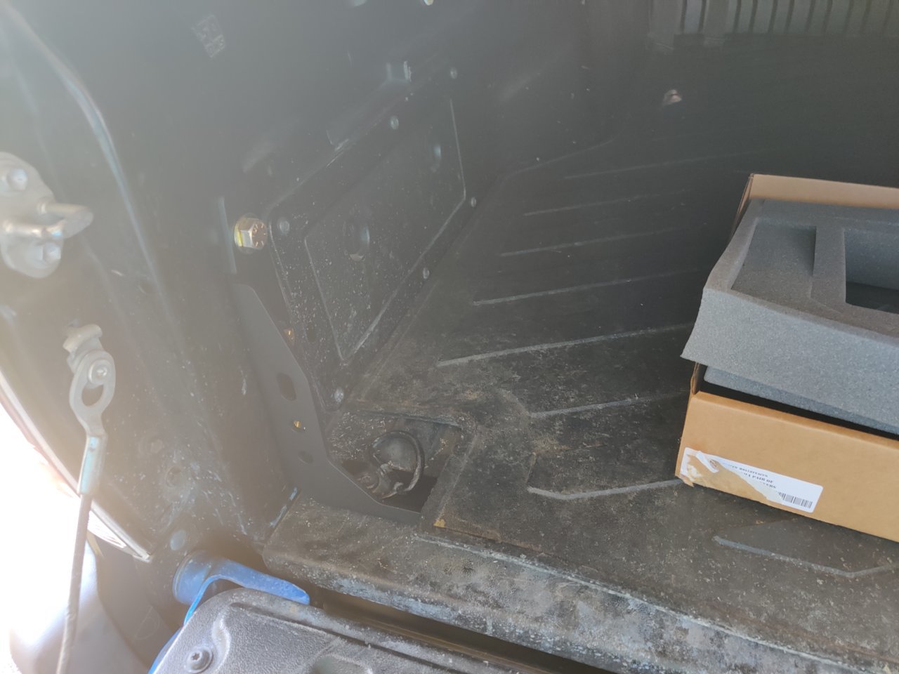

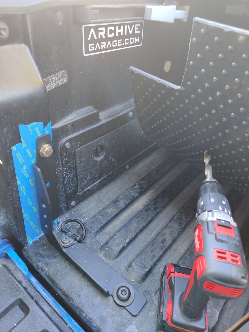

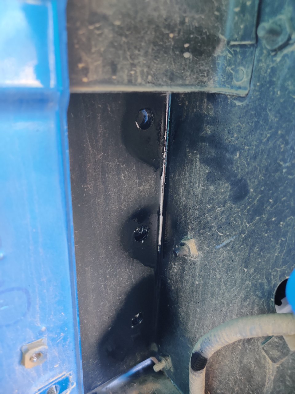

    So I kinda went in blind with this one. Seemed to work. First step was to play some madd tunes.
    https://youtu.be/qk1nnAHI1mI
    Tighten to locate holes to drill.
    Pilot hole.
    Bore out to 1/2 and tighten to help drill other two holes.
    Remove the bolts and brace to fog holes with some paint. Cover opposite side holes with tape to avoid over spray.
    Apply some antisneeze and tighten for the last time. Apply same method to the opposite side.
    Vacuum metal shavings and your done.
