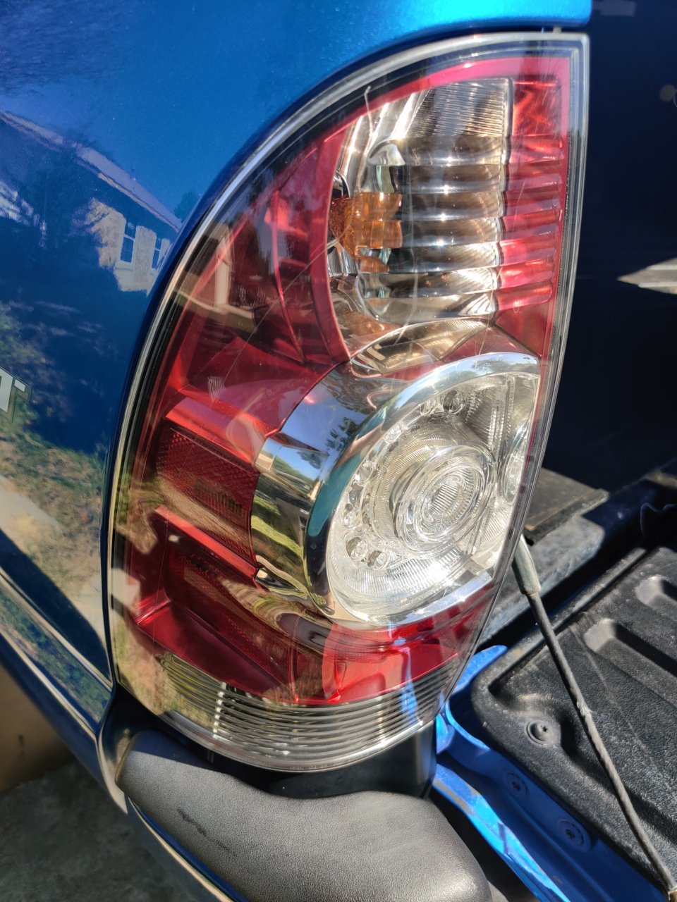

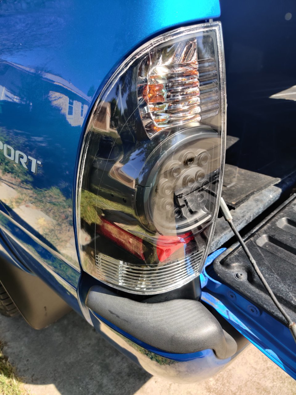

    Installed some black taillights.
    Also getting some replacement st60 calipers as both of mine came damaged due to lose packaging. Should get the replacements on Saturday and still be installed this weekend.

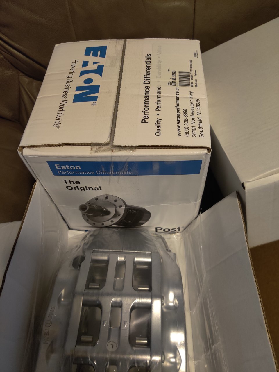

    Diff and replacement calipers showed up today

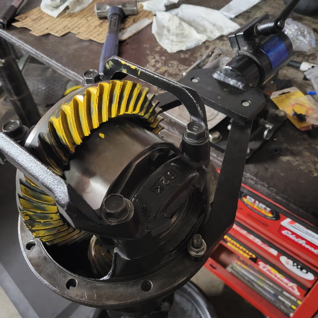

    Not much but I dropped my diff off to be built into a third member by @Texoma . Awesome roads out there to get into trouble.

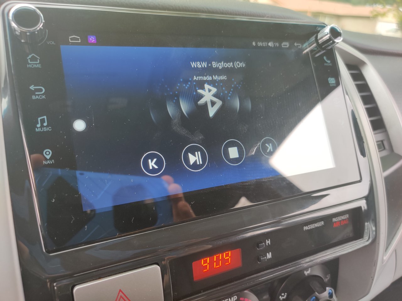

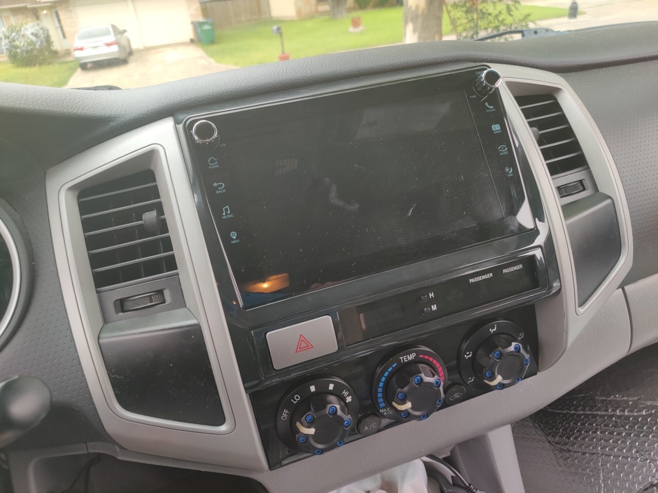

    Got my new radio.
    In the not fun land of maintenance I ordered a complete upper and lower steering shaft.

    Are you regearing at all? I kind of wish I did now but didn't want to deal (and $) with regearing the front diff too at the time.
    Is that an android head unit? I just got a new one and am loving it so far.

    Hoping to complete the diff tonight. Last step is setting up the solid spacer.

    Got to participate in a bmw autocross event. Was plenty fun getting in some seat time. Got extra laps in cause I kept catching other drivers. Might need to go to the M school for more.
    Installed my new radio. It's nice having steering wheel controls again. Now to figure out everything else on this thing.
