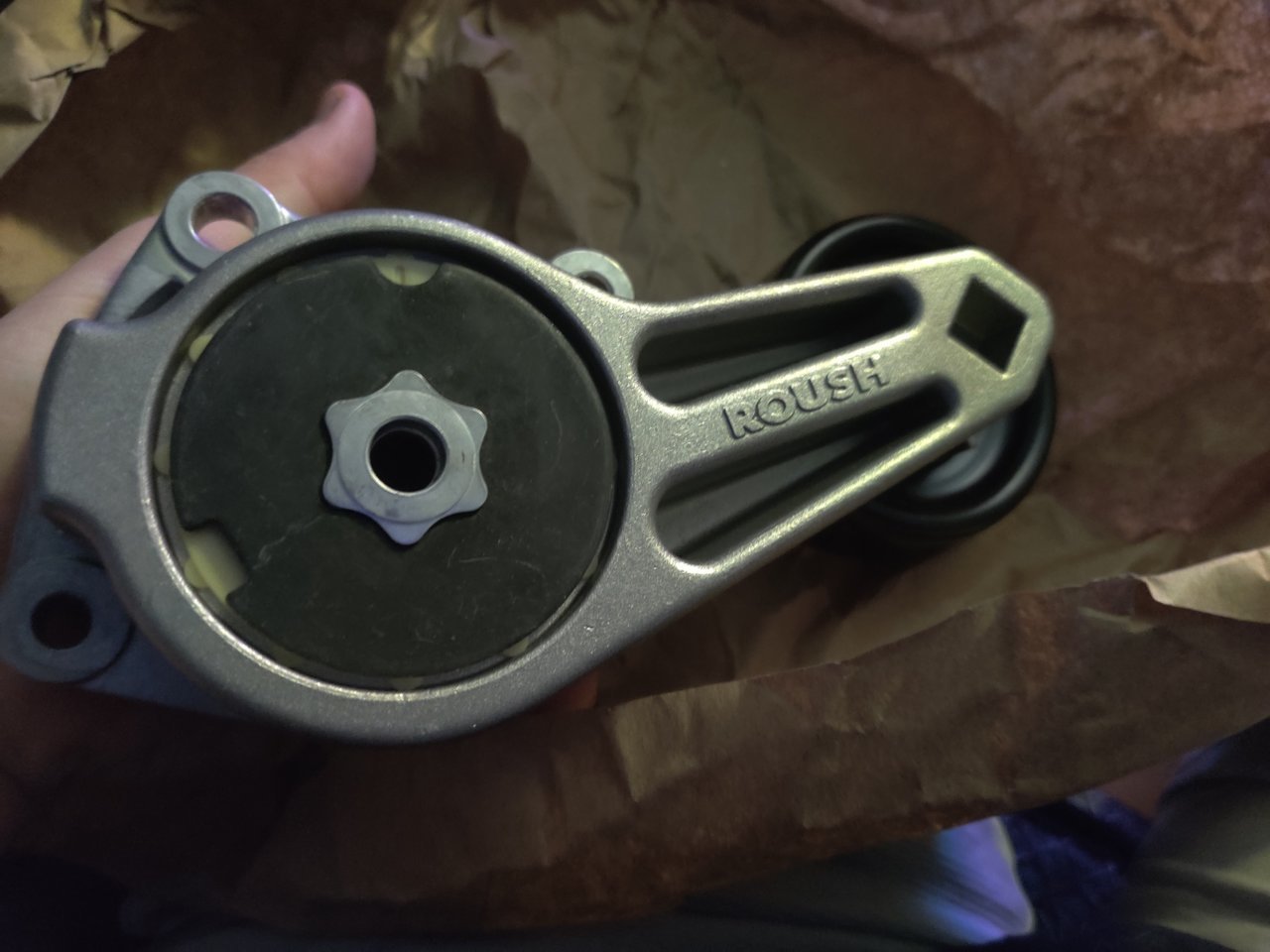

    Got the roush tensioner.

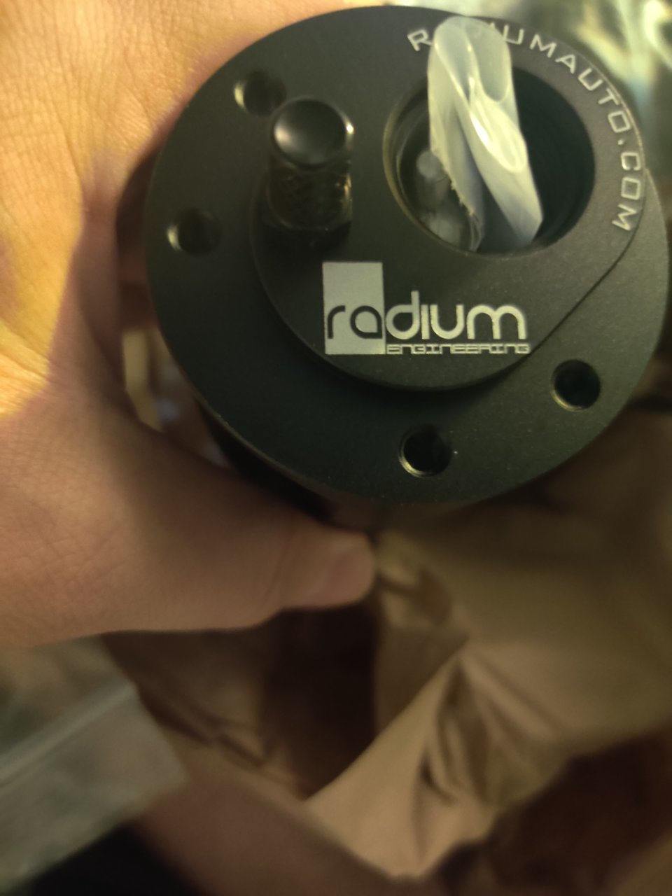

    Radium catch can delivered

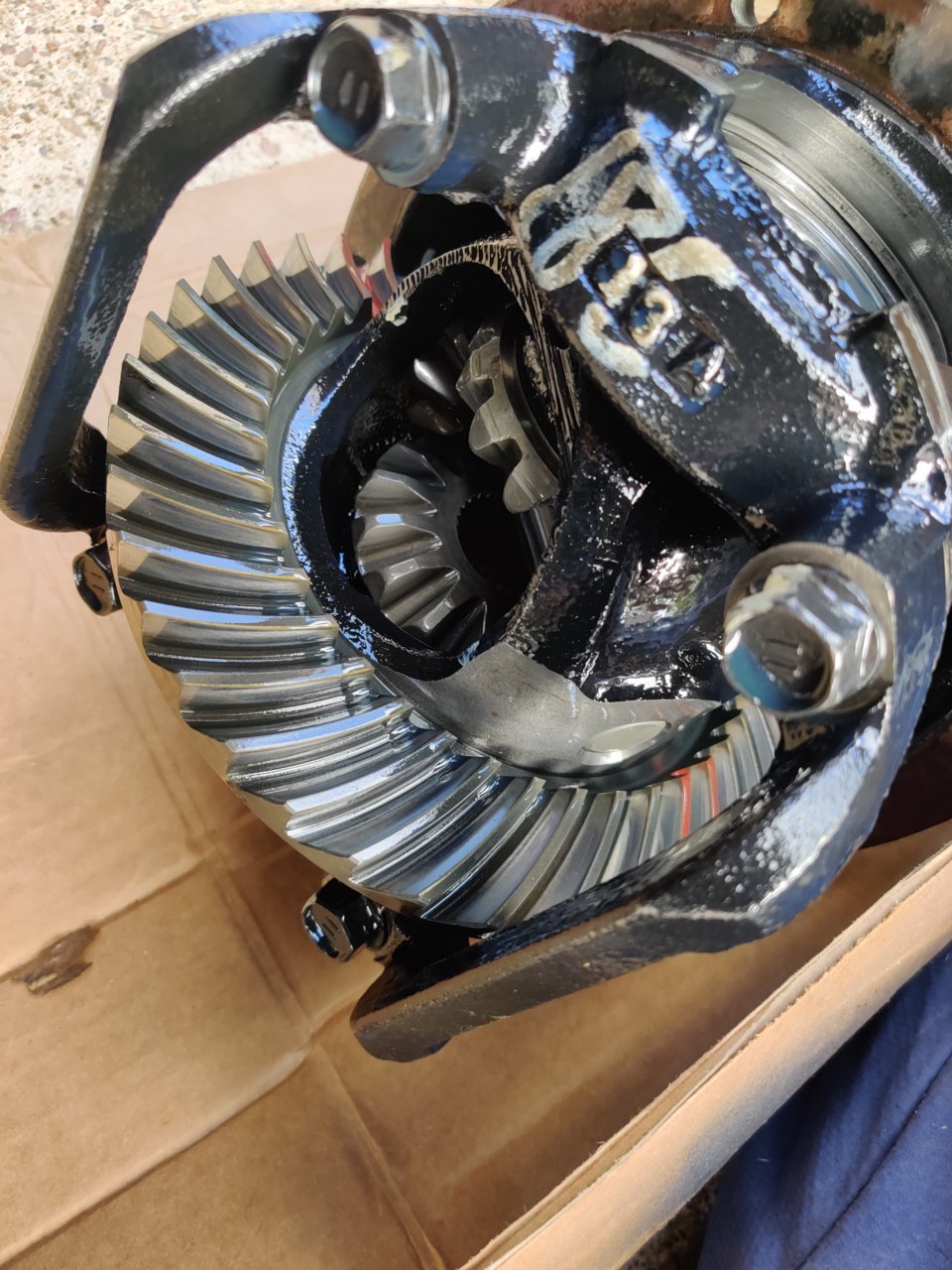

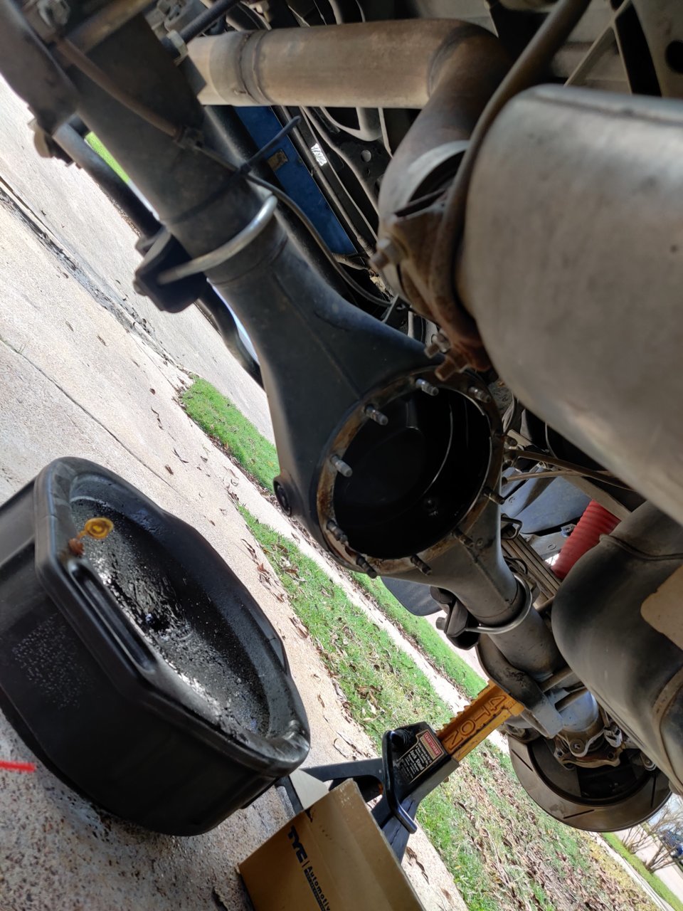

    LSD and quantum solenoid install

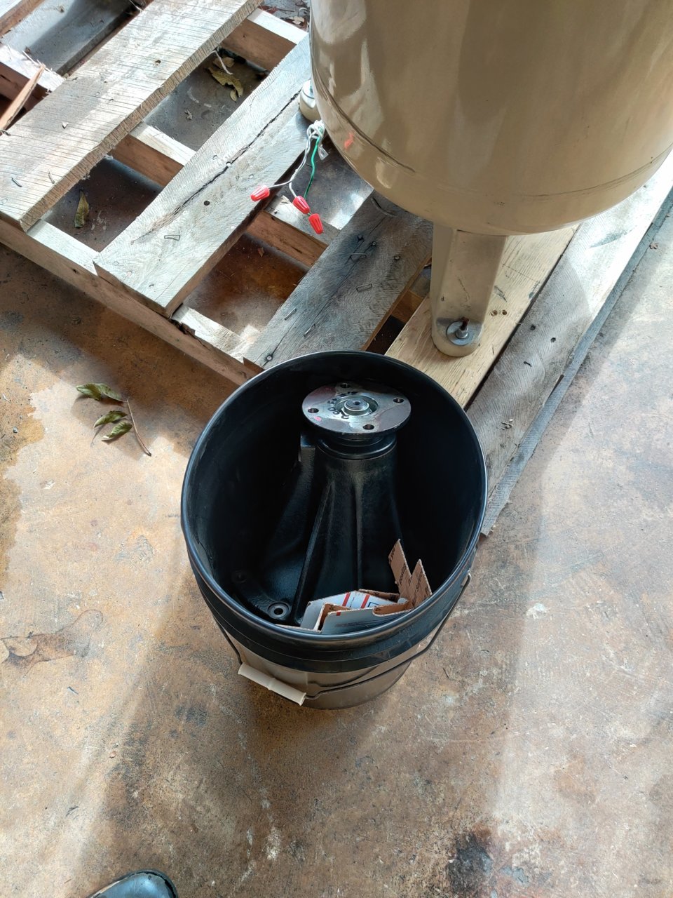

    Old diff out and new one in

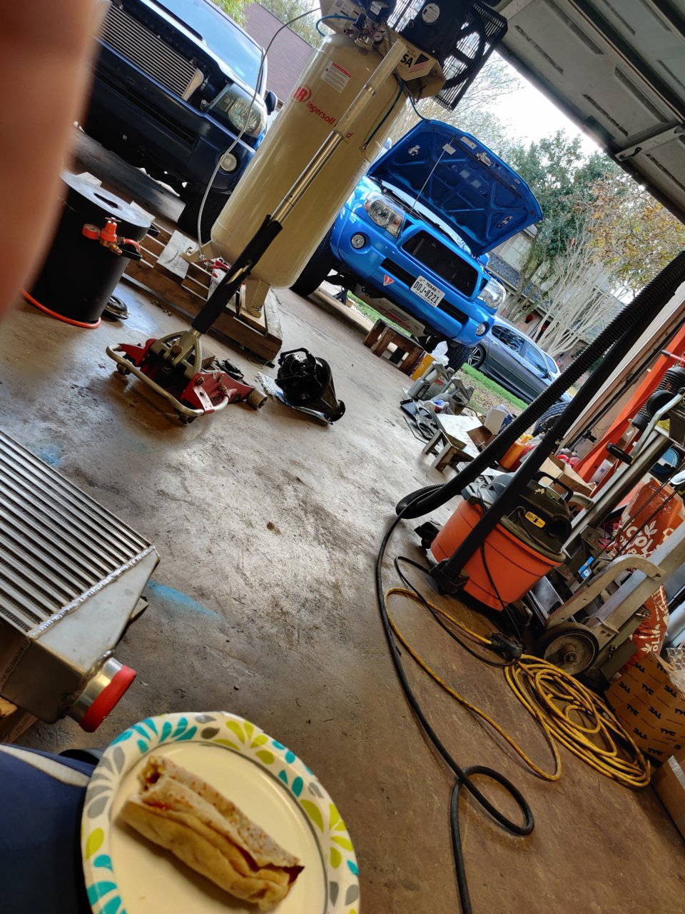

    Done. Taco tyme

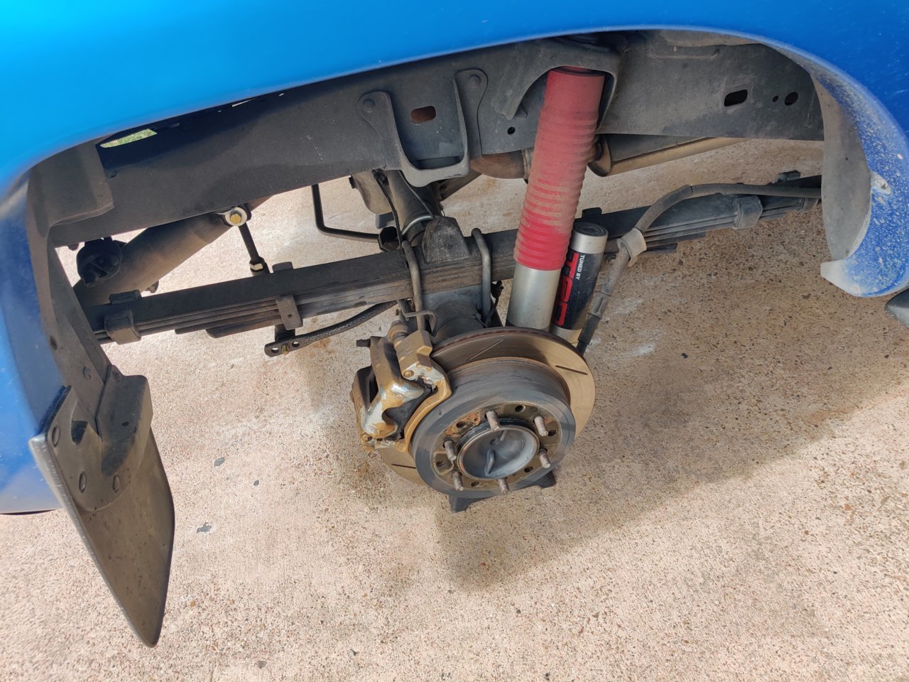

    New pass side caliper and rear ss brake lines delivered.

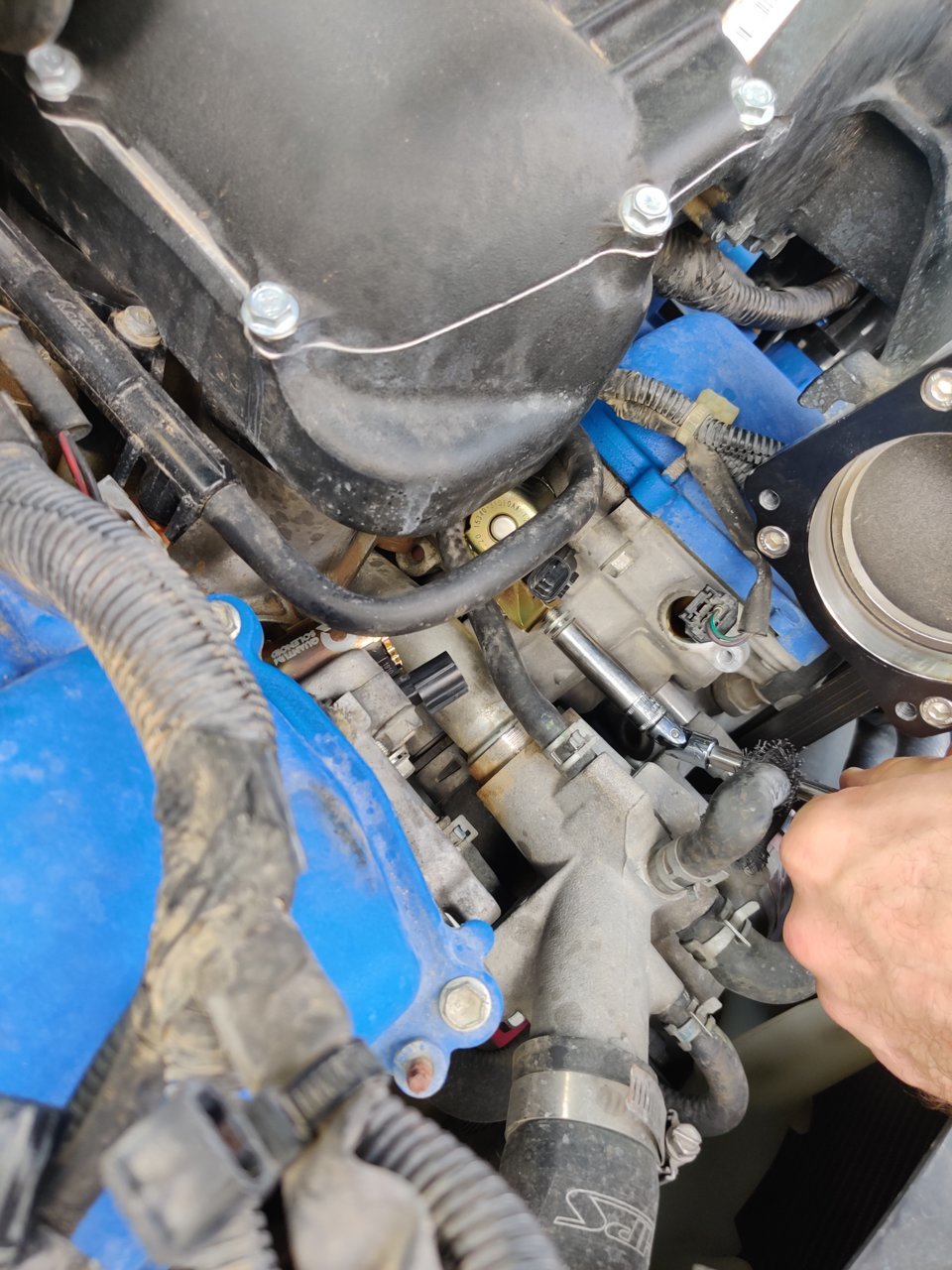

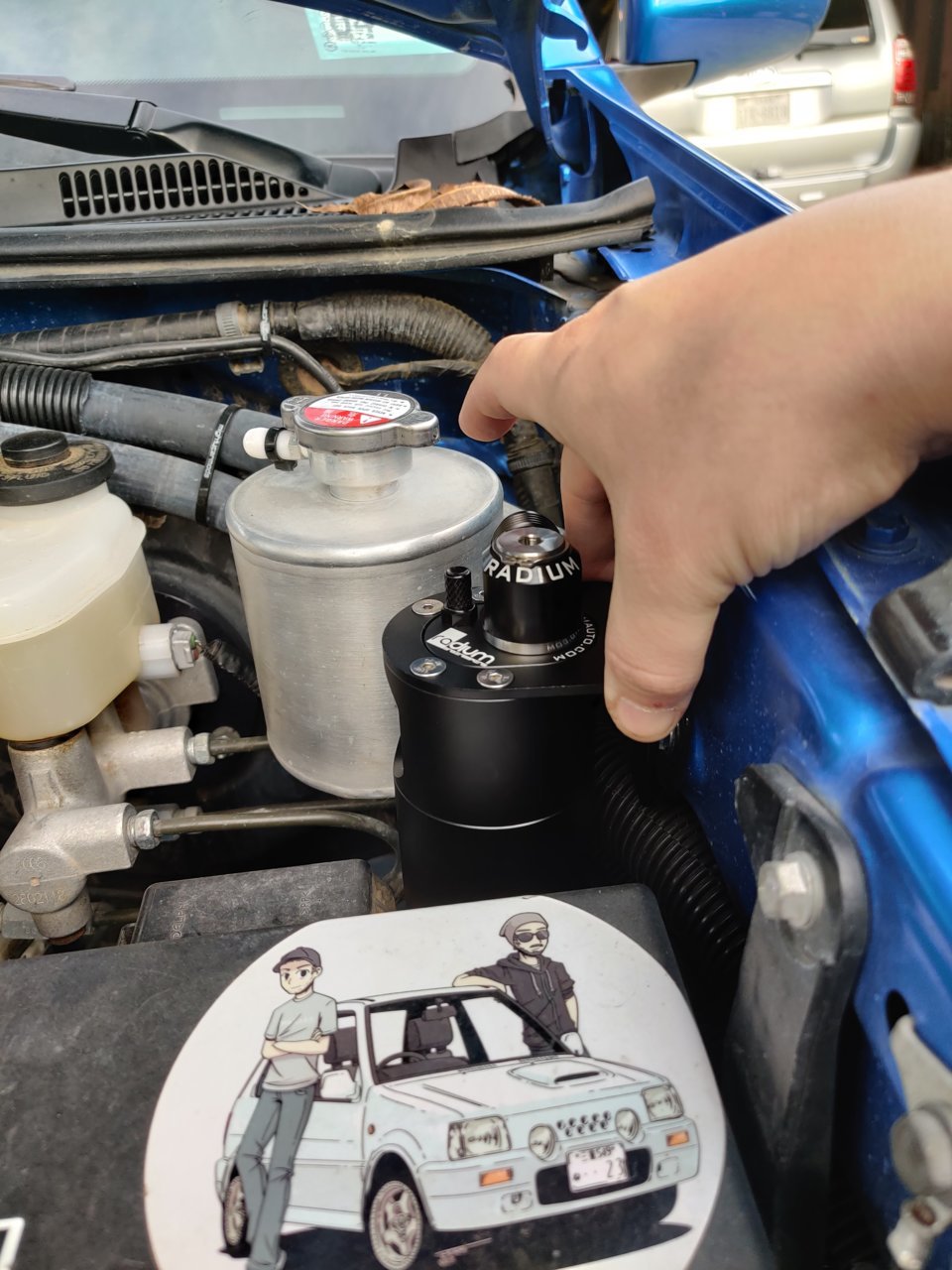

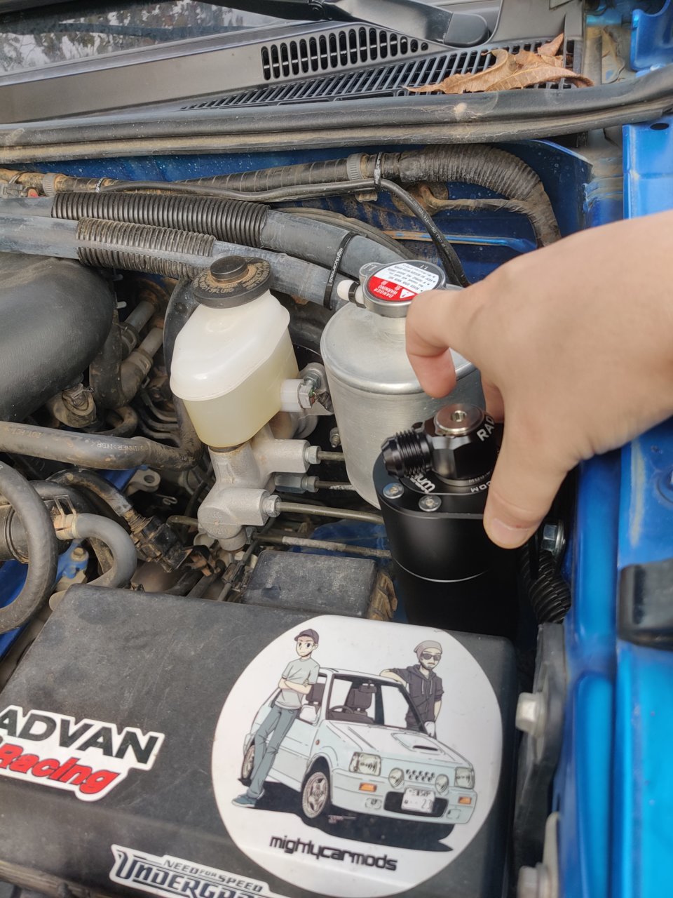

    Just a small mock up of the catch can. I am glad I went with the smaller non competition catch can as spacer is limited. With the 10an swivel I can either run the lines behind the coolant tank or on front. Plan is a 6an y to 10an in to the catch can and 3/8(?) Return into the engine. Just gotta grab some aluminum for a diy bracket and the other fittings to show up.

    mightytacoman
    mightytacoman Mighty-known Member
    Apr 3, 2013
    #101270
    2,412
    Kel
    4.5L 1grfe
    Brian Crower stroker kit, Carrillo pistons moly/ceramic coated, BC sportsman rods, arp s2000 head bolts, Darton M.I.D sleeves, Kelford race cams, Magnusson supercharger, hp tuner tuned, 650cc flow matched fuel injectors, CSF radiator, Walbro 255 fuel pump. pulleyboys quick change pulley with 2.3", fpr mod, NST crank, water and alternator pullies, 160° mishimoto thermostat. Puma On-board air, Radflo CDC ext coilovers with 14" 700# springs, extended length rear Radflo shocks with CDC, Dakar leak pack, Brute Force Fab front bumper galvanized and powder coated, DTRL mod, yellow fogs, fog anytime mod, relocated rear differential breather, synthetic fluids, custom airbox, tundra sized intake. 76mm throttle body, secondary air filter removed, Airflow snorkel, 4x innovation sliders powder coated, URD equal length headers, DT y-pipe, Aero-Turbine 2525xl exhaust dumped over axle, seat belt chime disabled, Warn 8000i winch, 1- 20" slim light bar in grill, 42" curved roof light both with custom brackets. Mesh grill, Brute Force Fab rear bumper with extra reverse lights, u bolt flip kit, SS extended brake lines, hockey puck bump stop extension, AT shackle flip kit, Light Racing UCA's, 4crawler 1.5" bodylift. custom built front and mid skid plates, re-geared to 4.56s, windows tinted 25%, Sony stereo, 8" skar sub-woofer, 1000 watt mono amp, retrofit headlights with legal demon eye, Kryptek Marathon seat covers. North Star agm 27f battery, Helo 791 rims, 315/75/r16 Mt/r ARB front air locker
    remind me- did you clear coat the resi tank or is that bare still?

    06 Toyota 4Runner
    AFE stage II intake, APR X1, URD 70mm Throttle Valve (ported and knife edged), NST intake manifold spacer, URD spec U headers, Denso IKH20, URD fuel pump, APR fuel rail, URD Y pipe, URD spec u catback, lightweight water pump pulley, Greddy sandwich cooler plate, Earls oil cooler, IPT valve body, FJ TRD shocks, Cusco front and rear sway bars, Energy Suspension rear track rod bushings and rear link bushings, Carbotech pads, Stoptech ss brake lines, Stoptech slotted rotors, Motul 600 rbf, Limited Grill, Painted hatch cover by me, Painted valve covers by me, Cobra CB, TRD rad and oil cap, Escort 8500, Autometer oil psi and temp gauges, AEM wideband afr gauge, Flexpod, Pioneer 400w speakers.
    its bare.

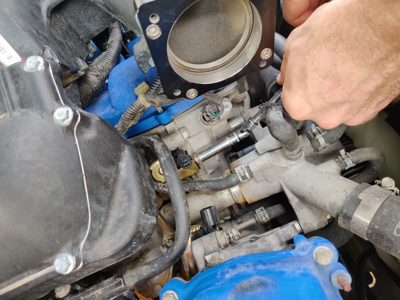

  12. Dec 6, 2021 at 2:29 PM
    #1072
    not_nick
    not_nick Well-Known Member
    Sep 20, 2017
    #230574
    1,903
    keeping jersey dirty
    looks like it has a built in bracket, no? That won't work?
  13. Dec 6, 2021 at 2:32 PM
    #1073
    Lucario Runner
    Lucario Runner [OP] Resident Truck/SUV racer
    Jun 29, 2011
    #59067
    7,199
    Robert
    San Antonio, TX or nearest race track
    06 Toyota 4Runner
    it does but the bolt holes are narrow plus there is a coolant line behind it so my plan is a get a little bar of aluminum with a slight bend that will go on top of the supercharger coolant tank, drill four holes and bolt it up. it'll be similar to the setup on my 4runner.

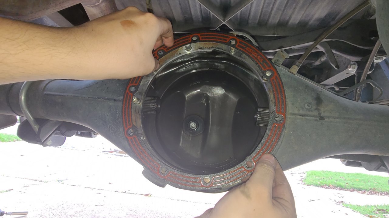

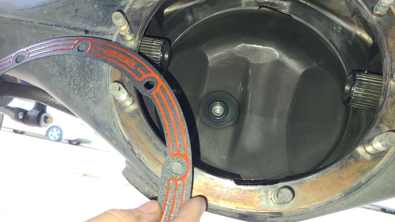

    Wanted to share how this lubelocker gasket was awesome but I could not install it as it wouldn't even slip over the studs and seems to be the wrong diff like an elocker even though the one I got was for a non elocker model. Idk. I returned it.
    https://eastcoastgearsupply.com/i-7185269-toyota-8-v6-non-elocker-lubelocker-gasket.html
    So with some time with the truck post truetrac install I love how it drives now. Super easy to slide and hooks well. The quantum solenoids also seem to add a bit more power. Overall I'm very happy with the truck now. Atm I'm planning on new gauges, boxing the frame, and a cf hood. Also in the short term I ordered some new hardware for the rear sway bar. So I anyone else wants to upgrade to a nylon nut it's a 7/16x20 thread.

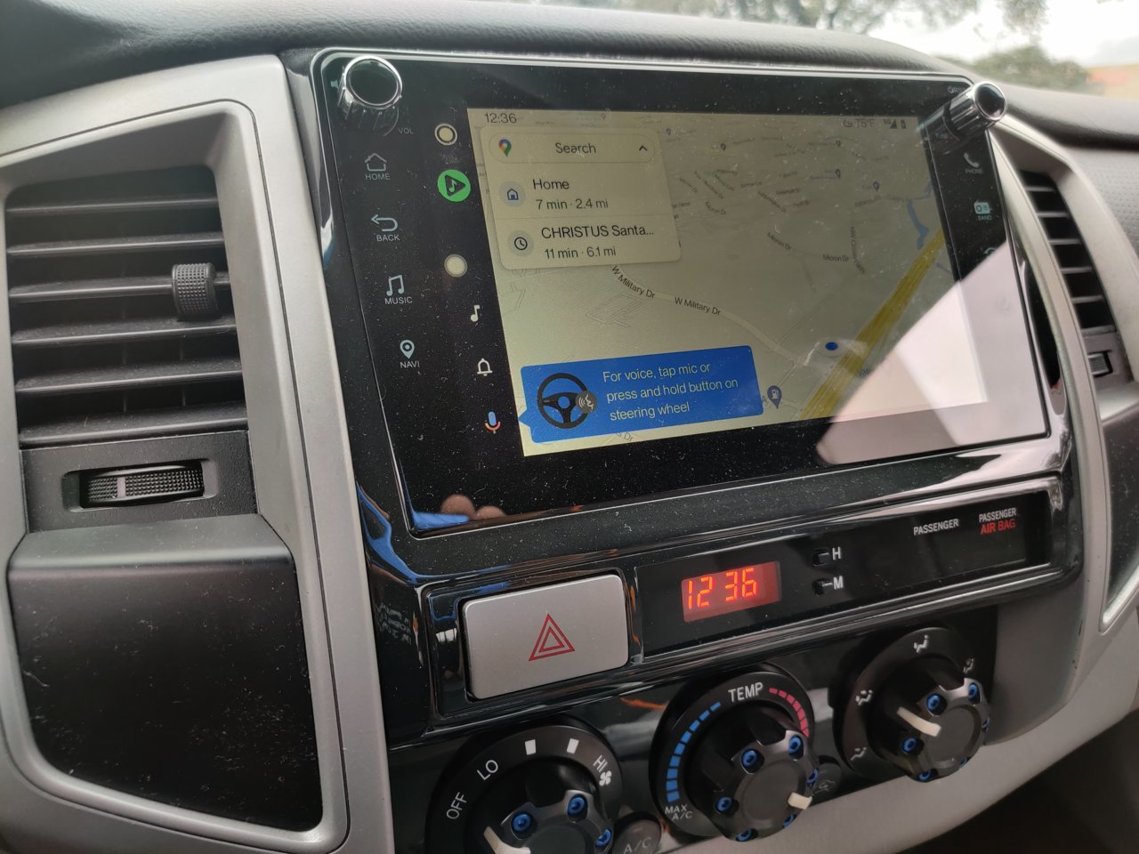

  16. Dec 15, 2021 at 10:57 AM
    #1076
    Lucario Runner
    Jun 29, 2011
    #59067
    7,199
    Robert
    06 Toyota 4Runner
    Need my camera man ;)
    Also got the gps to work. This is now rolls Royce level of luxury.

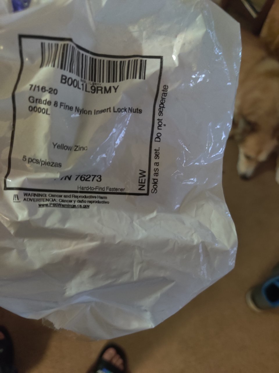

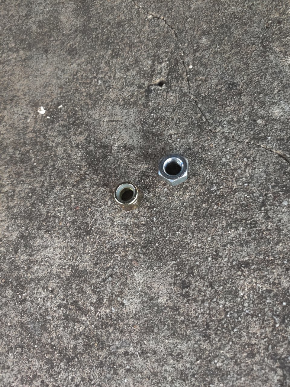

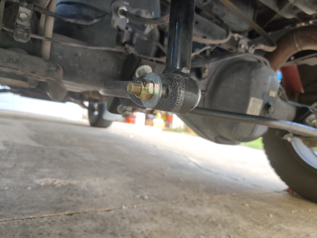

    Also received and installed improved hardware for the rear sway bar. Hellwig for whatever reason doesn't include lock washers or nylon nuts for the endlink to sway bar connection. I would recommend getting this upgrade so a nut doesn't fall off.
    Has temporary hardware installed but wasn't grade 8.
