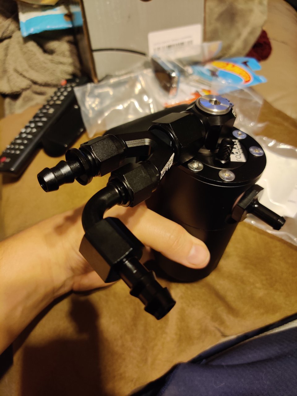

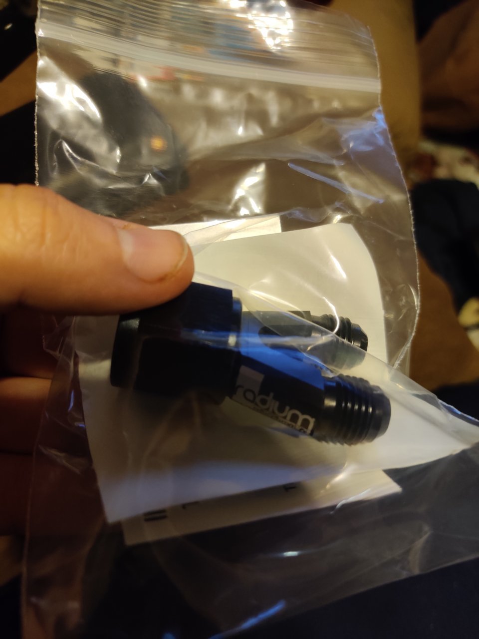

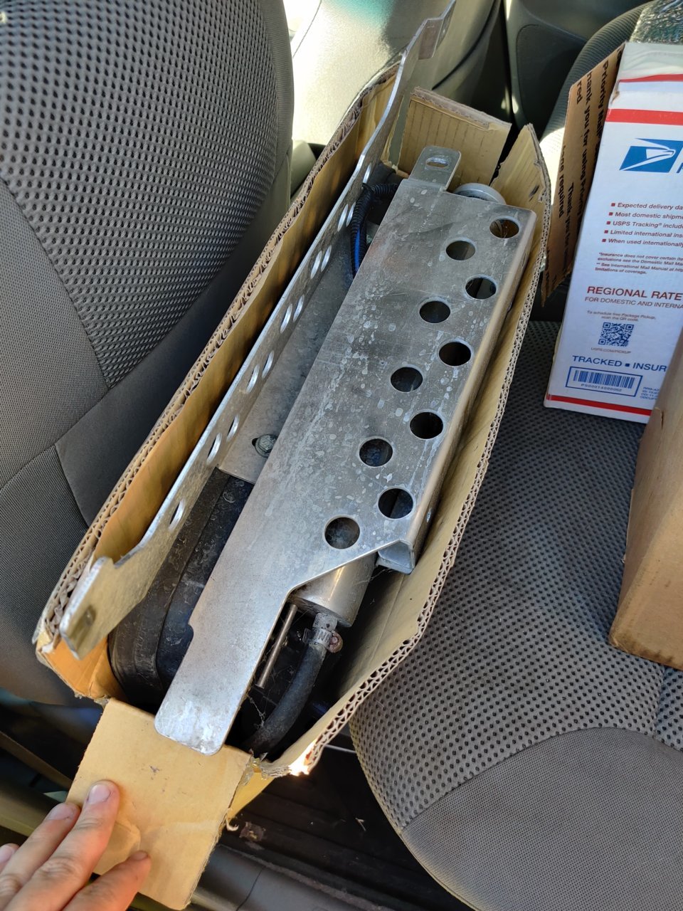

    Fittings showed up today. Orb to 3/8 for the return to engine and the 10an female to two 6an male with a straight pushlock and a 90.
    Also hung out with my overlander buddy @cgnsa
    Got an efan from @Oldie2007 thanks mate!

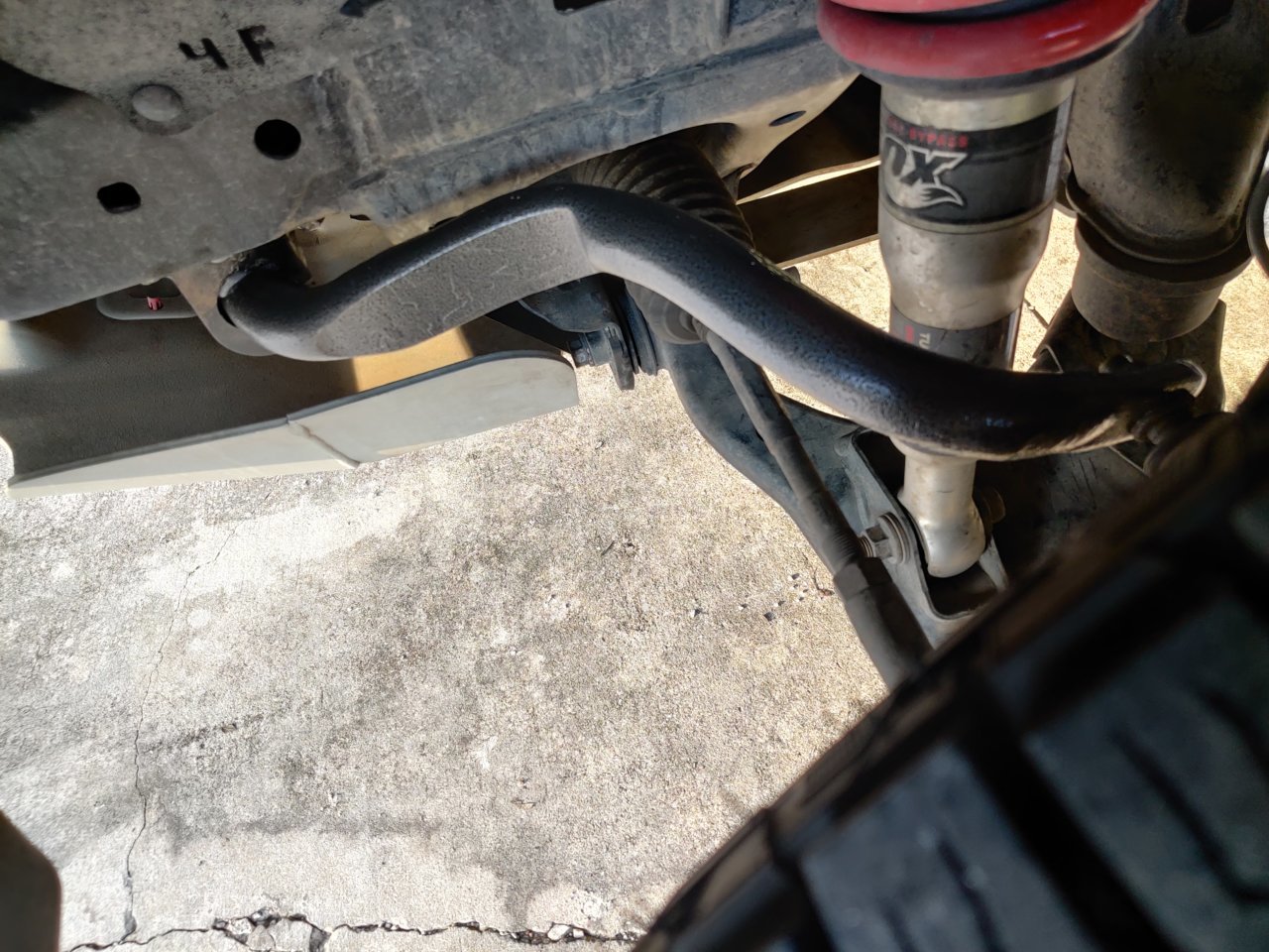

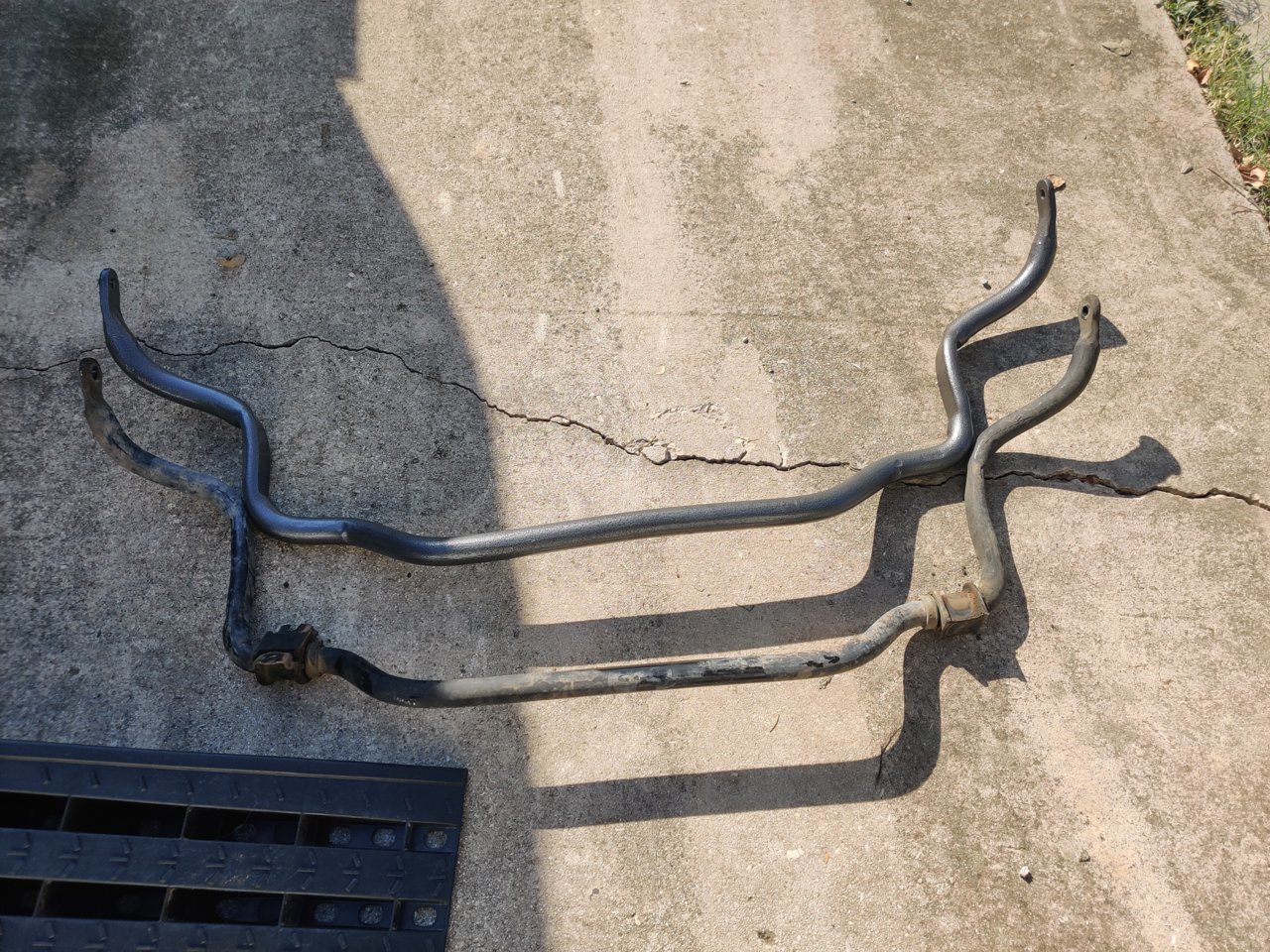

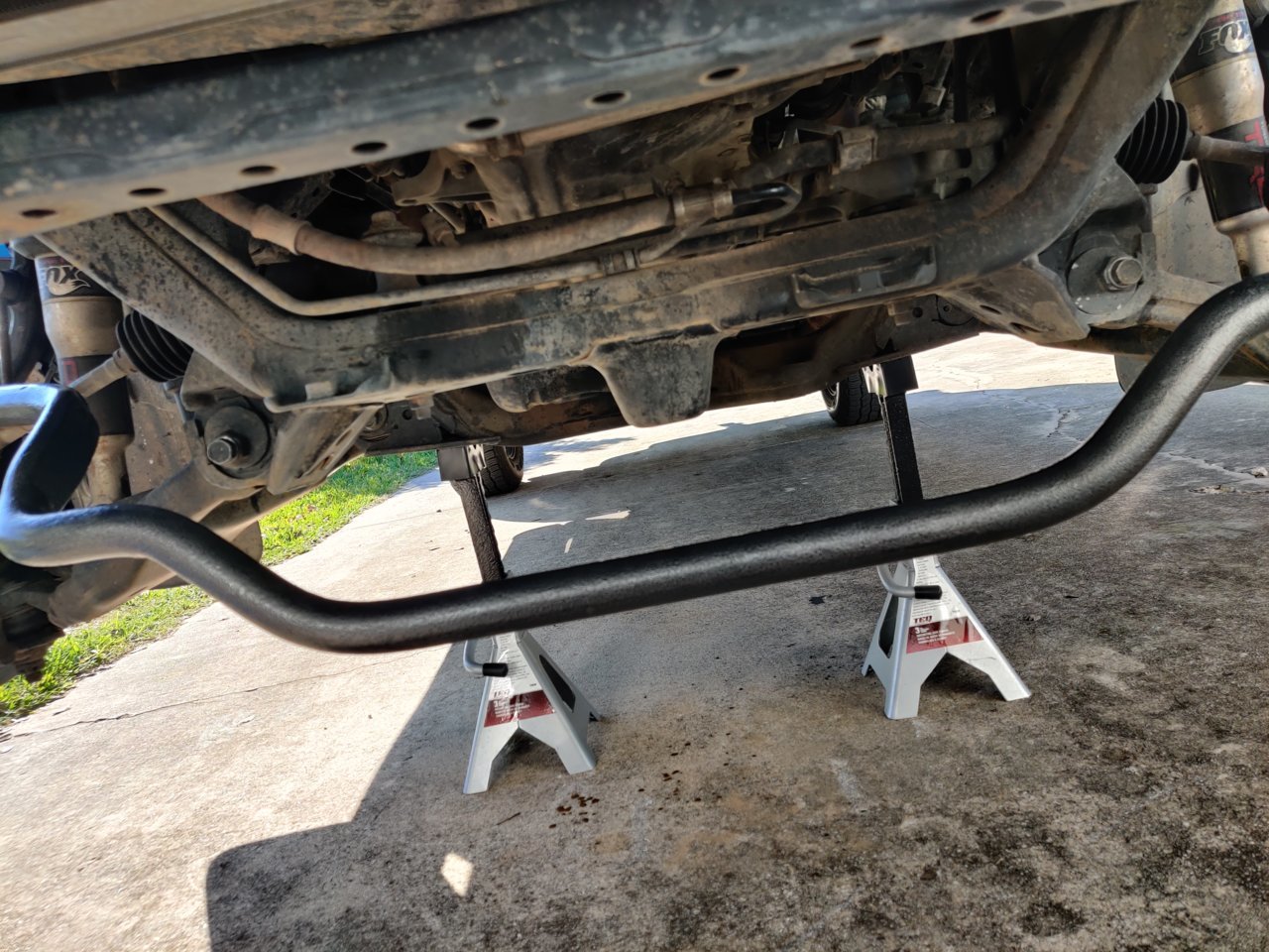

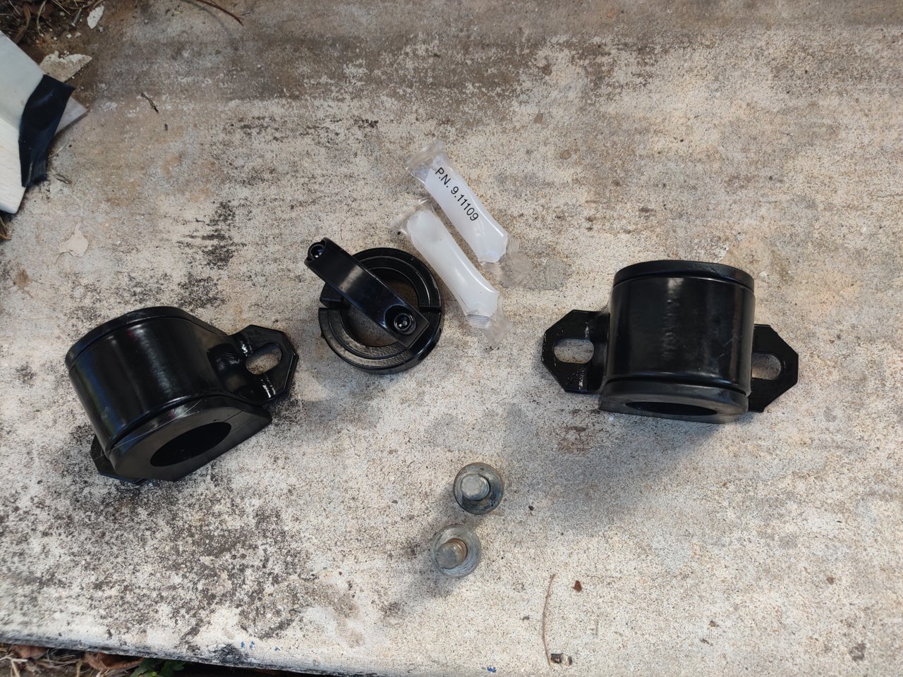

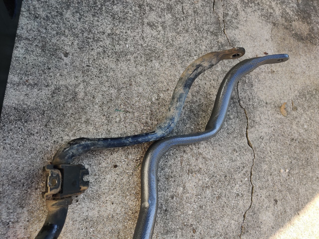

    Installed my hellwig front sway bar.

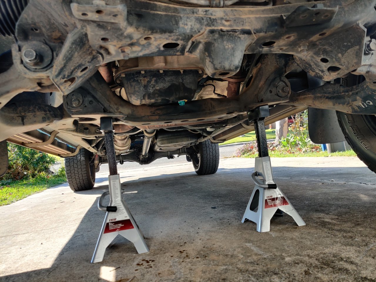

    These marlin lca braces are good points for jackstands.

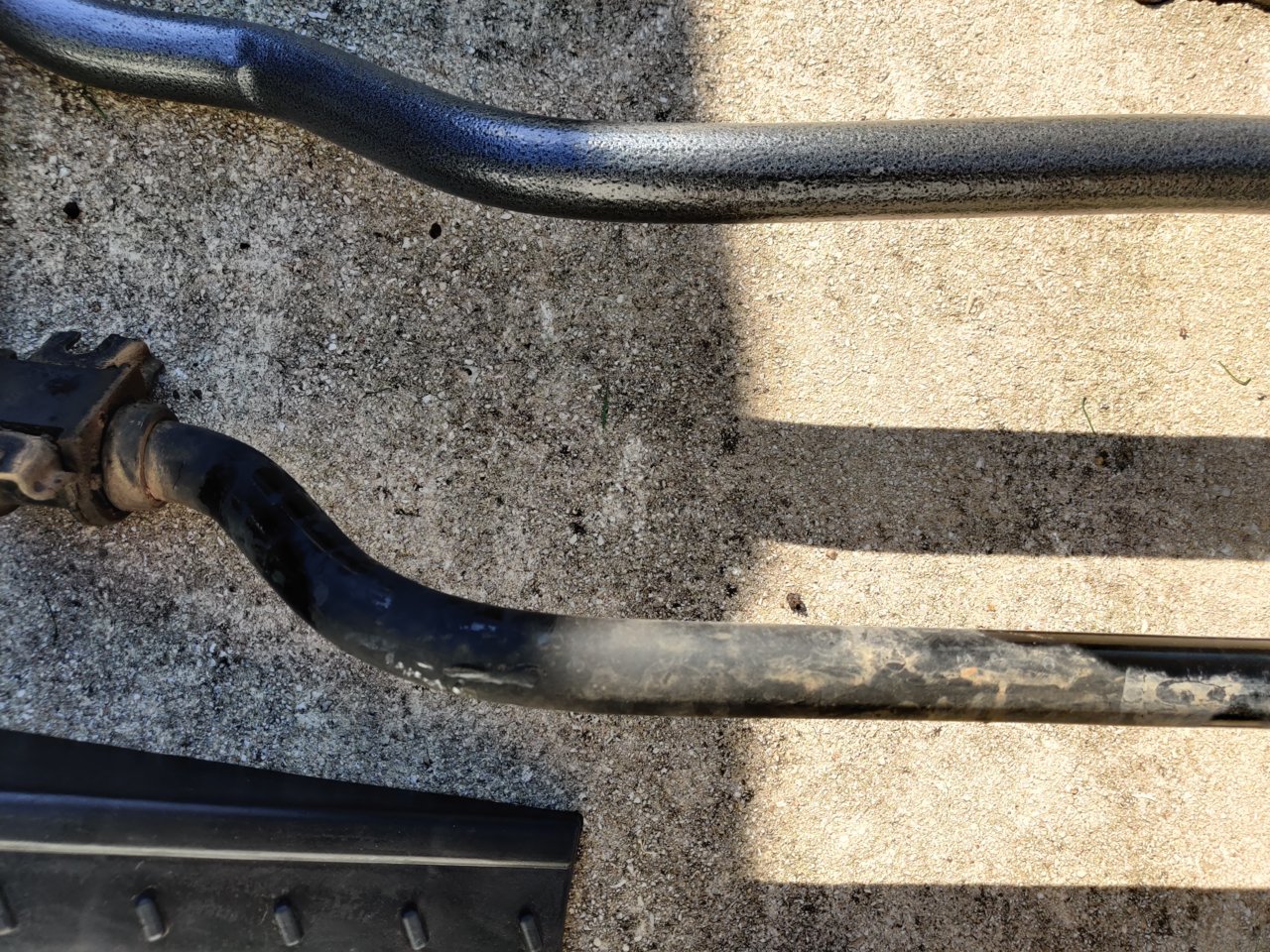

    Stock vs. hellwig. 1 3/8 I think.
    IMG_20211224_143929.jpghung from endlinks.

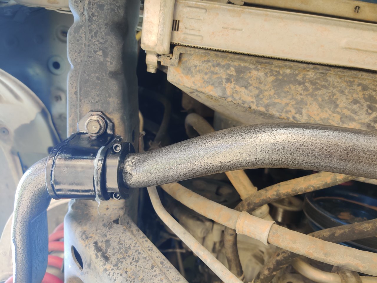

    What made this kit nice was the included lateral locks.
    Clearance is good. I was initially concerned about it but there plenty of room.

    Did it come with the lateral stops, or did you have to order those separately?
  7. Dec 25, 2021 at 6:45 AM
    #1087
    Lucario Runner
    Lucario Runner [OP] Resident Truck/SUV racer
    Jun 29, 2011
    #59067
    7,199
    Robert
    San Antonio, TX or nearest race track
    06 Toyota 4Runner
    AFE stage II intake, APR X1, URD 70mm Throttle Valve (ported and knife edged), NST intake manifold spacer, URD spec U headers, Denso IKH20, URD fuel pump, APR fuel rail, URD Y pipe, URD spec u catback, lightweight water pump pulley, Greddy sandwich cooler plate, Earls oil cooler, IPT valve body, FJ TRD shocks, Cusco front and rear sway bars, Energy Suspension rear track rod bushings and rear link bushings, Carbotech pads, Stoptech ss brake lines, Stoptech slotted rotors, Motul 600 rbf, Limited Grill, Painted hatch cover by me, Painted valve covers by me, Cobra CB, TRD rad and oil cap, Escort 8500, Autometer oil psi and temp gauges, AEM wideband afr gauge, Flexpod, Pioneer 400w speakers.
    It came with them.

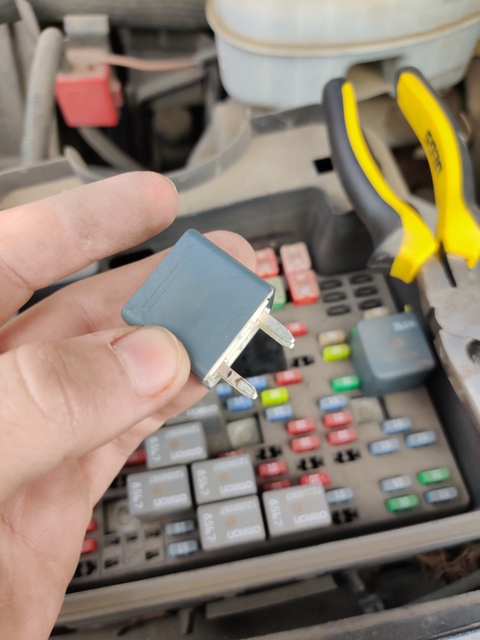

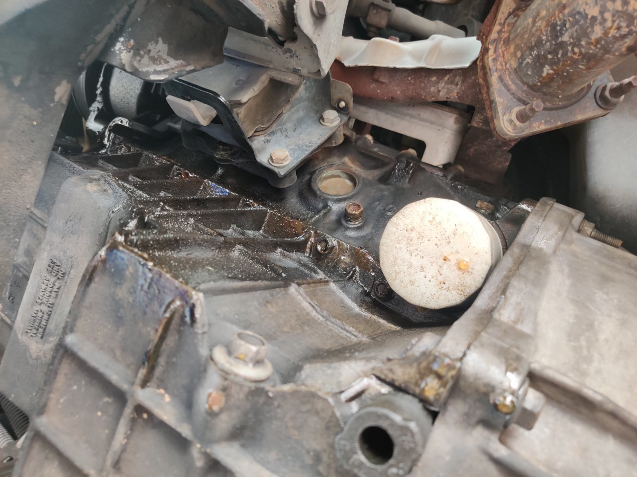

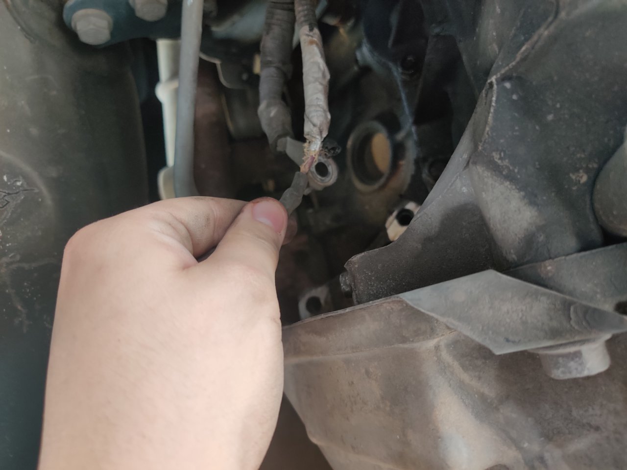

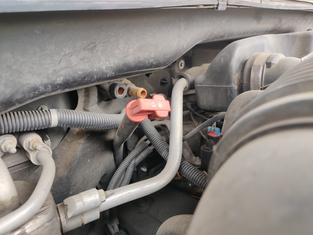

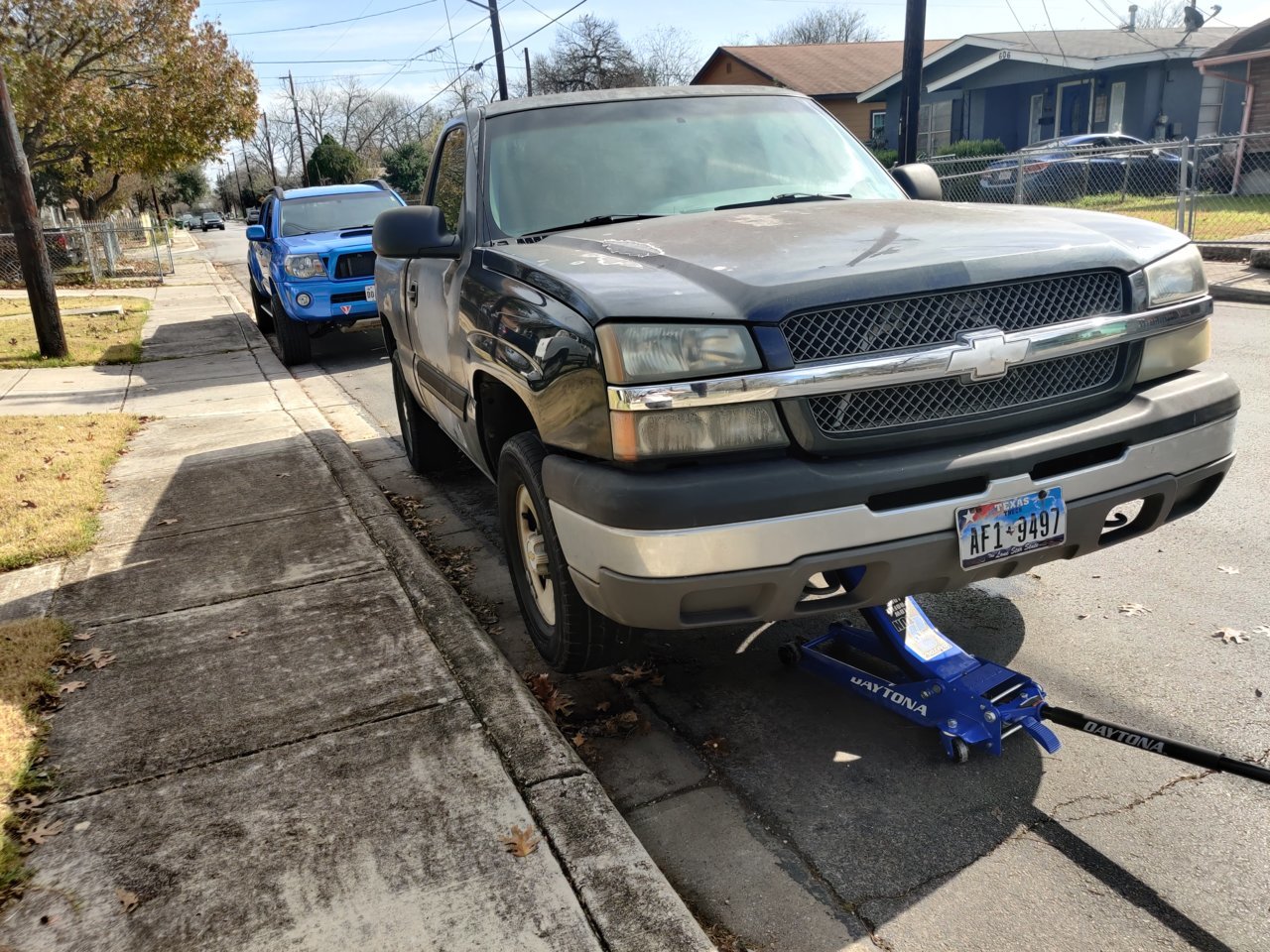

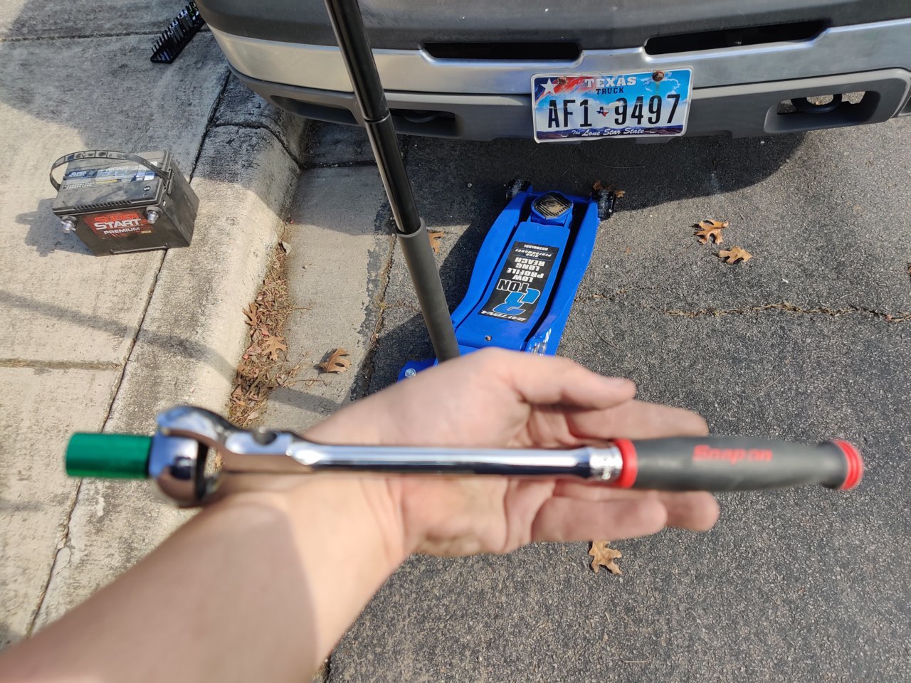

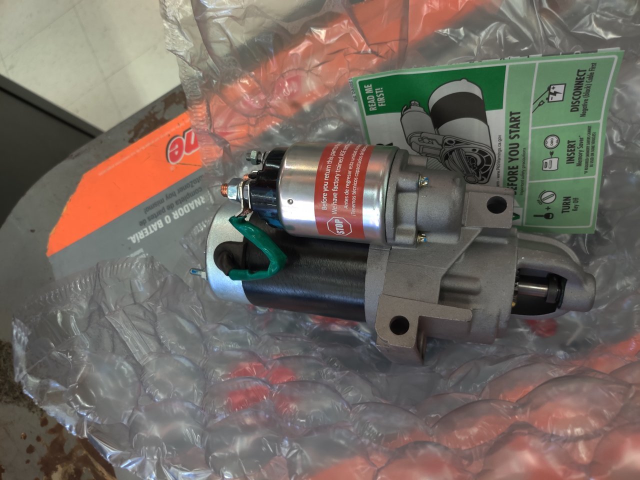

    Not so much modding but saving other vehicles in this case my uncle's truck. Truck left him stranded at a store and he towed it home. He got many opinions on what the issue was none of which were correct and luckily he didn't blindly buy parts before I looked at the truck.
    One of the fixes my 'mechanic' uncle, different uncle, did to the heater core. Yes this truck is a real shit box. I must state that I had no part in this bypass. I only smh whenever I see it. Anyway the issue with this truck was that it doesn't start from what I was told. My uncle was told it was either the battery or the alternator. When I tested the truck with the battery still in the truck it has power when you turn the key. However when you go to crank all power dies and does not crank at all. So that tells me it's something with the starter. So I go testing everything.
    relay looked like crap but still worked. So I narrowed it down to the starter and ordered one.
    A Little time passes as I insisted on getting a OEM starter and it got delivered. IMG_20220109_120008.jpg

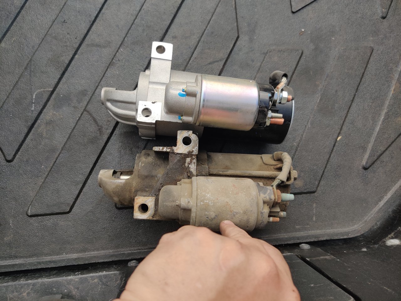

    So my spare tools from my trailer came in clutch as it has both sae and metric since I mostly just have metric at my house.
    Found this massive oil leak that Im guessing it's the front cover area. Also of course there's a puddle where I need to be to take the starter off. At least it's not cold otherwise I would not be doing this. Lol
    so the cover is basically just coming apart. I rewrapped it.

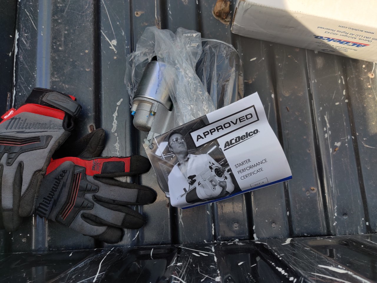

    So roadkill kicked it (when doesn't it) and after messing with the new one I compared it to the old one and it's the wrong one even though I entered the correct engine specs on Amazon.
    So in the end I got a duralast starter (I am not a fan of duralast) and it was more expensive that the AC Delco but it was the right one so on it goes. Old starter was also tested and was deemed bad. New starter installed and now runs and drives.IMG_20220109_133248.jpg
    Snapon and harbor freight yo. ;)
    Conclusion is to get a Tacoma or a 4runner.
