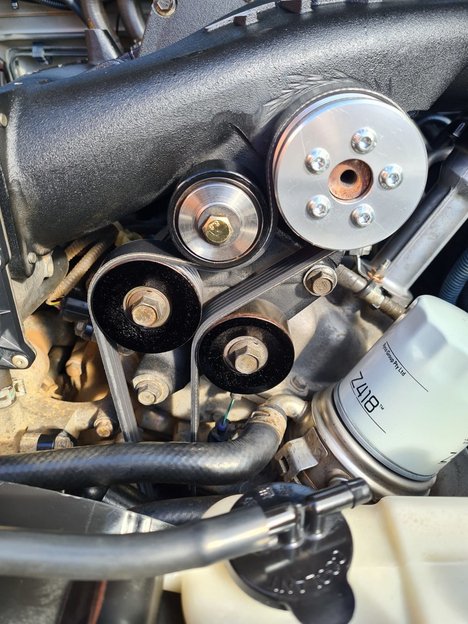

    Decided to invest in this additional idler pulley to help with belt slip when going down to a 2.7 or 2.5.

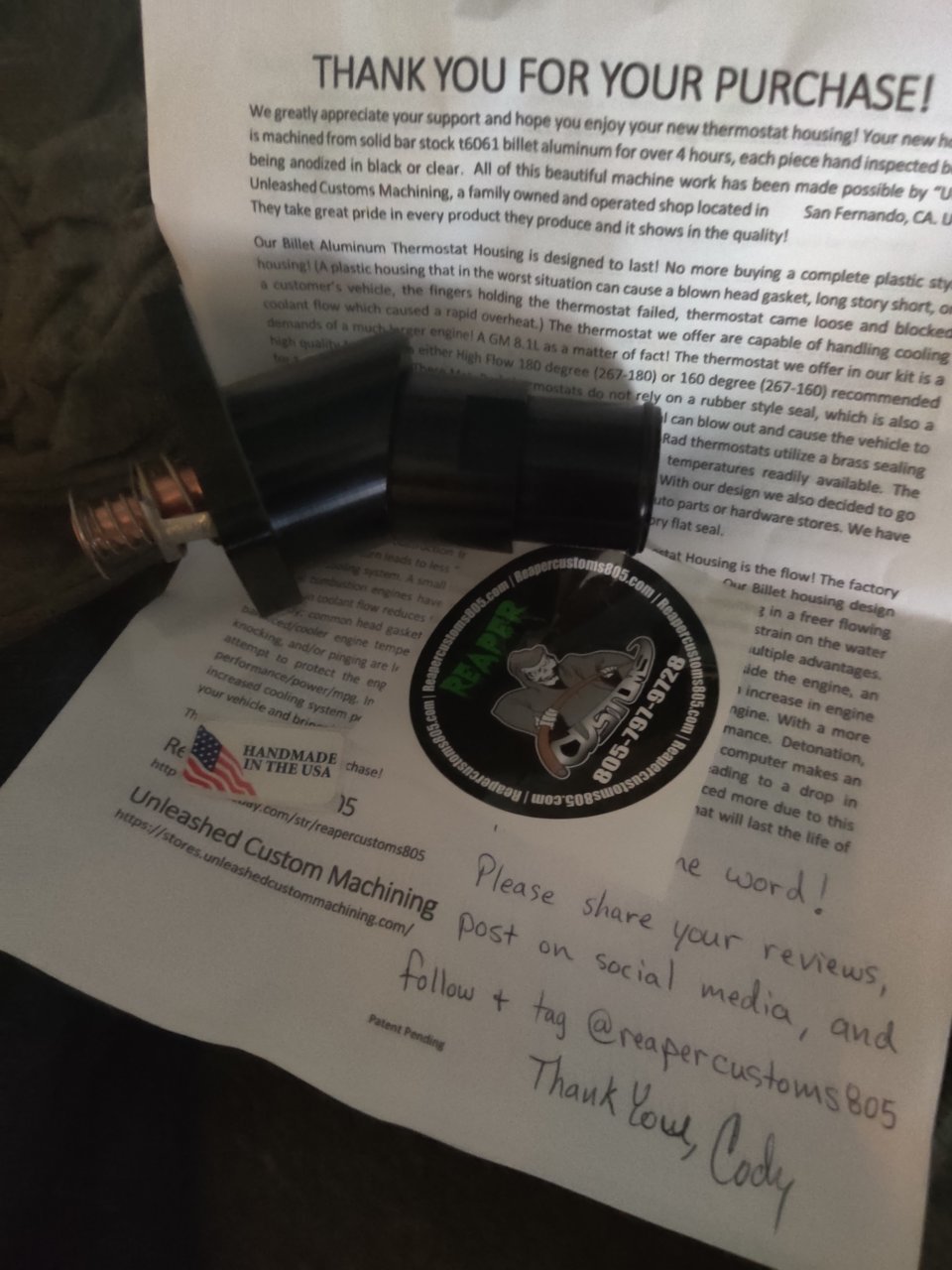

    Got my billet tstat from @1GR-FE<3R . Very nice piece. I'll install when I swap over the built engine in December.

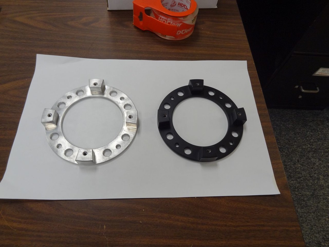

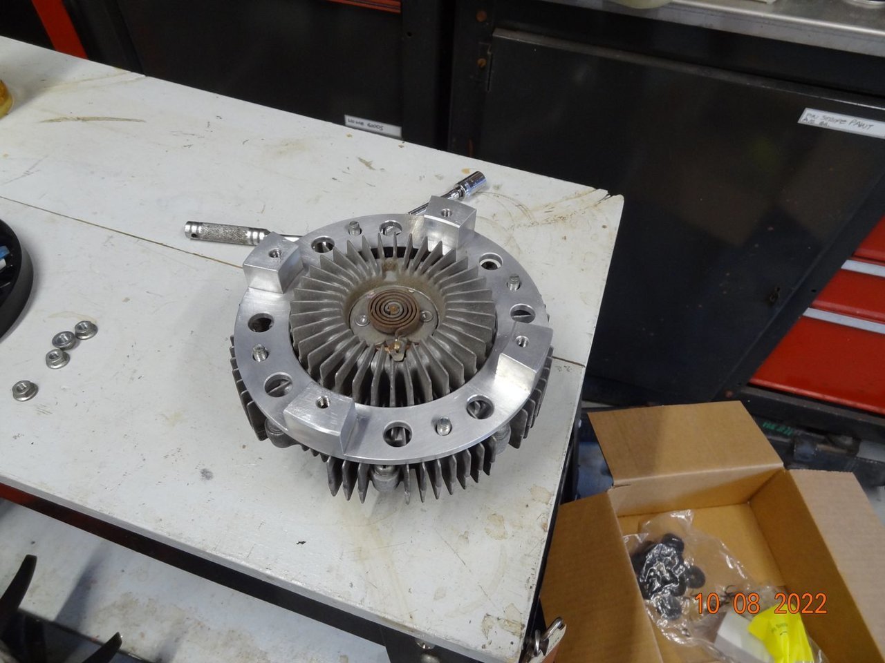

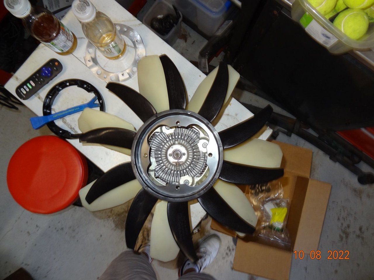

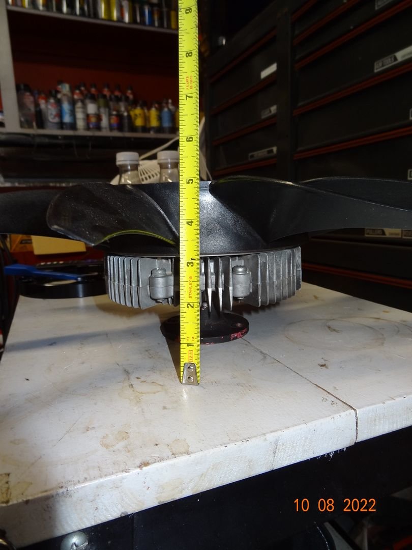

    This is Lucario's idea. I think it is a good idea, so I went through the process of making it. The idea is to pull more cfm at lower rpms.
    I have been using this for a few weeks. You use it with this fan:
    https://us.gktech.com/sr-ka-rb-vg-high-performance-engine-fan-60-more-air-flow
    It's a bolt on affair.
    To install it you take off the upper radiator shroud.
    Loosen fan shroud so you can get to the bolts off the existing fan. You do not need to remove it.
    You pull off the stock fan clutch and transfer to the new bracket.
    Bolt up the fan to the adapter, then install it on the engine.
    Before I bolted it the water pump, I put a little grease on the water pump flange (my stock fan
    was frozen to the water pump)
    Then you put the rest back together.
    The new assembly is approximately the same size as the stock fan.
    Here are a few more pics.
    White fan below is stock.
    Adapter with stock fan clutch.
    Stock fan height.
    New fan height.
    I made a few of these.
    I made these in raw aluminum. I made a few in a satin black powder coat.
    Price of the raw aluminum is $90 + shipping. Powder coat is $120 + shipping.
    I will ship it with new hardware.
    If you want one, jus shoot me a pm.

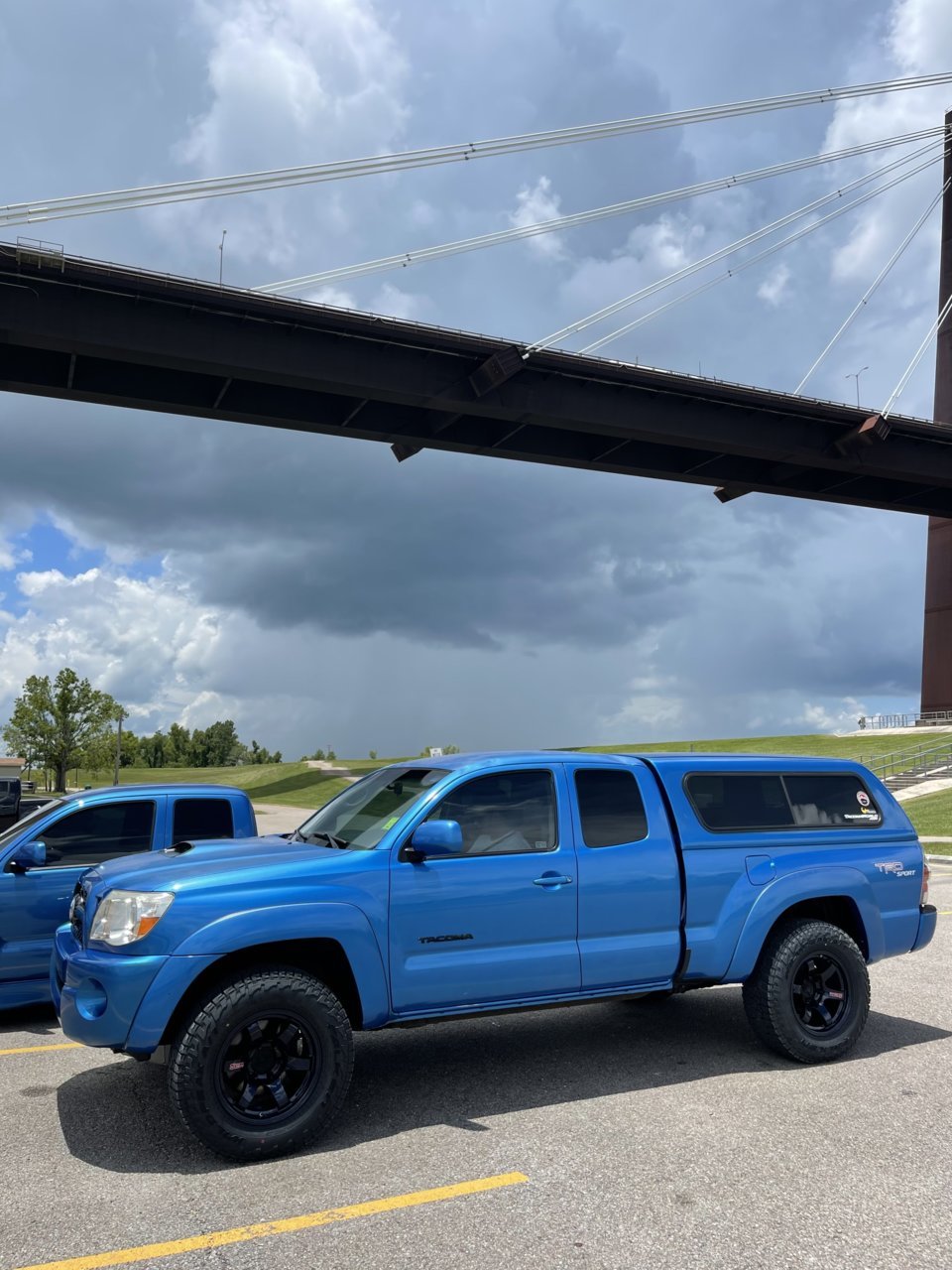

    2CB55610-A5FF-4B48-86F2-D5E234596A34.jpg 3EE0E2E8-916E-4B89-8AA1-0EBFBECF6DF8.jpg
    These are 17x8.5 +0 (System Motorsports offered a exclusive spec 8.5 -10 iirc)
