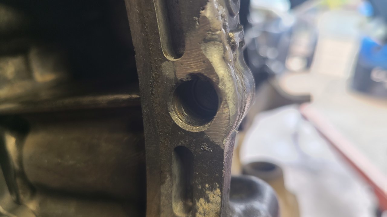

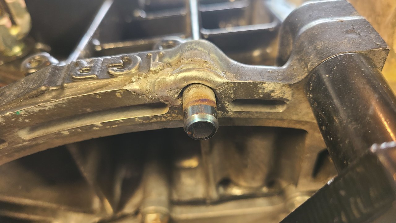

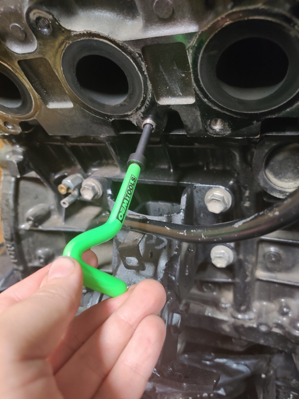

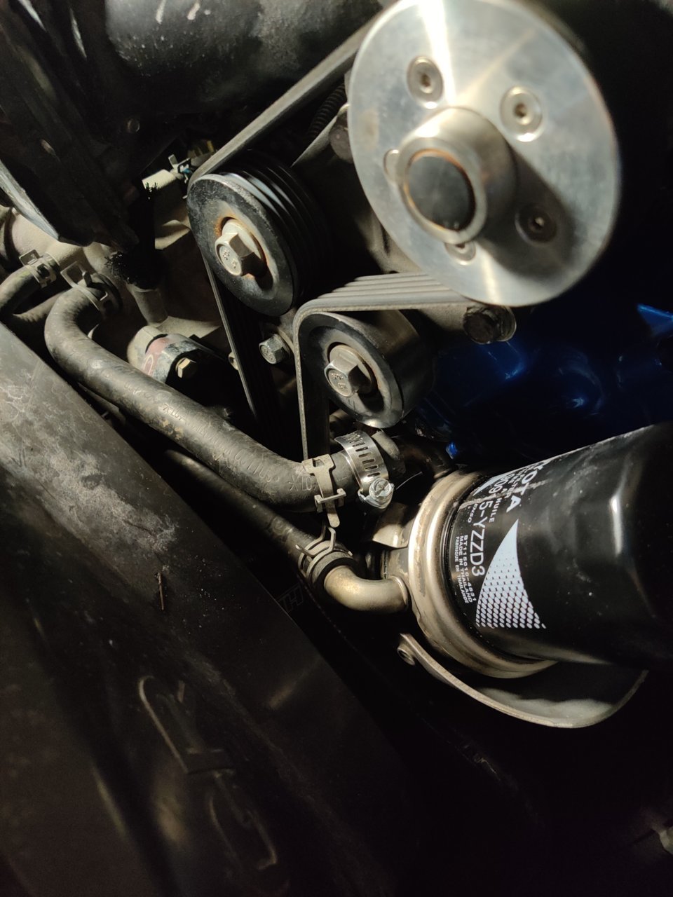

    It comes along. All NE timing cover bolts swapped. Oil pans on. Going to fix up a booger by a dowel pin, to give it back some strength. Then time to drop it in the engine bay.

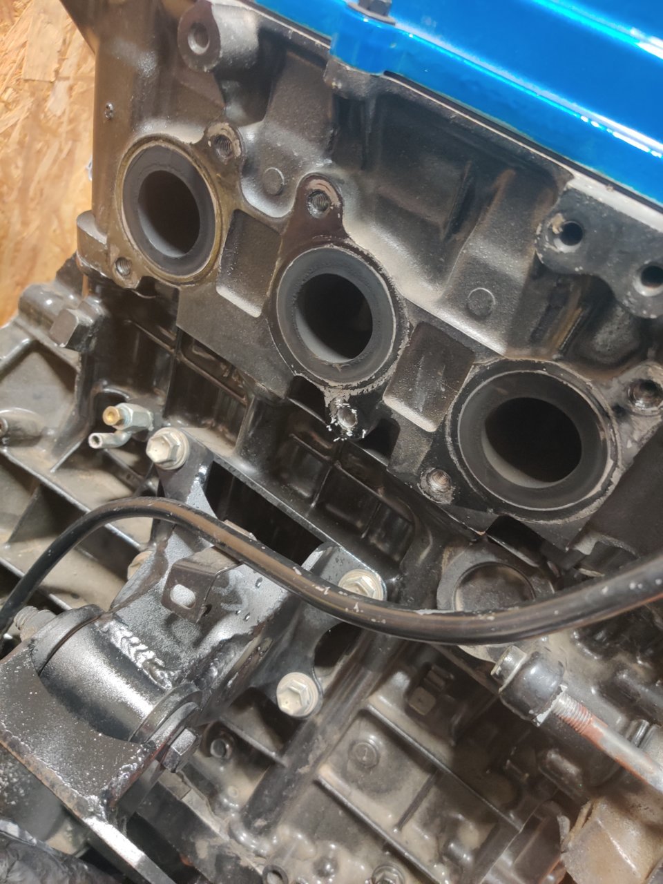

    Had to fix a thread with a helicoil.
    Pan swap to 4x4 pan.
    Added more material back to block.

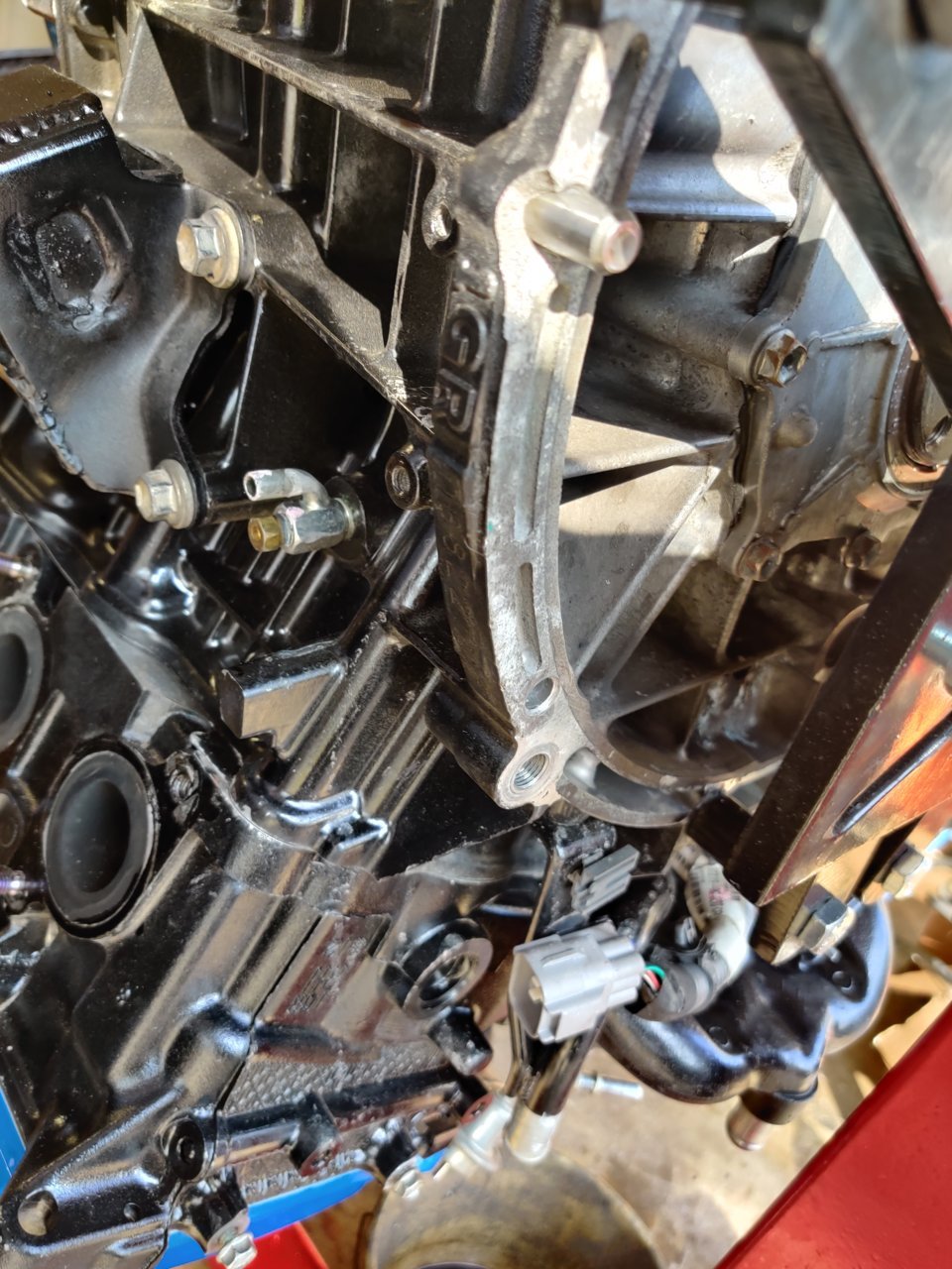

    Engine in. Lots of small things like fixing the lower oil pan for straightness, hardware swap, etc but now it's the how stretch.

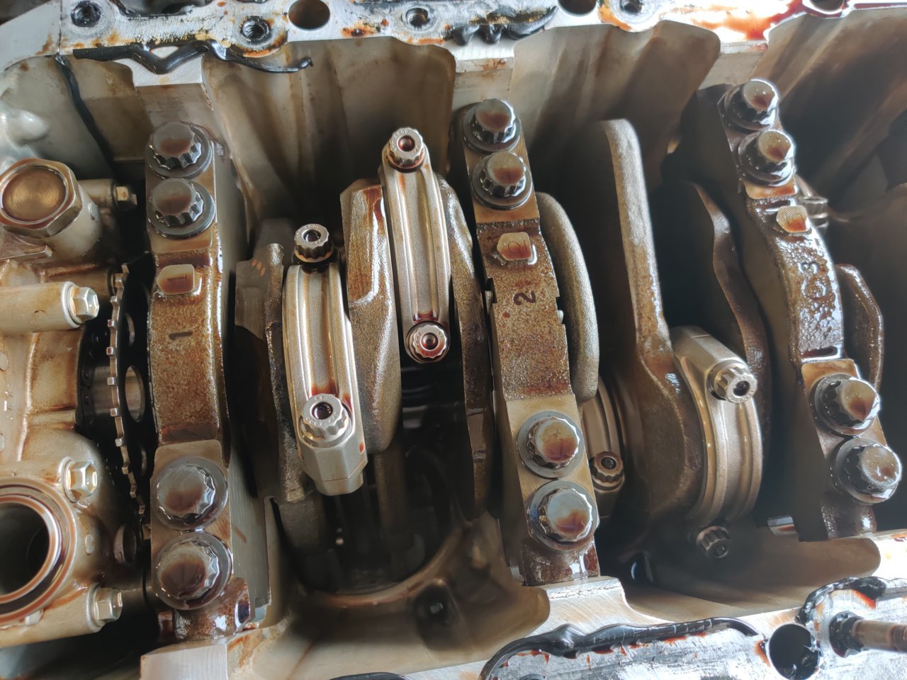

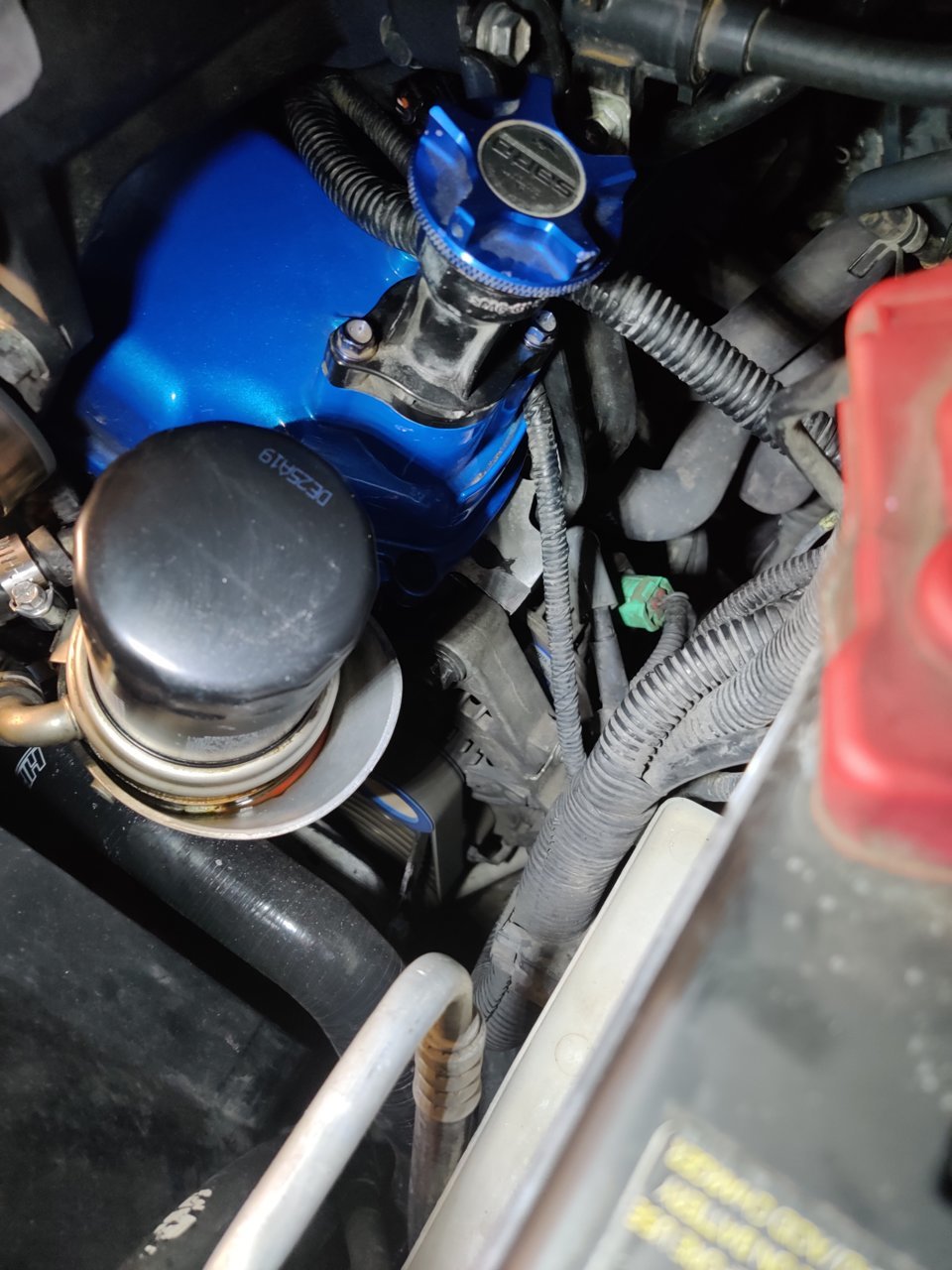

    Forgot to take a picture of the before, but it wasnt bad.

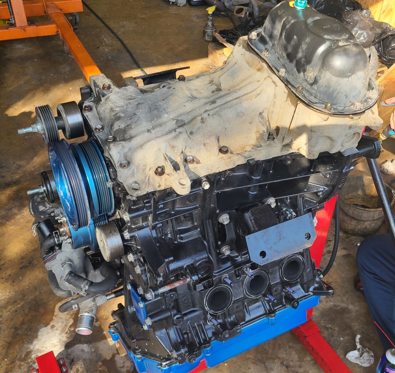

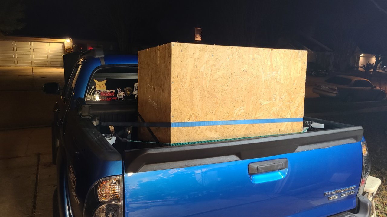

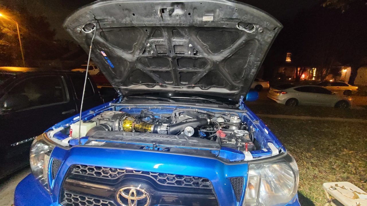

    Late last night. She sailed away.

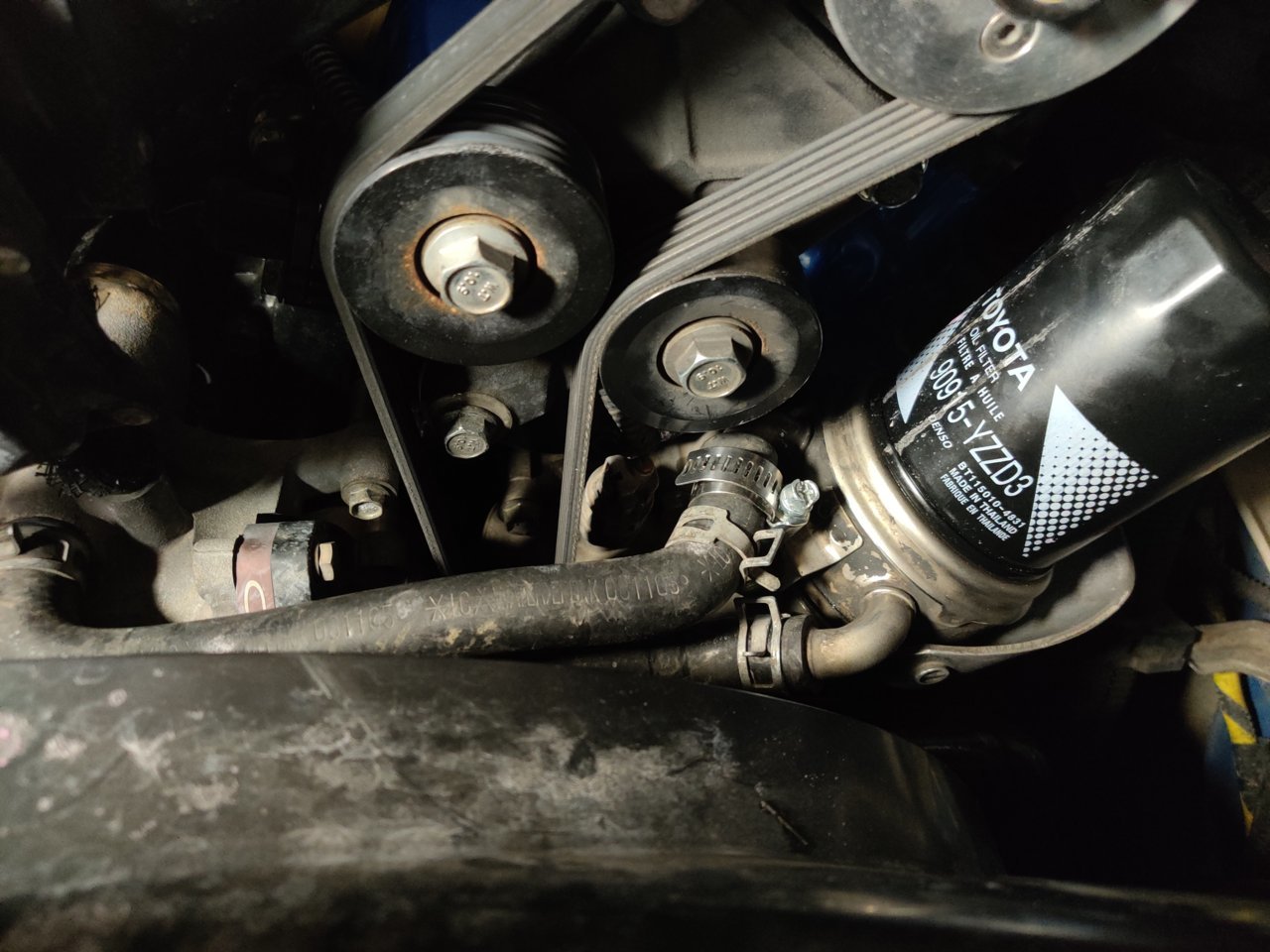

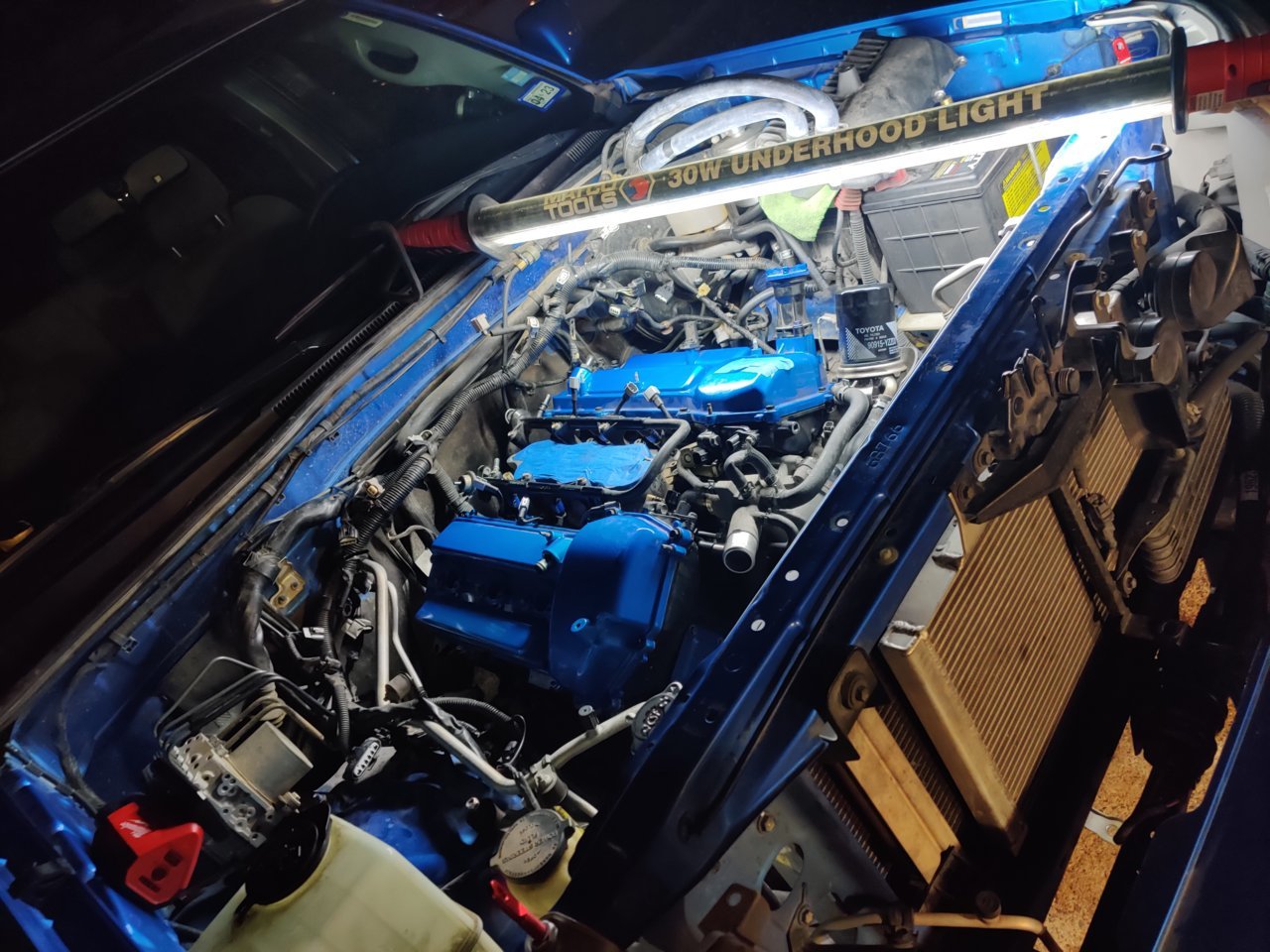

    Encountered one problem at first start-up. A leaking injector o-ring. Some quick work, and we had it corrected and back together.

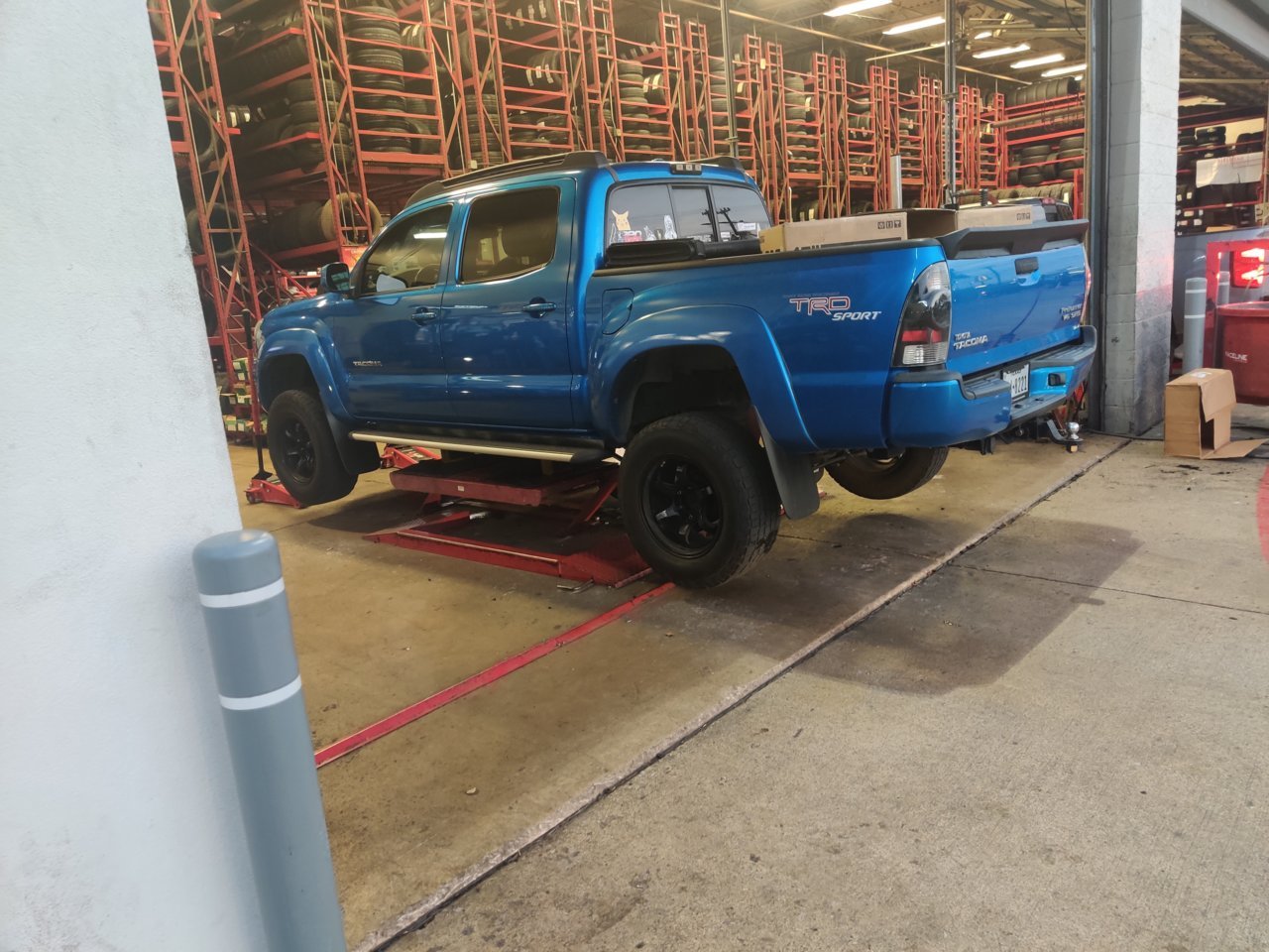

    Got a screen shot of the tire style?

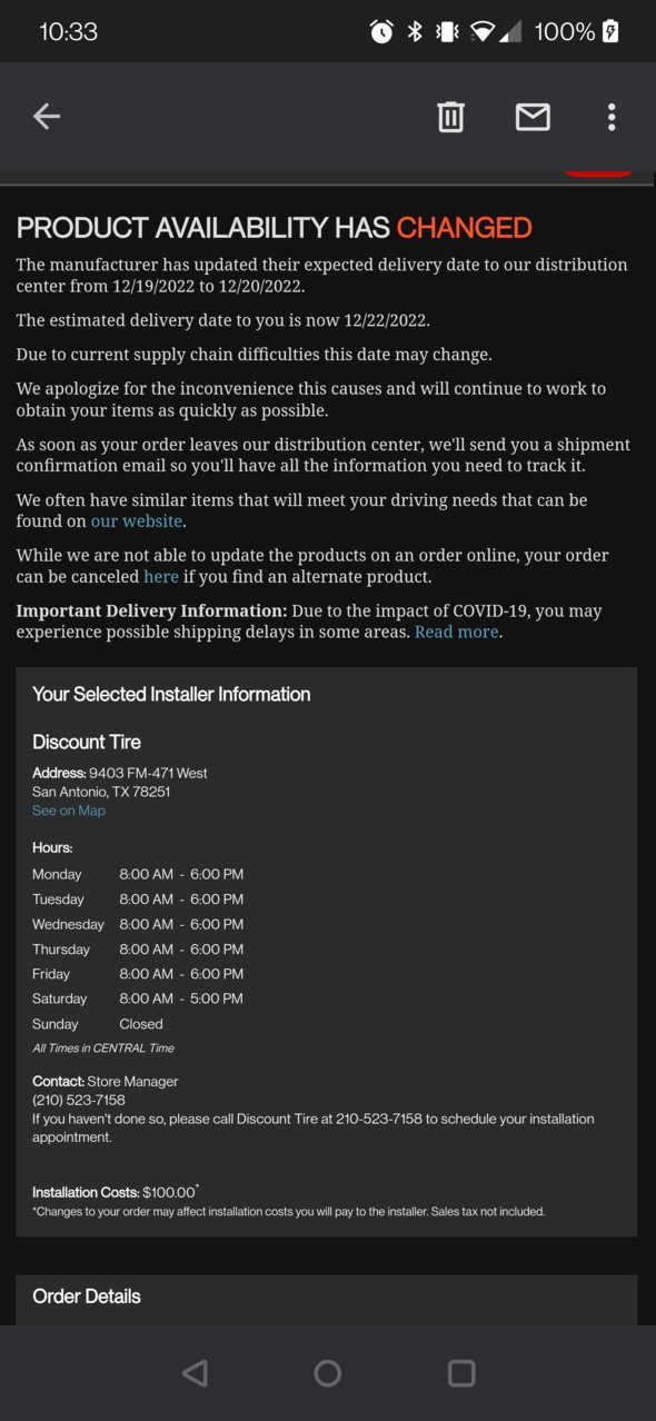

    Tires have shipped and should be here tomorrow, have an appointment for install after work.

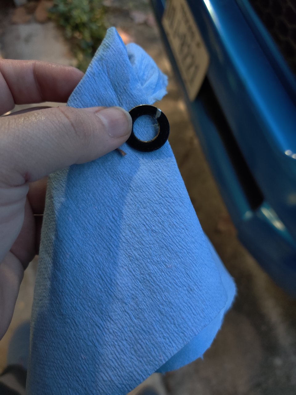

    PSA watch those crush washer when changing your oil. Had an annoying drip post engine swap. Should be fixed with the new crush washer in.

    Pesky coated o-ring.

    Look full droop. Max overlanding cred achieved.
