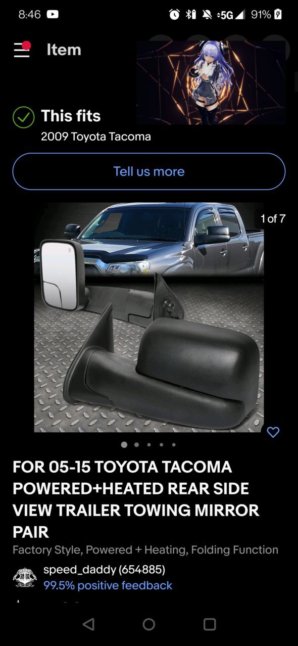

    Bruh. They make moose mirrors for Tacomas now.

    i couldn't find pre-painted units so ended up grabbing a used set from ebay that ended up showing broken, found some on marketplace and made a good set out of 4 mirrors lol thinking on getting some 2.5 with the turn signal and get them painted whenever I paint my hood.

    Lmao want some? That's why I was searching for some, to get rid of them thangs, free if you promise to destroy them :D

    I appreciate the offer but I'll decline. Do those really help with towing? I've towed with my 16ft car hauler trailer and didn't really have an issue with rear visibility.

    I wonder if there is a way to make those functional. It'll be the only way to convince me to get the 2.5 mirrors. Although I might look into the headed option as the cold makes the mirrors almost useless.

    I'm not sure to be honest, I think is more for looks, you already know how it is down here, tow mirrors, squat, GM 22" snowflakes, etc
    Truck came like that, can't stand them, they're hideous imo.

    I'll look into it and will keep you in the loop. And you're 100% correct, it'll be more beneficial to have heated mirrors.

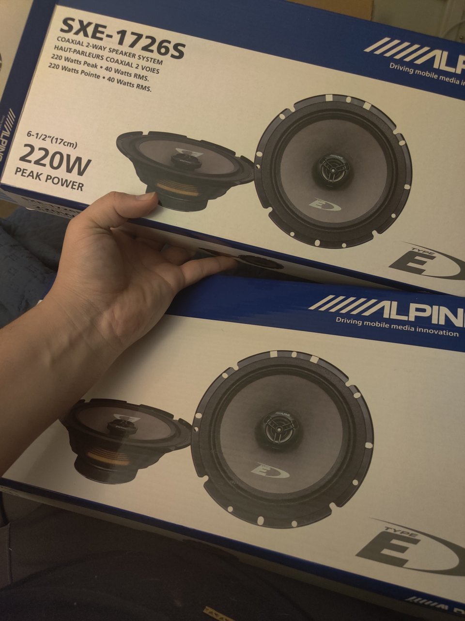

    Ordered some alpine 6.5 220w speakers. Hoping for some more volume during the commute. And maybe some tint too but always have been hesitant with the tint police.

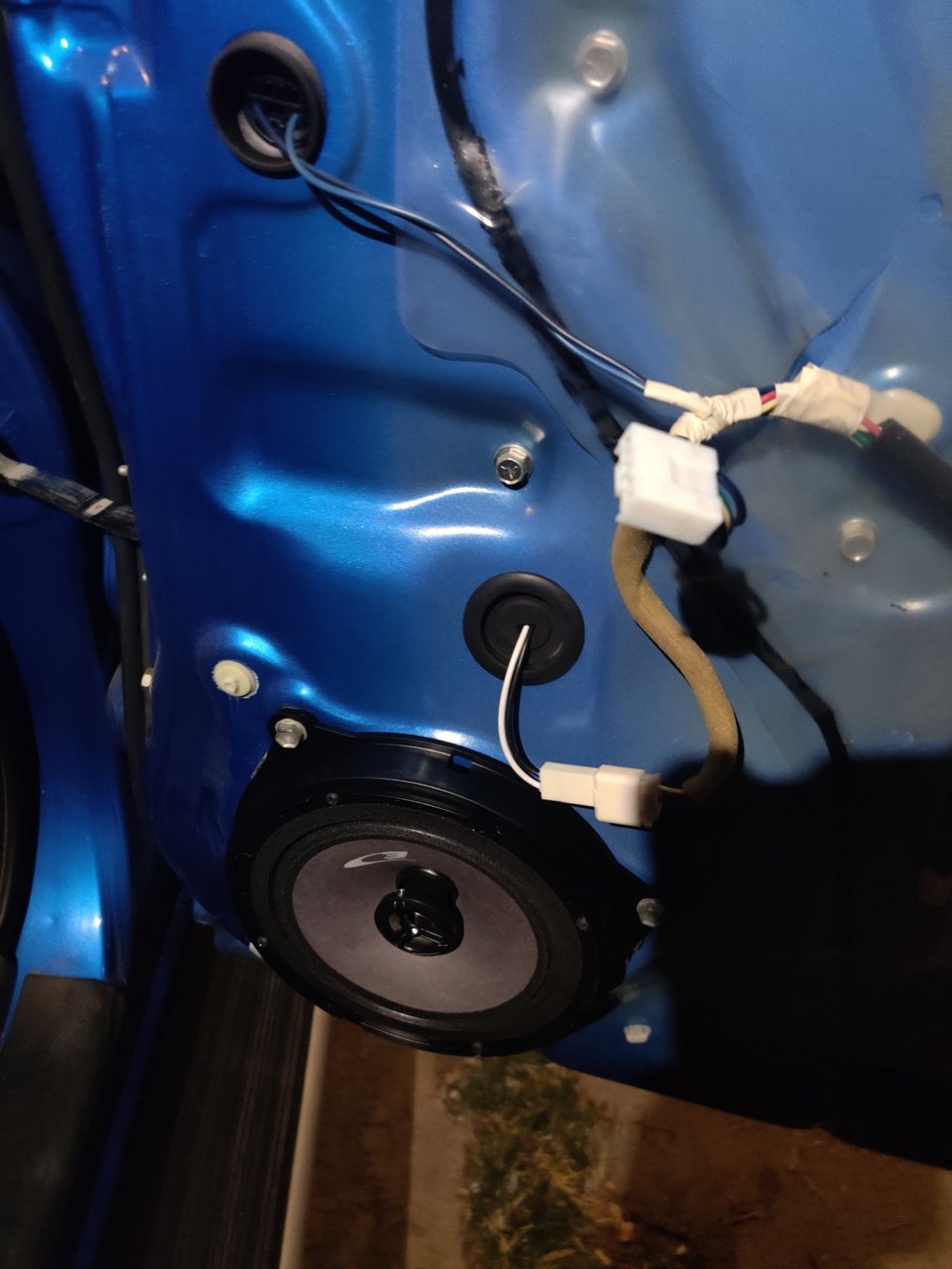

    IMG_20230117_173727.jpgorderer a pair of speakers and got a pair of boxes win. Ordered some new ikh22 plugs from rock auto for less than $60 shipped so good deal, everywhere else was like $12-15 each. Had a po300 this morning on the way to work. It's supposed to rain this weekend but I plan on addressing the cooling system for air, and swapping the advans back on.

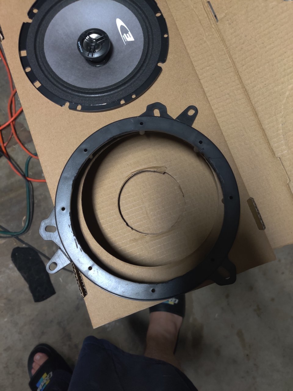

    Had to modify the brackets for the speakers to be fully seated but got both sides installed. Sound good. Need to replace some clips that broke that hood the door panel on but that's no biggie.

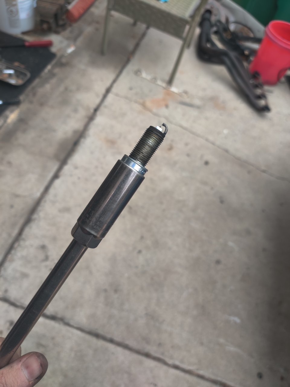

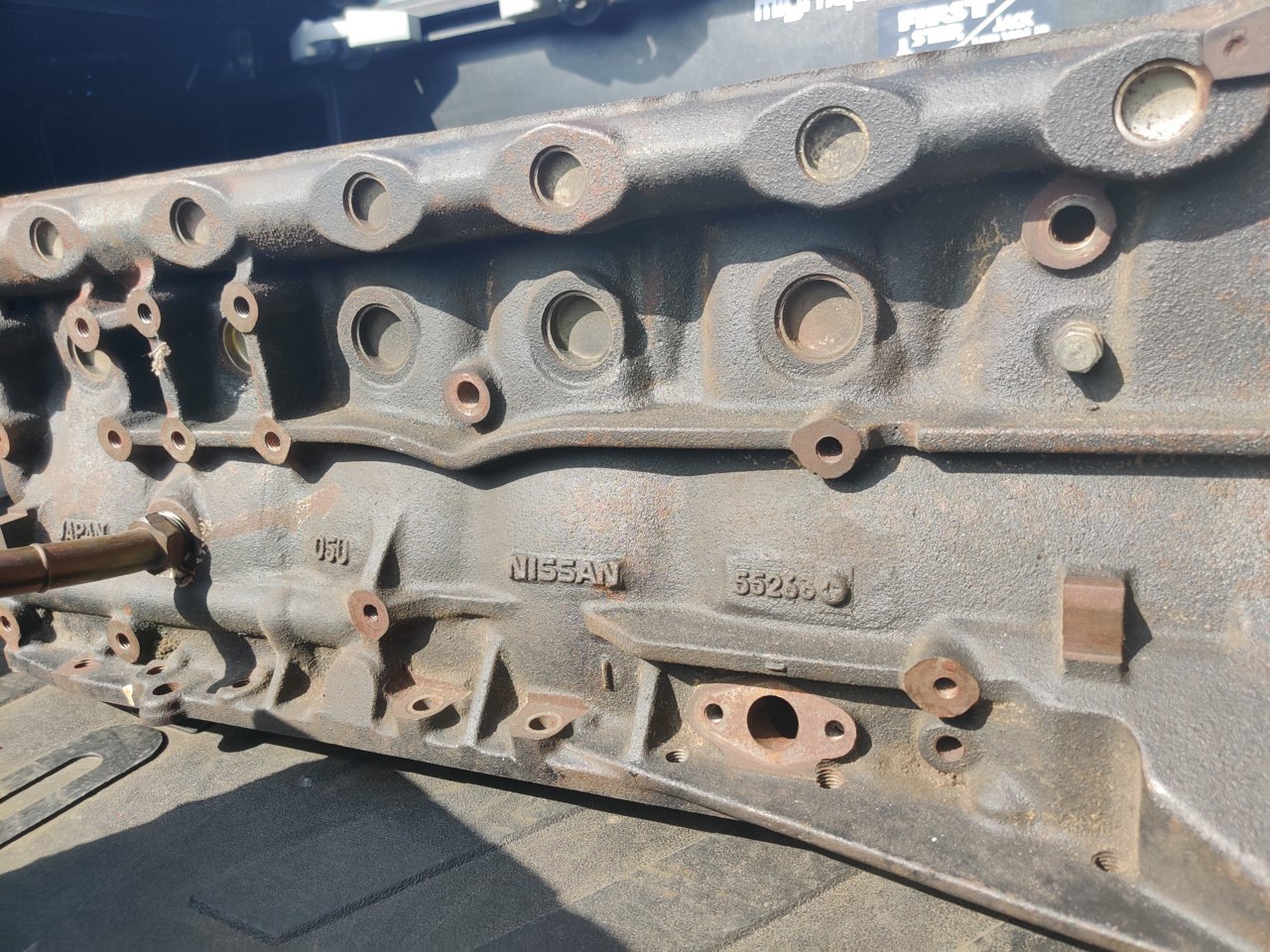

    Hello GTR block.

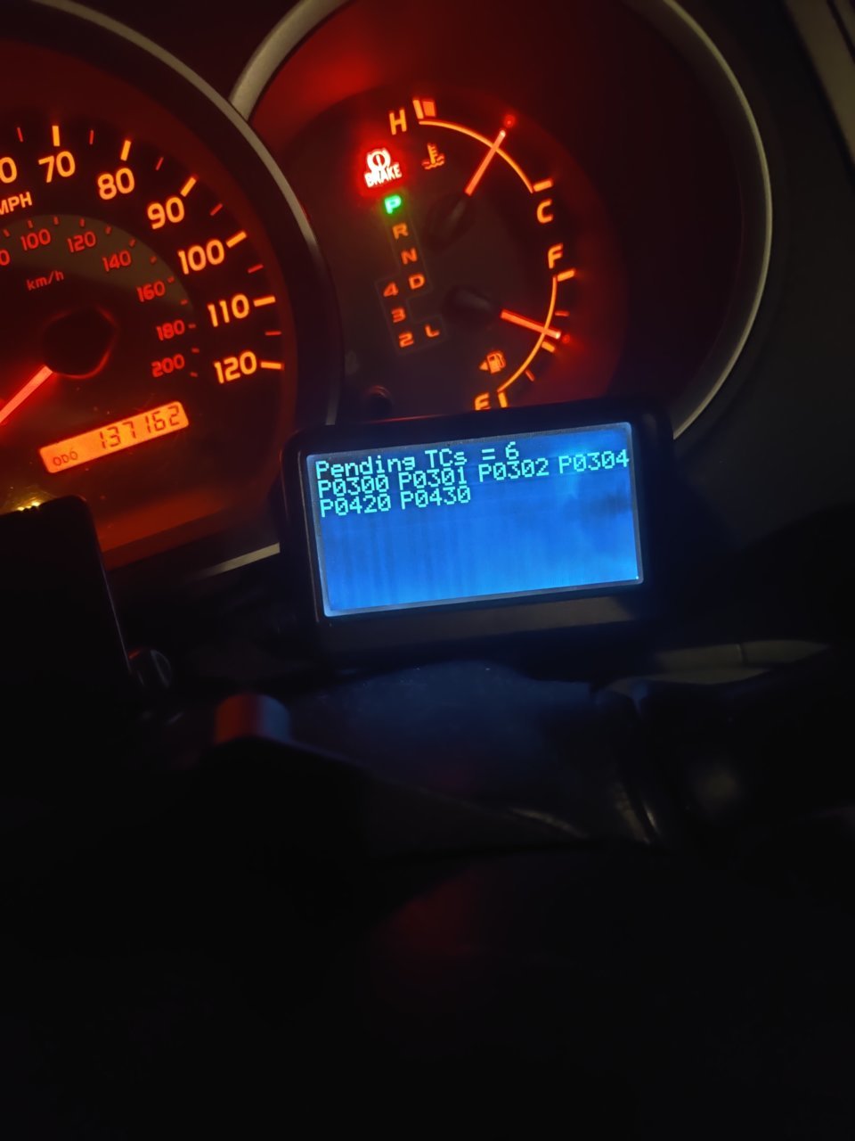

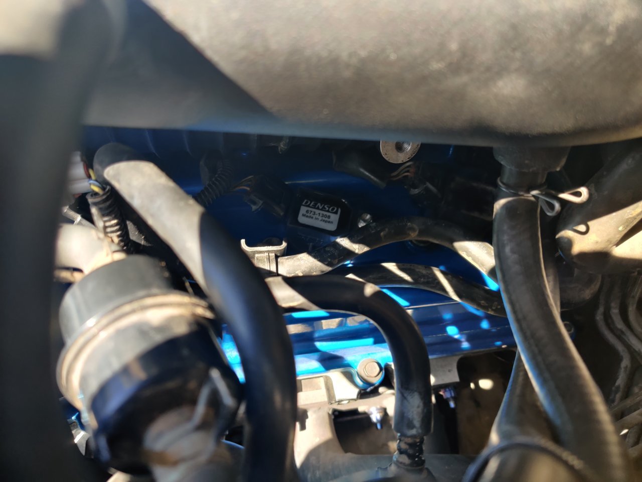

    So I'm tracking a random misfire issue. Pulled some plugs from the coded cylinders and the plugs look good. So next guess is the coil packs. I'll swap some off my 4runner and see how it does.

    Swapped the coils over and the truck runs a bit smoother, so gonna order a set of coil packs.
