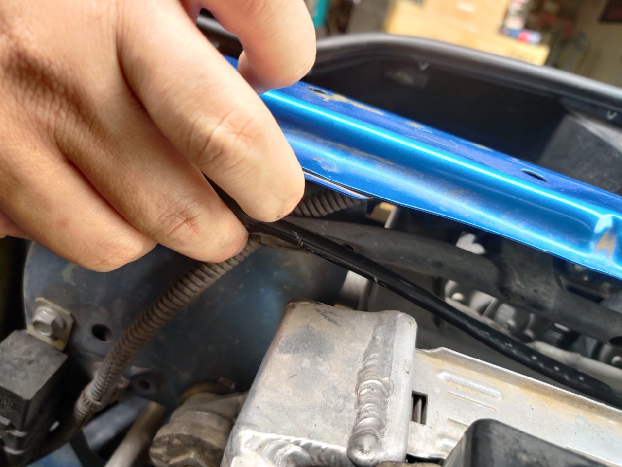

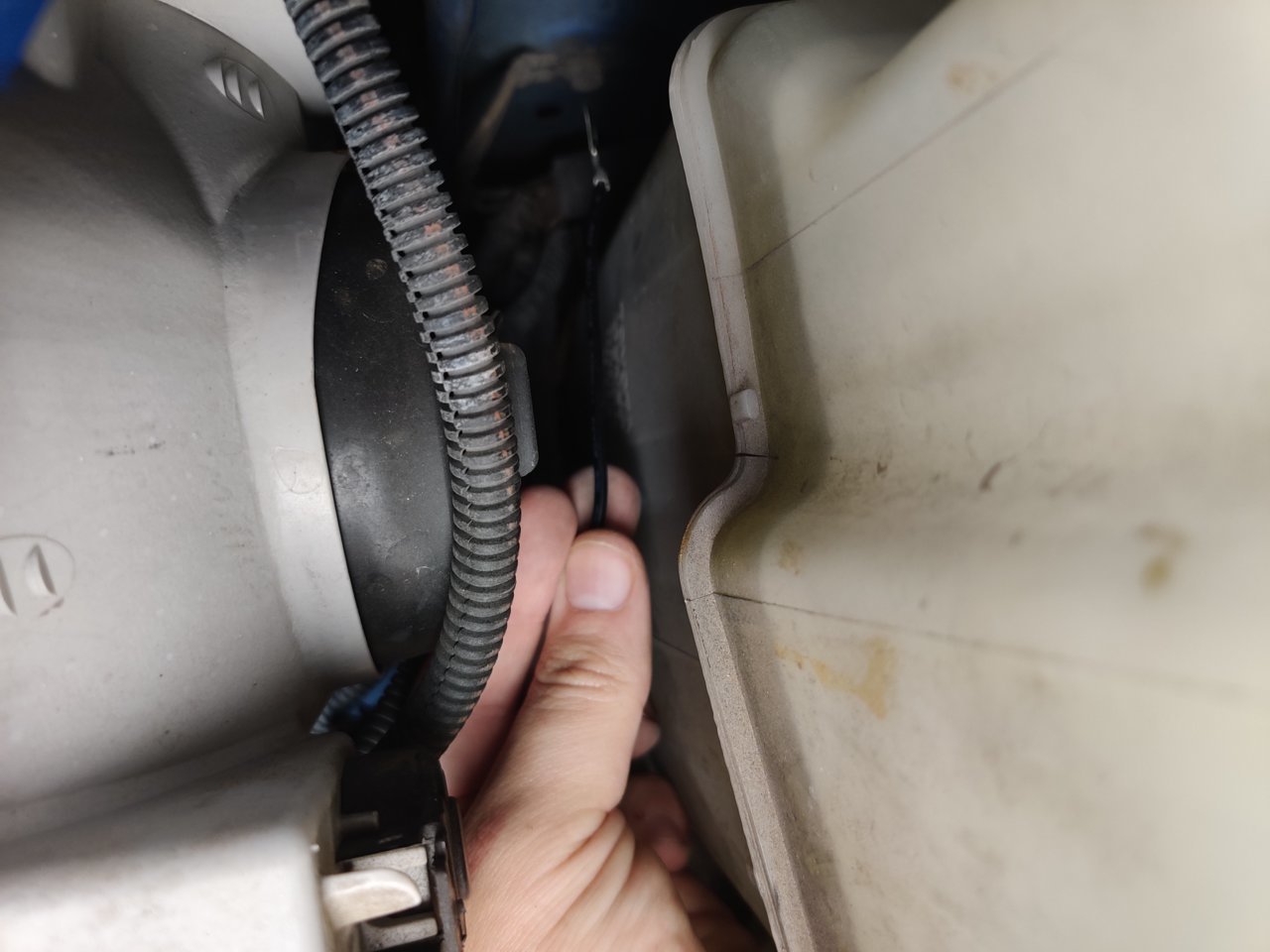

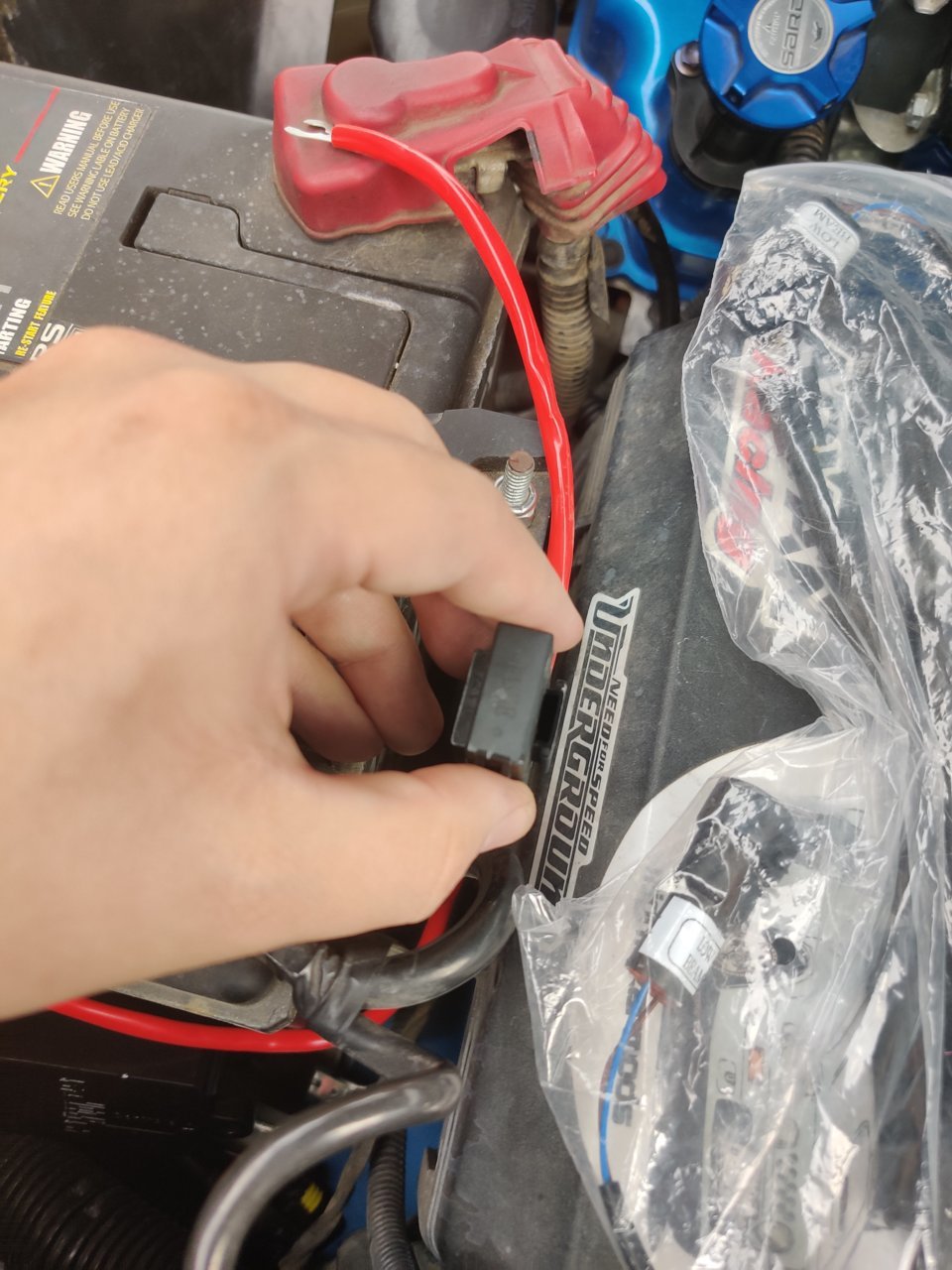

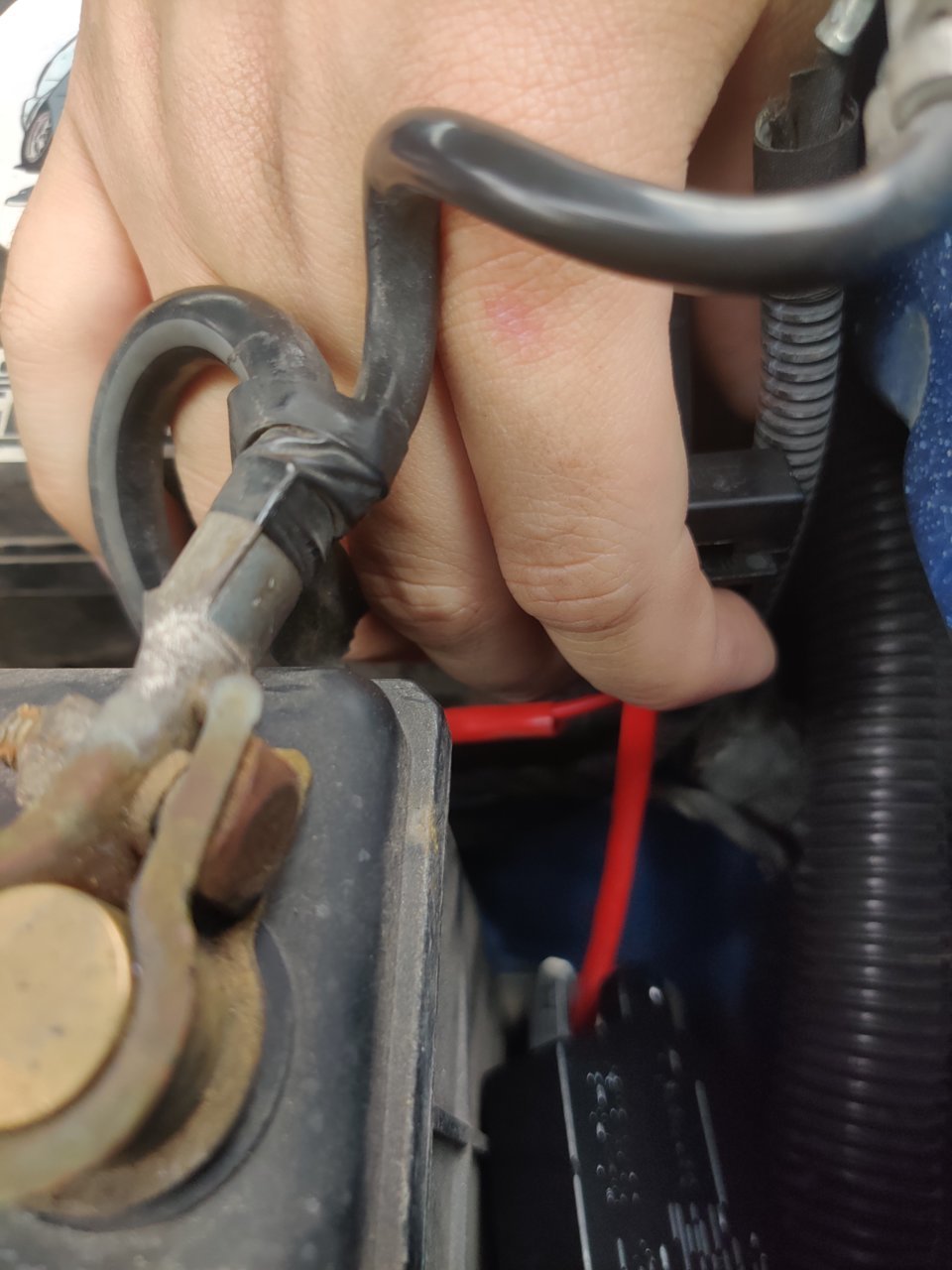

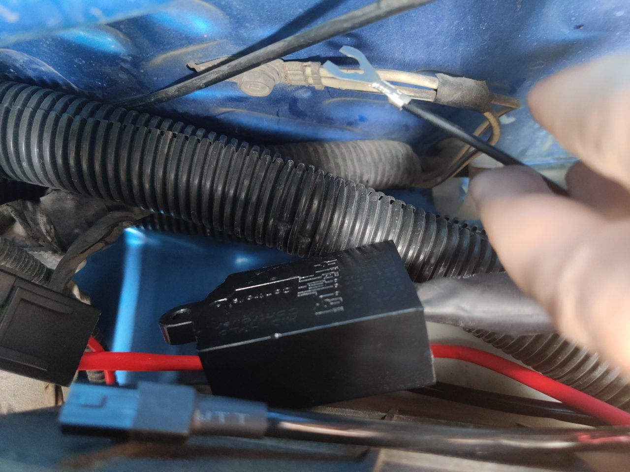

    Upon initial impression I'm thinking the wiring will go like this. Open to any suggestions.
    Route battery wire behind battery.
    Could zip tie fuse block to this loom to secure.
    IMG_20230223_164546.jpgbolt driver side ground to this body ground.
    IMG_20230223_164951.jpgnot a fan of the idea but could double side tape this to inner fender. Hole is really some and no bolt holes available minus the body ground and places for clips.
    IMG_20230223_164630.jpgzip tie passenger side wiring to hood release cover.
    IMG_20230223_164719.jpgsecure this side with zip tie through radiator support that is not being used by the intake.
    Use this ground for passenger side headlight.
