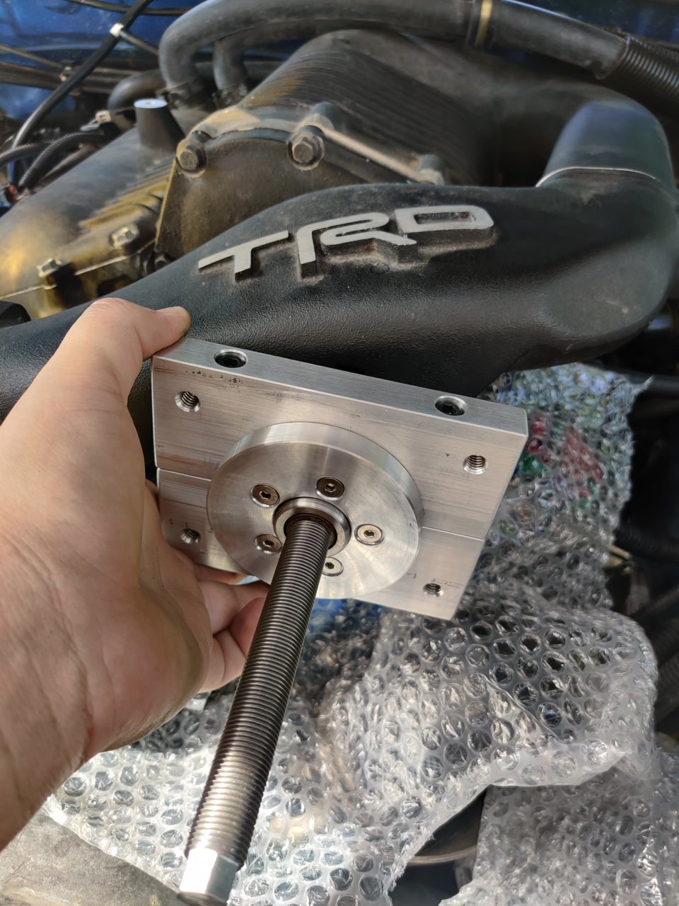

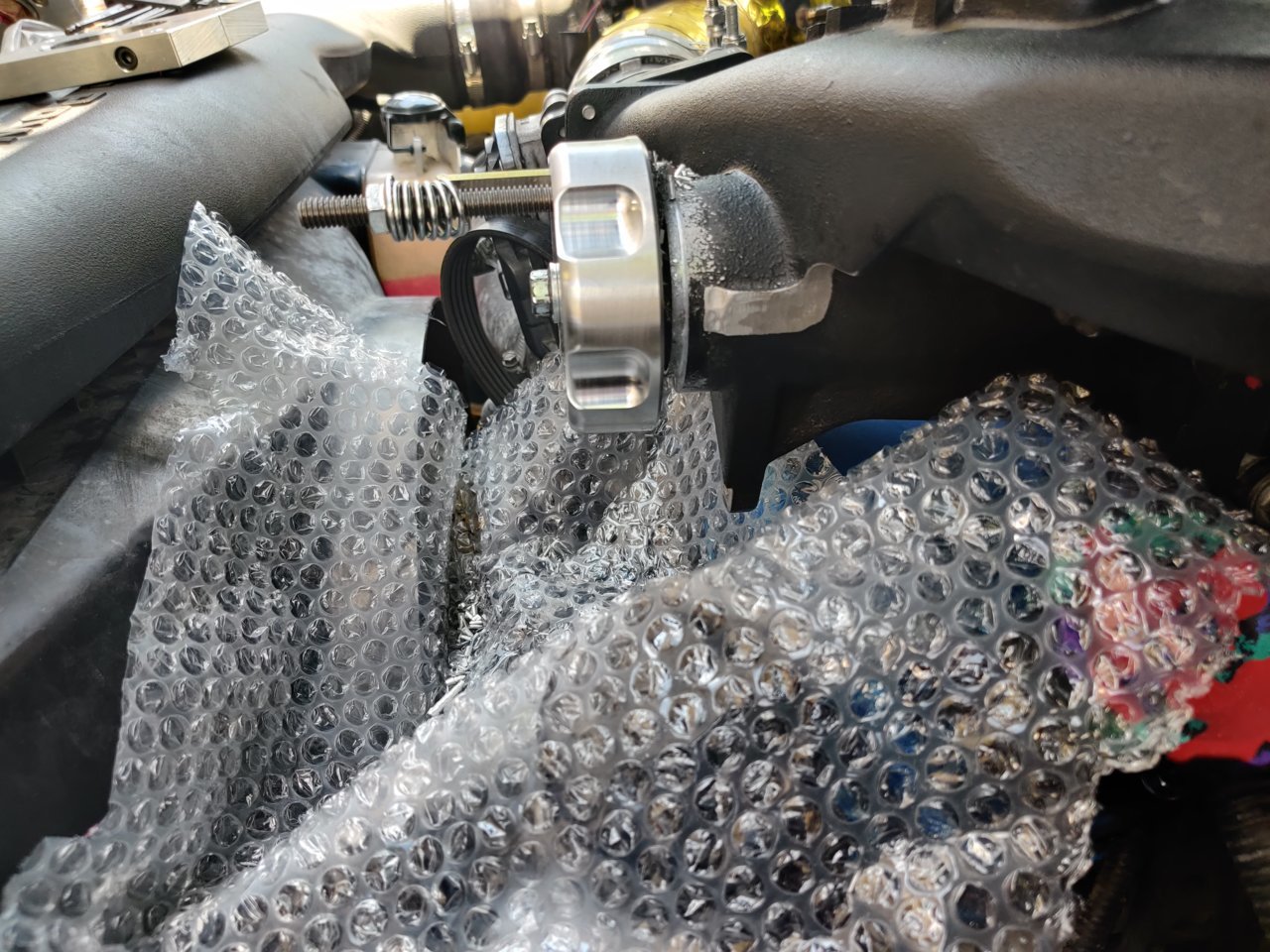

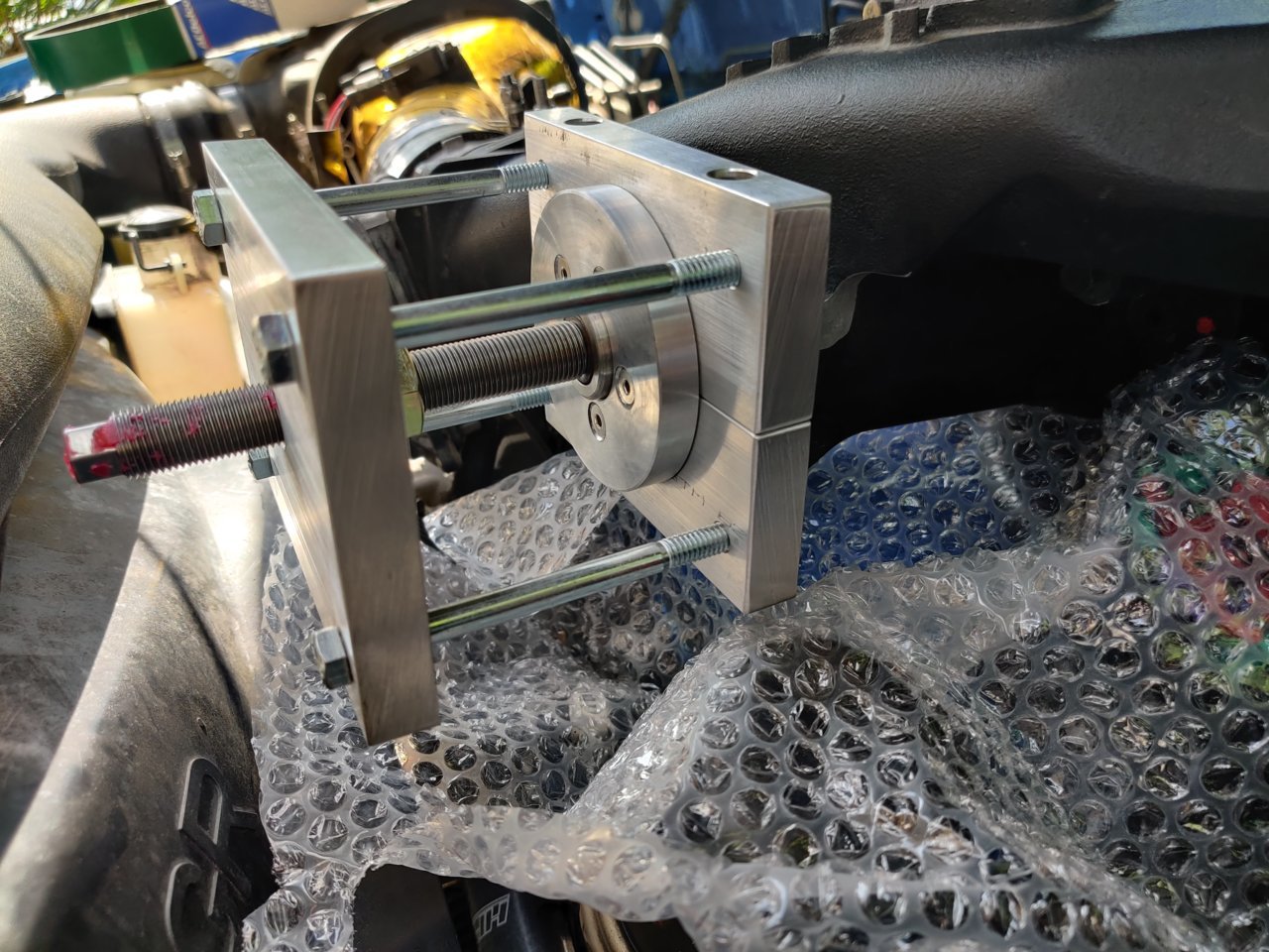

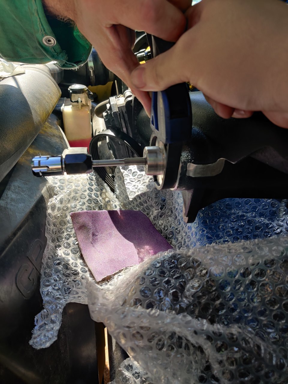

    Thread was mess up on the snout, that was fixed and the hub is off, cutting the material off the supercharger for smaller pulley clearance.

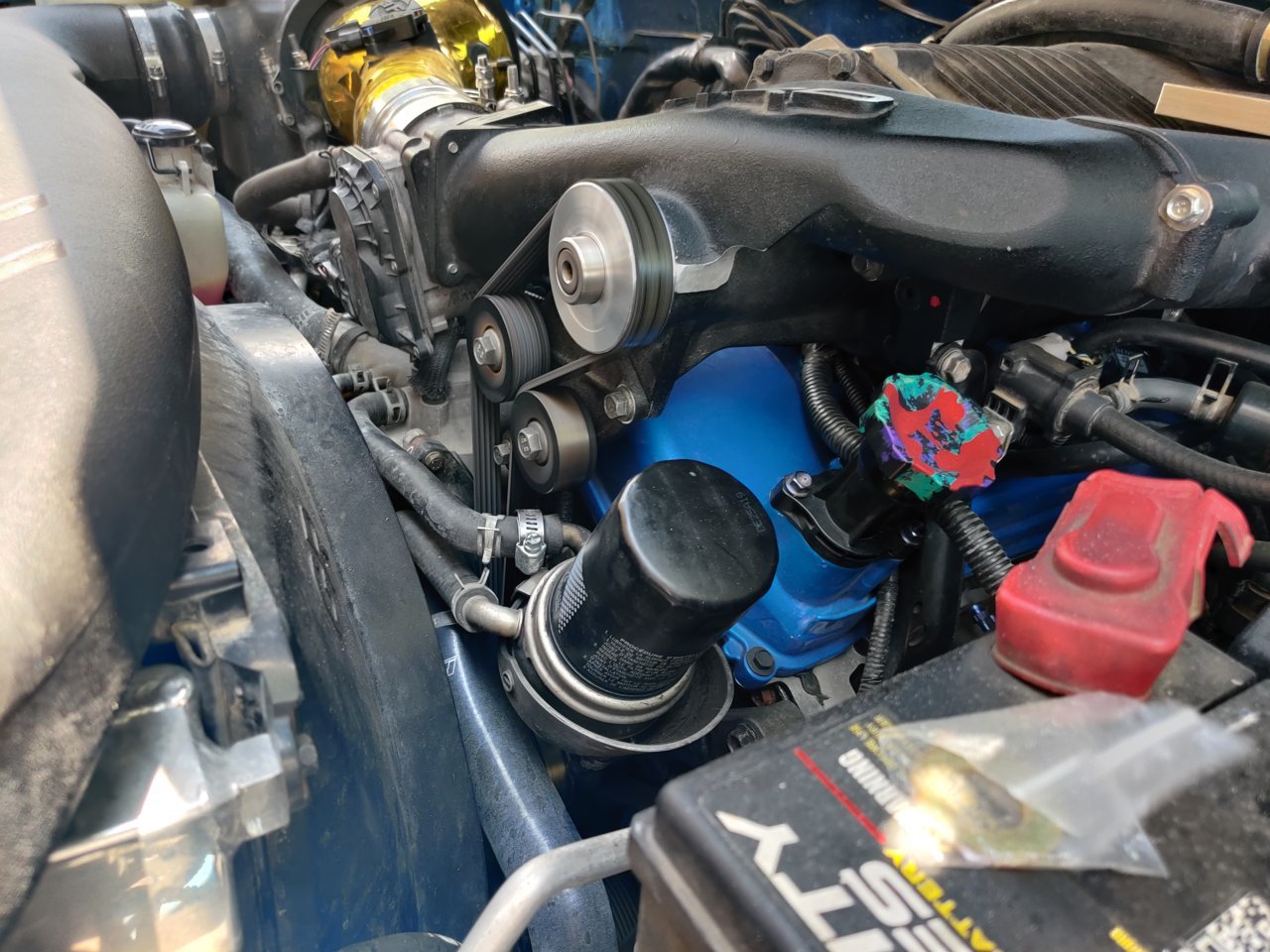

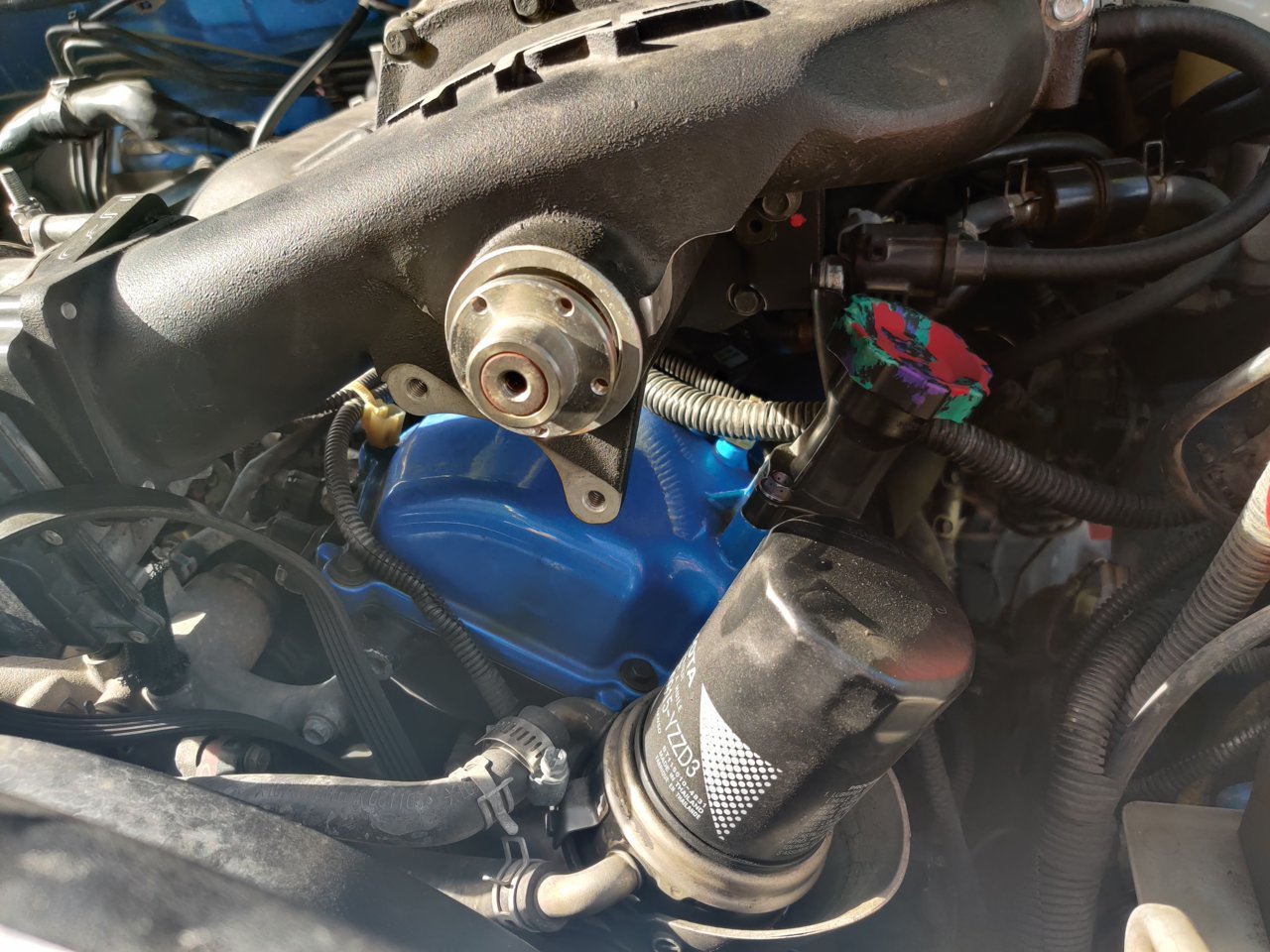

    Where did you get the short oil filler neck?

    Part numbers:
    12196-38010 Tundra oil filler tube seal
    12185-38011 Tundra oil filler tube
    Any Toyota dealer should get it for ya

    Cool thanks!
    Great way to save a couple ounces and lower the trucks center of gravity a thou or two :D

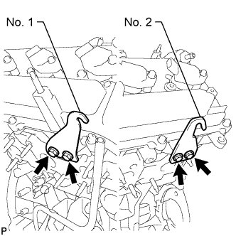

    12282-31050
    12281-31070
    These are the Toyota OEM part numbers for what they call engine hangers… in case you don’t wanna fab your own. They’re like $35 bucks per side, not too bad.
    90119-08A87 Is the part number for the bolt (4x); not sure off hand what thread size/pitch probably M10 1.25 or something
