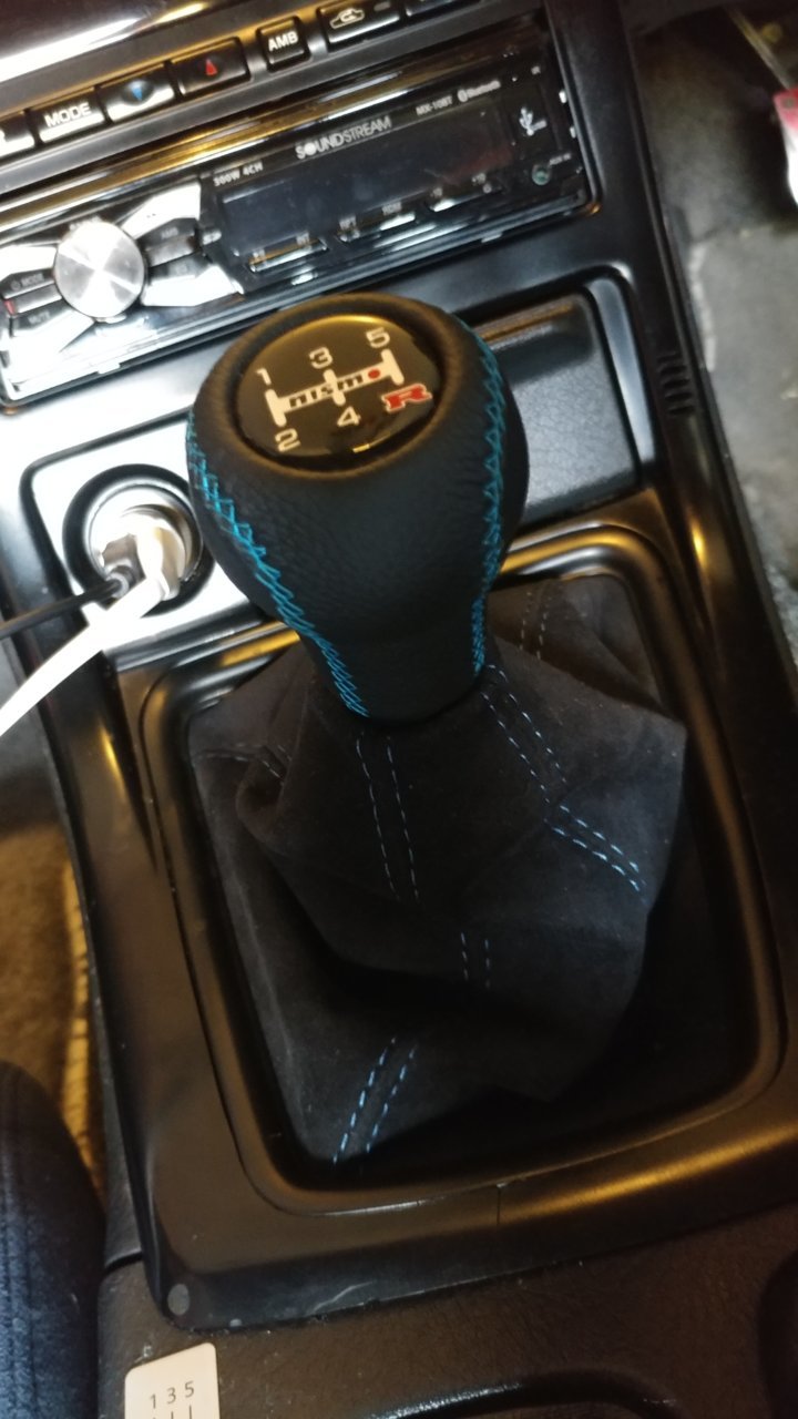

  6. May 9, 2019 at 2:43 PM

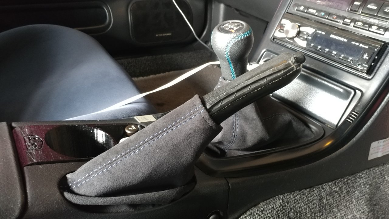

    Alcantera shift boot. Still need to install thr ebrake one.

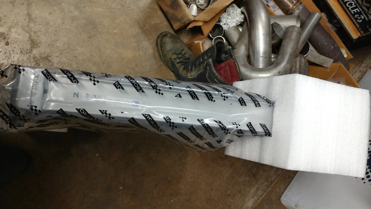

    20190522_152730.jpg 20190522_152736.jpg koyo rad showed up today.
    Ebrake boot installed today. Was a pita.

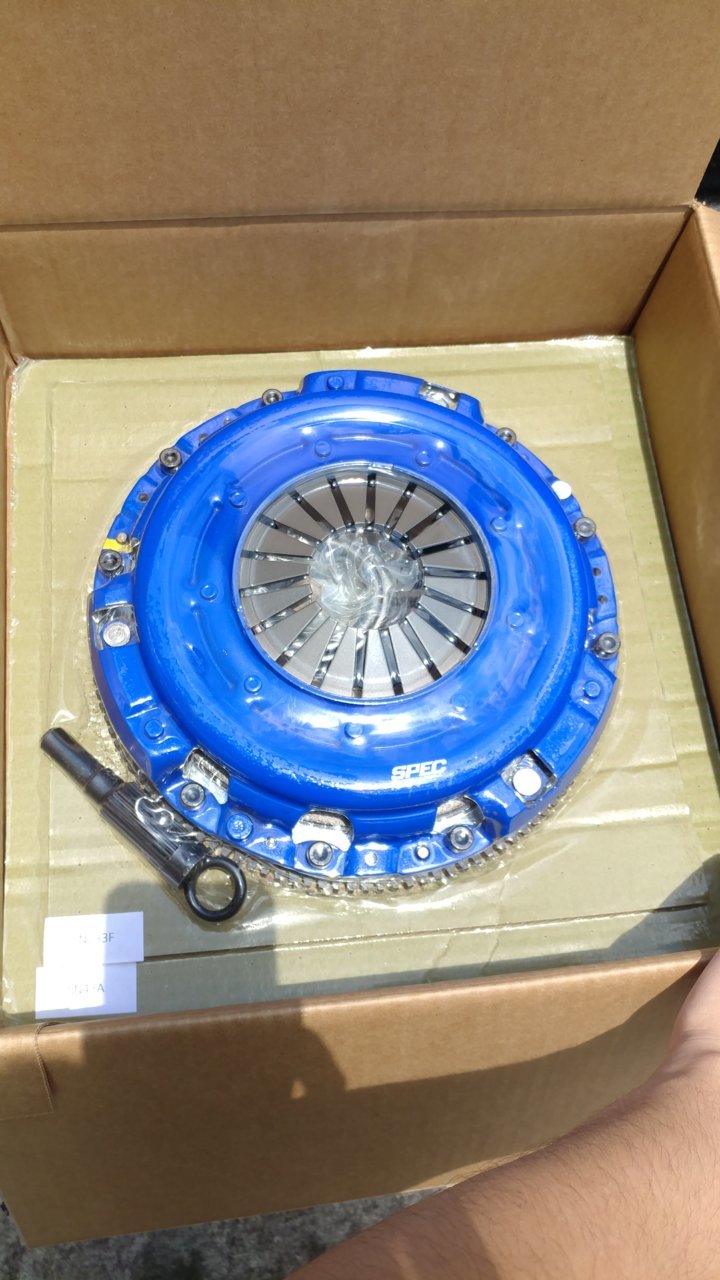

  11. May 23, 2019 at 12:33 PM
    #51
    Lucario Runner
    Lucario Runner [OP] Resident Truck/SUV racer
    Jun 29, 2011
    #59067
    7,198
    Robert
    San Antonio, TX or nearest race track
    06 Toyota 4Runner
    AFE stage II intake, APR X1, URD 70mm Throttle Valve (ported and knife edged), NST intake manifold spacer, URD spec U headers, Denso IKH20, URD fuel pump, APR fuel rail, URD Y pipe, URD spec u catback, lightweight water pump pulley, Greddy sandwich cooler plate, Earls oil cooler, IPT valve body, FJ TRD shocks, Cusco front and rear sway bars, Energy Suspension rear track rod bushings and rear link bushings, Carbotech pads, Stoptech ss brake lines, Stoptech slotted rotors, Motul 600 rbf, Limited Grill, Painted hatch cover by me, Painted valve covers by me, Cobra CB, TRD rad and oil cap, Escort 8500, Autometer oil psi and temp gauges, AEM wideband afr gauge, Flexpod, Pioneer 400w speakers.
    20190523_141440.jpg clutch and flywheel showed up. Wanted a aluminum pressure plate but that couldn't be selected by the distributor. Oh well this set up should be good enough for now.

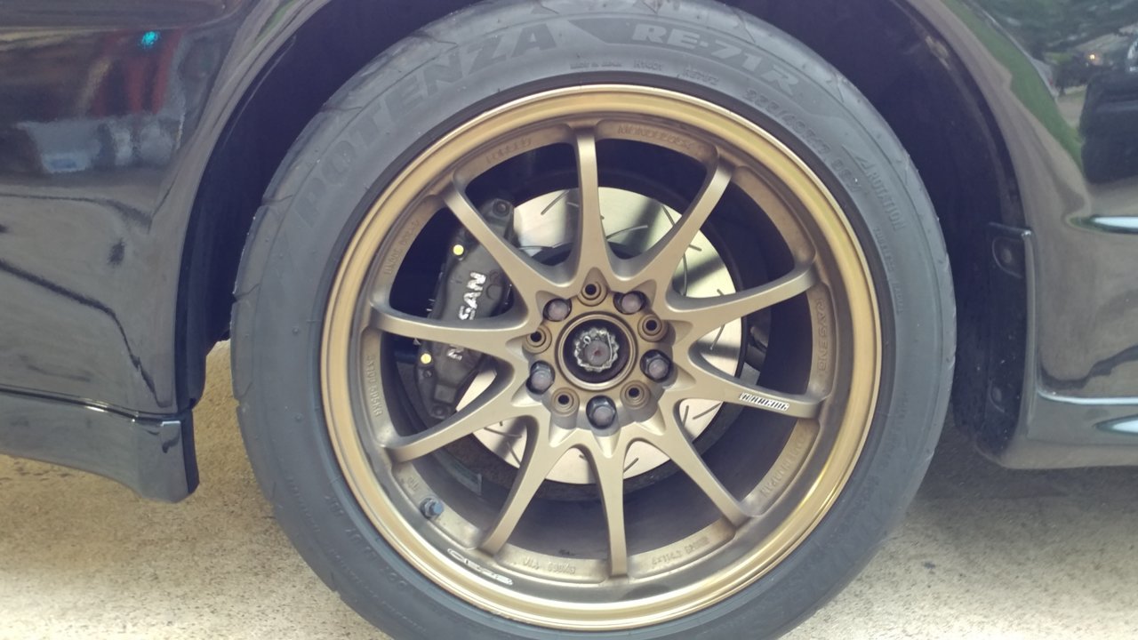

    Front brakes done.

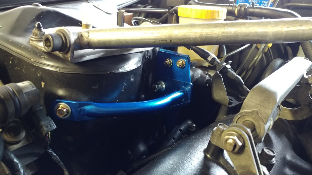

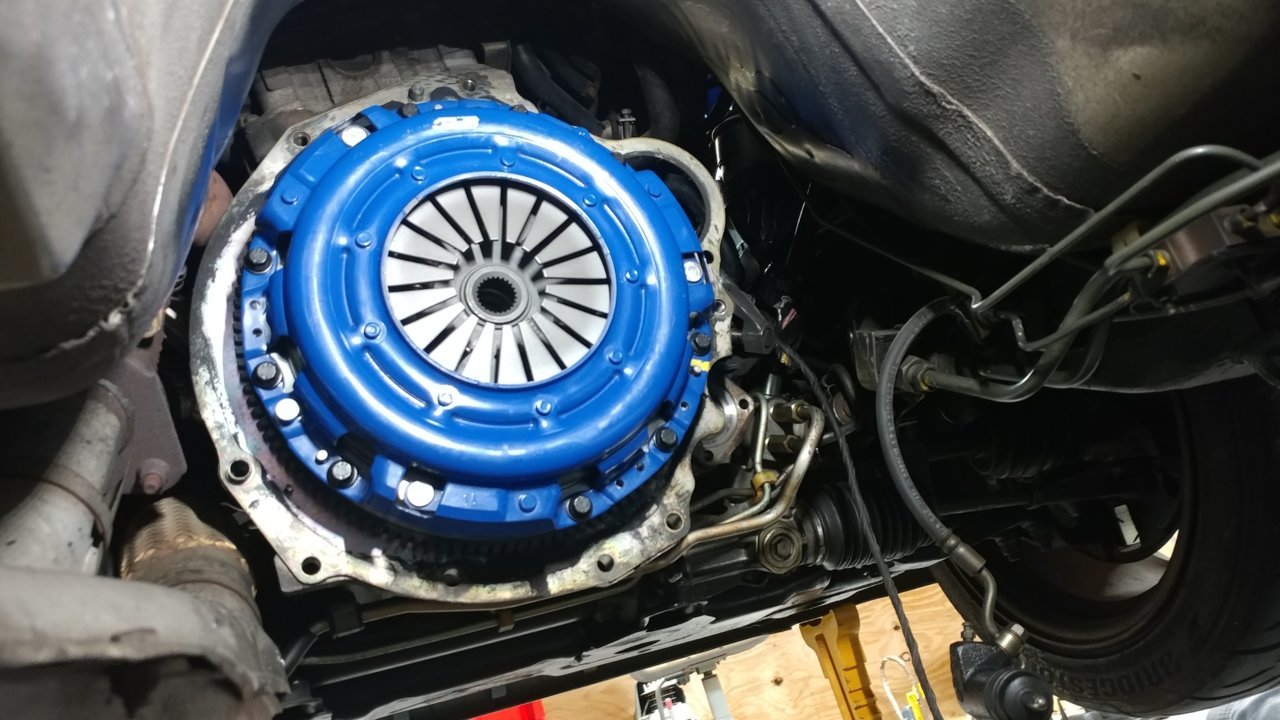

  18. Jun 2, 2019 at 9:34 PM
    #58
    Lucario Runner
    Jun 29, 2011
    #59067
    7,198
    Robert
    06 Toyota 4Runner

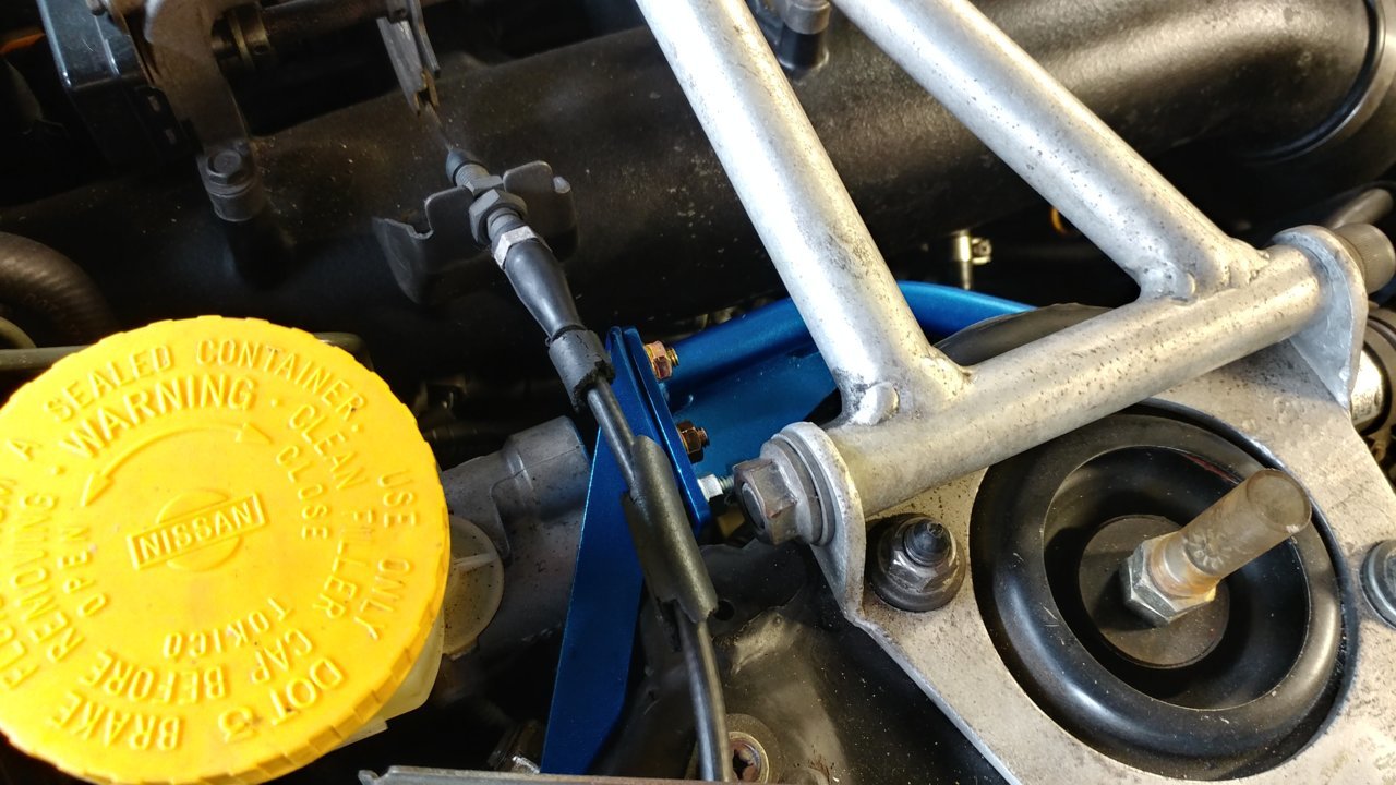

    Cusco master cylinder brace.

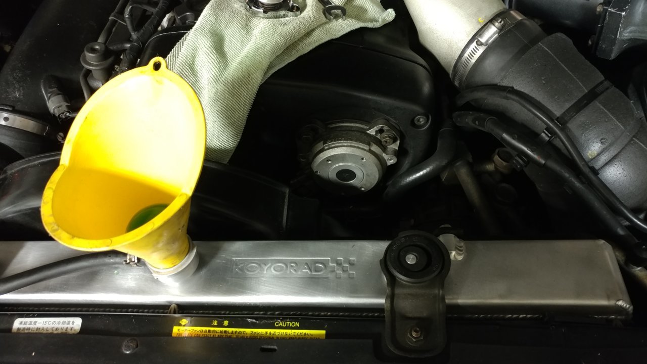

    Koyo rad racing radiator.

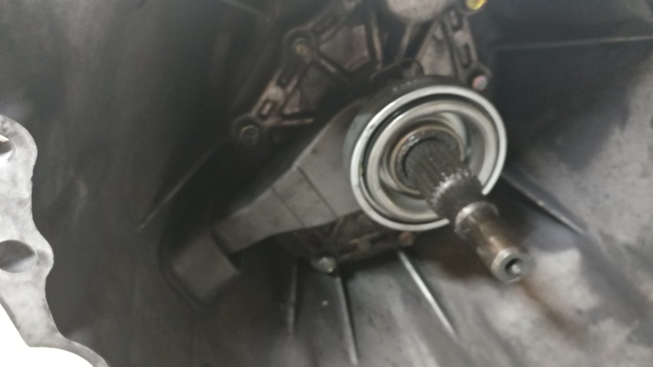

    Dropping transmission for clutch job. Big thanks for @mnovak @Brice and @Torspd for the help in this endeavor.
    Old bushing removal and new rear main seal.
    You'll need this for either a rb26 or an fa20. Workz better than bread.
    New tob, fork, upgraded pivet ball and new boot installed.

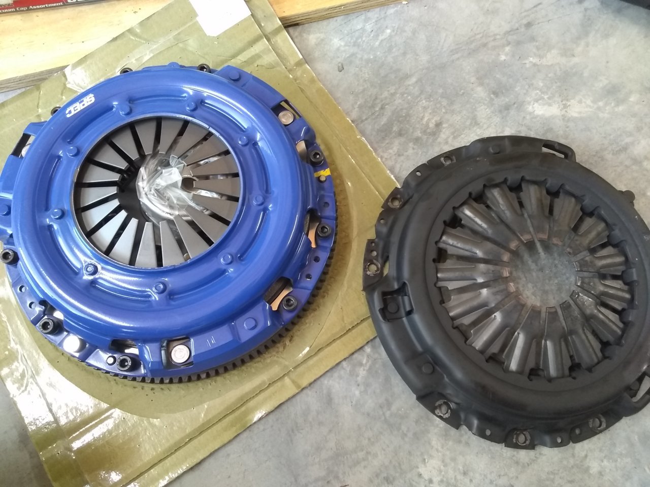

    Clutch in. @Torspd can add more details but to summarize the steel flywheel was shot, looks like they just changed the clutch material, not sure on the pressure plate friction side and pressure plate bolts were loose. So this will be fixed properly. We are at the point of lowering the subframe to stab the transmission. Hopefully it'll be running by Tuesday.

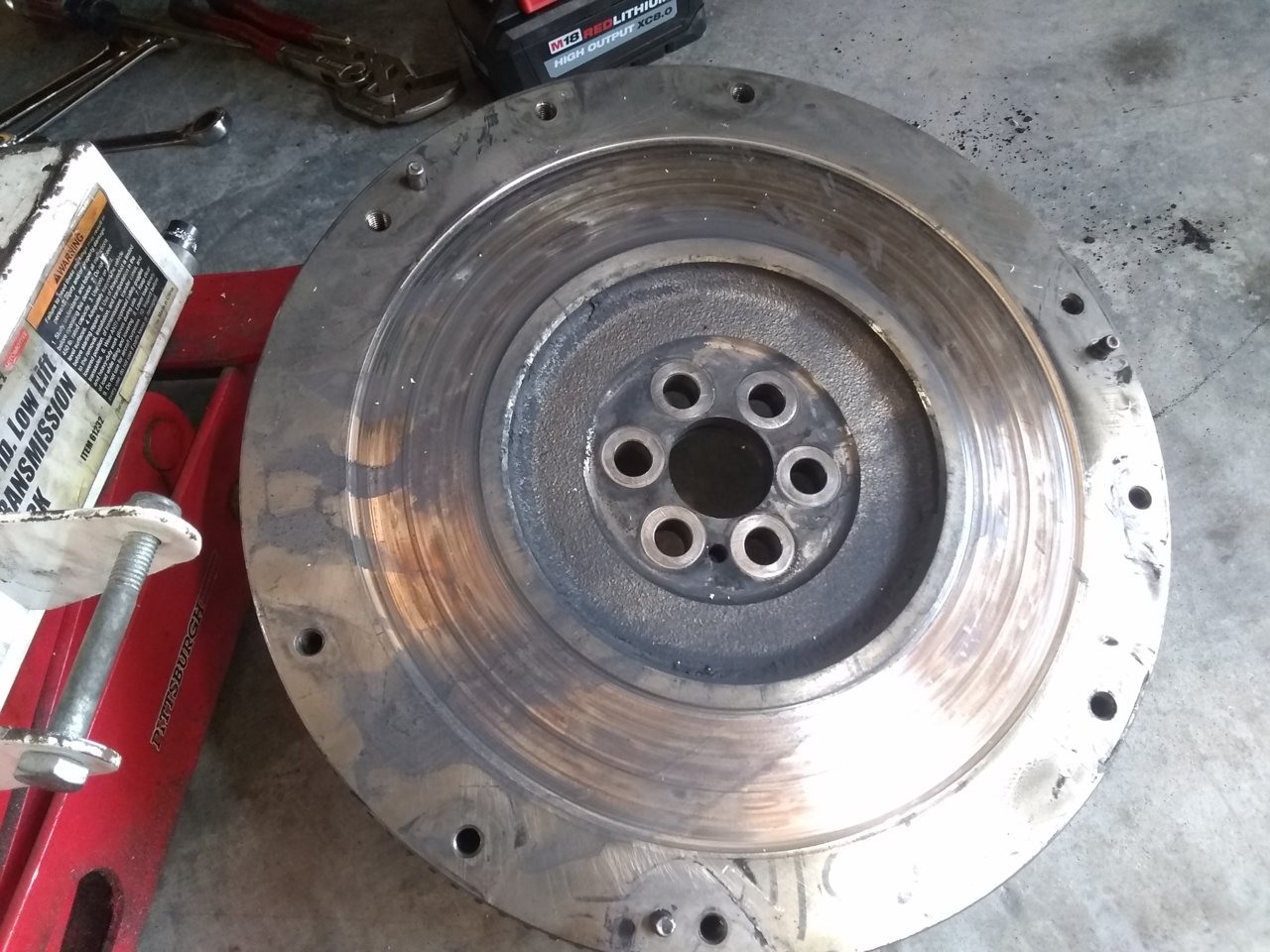

    Here is the old flywheel. Never seen one resemble a badly worn brake rotors before.
    SPEC Stage 3+ RB26 clutch, versus old.

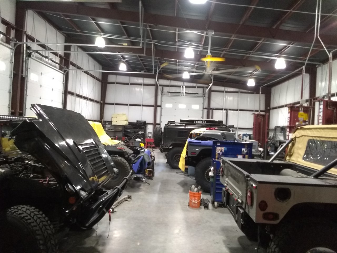

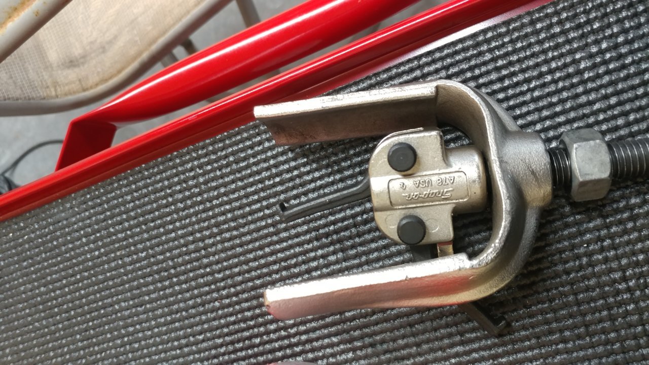

    Pit stop to a friend's shop for a couple specialty tools. Mod Mofia, for all of you Hummer aficionados.
