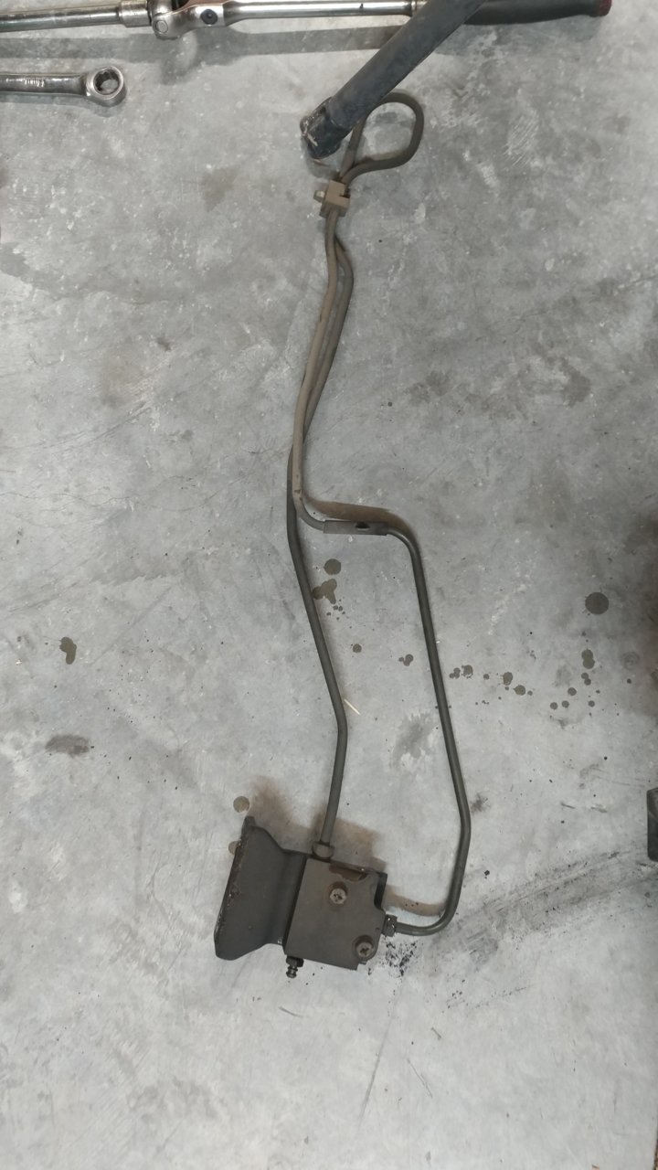

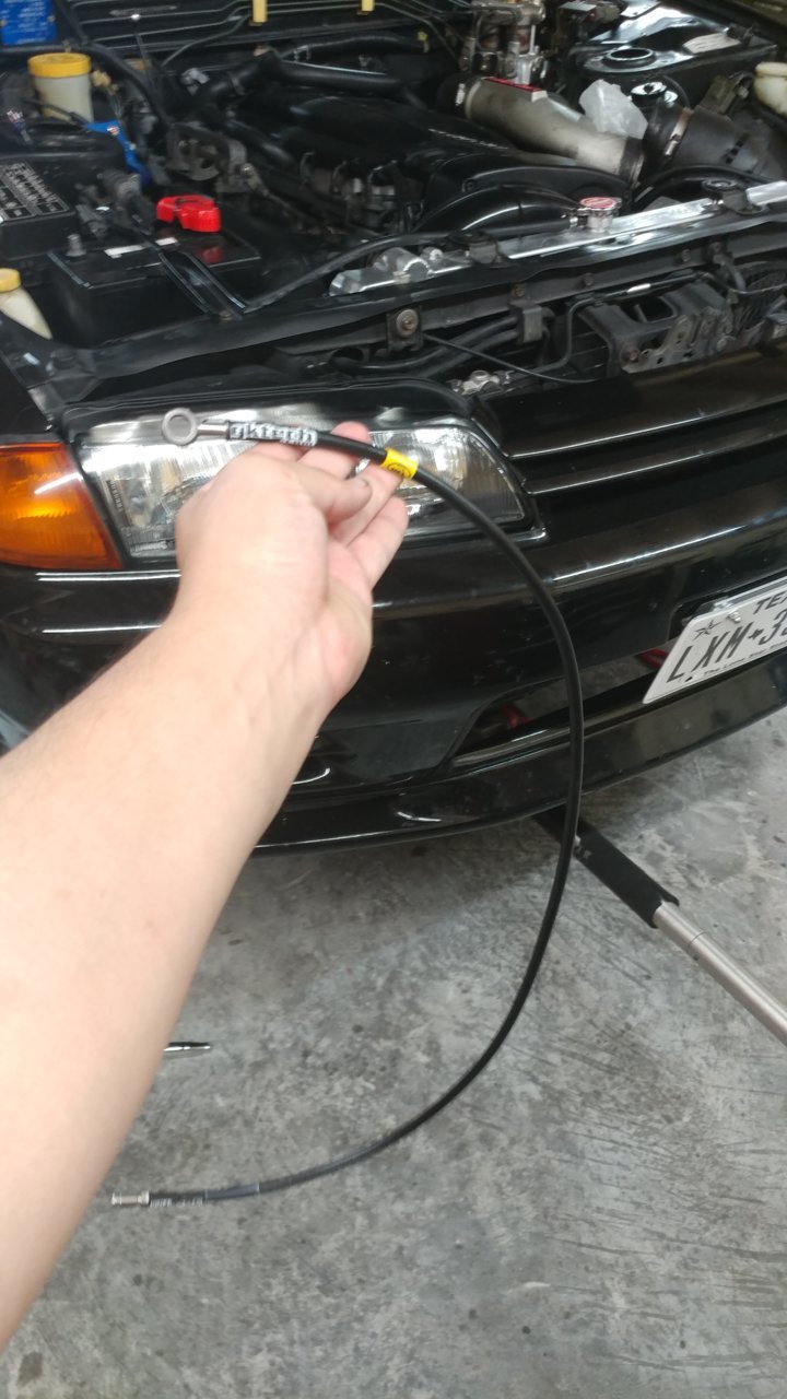

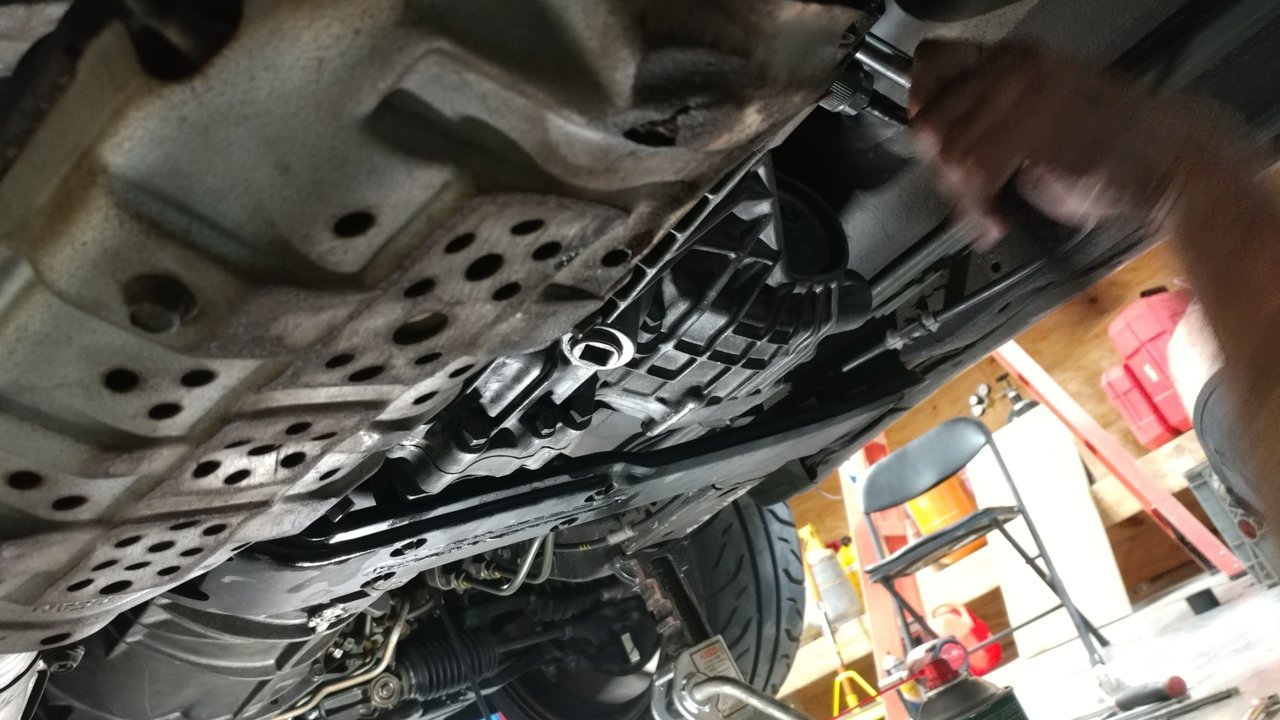

    Gktech clutch line and new Nismo slave cylinder in.
    Guess I'm sol 4 warranty.
    Dont know why the loop into the same system for the clutch but it's out 4 weight reduction and simplicity.
    When u wanna have shit done right now.
    Transmission in. Need to tap new thread for one trans mount bolt and put fluid in for the transfercase and the attesa.

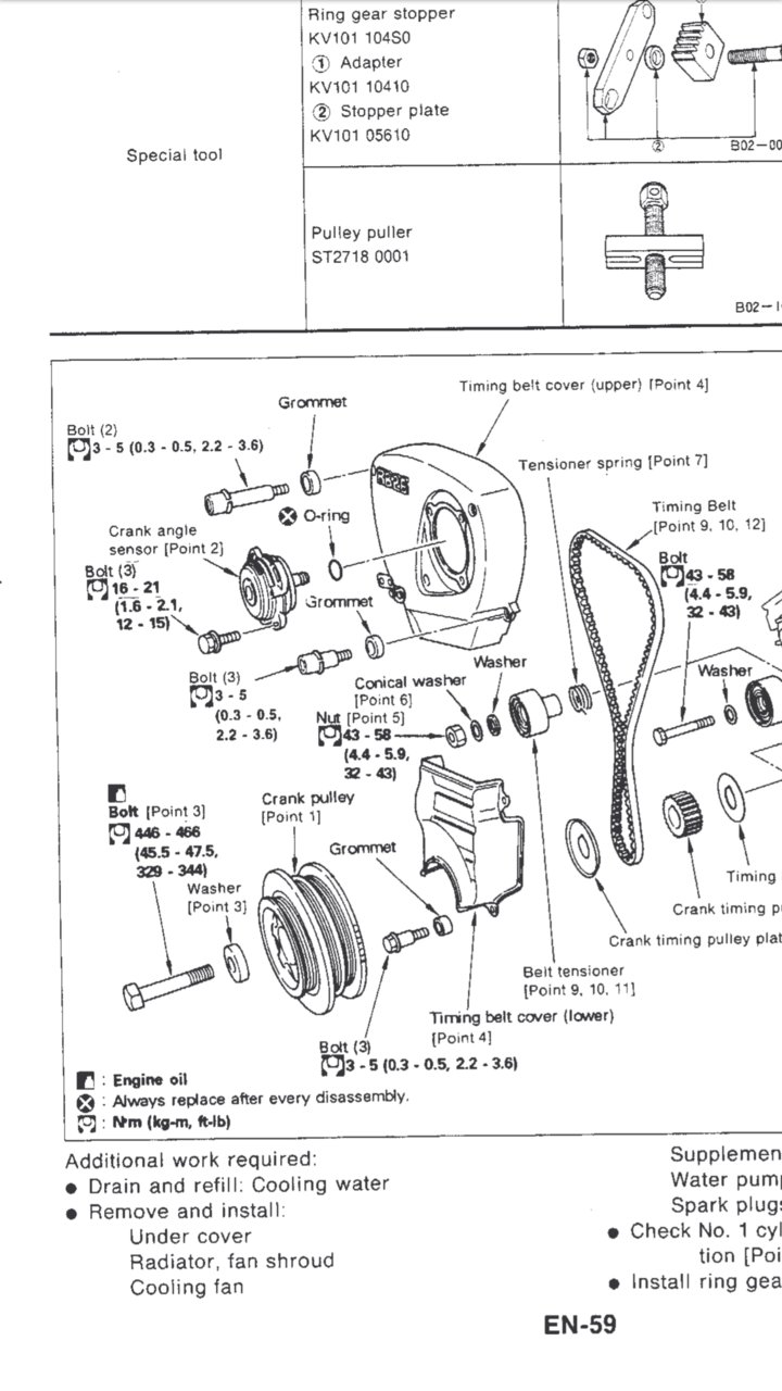

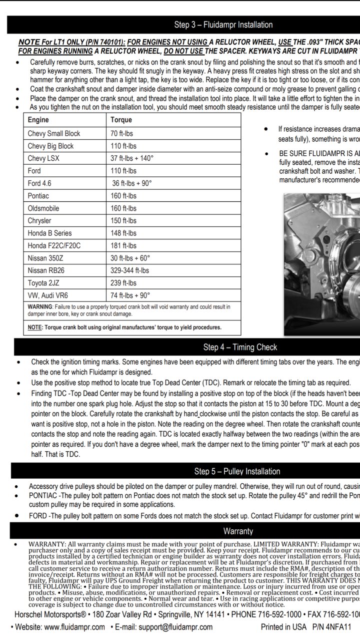

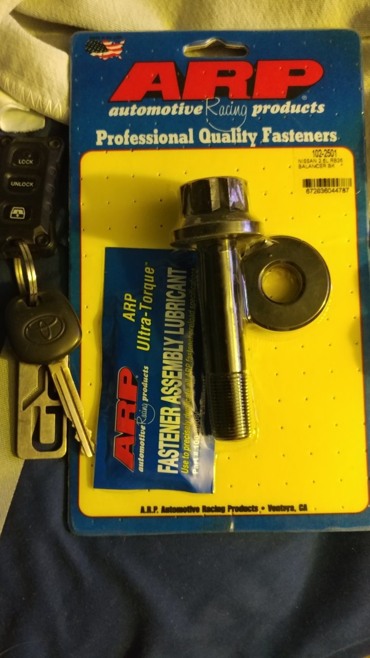

    20190613_124345.jpg ARP crank bolt.
    Tq spec on an RB, hence answers the age old question the RB is greater than a 2jz.

    Is that tq specification with oil on the threads, or the ARP lube? Since those instructions are for a Fluidamper pulley?

    Its tq spec in general. Here it is for an oem one.

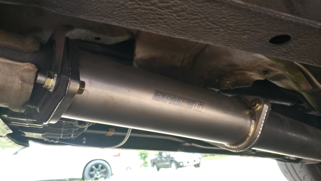

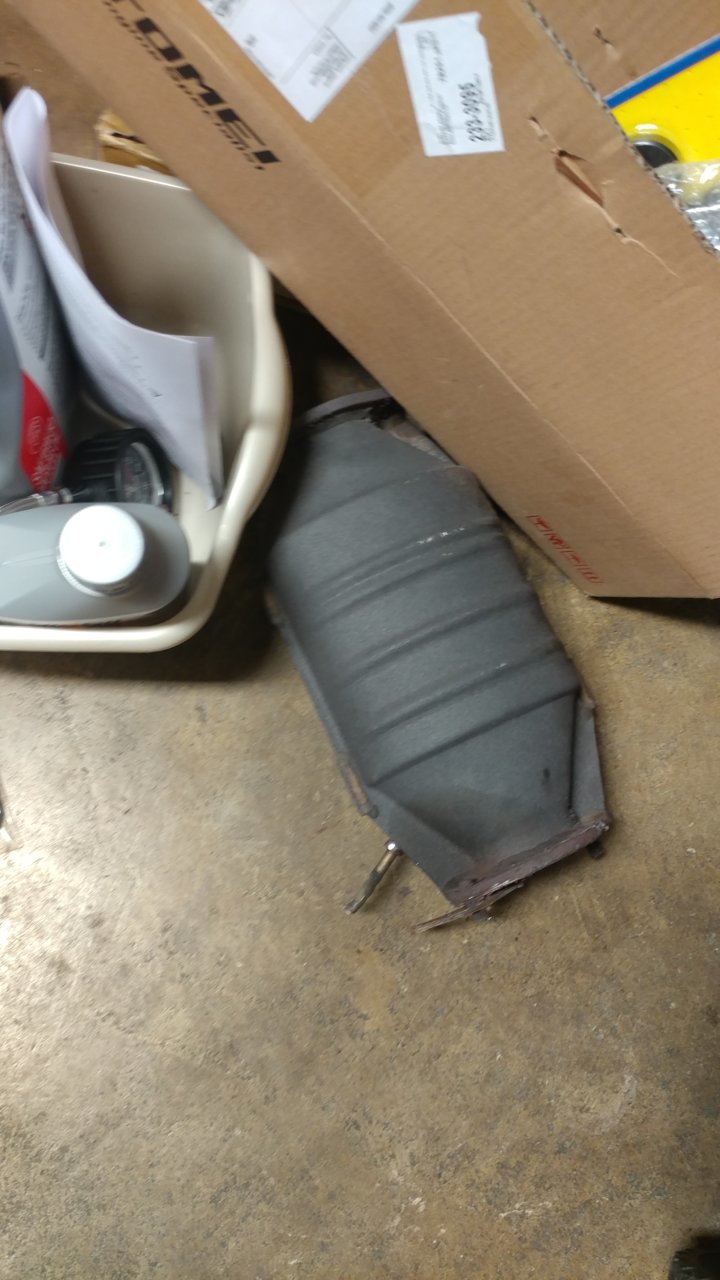

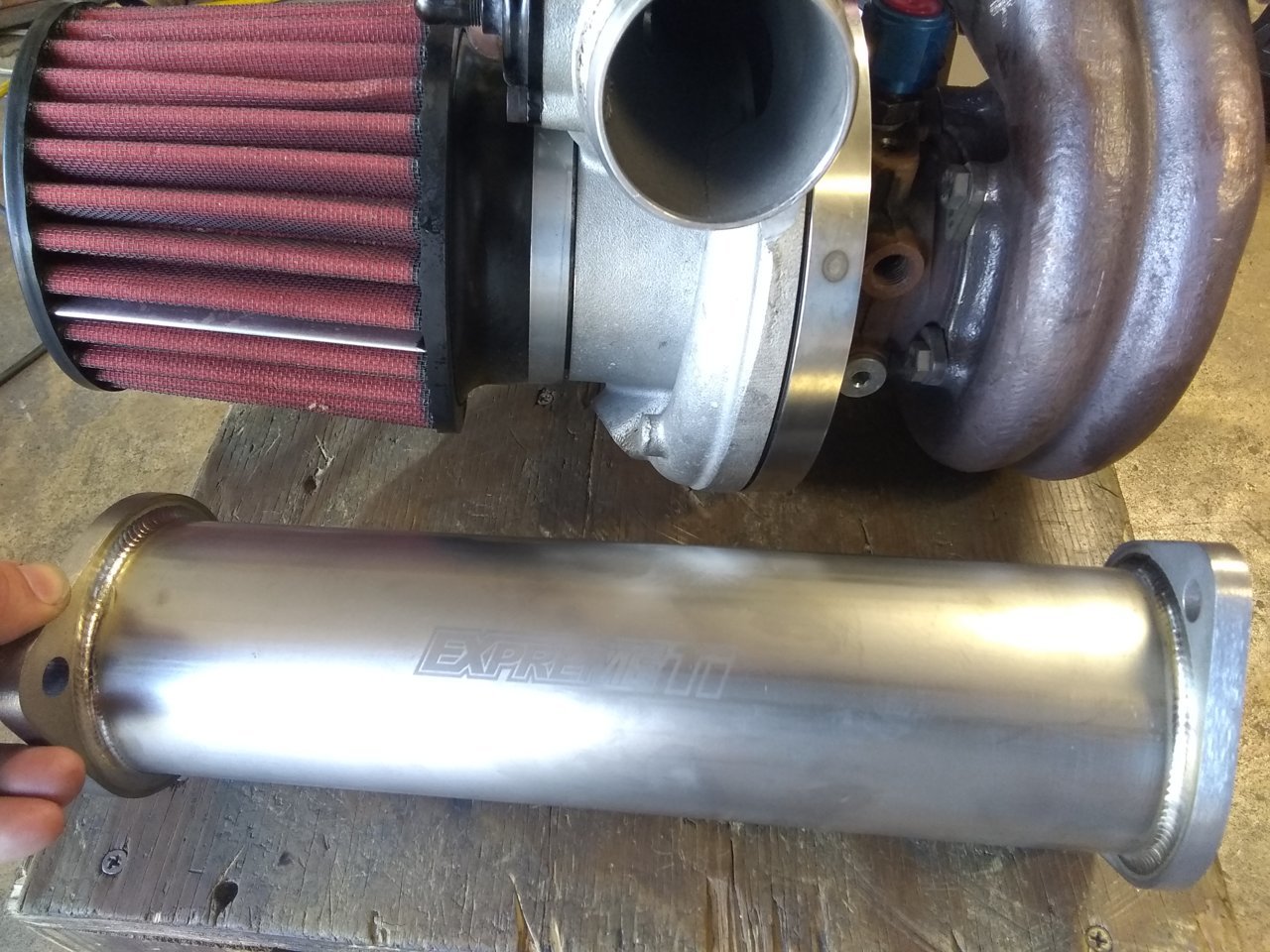

    @Torspd and I got this heavy pos out and installed the tomei race pipe. Two more days till track day.

    Sep 18, 2009
    #22958
    26,446
    Tor
    The Great America!
    MMVI 4.4L 4x4 Access Cab
    Torspd Custom Turbo kit [] Borg Warner 9180EFR Turbo [] Haltech Elite 2500 [] TiAL Q BOV [] TiAL V44 Wastegate @ 15psi [] CP Pistons [] CP Carrillo Rods [] ARP Head studs [] ARP Main Studs [] ARP Header - Head Studs [] Ported Heads w/ 1mm oversized valves intake/exhaust [] Brian Crower Forged Stroker Crank [] Darton M.I.D. Sleeved Block [] Kelford Camshafts [] Torspd 160* T-stat mod [] APR Large Fuel Rail [] Walbro 460 LPH E85 Fuel Pump [] FueLab FPR [] APR T56 Conversion Kit [] KP RACING Built T56 [] McLeod Racing Custom Twin Disk Clutch [] One Piece Aluminum Driveshaft [] MGW Shifter [] Custom lowering kit [] Ohlins Front Coilovers [] QA1rear shocks [] Custom Ron Davis Radiator [] Dual SPAL Electric Fans []
    For this Ti goodness right here.

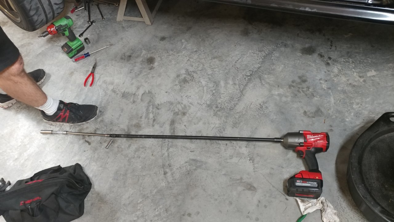

    20190620_135627_HDR.jpg track day prep. Drain and fill transmission w/redline heavy shockproof. Engine oil drained and filled w/15w50 race oil. Might adjust air pressure and shock settings later.

    How'd you make your car levitate?

    My will was stronger than the mass of the GTR.
