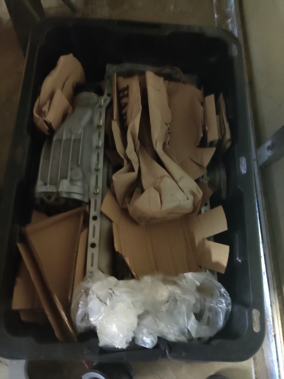

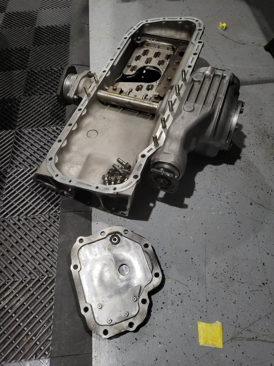

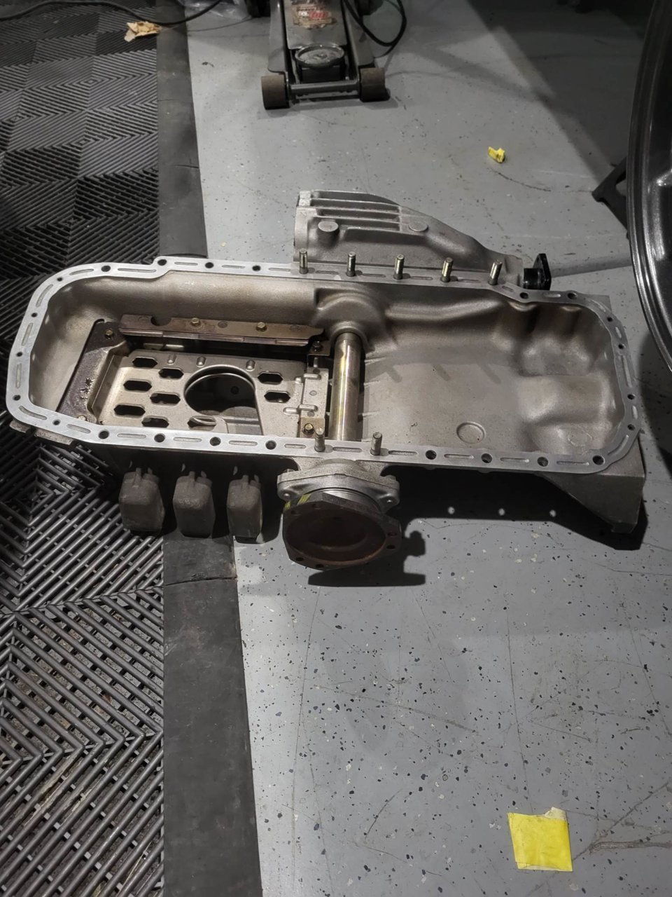

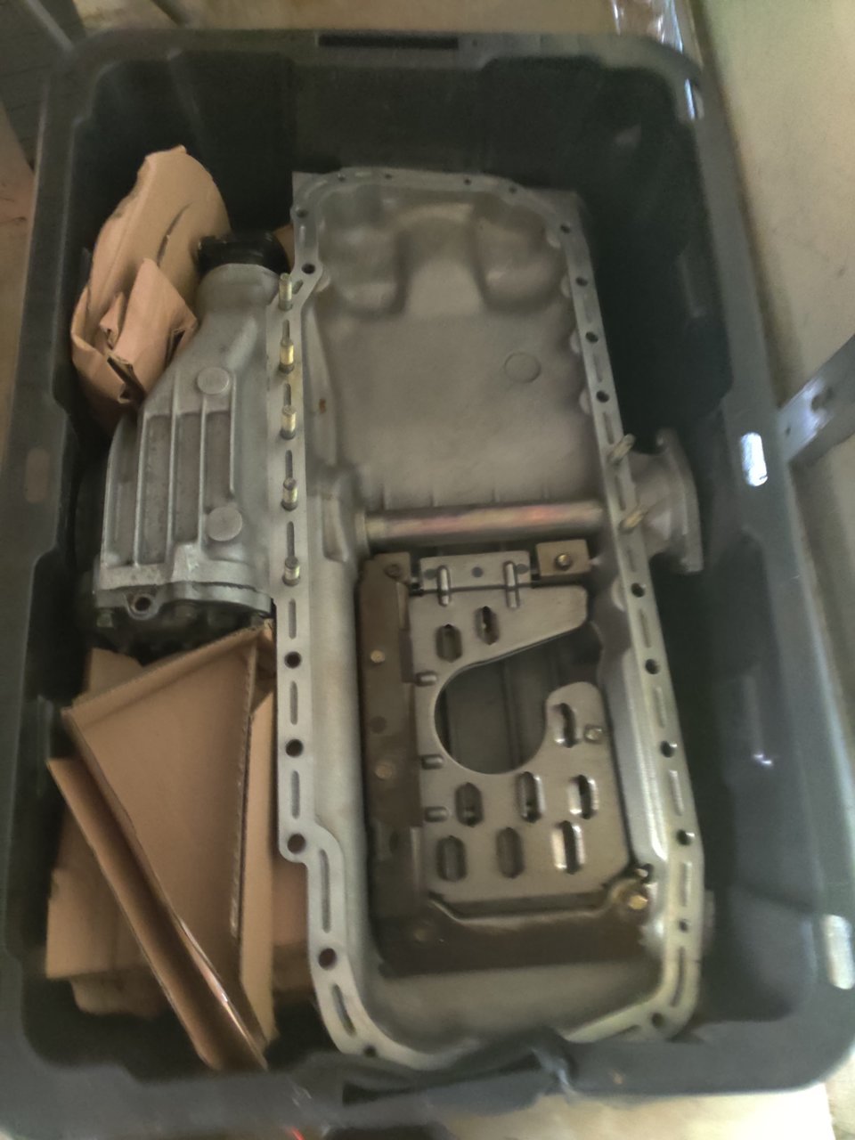

    Got me a loaded oil pan coming. These have been hard to find. Last major thing I need is a cylinder head. Still looking out for one of those.

    Good catch!

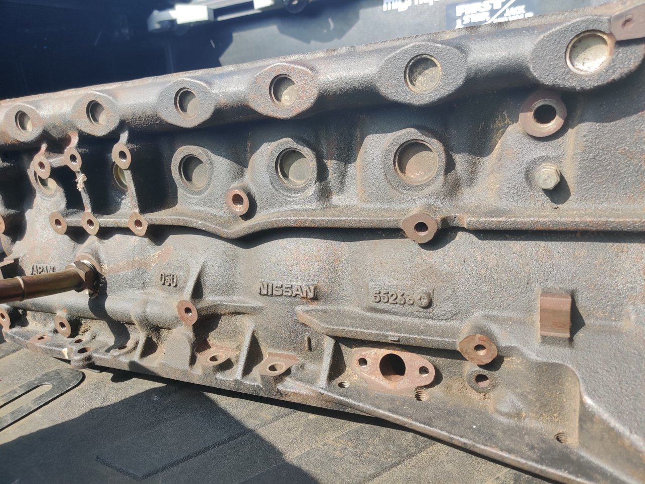

    Block dropped off to be inspected.

    Block still pending being checked for usability which is fine, more time to save funds. Turbo wise I'm pending further eval is either using gt2860r or a GTX 2867r. Leaning towards the GTX for future growth.

    Block has been cleared for usage to build on. Machine shop will give me the details on the bore to either stay 86mm or step up to 86.5mm. then I can order the stroker kit with the right pistons. Not much needed for a short block minus doing the spline drive conversion for the oil pump. I was going with the tomei pump but hks now has a revised oil pump with the external adjustment and a provision for the crank angle sensor. I will see about which bearings to use and if any coating or treatments can be applicable. Also if anyone sees a rb26 head for sale please let me know.
