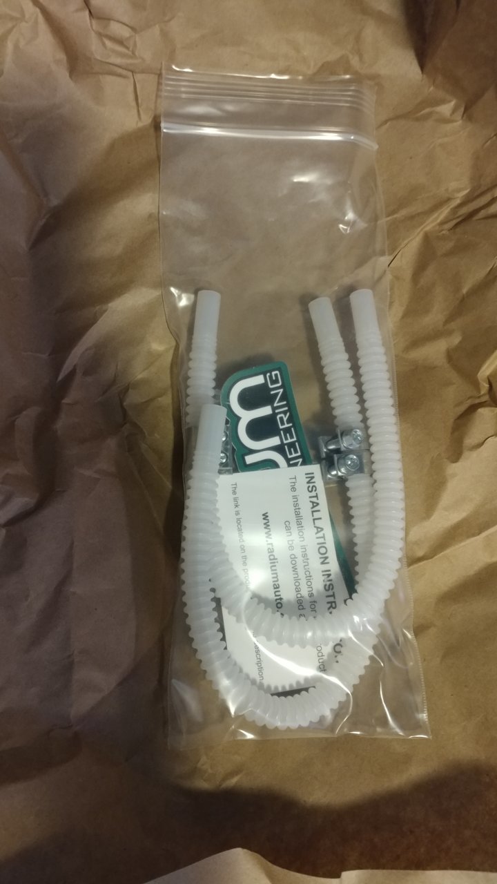

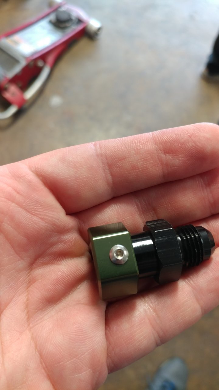

    20190207_163433.jpgso with this I can make a revision to the fuel pump assembly.

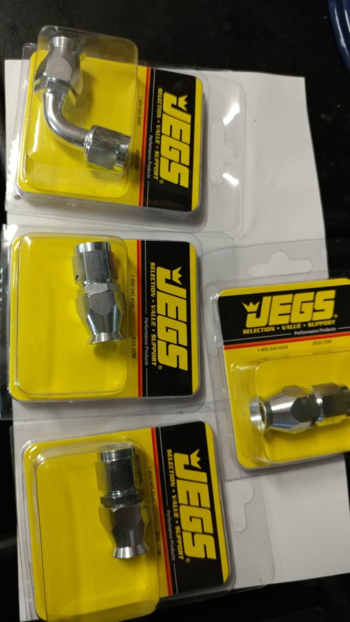

    20190207_163725.jpgI now have the fittings needed to install the fst filter with ptfe hose.

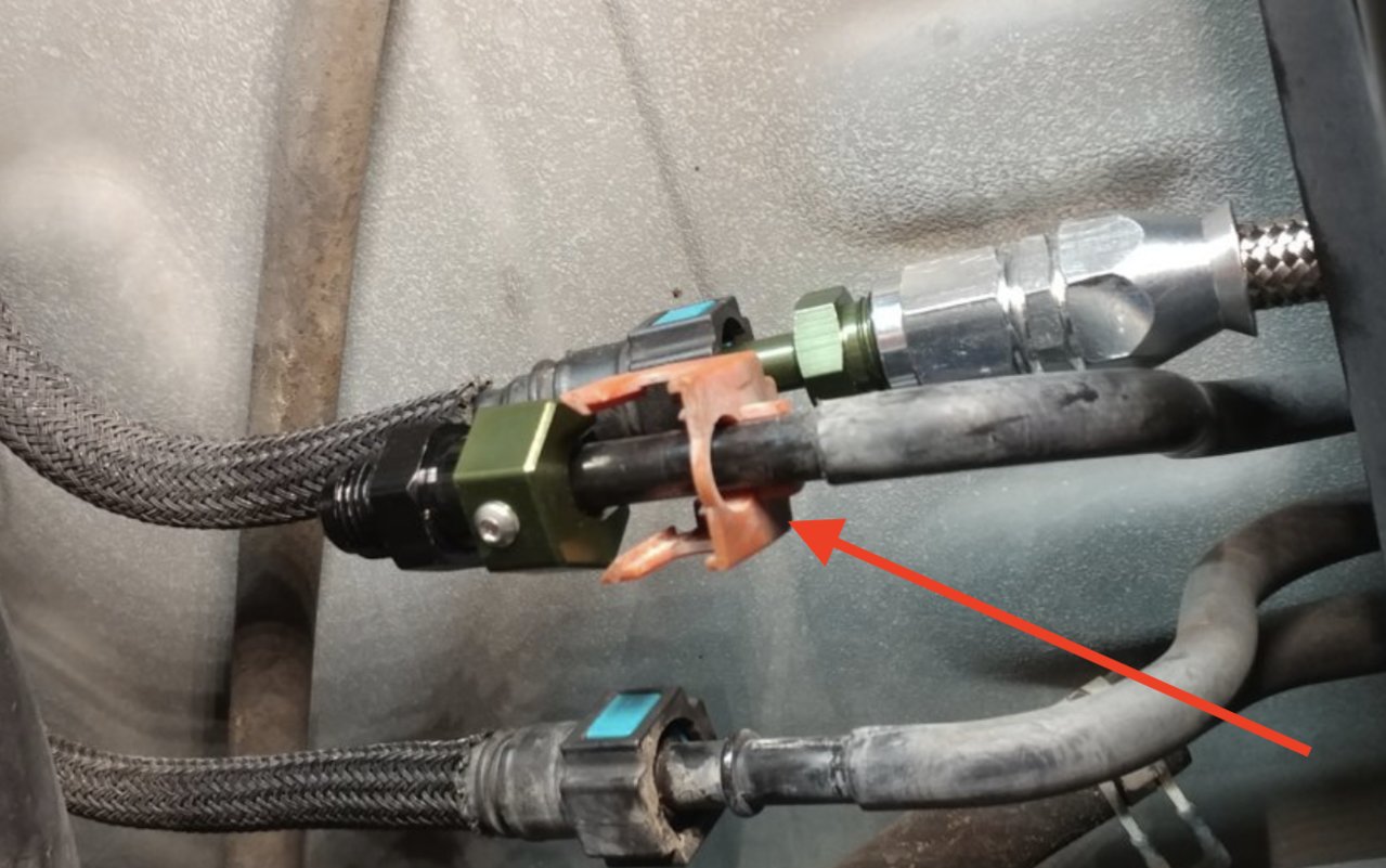

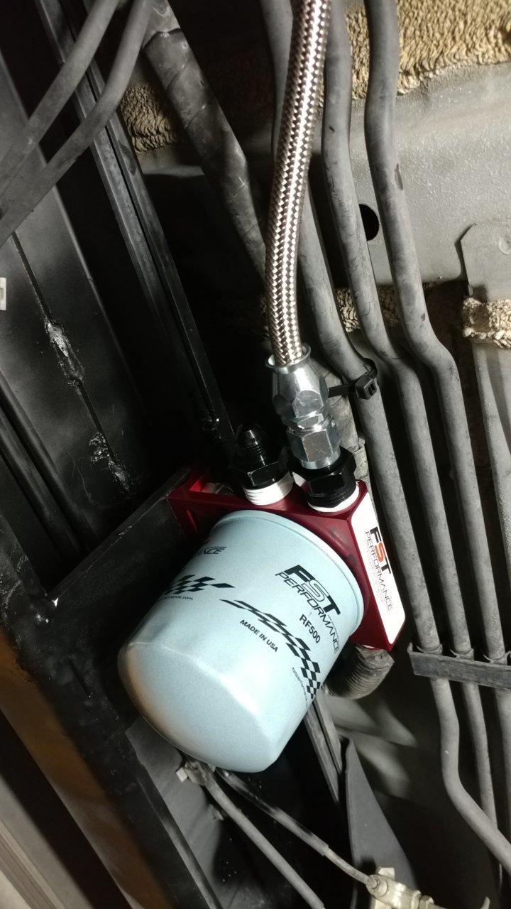

    To follow forth with more mod maddness. Copying the great idea of @loginfailed 's filter mounting.
    This is our handy work from today.
    (The Radium fuel lines fit perfectly, but unfortunately did not get any pictures of that.)
    IMG_20190302_150002210.jpg IMG_20190302_150838199.jpg IMG_20190302_200639050.jpg IMG_20190302_201011827.jpg
    TacoLeeSD, Slashaar, not_nick and 6 others like this.

    Strong work, vera noice! Is that a new style of -AN wrench? :D
    PS: Take off the pink thing, you don't need it anymore!
  12. Mar 2, 2019 at 6:38 PM

    Stainless wrench for the stainless -AN fittings. :D

    I painted both sidez cause I'm weak...

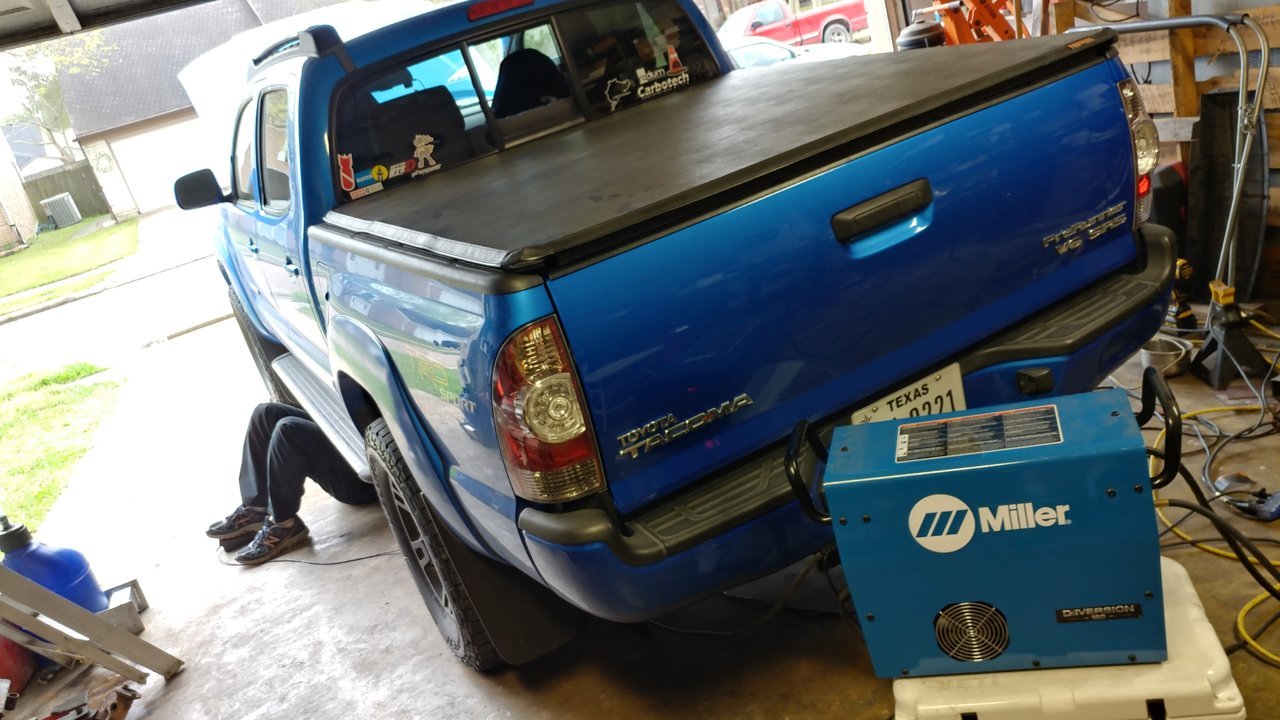

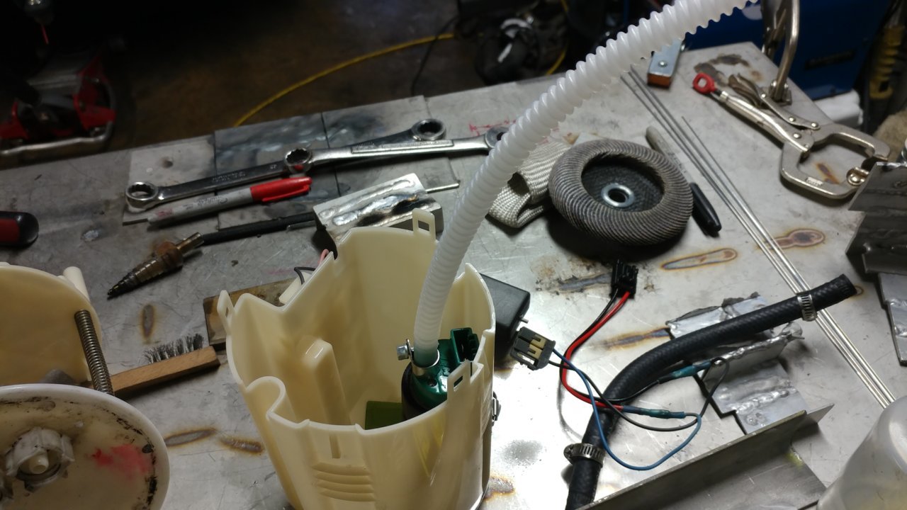

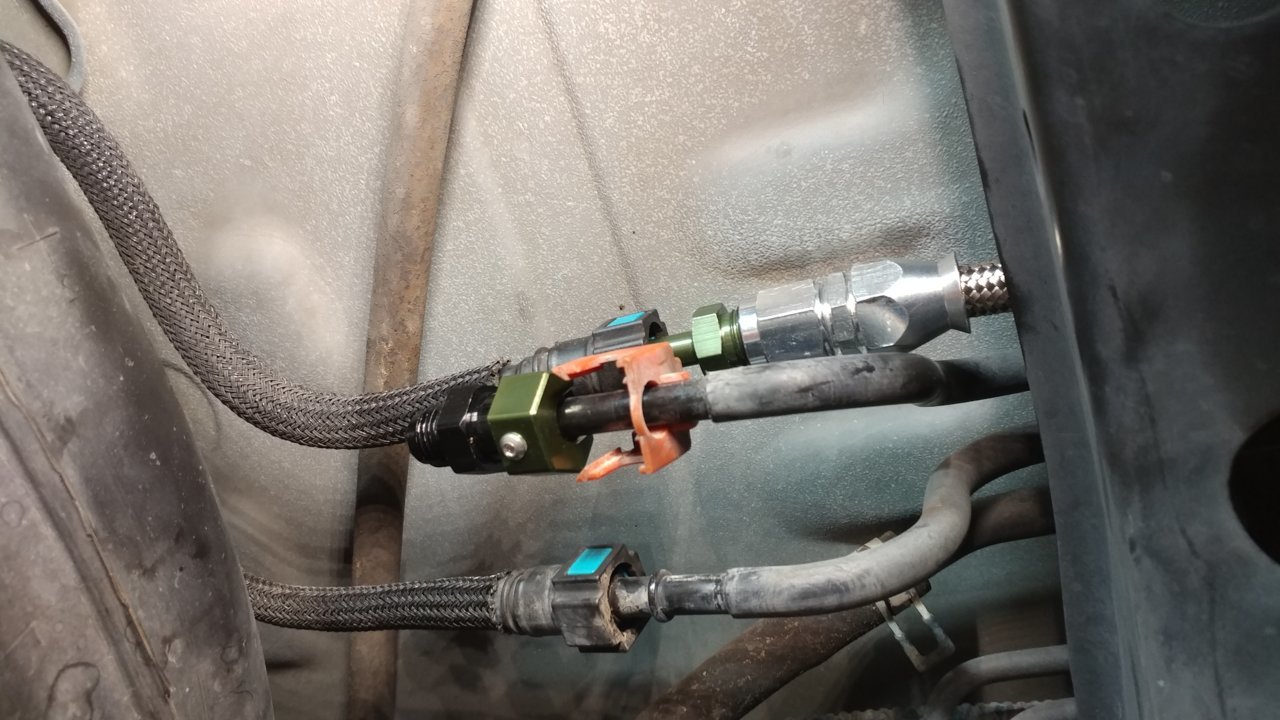

    Welding in plate
    Radium ptfe accordion hose.
    Radium 5/16 to 6an adaptor fittings
    Basically done.
    Truck runs.

    It's not pretty but functional. Tacoma frame repair in a can.

    Cut that bitch off, bro. You're killing me over here. Is that part of your engineering plan? You need that on there to reduce harmonics of the fuel pump or what? :D
